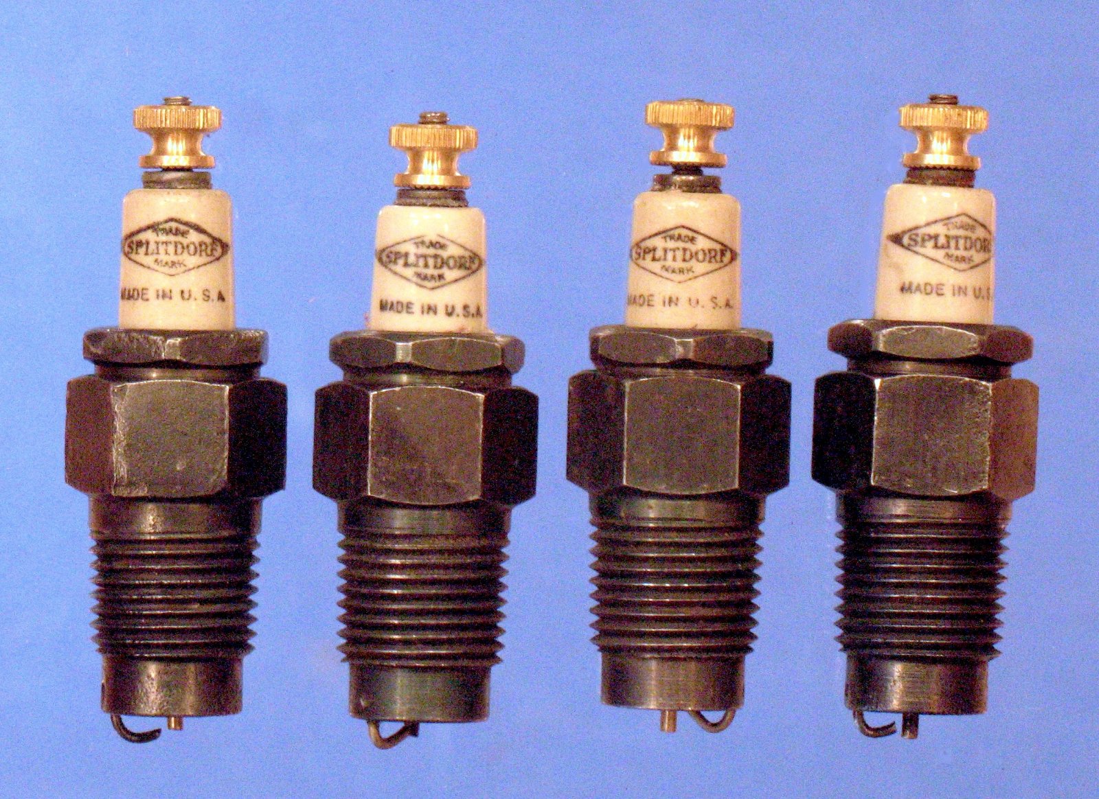

Many plugs are fine. Among new plugs, Autolite 3095 is probably the least expensive (about $12 a set). Those are a good cheap start for awhile, but I've had them fail in less than a year. The Champion 25 fall-apart plugs sometimes come unglued and fall apart. I can't report on the new Champion X plugs because they're too ungodly expensive for me. Even at Rock Auto, probably the least expensive source, they're about $100 for a set of four. Yes, really.
Original Champion X plugs from the teens and twenties are often very good after you clean them up, and can often be found at swap meets for $5 each or less. They sometimes also turn up on eBay.There have probably been over a hundred brands of plugs made for your T, and some of the old ones as as good today as they were a hundred years ago. I'm currently running a set of the old Splitdorf ivory plugs, and they're fine. On the other hand, the Splitdorf green plugs look neat but rarely work.
I often use original Champion X plugs because they are plentiful, cheap, and functional. They were Ford OEM equipment, so they outnumber other old plugs by a lot. Here's a page on those: http://dauntlessgeezer.com/DG95.html
If I needed new plugs I would use the Autolite 3095 while looking for original X's on eBay or at swap meets.
These are working OK for me.
One of these days I'll try some Horseshoe or other old brand plugs. I'm still hunting for enough of those Edison 14's to make a set.

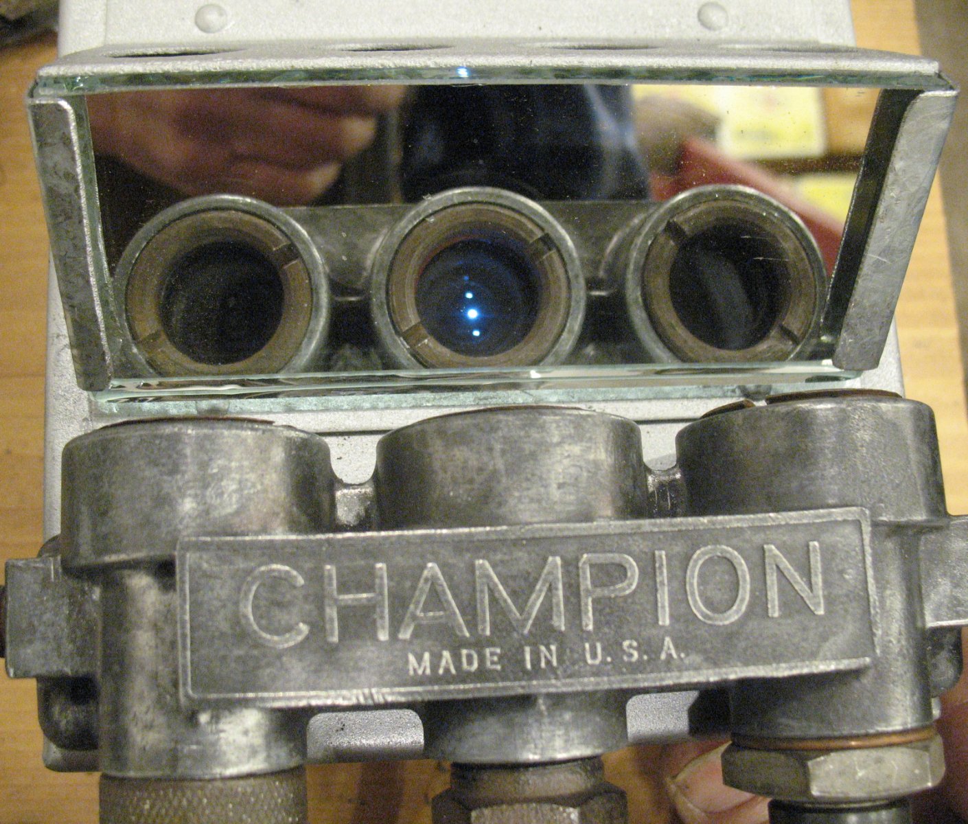

As John Regan has occasionally reminded us, laying the plugs out on top of the engine isn't a real spark plug test. It doesn't show you whether the plugs actually work in the car under compression. A plug tester is the tool for that.
70 psi is more pressure than you're likely to have in a Model T. If you get a good spark there, it's good to go.
The center dot is the actual spark. The two little ones are reflections.

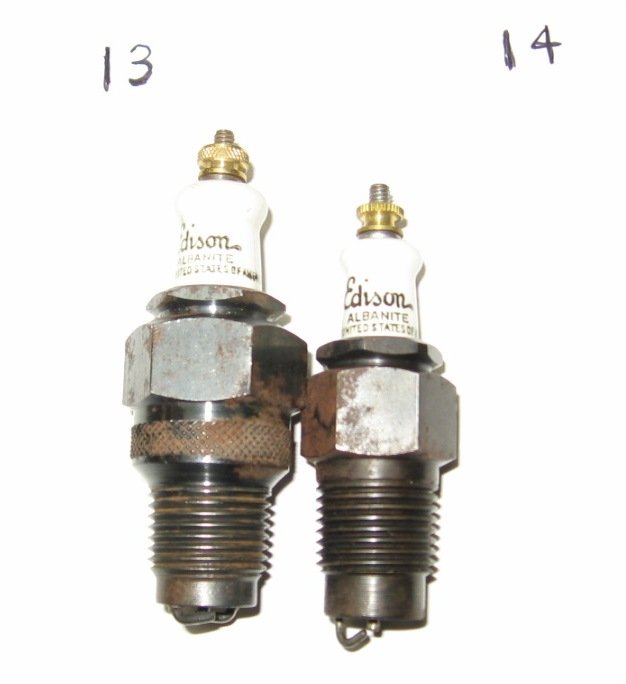

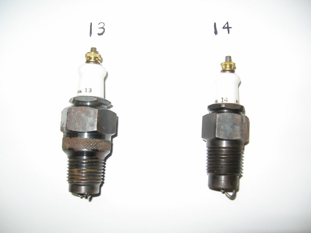

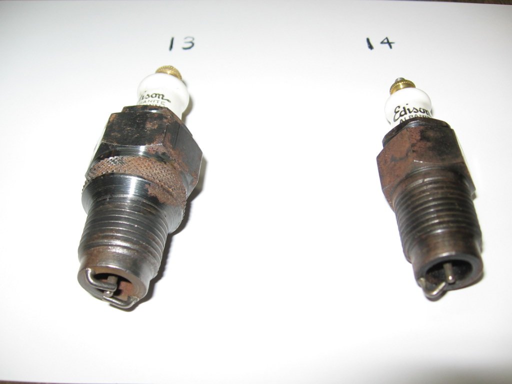

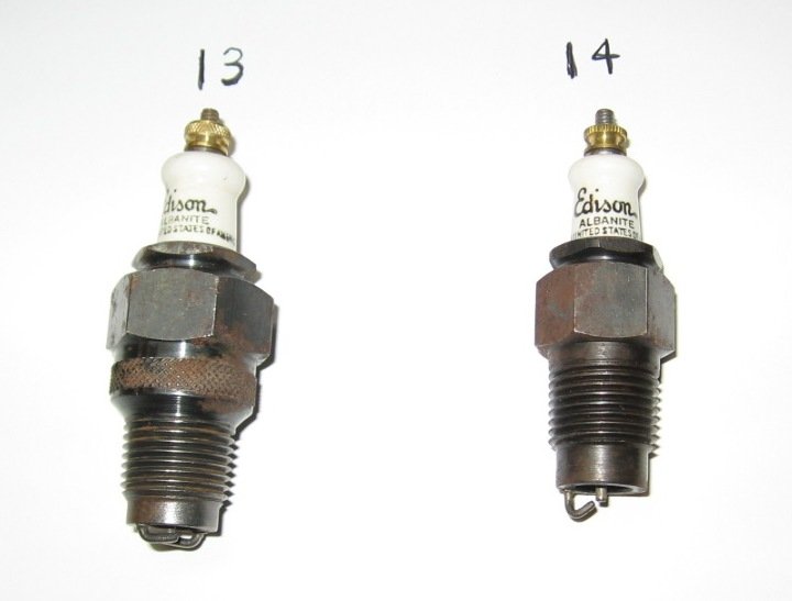

Edison 13s will also work in a T, but they are even harder to find than the 14s. The 13s are physically larger and have dual ground electrodes. I have no experience with how they run. :)
