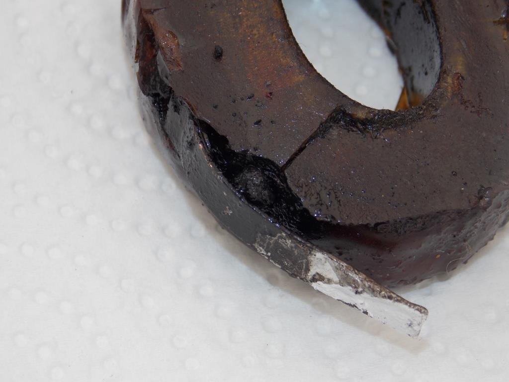

Here a few pictures of what can possibly go wrong with the magneto.
First is a double oval freshly rebuild and run for a few hours.
The rebuild coil loop
Rebuild coil.
Rebuild coil.
Disassembled coil.
Disassembled coil.
The reason why there was fire was the debrit of oil, band material and small metal parts that made contact wih the frame.

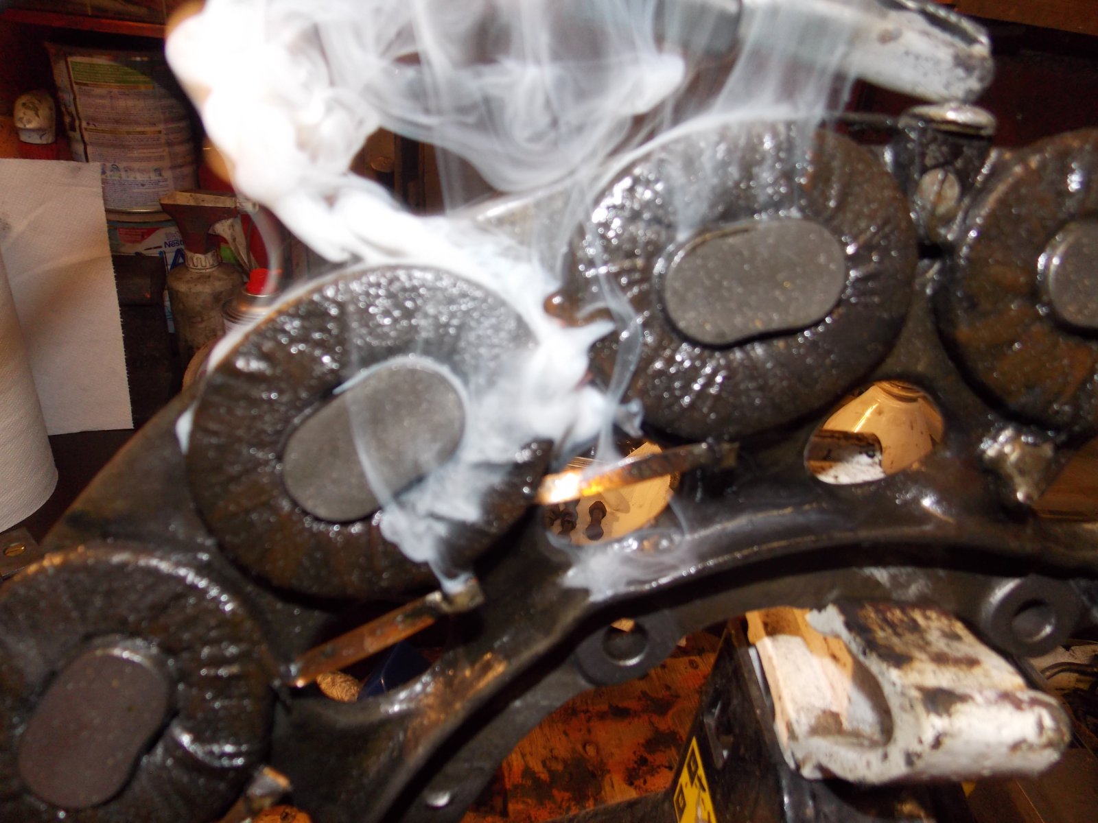

Second one was during the recharge of the magnets during the rebuild of an engine.
The magneto loop was looking fine and I tried to use it again. During the recharge of the magnets I set the loop over the flywheel and flashed it three times with 42Vdc. it started smoking at the second time. Needed a total rebuild.
Andre

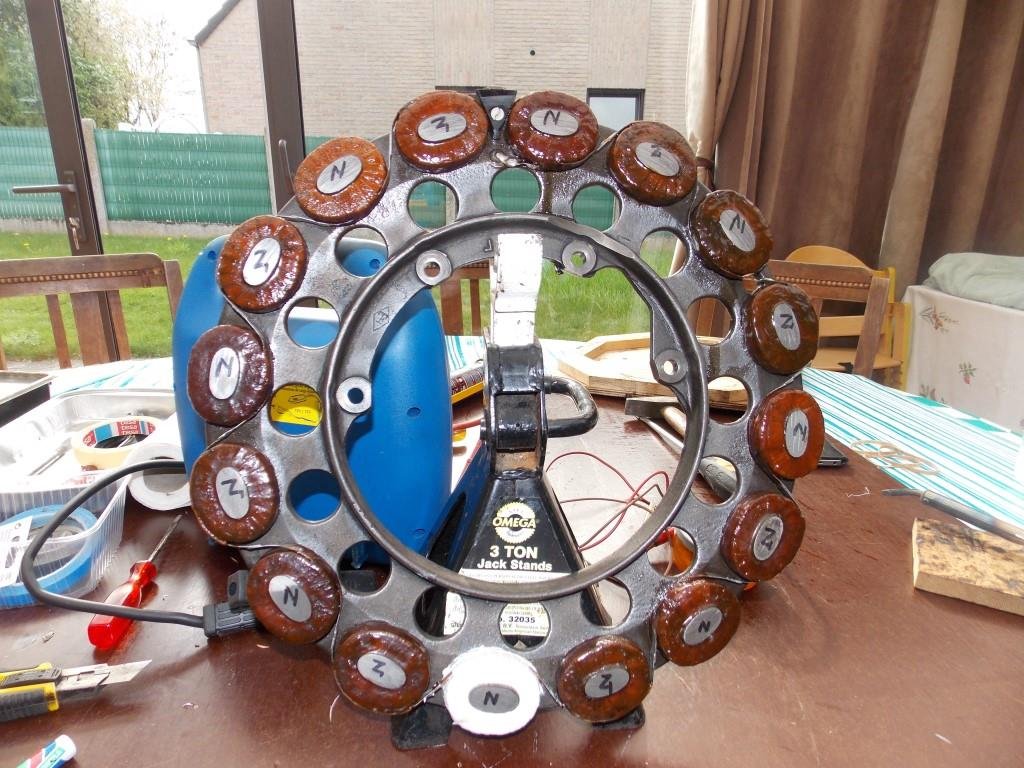

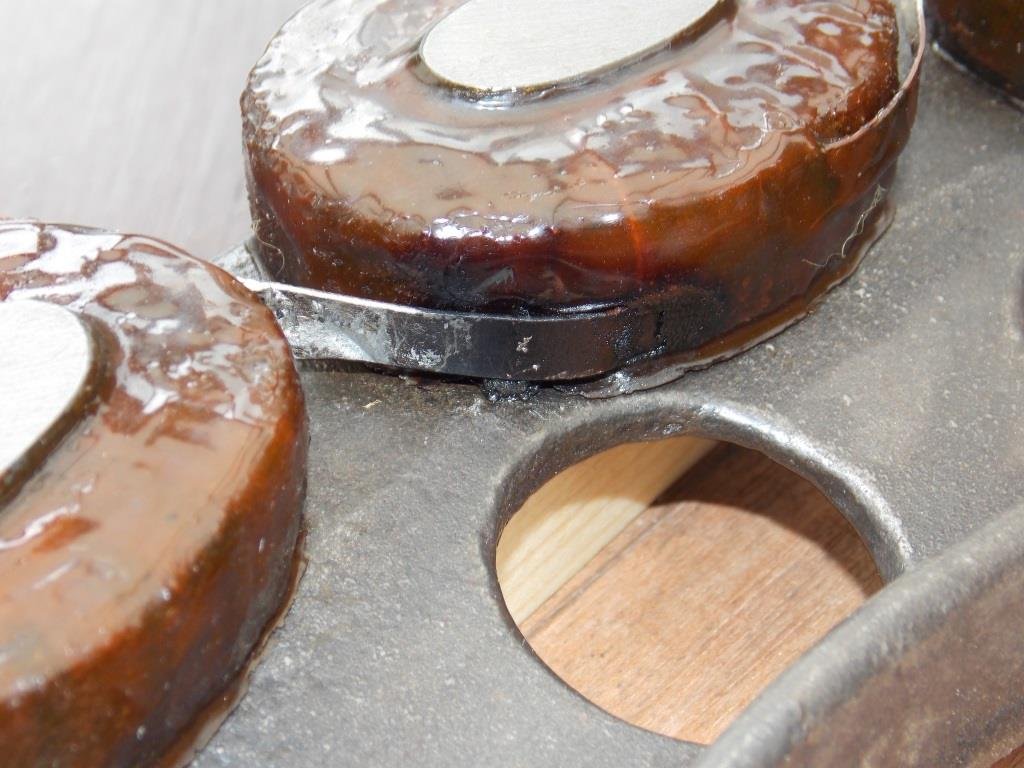

I just need to learn how to put the photos in the right order. The last photo is for the message I wrote just before this one.
Finished single loop.
What was wrong.
What was wrong.
Smoking loop.
Smoking loop.
Finished double oval loop.
