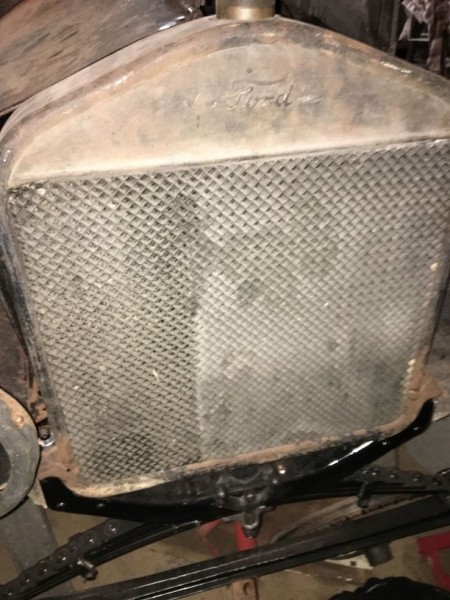

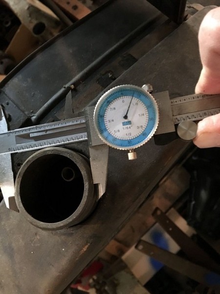

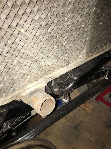

Folks, this radiator came with my un-assembled model t. I'm trying to locate a radiator cap to fit. Thought a 28-29 model A cap would fit, but this is 16 tpi, and the model A is 18 tpi. Note the diamond pattern cooling fins. Hose connections appear to be in the right spot for a T. Any suggestions on sourcing a cap, besides making one? Thanks for your help.

I would recommend that you put the radiator on a T and put something such as a piece of old innertube and fasten with a wire tie or something. Then take the T out for a drive and try to get it as hot as you can to see how well the radiator performs before you look for a cap. The reason why is that that design radiator cannot be rodded out and can only be boiled out so when it gets plugged, it is beyond usefulness.
If the radiator is good, then search for a cap. They can be found in swap meets, antique stores, especially those who have auto parts. Maybe someone you know who has a radiator with outside threads will have a cap which will fit. Then you can look for a source of that type cap.
Otherwise, the radiator is good for a wall hanging.

Very interesting after-market radiator. While most after-market radiators were made with a filler neck that would fit a standard T radiator cap, or therefore a standard accessory for a T cap. A few did use any of other neck sizes or threads. Another possibility, is that someone may have changed the neck at some time. You may or may not be able to tell by looking at the base of the neck and top tank closely.
That is what is usually referred to as a "honeycomb" radiator, more properly called a "cellular" design. They can be very good. Or not so good clear to very bad. The cellular design cannot be rodded out, and they resist cleaning by most methods. Some people love them, some hate them.

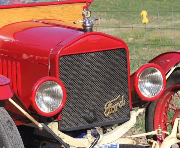

Got one on my speedster. This one came with a Model A cap and T era wings & Moto-meter.

Looks a lot like a Whippet or Overland neck.
