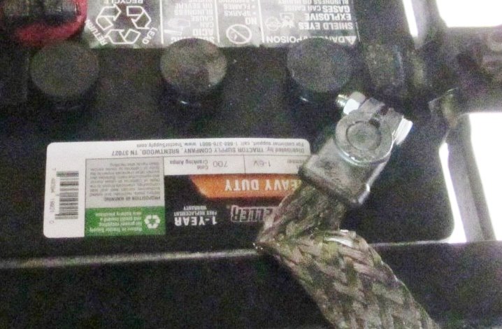

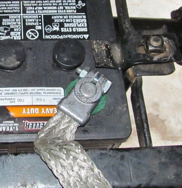

- Posts: 4046
Re: battery cable connection
David
Now time for me to eat some crow
Just today decided to replace the battery in Lizzie, it being 5 years old and wasn't responding to multiple re-charges well.
So the old negative cable was tried, had placed on the Ford way back in '86. And the contact inside the frame at the bracket was rusted and didn't seem good, so opted to go the route of placing a new negative woven cable on the outside of the frame. Made sure to have shiny frame area for contact, and mounted the new woven cable from the favorite T parts supplier!
All fastened down now and ready for check and then start the T.
If you look now that negative terminal is squeezed so tight and even bent.....and the terminal was still loose!
Could lift it right off and there was no more travel to the bolt and nut. Seems the new negative woven cables must be metric or China measure......too big just like your problem!
So, took the cable to the bench vise, and filed the lead surfaces from both side of the open lugs of that terminal.
Now! The terminal is tight, as the filed off surface allows the clamp to travel enough to pinch on the battery post as it should
So learned a NEW one today......watch out for woven negative cables with over sized terminals
