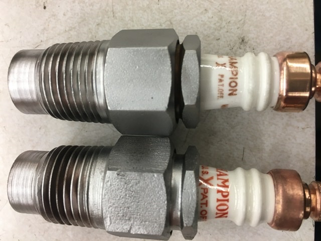

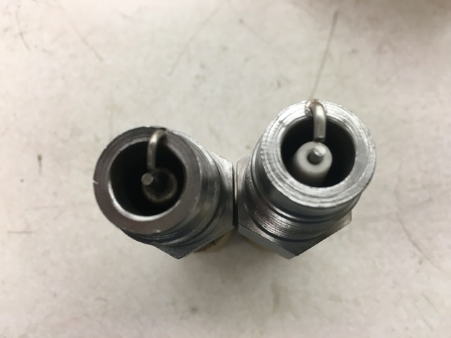

I have two different styles of Champion X spark plugs. The style that appears to be of older vintage has the ceramic .285 below the face. The other is only .105. Would these be two different heat ranges?
Keith

I believe what he is talking about is how much longer the exposed center electrode is on one plug compared to the other, and thus the difference in the height of the center porcelain below the end of the plug between the two plugs.
I am not even close to knowledgeable on spark plug theory, but due to some research on spark plug heat ranges in the last year or two I would SPECULATE that the heat ranges are different. I worked on a T that had a Z head and modern plugs. I had to put hotter plugs in it to make it reliable, not constantly cleaning the plugs. If I recall correctly the center porcelain was the main difference. Somebody more knowledgeable please correct me if I am wrong.

Yes Terry, That is my question. Is the plug with the ceramic.285 thousands down inside the base with more electrode exposed a different heat range than the one that the ceramic is only .105 thousands down and less electrode exposed?

The one on the left is a hotter plug, the right one allows the heat of the plug to bleed off into the head easier. The hotter the plug, the better suited it is for slow, laborous work as it burns off the carbon easier. Faster motors need cooler plugs.
