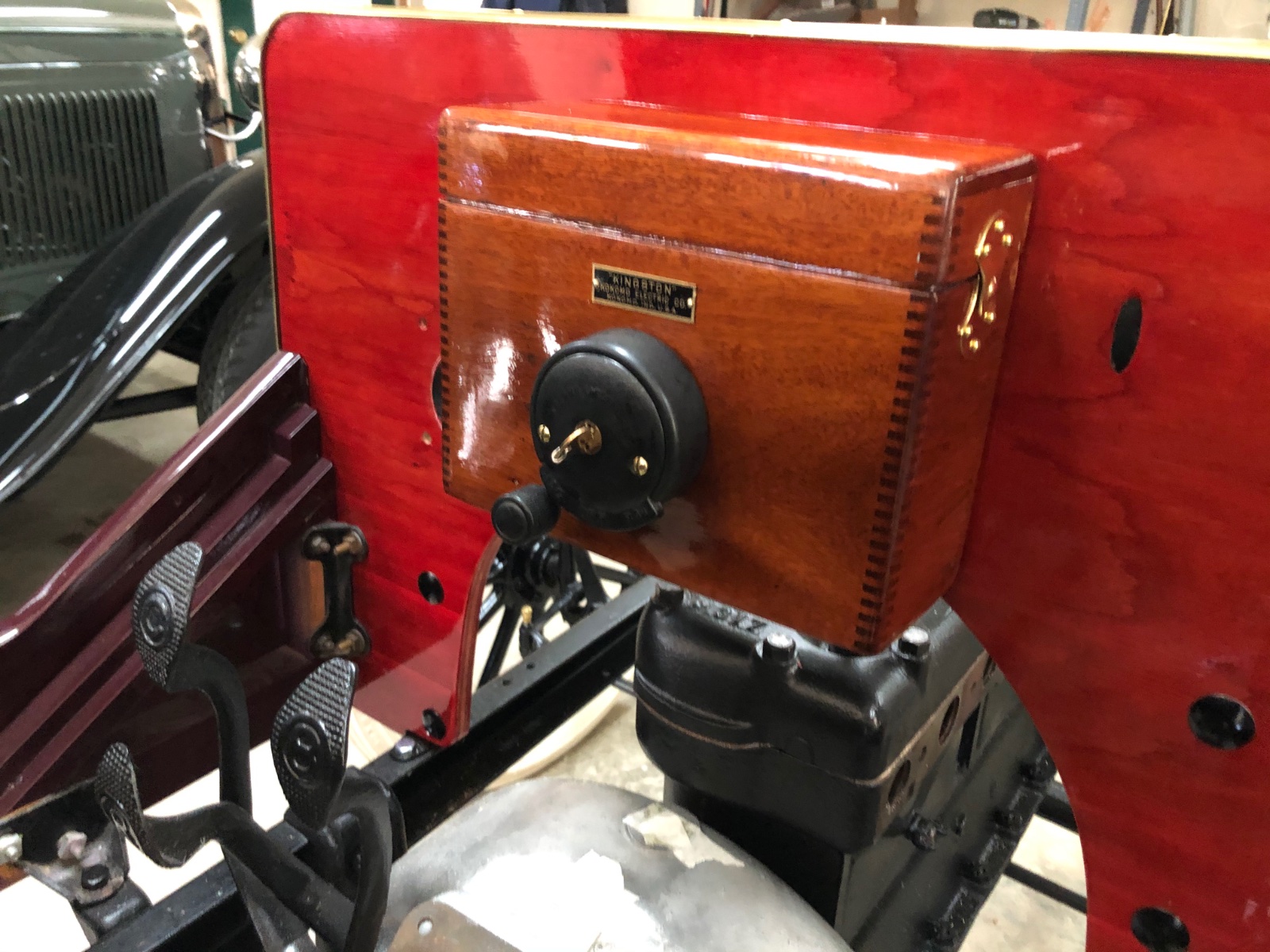

Post by Art Ebeling » Thu Nov 07, 2019 4:52 pm
I put the body back on the frame, installed the firewall and coilbox the timer. Art

Post by 1921coupe » Thu Nov 07, 2019 7:48 pm
Art, is that a ‘31 Vicky in the background of the last picture. I love them.

Post by Art Ebeling » Thu Nov 07, 2019 8:08 pm
Yes it is. Art

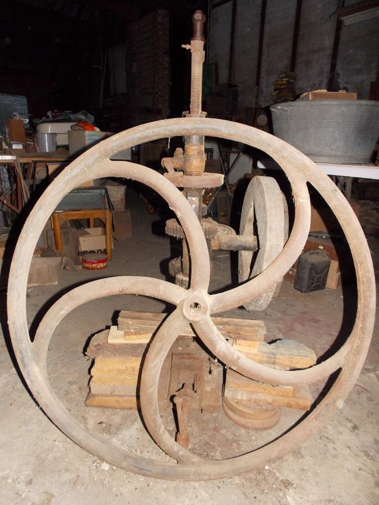

Post by AndreFordT » Sat Nov 09, 2019 9:46 am

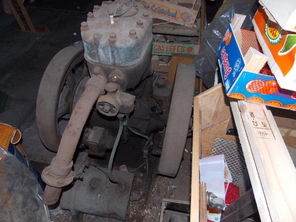

I didn't do much on T today but get these home for a future restauration.
A 1880 black smith drill and a 1927 5hp lister engine.
Andre
Belgium

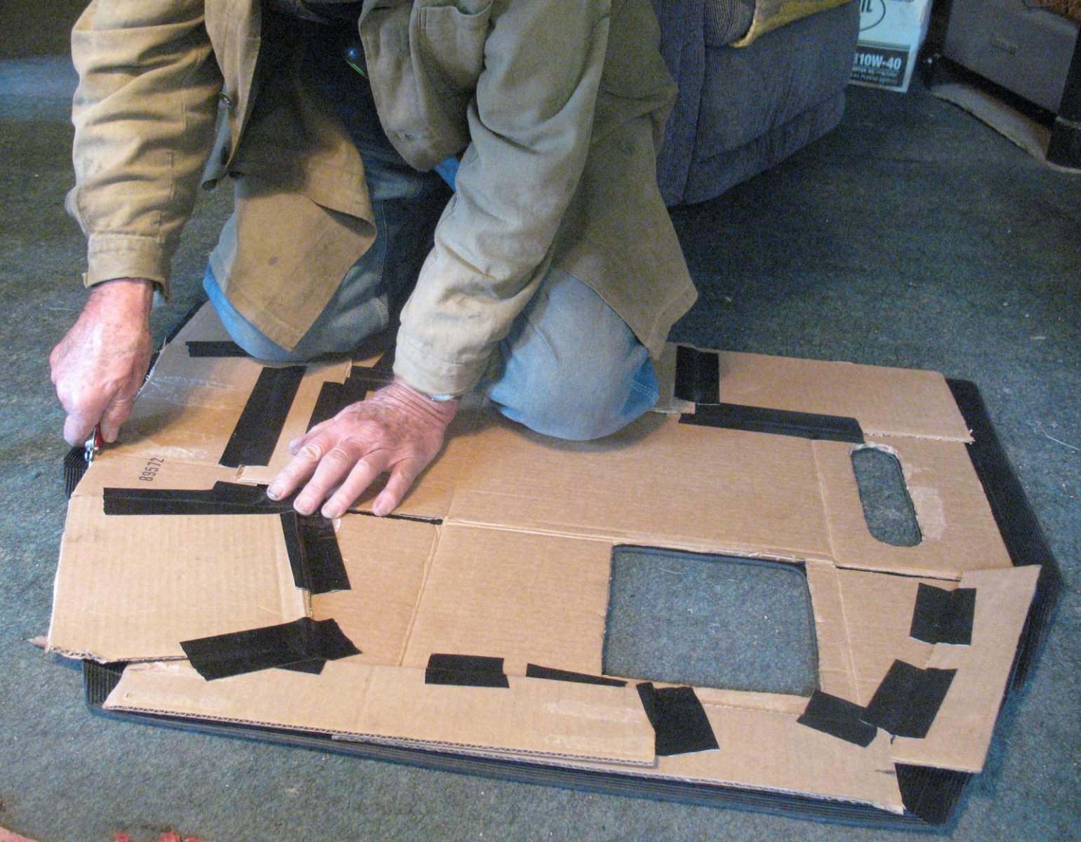

Lay on smaller pieces that fit the outer edges of the floor and tape them to the main body of the pattern.

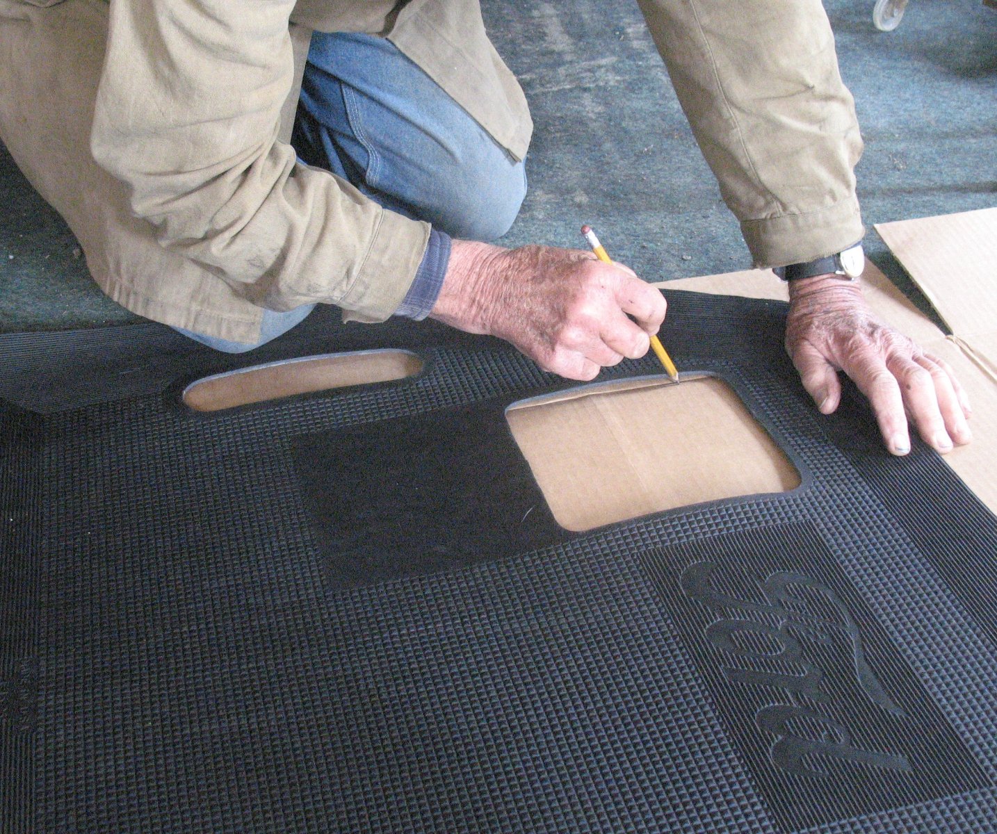

Align the pattern with the mat's pedal and lever holes and trim off the pieces of mat that stick out.

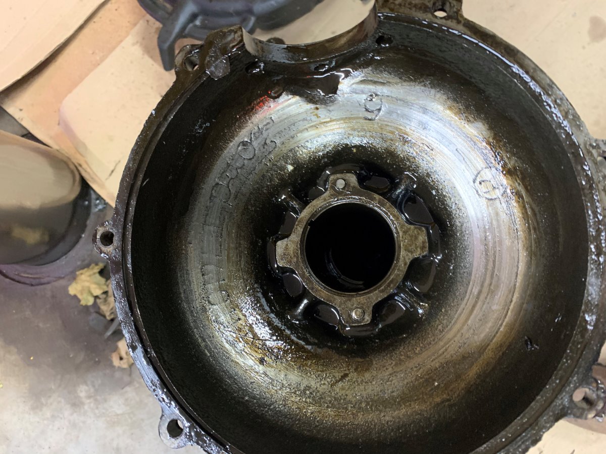

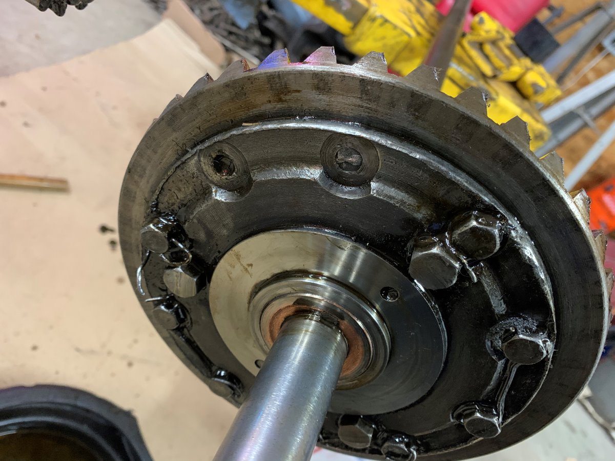

I pulled the rear axle out of my 26 Roadster and tore it apart. It's going to need a little bit of work. This is my first rearend rebuild.
Scott C.
Posts: 837
Last Name: Clements
Location: Waynetown Indiana
Re: What have you done with your T in November ?
Post by Scott C. » Tue Nov 12, 2019 1:47 am
The old babbit thrust washers were intact. I think that some one must have replaced them at one time.

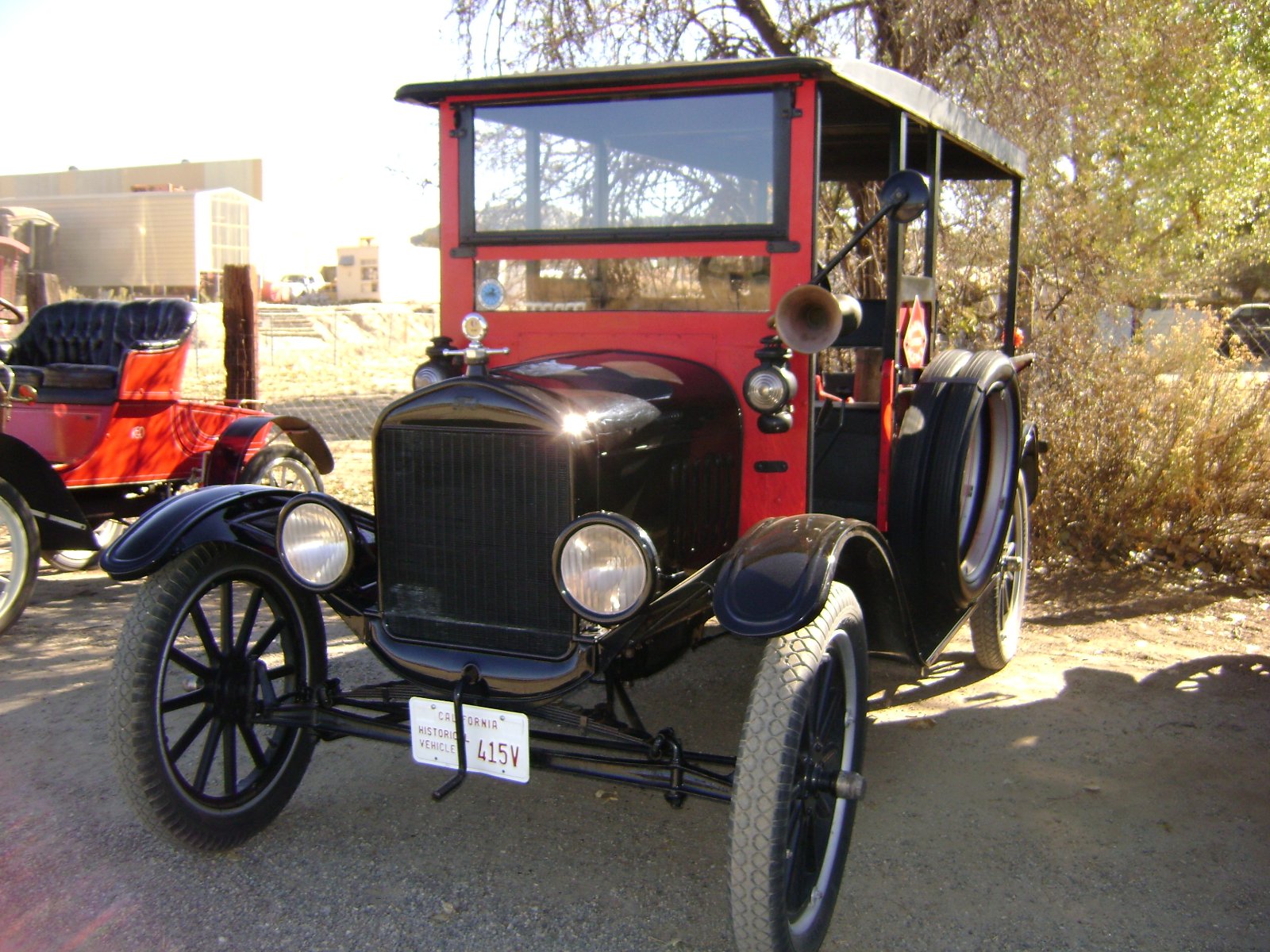

Saturday, the Model T Ford Club of San Diego drove up to the Railroad museum in Campo Ca. There was a ceremony for the 100th anniversary of driving the gold spike which completed the railroad between San Diego and El Centro. This railroad was named, "San Diego and Arizona Eastern Railroad" It dipped down into Baja California, Mexico through Tijuana and crossed back to California between Tecate and Campo. This opened up the Imperial Valley to San Diego and the port of San Diego. It also made a very good route for rail transport between Tijuana and Tecate and greatly increased the economy of the northern Baja area. Today, the parts in the United States are in poor repair, but the line is still used for freight through northern Baja.
There were at least 500 people there and we had the Model T club and Model A club and Horseless Carriage clubs there with their cars on display between the entrance and the location of the ceremony so we had many admirers who looked and asked questions.

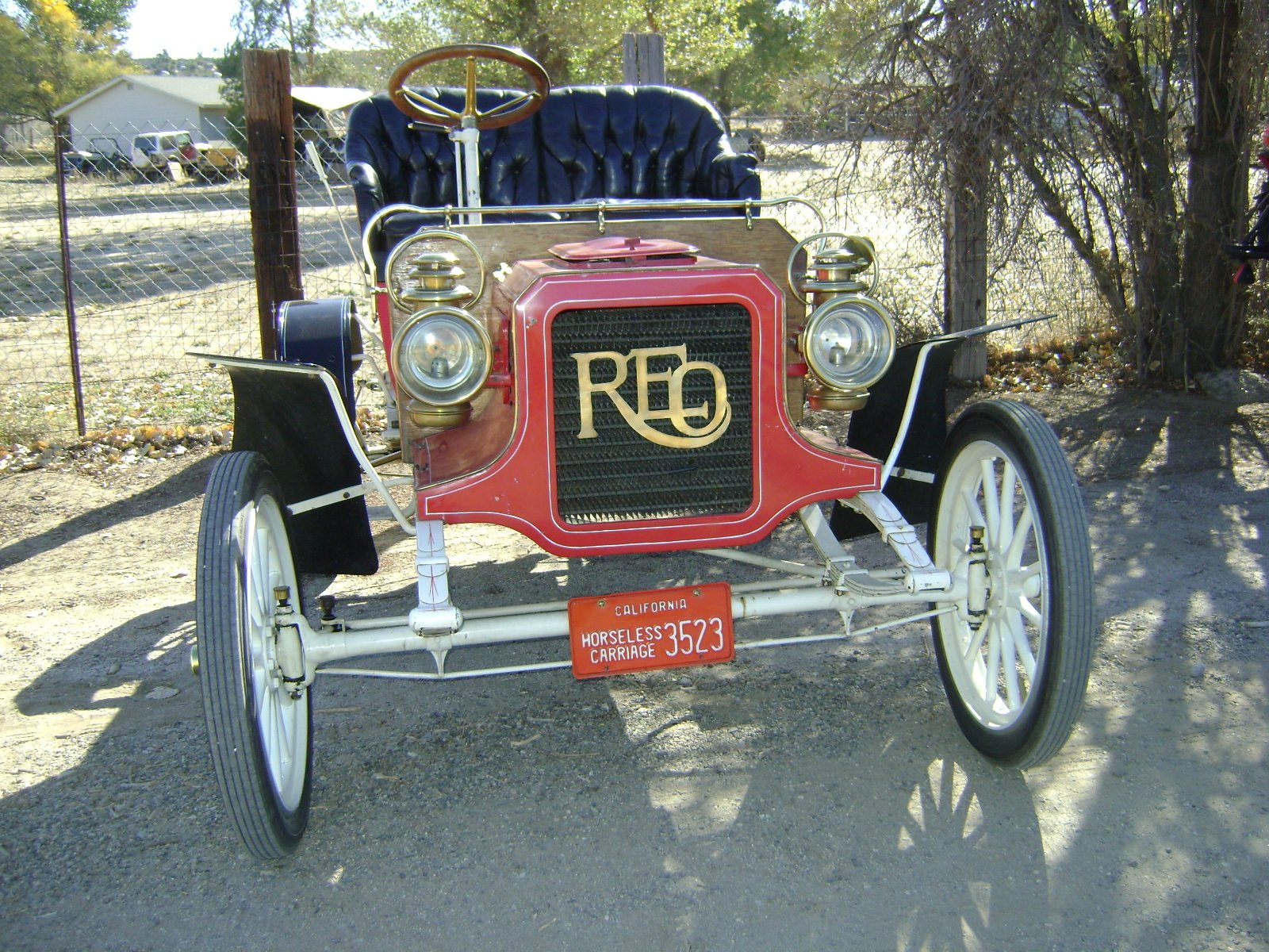

More pictures of Railroad tour

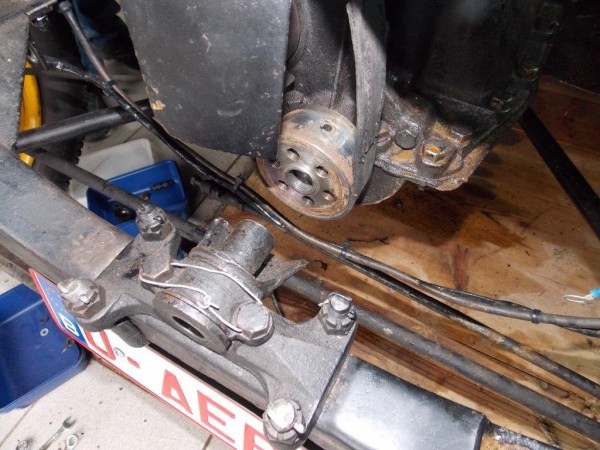

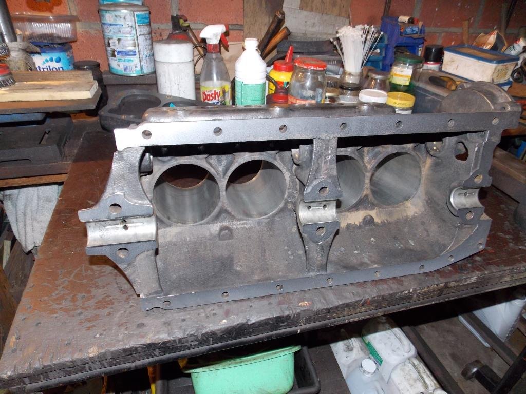

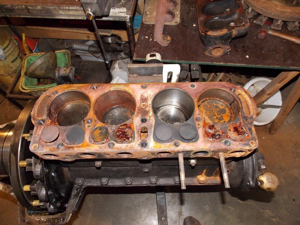

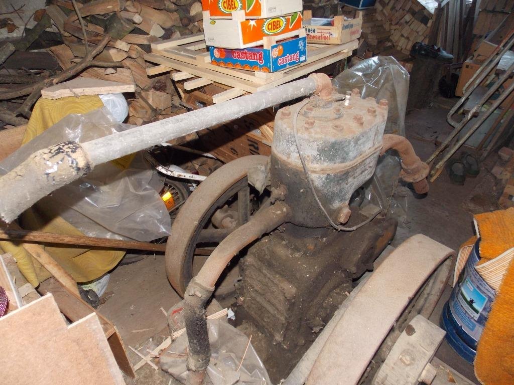

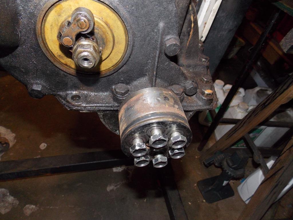

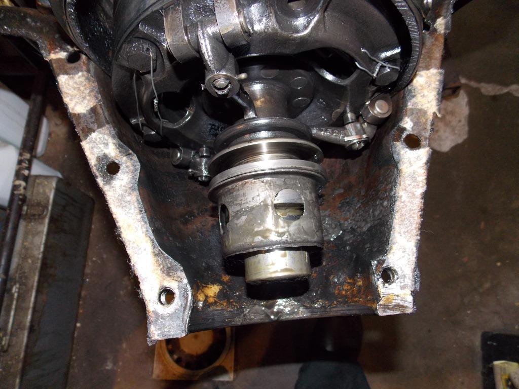

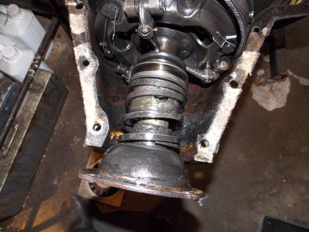

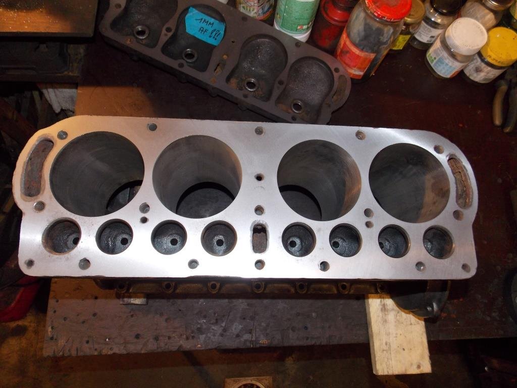

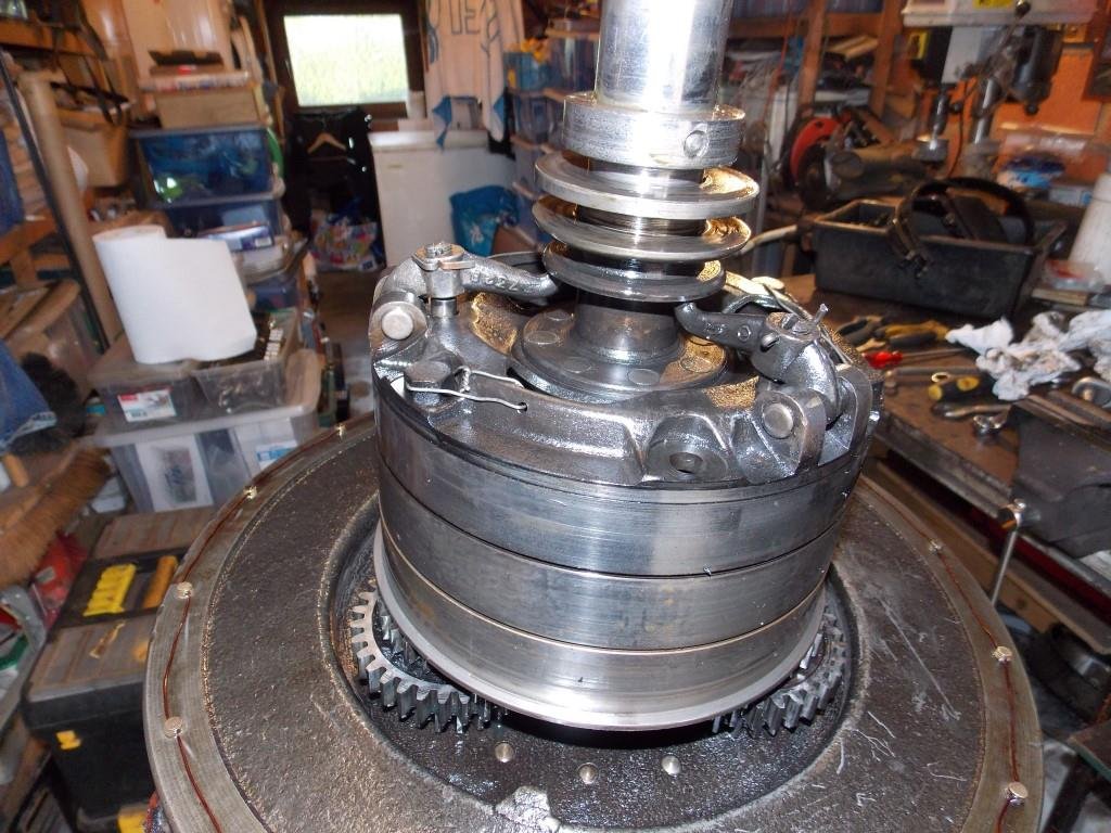

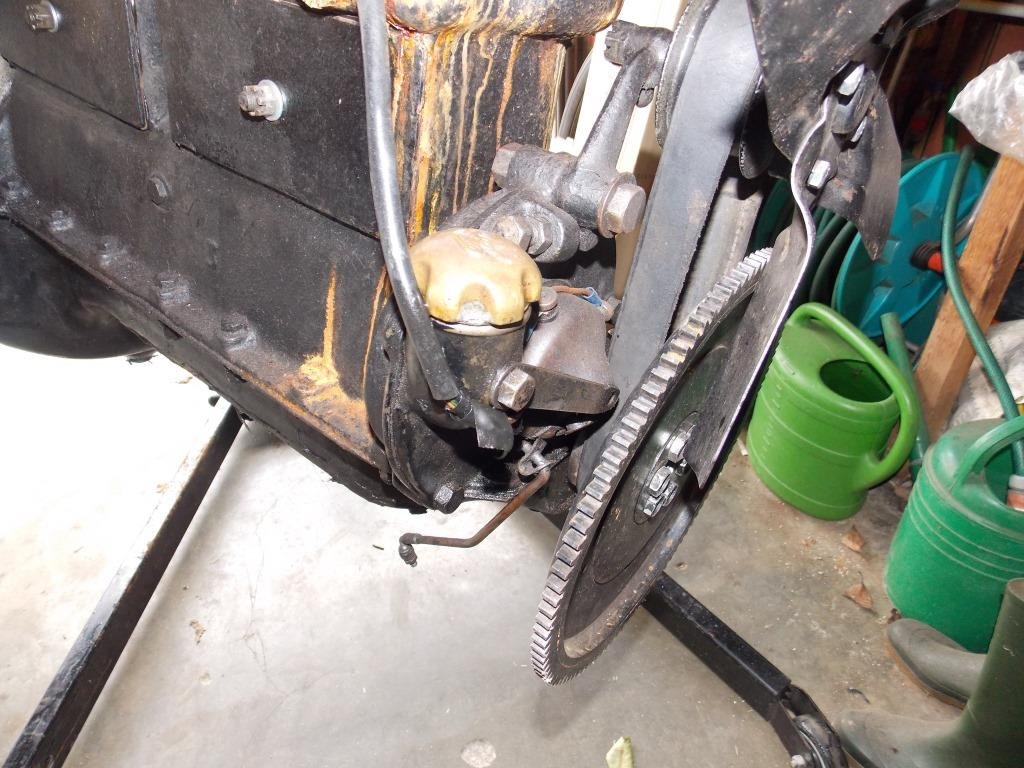

Last week I started the rebuild of a 1912 engine.
On the front there was a 2CV Citroën flywheel and starter build up.
To do this they cut off the nose in the front of the oilpan and build the starter in a support under the frame.

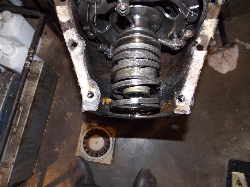

The transmission end had also a strange build up.

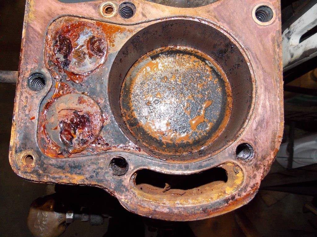

The cilinder head gasket was mounted the wrong way and water leaking in the cylinders. The engine was blocked and didn't run.
More photos in the next post

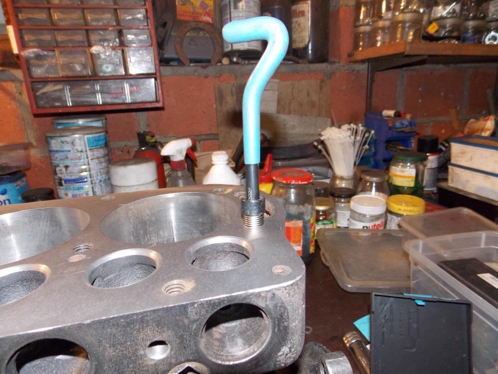

A few more photos.

Using the ball cap to maintain pressure on the clutch spring is the craziest thing I've ever seen :o
will it work? not for long!

Frank,
it didn't work at all.
Neither the starter or the transmission construction did work.
In August the phone rings: "Get your (my) name from a friend , can you please come and look to my T and try to make it run."
Just a good job for the cold winter days.
Engine is apart and clean.

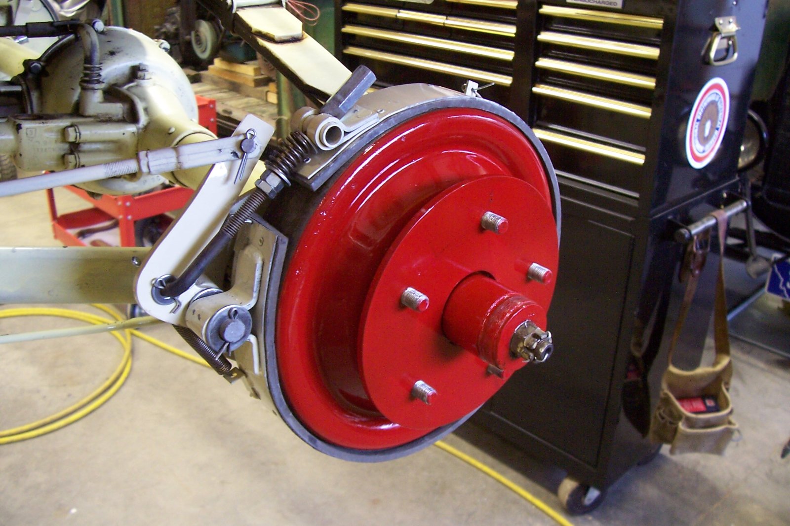

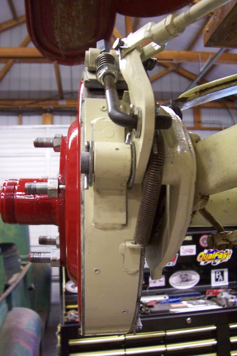

Got the Rocky Mountain brakes installed on my speedster. It might even stop now.

Pat,
It will slow down better but really stop ... . It is still a Model T.
Drive carefully and think three mistakes further to give you the time for an emergency stop if needed.
Keep it safe.

Yes, good advice. Thanks.

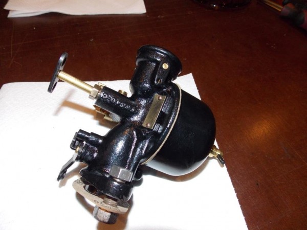

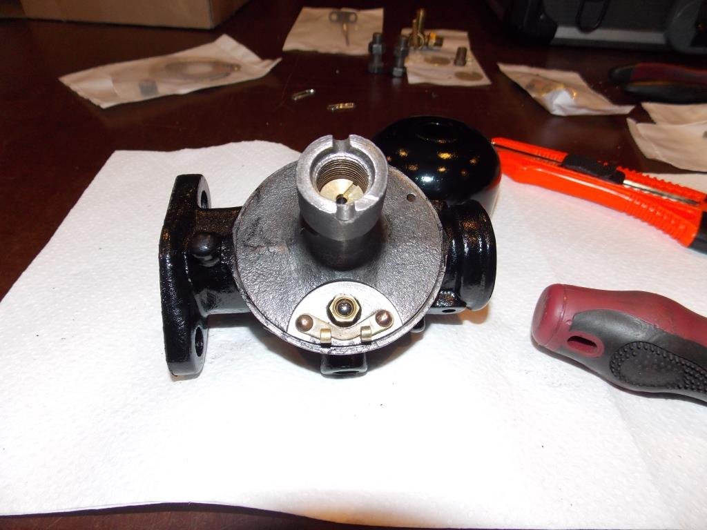

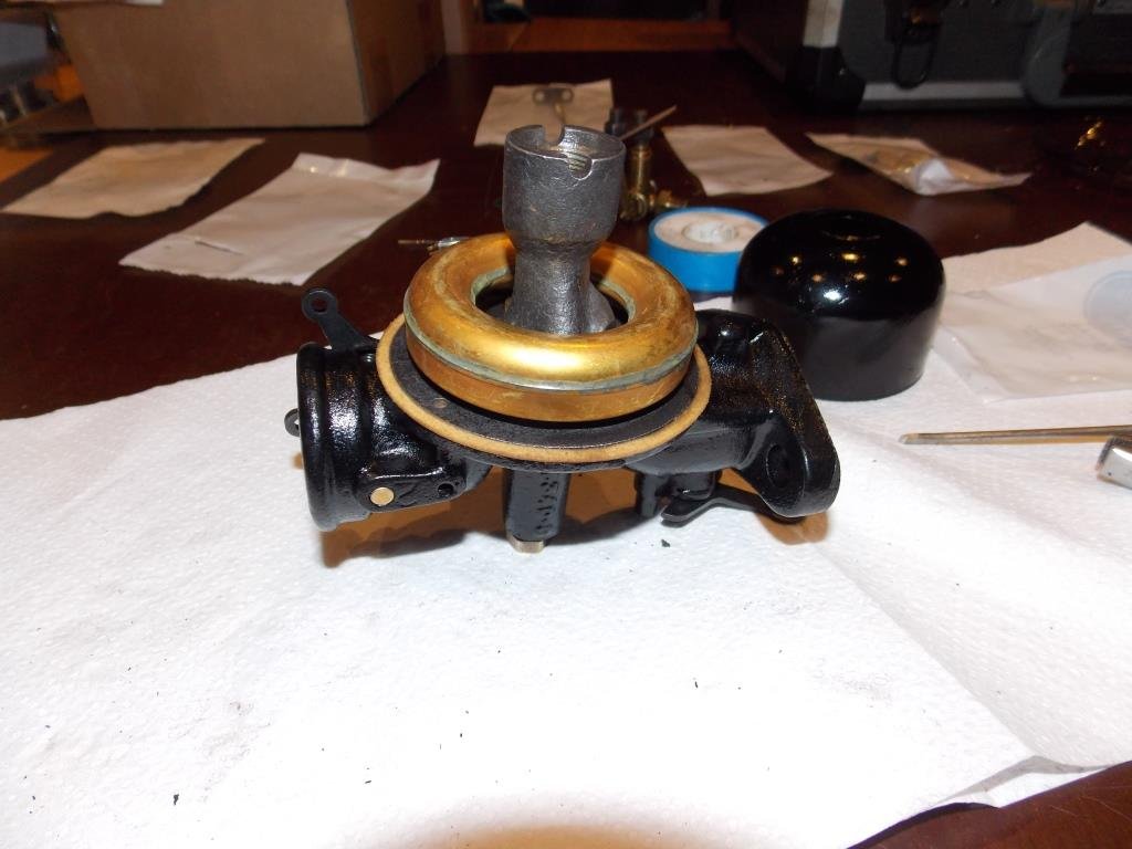

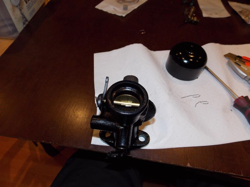

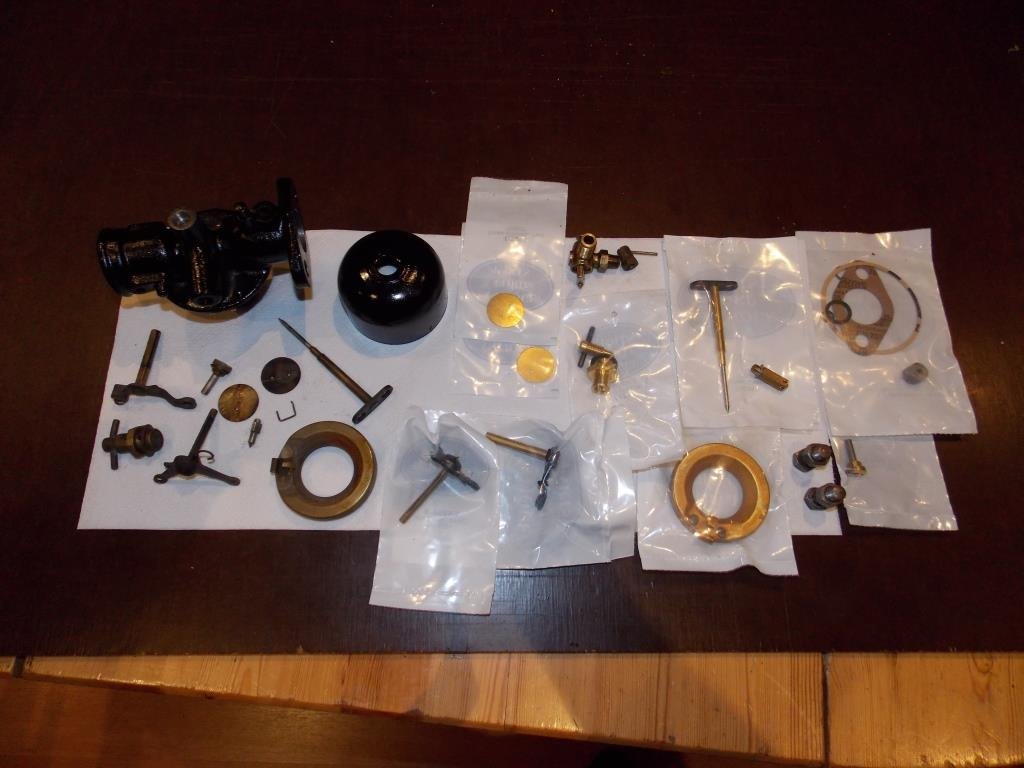

Just finished the rebuild of a NH carburetor this evening.

Render it semi-useless “fixing” it??? Hahaha

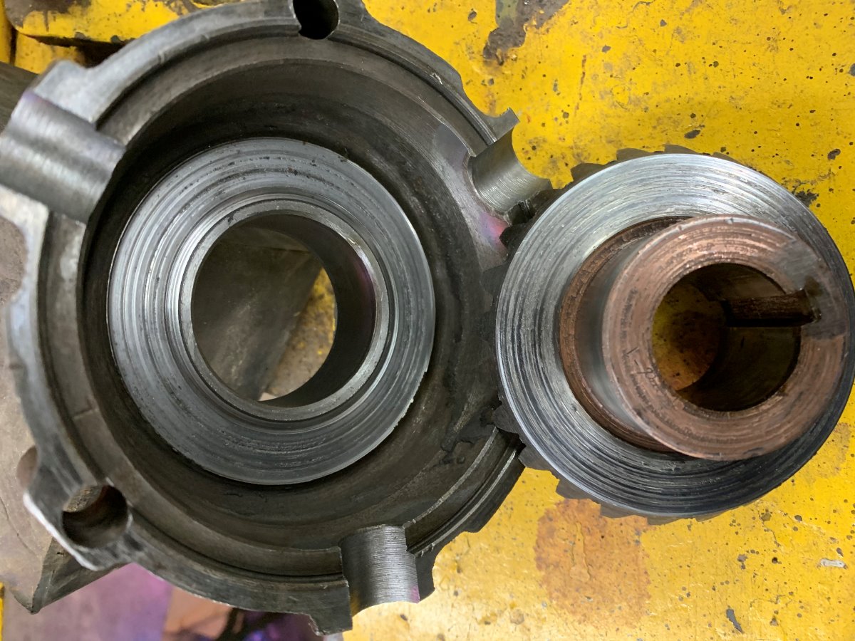

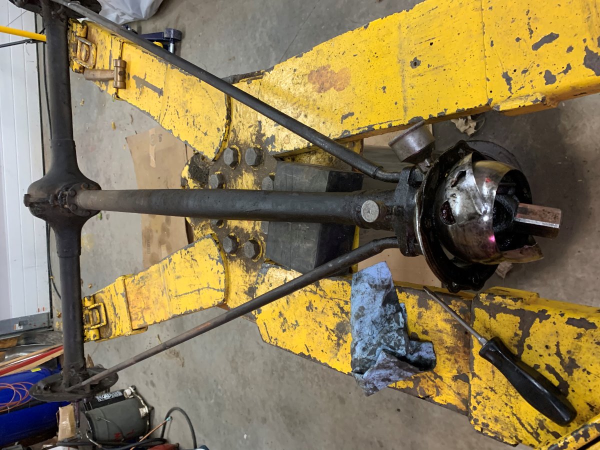

My Ruckstell is all scattered on my garage floor !! :o
Special thanks to Mr Morsher and Mr Andulics for the manuals and another thanks to Tim for inspecting things and assuring me most of my parts looked useable !! :D
Good thing since I sold him all my pieces ! :lol:
Time for some degreasing... :P
