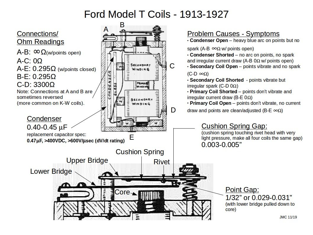

- Posts: 5497
Re: coil point arc
http://www.mtfca.com/discus/messages/33 ... 1364507902
Ignore the spring cushion gap and stick with Fords recommendation.

thanks for the coil diagram as I will check the points gap and inspect them from pitting.
