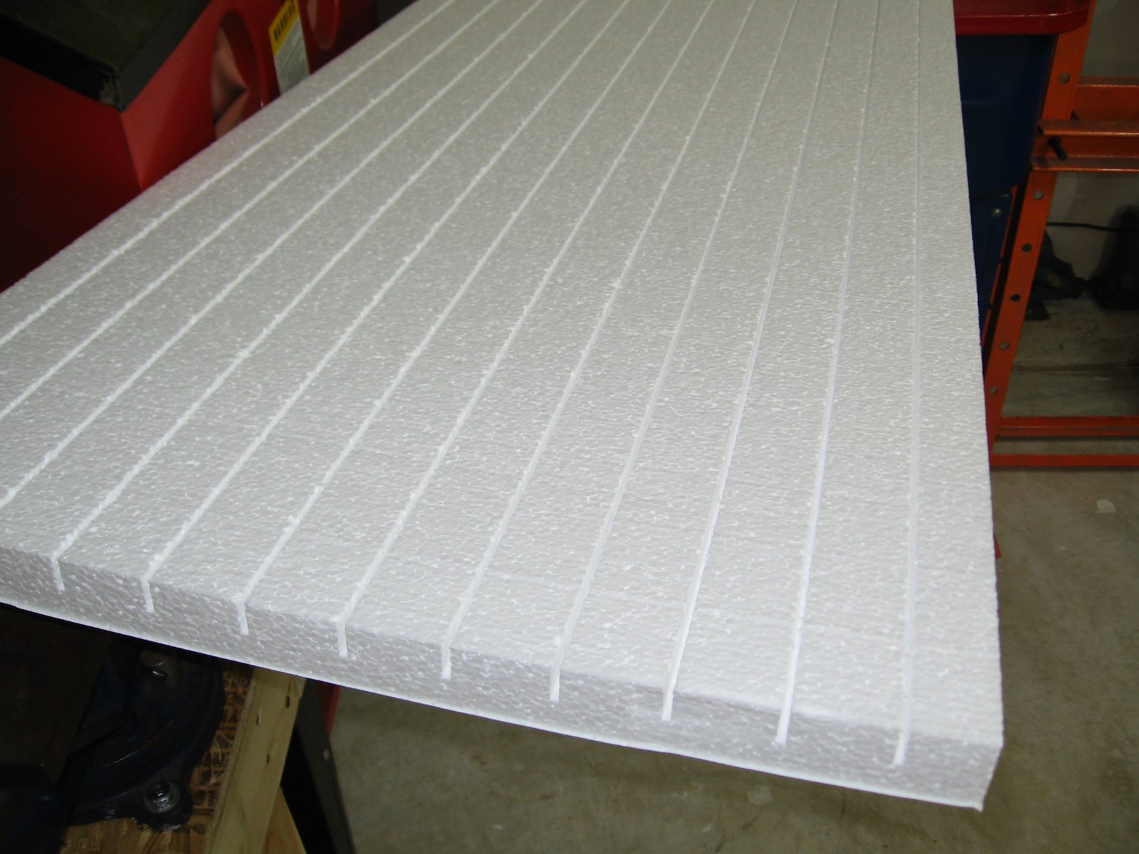

I have a smaller garage only 600 square feet, I have 4” of ridgid styrofoam under my concrete Floor with water lines ran 12”on center, poured in the concrete. Their is an on demand boiler running a glycol/water mix through the lines. It’s an amazing way to heat the garage, the concrete holds the heat well, I just have a bathroom fan running to remove the gas fumes (seems to work ok)I’m not sure if I’ll do it again as it wasn’t cheap, but nice. I live in Edmonton so it can get fairly cold in winter. It obviously wouldn’t work for your large shop as you already have the floor poured, but it is a nice heat.

Brilliant. I think you and Les win! If I ever have to pour another garage/shop floor, this is the hot ticket.Hippie wrote: ↑Fri Nov 29, 2019 11:09 pmI have a smaller garage only 600 square feet, I have 4” of ridgid styrofoam under my concrete Floor with water lines ran 12”on center, poured in the concrete. Their is an on demand boiler running a glycol/water mix through the lines. It’s an amazing way to heat the garage, the concrete holds the heat well, I just have a bathroom fan running to remove the gas fumes (seems to work ok)I’m not sure if I’ll do it again as it wasn’t cheap, but nice. I live in Edmonton so it can get fairly cold in winter. It obviously wouldn’t work for your large shop as you already have the floor poured, but it is a nice heat.
