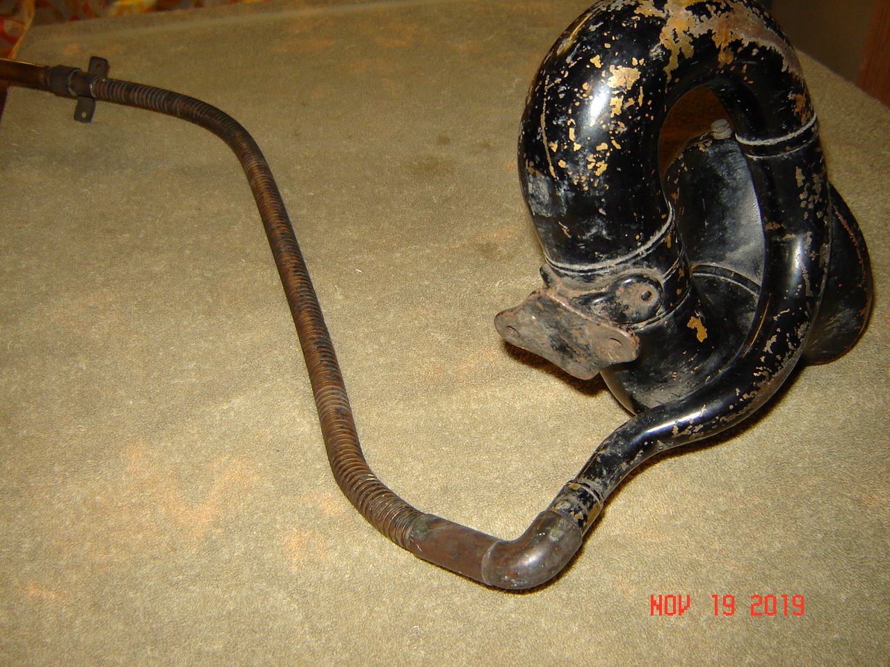

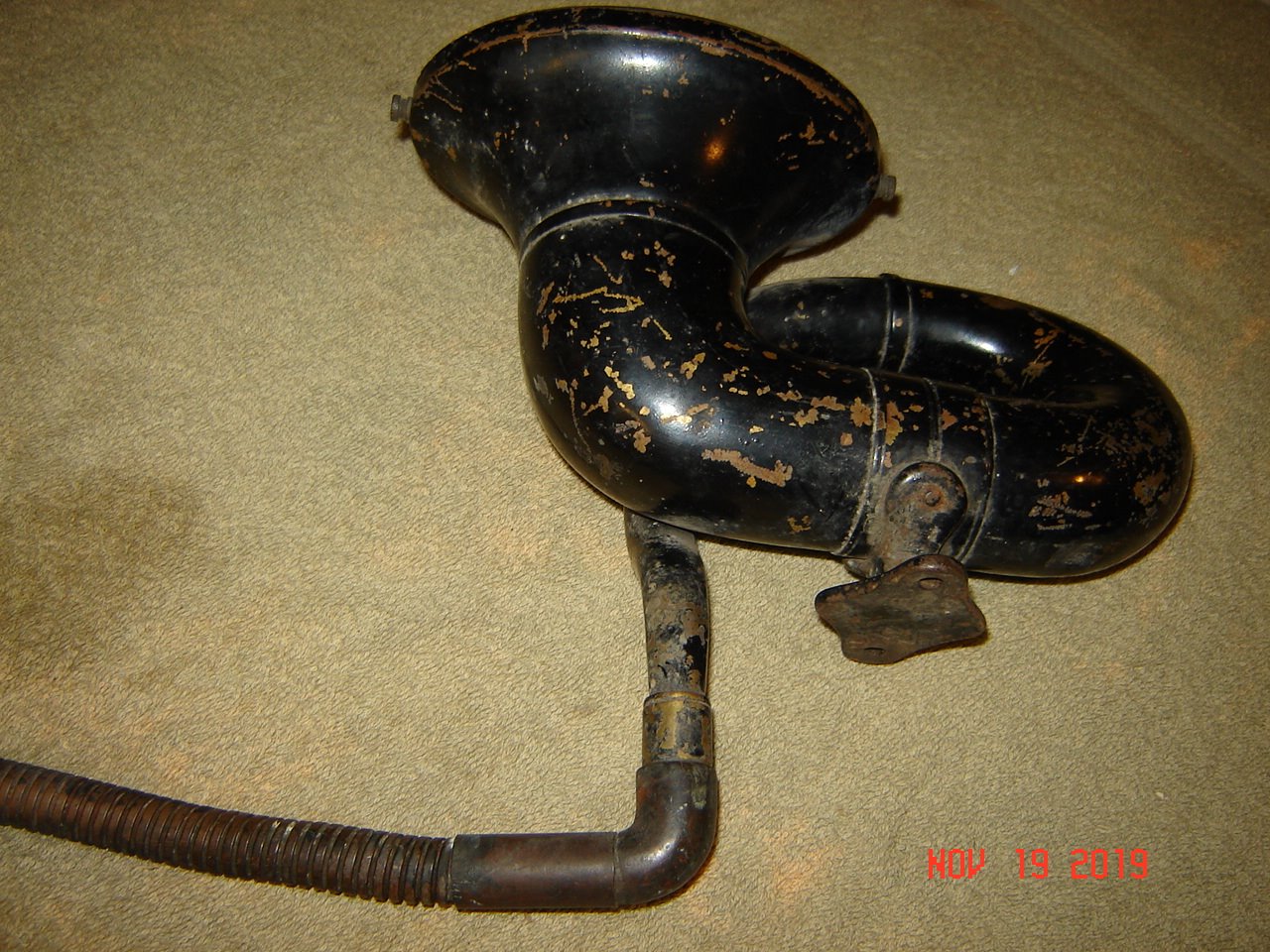

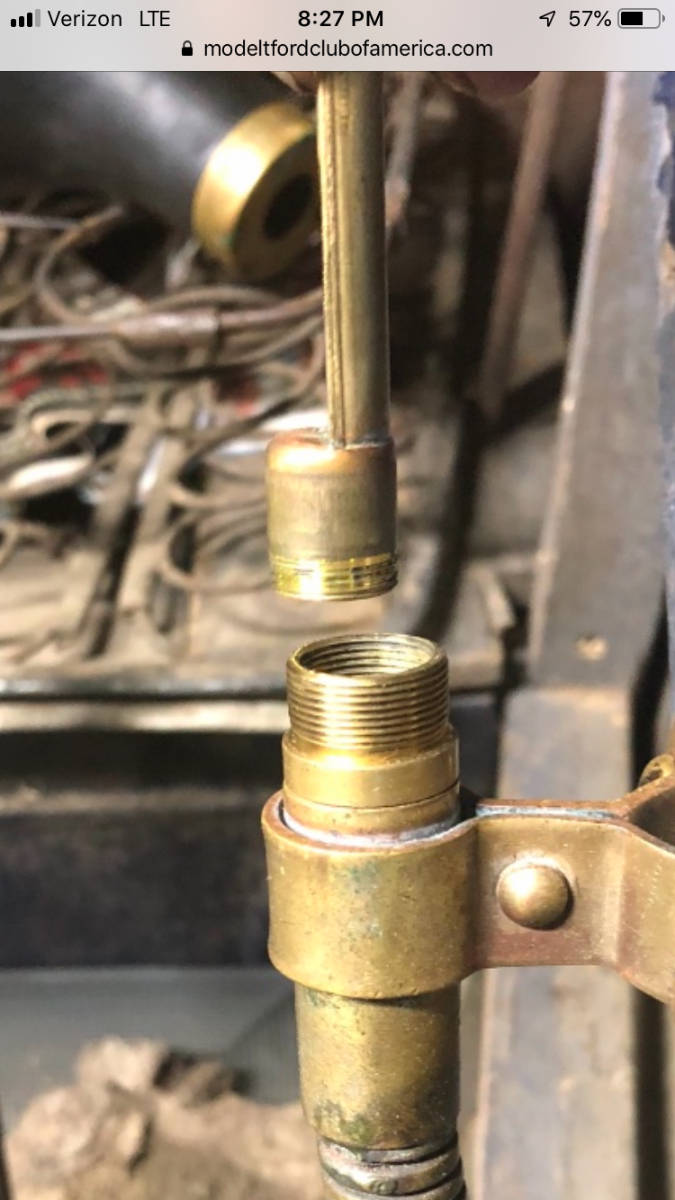

Post by Corey Walker » Tue Nov 19, 2019 9:34 pm
Here are some pictures. You can see the scalloped mounting bracket, also the 90 degree elbow that screws on instead of the straight tube used previously. The 1915 bracket is different than previous years as well. There is a brass tube not pictured that covers the reed and holds the bulb.

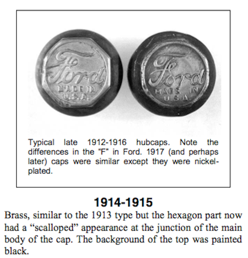

Post by Original Smith » Wed Nov 20, 2019 10:53 am
There are two styles of high F hubcaps. 1913, and 1914-17. The 1917's are nickel plated. The 1913 hub cap is very much like the 1914 style, but the F is much larger and bolder. It takes some practice to get used to the two styles.

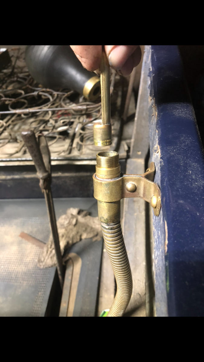

Post by Steve Jelf » Wed Nov 20, 2019 1:41 pm

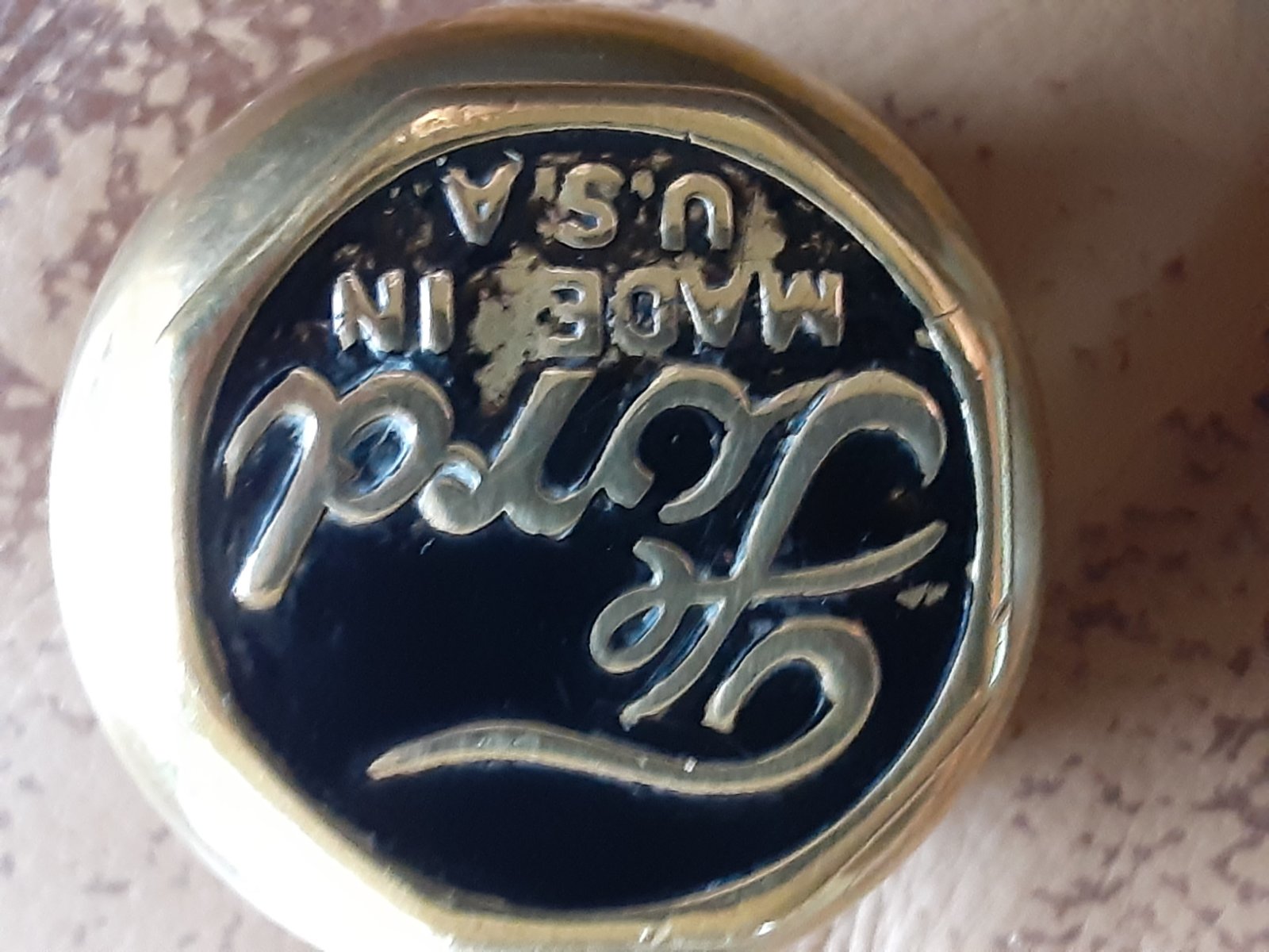

Assuming that what you propose to do is possible, I expect it will be ungodly expensive. I would leave them be as Colin suggests or go with the brass caps available from the parts dealers. If you insist on exactly the right caps, go with these while you look for them. Most people, even Model T people, won't know the difference.

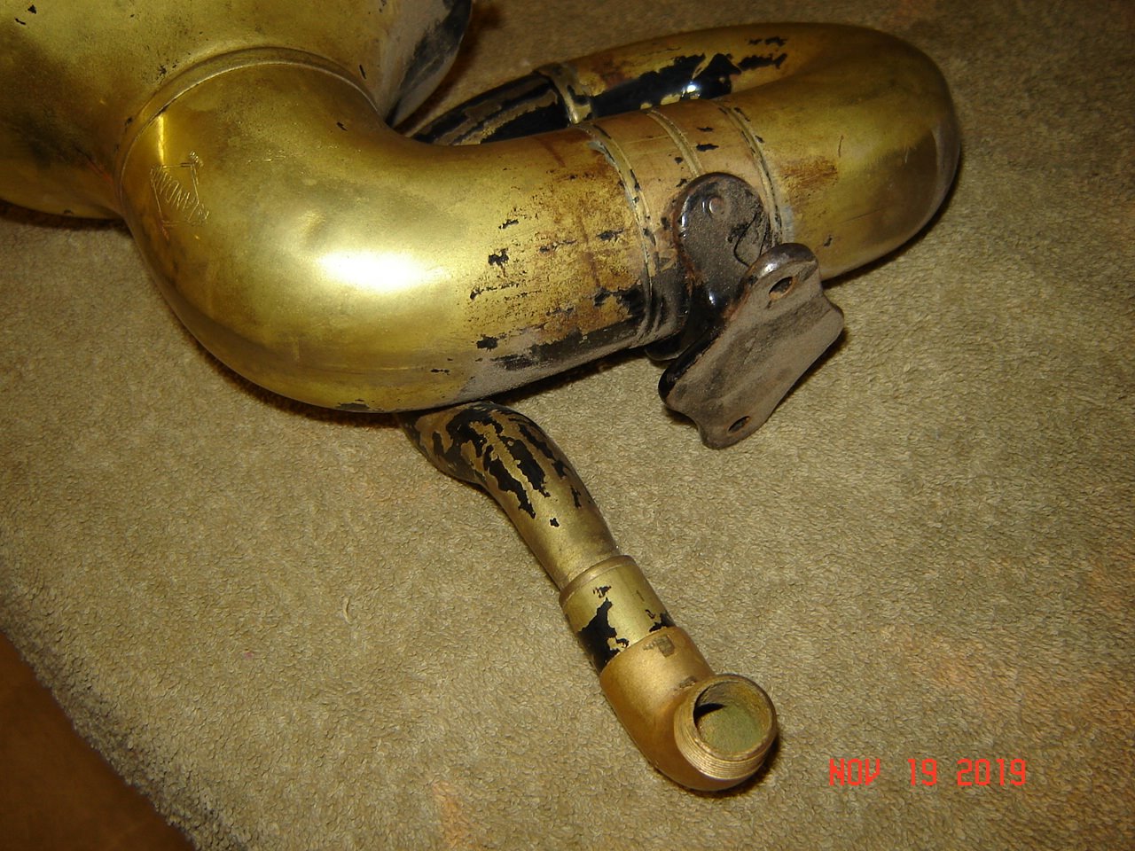

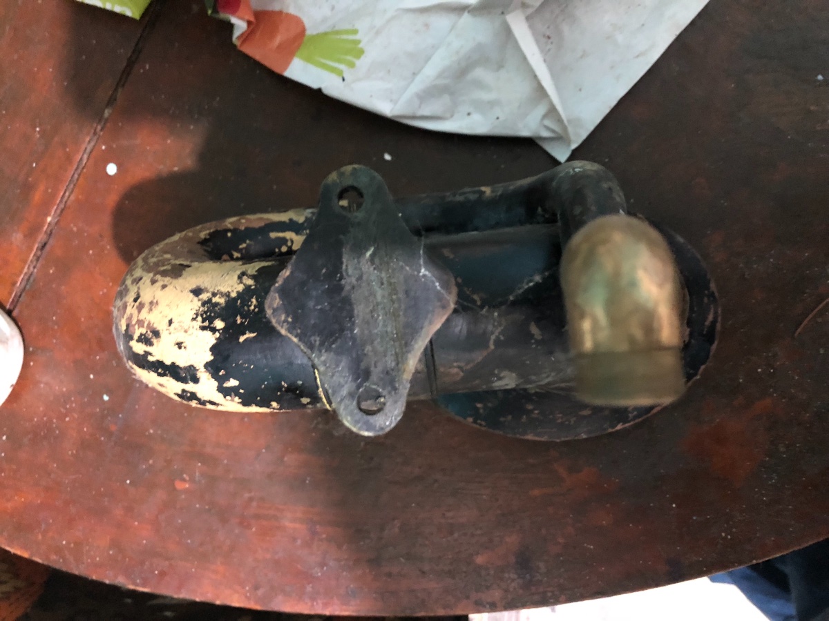

Post by Jim, Sr. » Wed Nov 20, 2019 9:58 pm
The 1915 horn does not need to be a Rubes horn. Standard and Nonpareil also supplied the bulb horns to Ford. These two horns were made by Standard. The black horn pictured has a reed, and is actually quite loud.

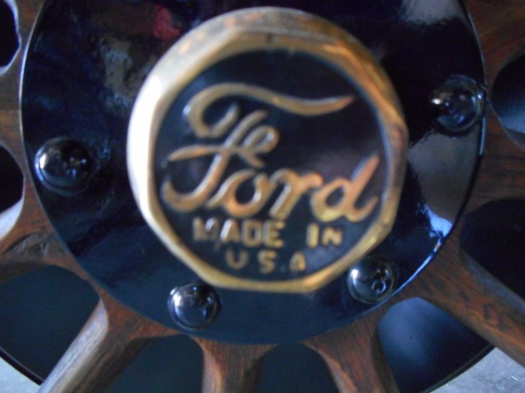

Post by Original Smith » Tue Dec 03, 2019 12:05 pm
Those hubcaps are easy to get confused on, especially the difference between a true '13 and '14. Keep in mind, Ford had different suppliers for those. The depth of the octagon can be different. I probably have more 1913 hubcaps than anyone, and there are differences among them. For anyone interested, the "F" in the script is much bolder than the '14-'16 caps. The '16 style was carried over into '17, as I have nickel plated examples of those too. The easiest way to tell is to put a '13 hubcap next to a '14, and the difference will be apparent. I have the '14 style hubcaps on my 1915, but don't have any photos of them.
