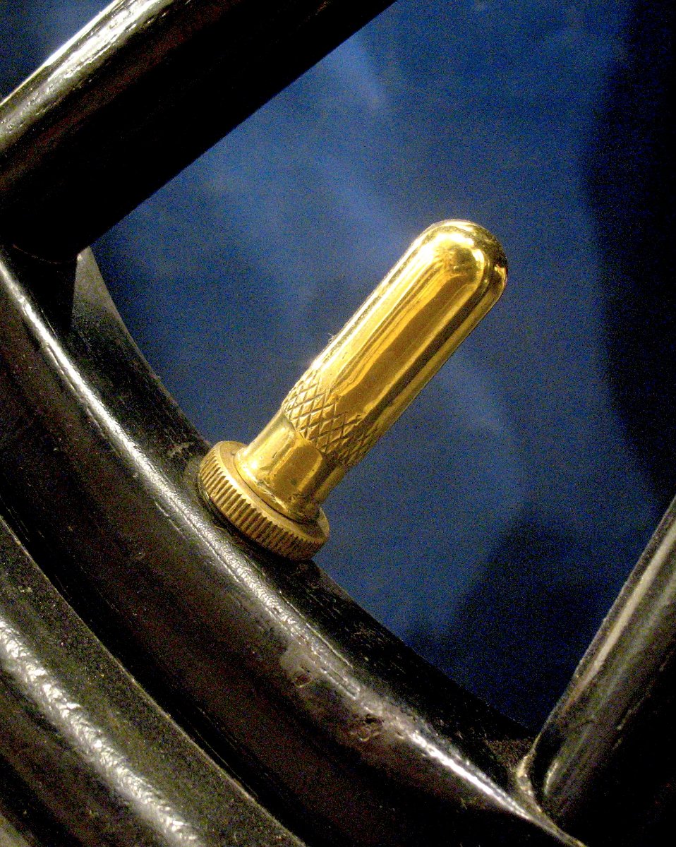

...always pay the money and get brass stems!
I save $10 to $13 a tube by getting rubber stems, cutting them off, and installing metal ones I've picked up at swap meets for $1 or so.

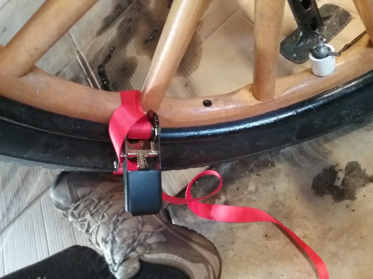

I always start at the valve. I use a non-hook ratchet strap to hold everything in place (no damage to a wood felloe) and use some really old tire irons that are about 18" long and a Harbor Freight rubber mallet.
In fact, I bought a HF canvas tool bag and have the jack, tire irons, mallet, tube, and everything I would need to fix a flat in one neat, tidy package.

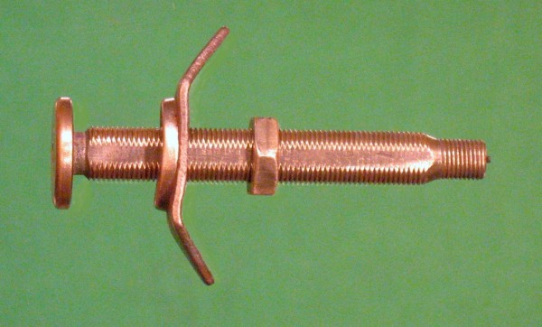

What I've been using for years is a special wire that looks like a modern speedometer cable, with a nub at one end that screws onto where the valve cap goes, and has a Tee handle at the other end. What I did this time to hold the tube in place is a rim nut screwed in upside down into the felloe. It keeps the valve stem centered while mounting the tire to the rim. This backs up what Adam said earlier.

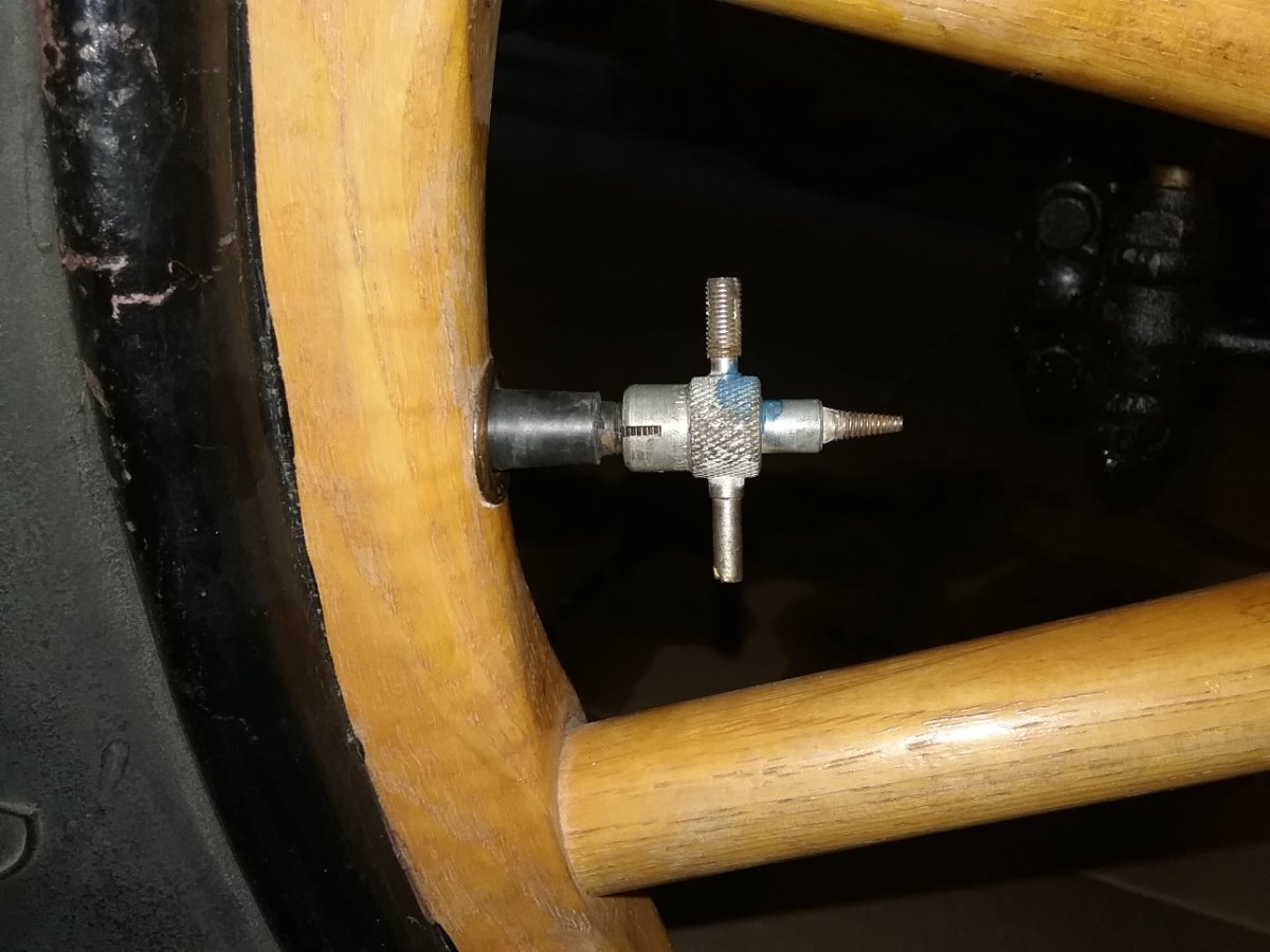

I have & use one of them "antique" valve stem holders Larry !

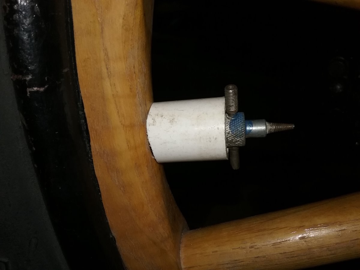

I use a tool like this
https://www.ebay.com/itm/Valve-Stem-ins ... SwxH1UJ3zS
The long end screws onto the valve stem and I use a piece of wire around the T end to pull the stem through the fellow and wrap the other end of the wire around the axle nut to keep the stem in place.
I have an old rusty one that I have had for years and recently bought one at Autozone

I believe that tool was designed to pull tubless tyre valve stems into the rim. It sure works well for that. It is also handy when installing truck tyres and the various stem configurations used on those. I have never had the occasion to use it on a T, but then I have never mounted tyres on wooden felloe rims which may require the stem be held in place.
Topic author - Posts: 3913
- First Name: Larry
- Last Name: Smith
Re: Mounting A Stubborn 30 x 3
Yup! That is the tool. Can't own a T without one. Like Steve said, I'm glad they are still available.

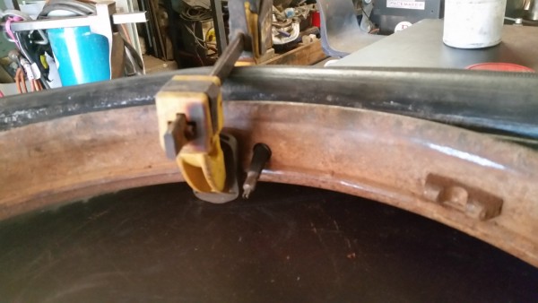

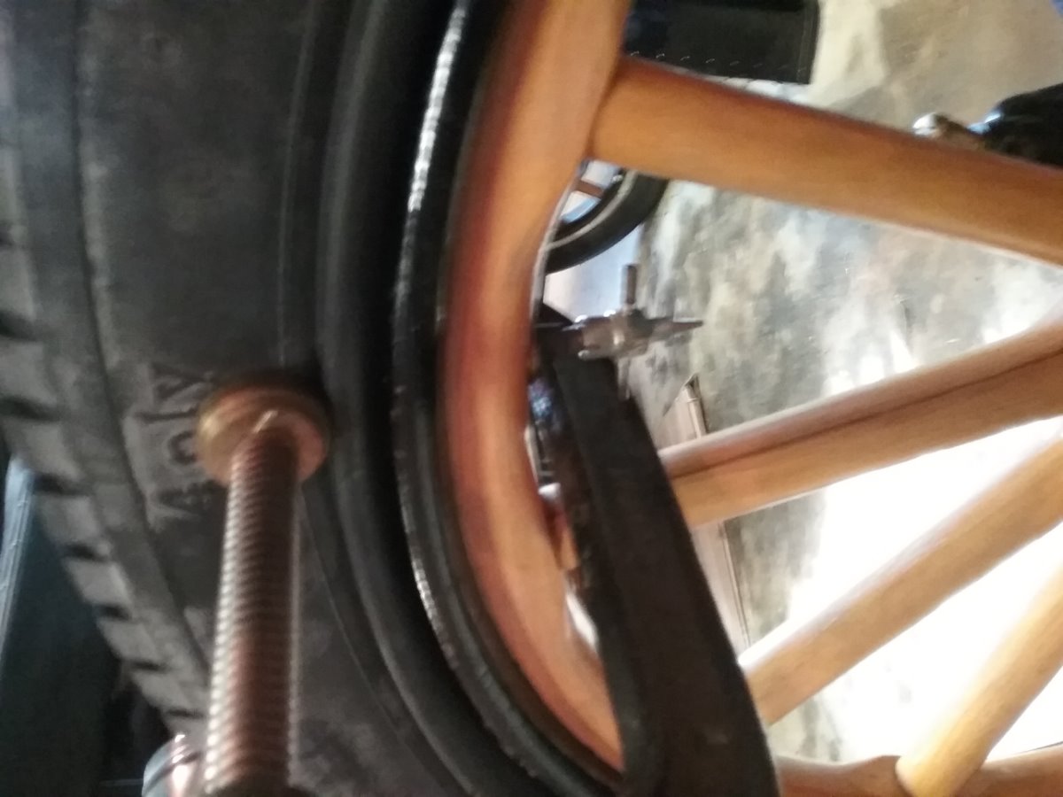

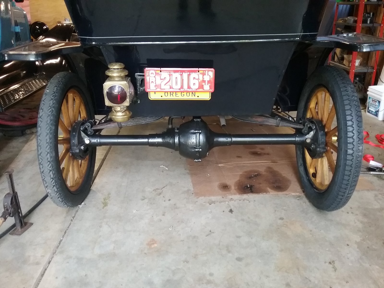

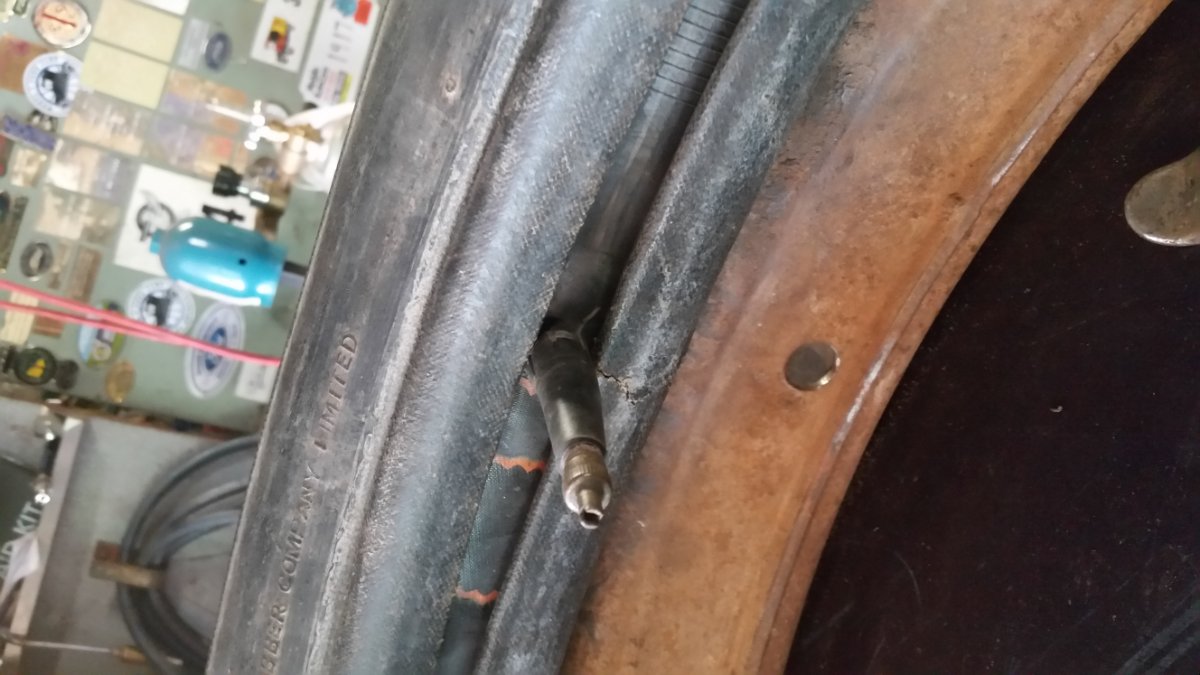

Here is what I did for mounting Excelsior tires on my non-demountable wheels:
Using the current rubber stem tubes, I was not able to get the two beads and stem inside the rim. So I notched them, like the old days.
I used my tire valve stem tool to hold the valve stem in place and used a big C-clamp to get the beads and stem in the rim.
I then put the stem at the bottom of the wheel and using the stem tool to told it in place, lower the jack jest enough so the wheel does not spin.
I then use a piece of pvc pipe to put some tension on the rubber stem and hold it in place.
I seated the bead a short distance away from the stem, then put on a short strap so the seated bead would stay in place. The strap is kind to the wooden felloe. I then went the opposite direction then seated the rest of the tire. I use some old tire irons that are about 18" long, and a rubber mallet that I picked up from Harbor Freight.
There was a definite learning curve, and it would have been much easier with an extra set of hands! The first tire took me about 45 minutes to mount.by the time I got to the fourth tire, it took me about 10-15 minutes!

Where did you find rubber stem tubes that fit through the opening in the felloe? I haven't seen anything since Schraeder made them that works!
- Posts: 7399

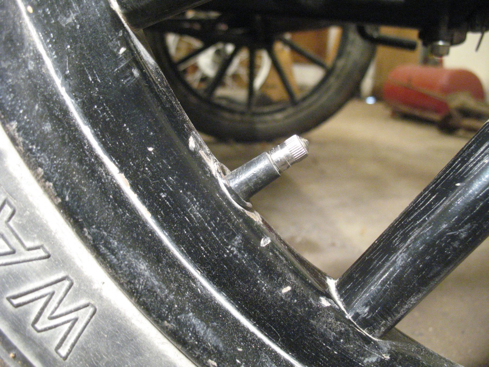

When I had a flat in September I installed a rubber-stem tube with no trouble. It's a Hartford. The wheel is by Noah Stutzman. I don't know if he makes the holes larger than original.
Larry-
When Jim Kanne rebuilt the wheels, (before my time) I believe he used a larger sized ferrule in the hole in the felloe for the valve stem. I believe the rubber stem tubes I am currently using are Hartford. If I had original metal stems, I could use the valve stem nuts to hold the stem in place instead of the PVC pipe and valve core tool.
Pete-
I've seen video of the garbage bag method, but have never tried it. I'm glad Mary was able to help you. A couple of extra hands really makes a difference. I had Spencer help me mount some 30x3-1/2 demountables, but when I was doing the non-demountables by myself, I relied on the strap!
IMHO, the 30x3-1/2 are easier to mount than the 30x3. YMMV
