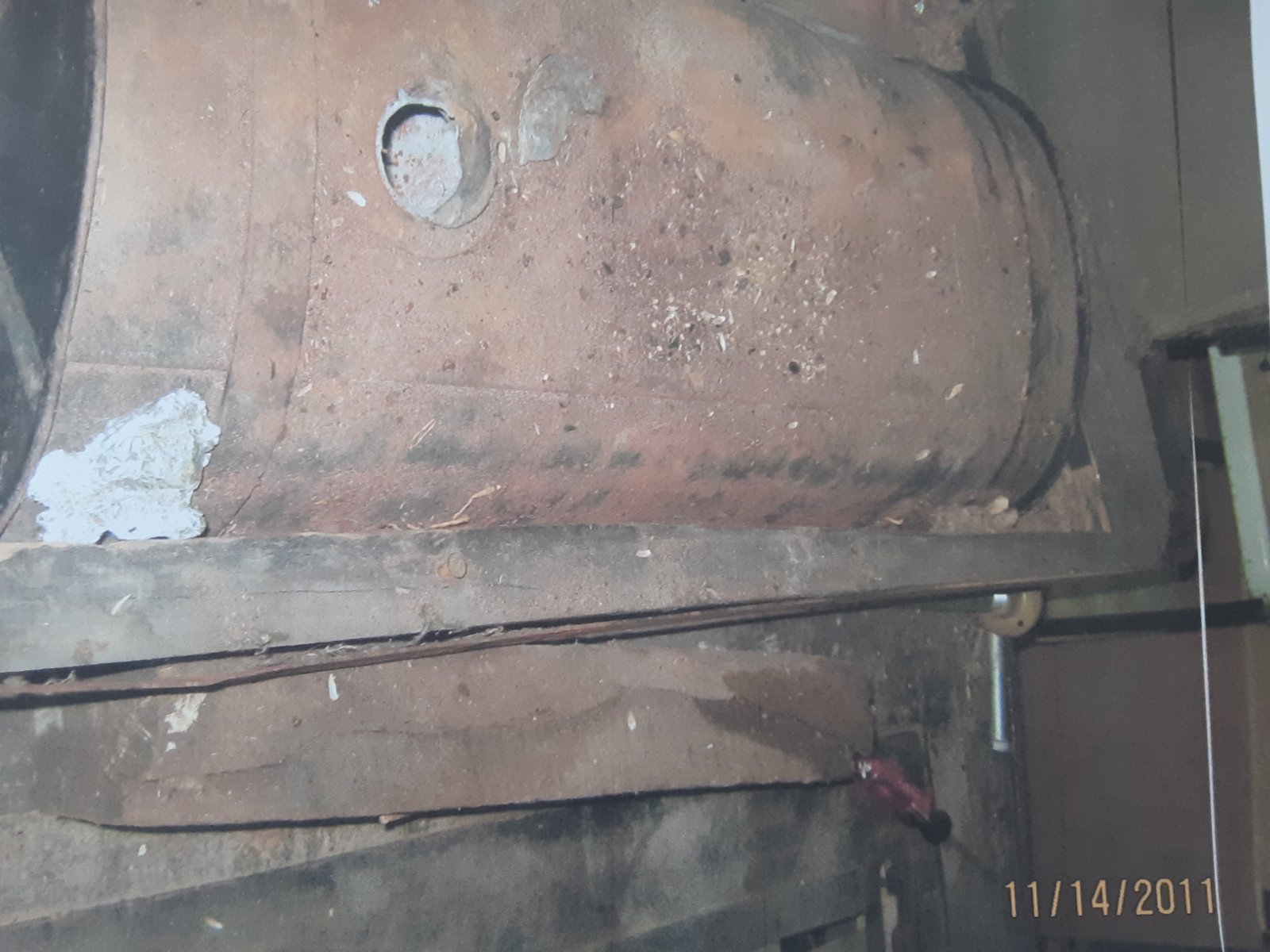

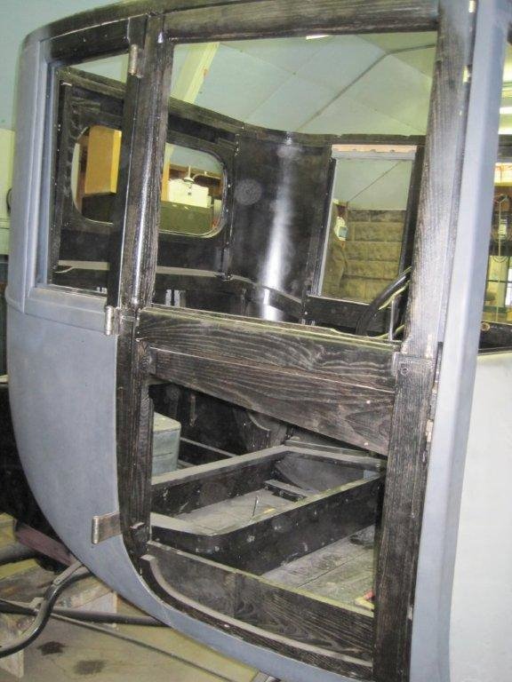

Hi all, l am at the point of bolting the body down on the 20 coupe I've been working on since 2011. It seems to me that the tank is to high for the seat, so I looked back at the pictures I took while taking it apart and it looks like that is the way it was. So wondering if there is someone out there with the oval tank under the seat in a coupe that can tell me if this is correct. Thanks George

It’s likely to be the wrong tank AND in the wrong place. Most coupes had a square tank in the trunk.
However... According to Bruce’s book, At some point in late ‘20 some coupes did have oval tanks installed as an “experiment”. Your seat base doesn’t look right for an oval tank though.

Re: 20 coupe gas tank
Some of the closed car seat frames had a wooden framework below the springs. The somewhat later coupe I had did. That wooden framework allows about 3/4 inch clearance above the seat riser frame that the ends of the gasoline tank can fit in. Does your coupe have a single or split seat cushion frame?
Thanks for the replies. Wayne I have the single cushion seat, I think it has the 3/4 wood frame you mention, but I don't think that is enough. I need to get some help to get the cushions down from storage and try them. Still hoping that someone out there has one of these coupes with the oval tank. I like the idea of it being a little different than the norm.

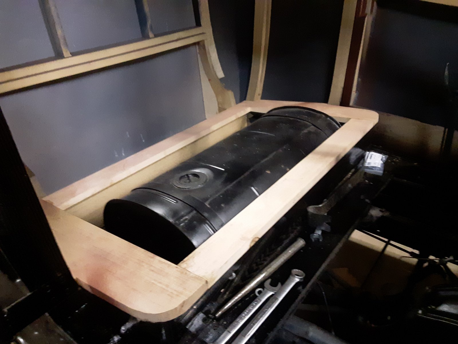

Here is a picture of a '21 Coupe gas tank it is in the turtle deck just like my '22 Coupe.

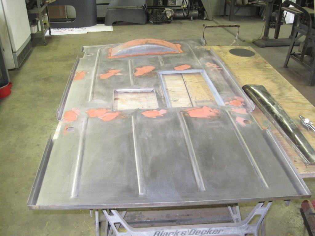

The turtle deck floor was part of the entire floor pan for the whole car
As you can see the gas tank and the battery had a hole in the pan. The hole for the gas tank allowed the fuel line and sediment bulb to hang below the car

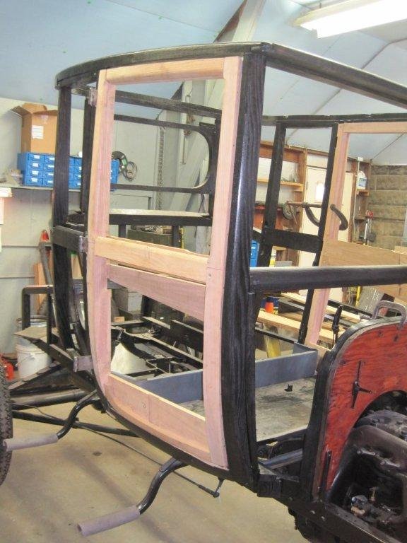

The original floor pans reinforcement bead rolls were "X" shaped and not straight like mine are rolled. The speed shop where I took the metal to be rolled started to roll the floor pan before I arrived and already had two runs done. I wanted them to provide me with new metal and make the proper "X" design but that is another story. The metal pan runs under the seat and into the turtle deck. The hump is positioned over the rear spring. From the front seat forward to the firewall is the standard wooden floor board set up. I'll post two pictures.
[/ If you look carefully you can see a corner of the fuel tank just behind the seat riser. In front of the riser is where the wooden floor starts.
size]
You can see the wood floor just in front of the riser
size]
