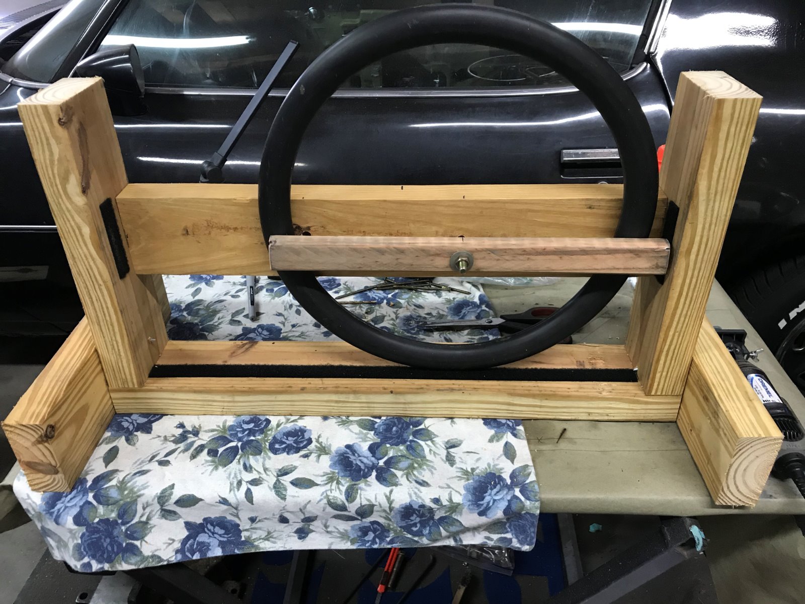

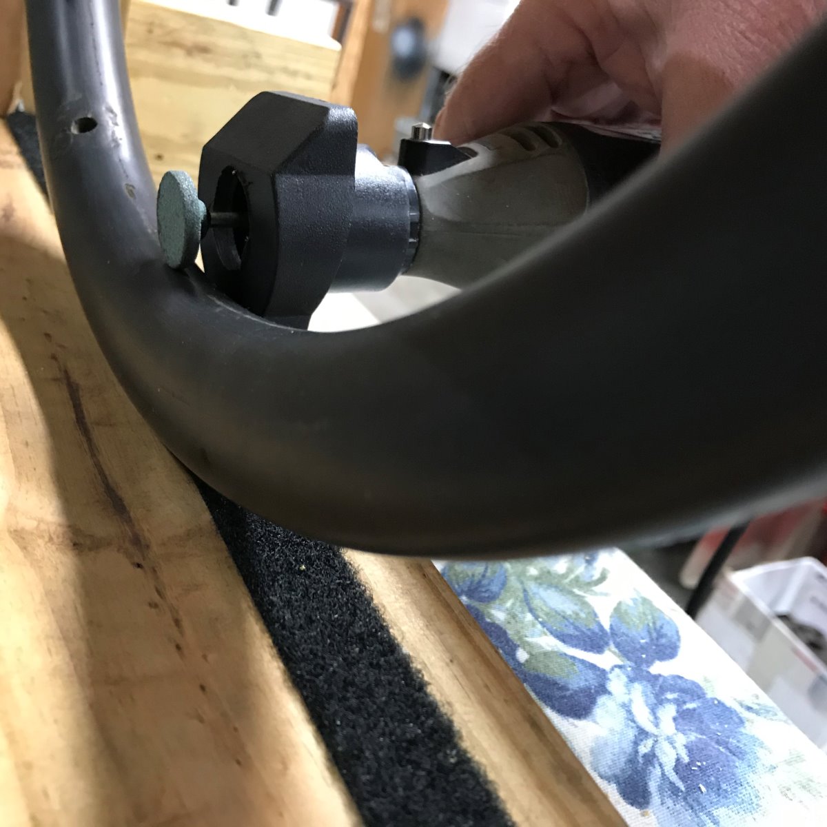

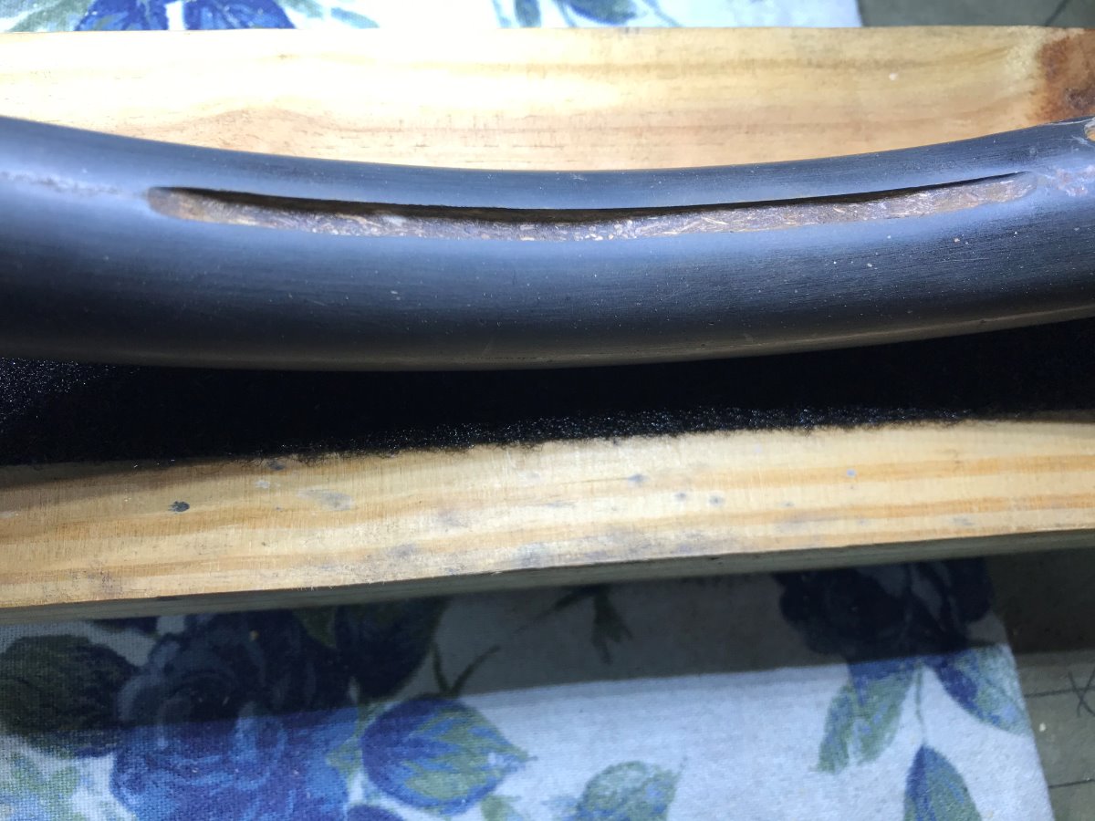

Re: Fordite steering wheel repair
Post by RFH » Thu Jan 02, 2020 12:11 pm
Hi again,
I made a jig to hold the wheel.
Started grinding out the seam crack to fill and sand.
Other than a horrible smell and lots of dust, seems to be going well.
Looking forward to the end result.
Thanks again for all the info.
Randy Hilyer
