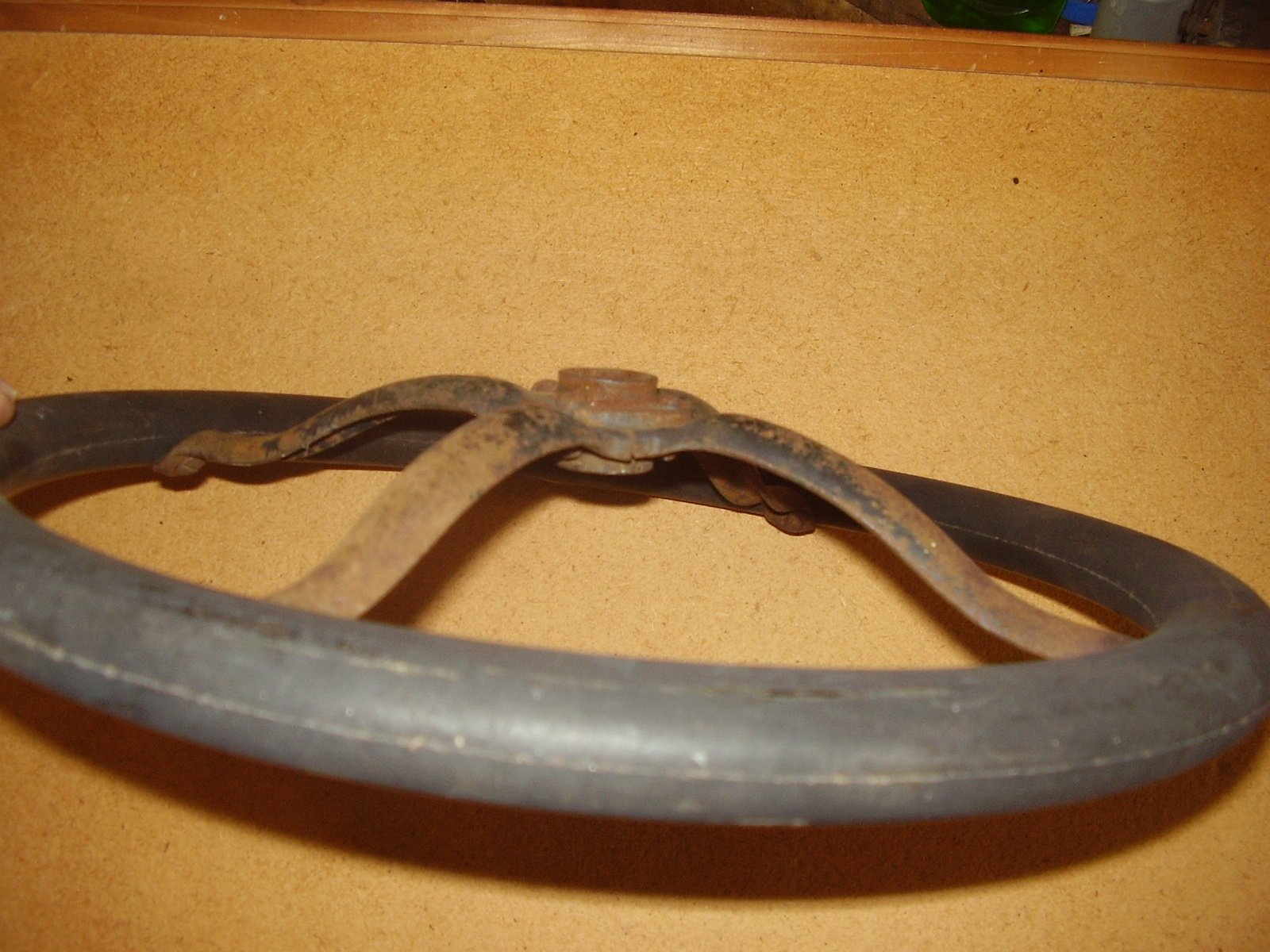

- Posts: 680
- First Name: R.V.
- Last Name: Anderson
- Location: Kennedy, NY
Re: Fordite steering wheel repair
The 15" wheel that I have (actually I several) and which Steve T. cites is really quite unique. The pressed steel spider has a significantly higher profile, resulting in a deeper "dish", than the familiar 16" spider used in later 1920-25. When I was looking for one of these for my April 1920 touring, one fellow told me that that wheel was "Canadian." I found the drawing and release info at the Archives, and it was definitely a US production part, though it may have appeared in Canadian production as well. (FWIW, my dad's 1923 Canadian coupe, a true unrestored survivor, still has a forged spider, with the horn button of course.)
Here are some photos. Note the deeper "dish" in the side view. The rim looks warped in that photo but it's not; just a trick of the perspective.
Thanks R.V. Anderson for the photos.
The outside of my wheel has a line around it like yours.
Looks like you can see the inside material of the wheel.
There is also a line or seam / crack on the inside of the wheel.
This is what I was going to cut and fill in an attempt to make it stronger or last longer.
Just didn't want it to fall apart one day.
Thanks,
Randy

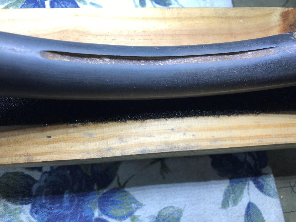

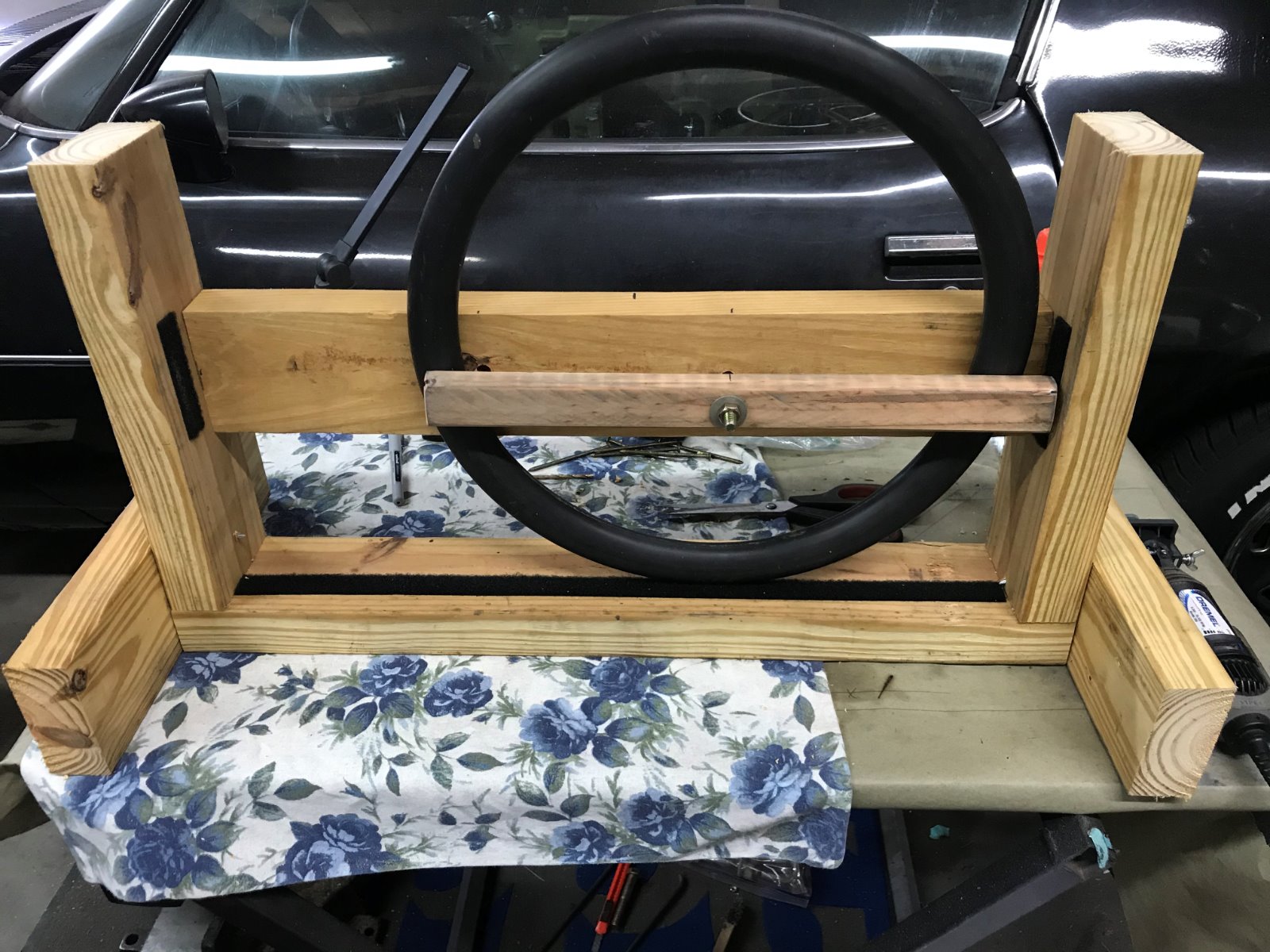

Topic author - Posts: 21
- Joined: Thu Jan 17, 2019 7:42 am
- First Name: RANDALL
- Last Name: HILYER
- * REQUIRED* Type and Year of Model Ts owned: 1919 COUPE
- Location: SOUTH CAROLINA
Hi again,
I made a jig to hold the wheel.
Started grinding out the seam crack to fill and sand.
Other than a horrible smell and lots of dust, seems to be going well.
Looking forward to the end result.
Thanks again for all the info.
Randy Hilyer
Randy Hilyer
