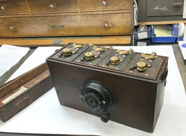

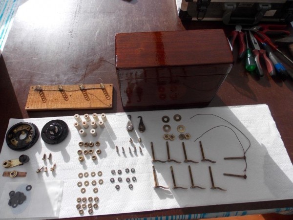

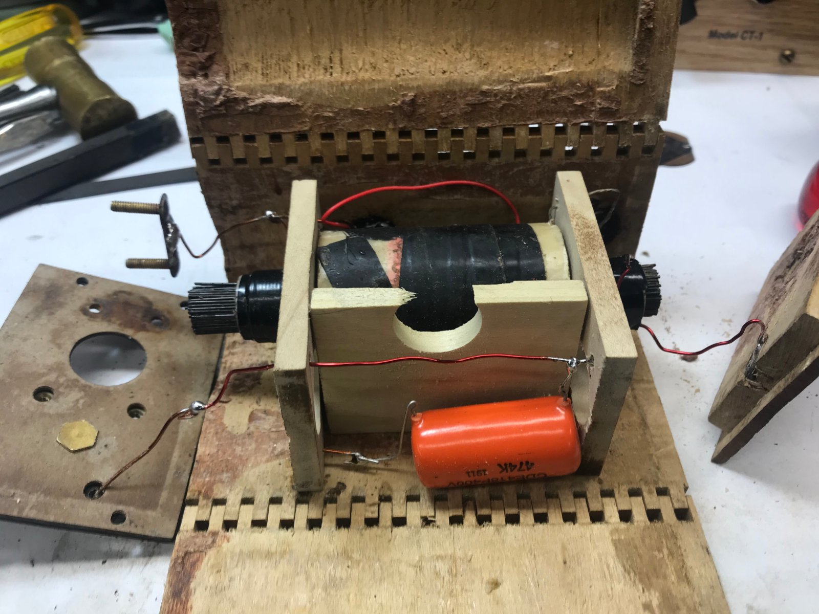

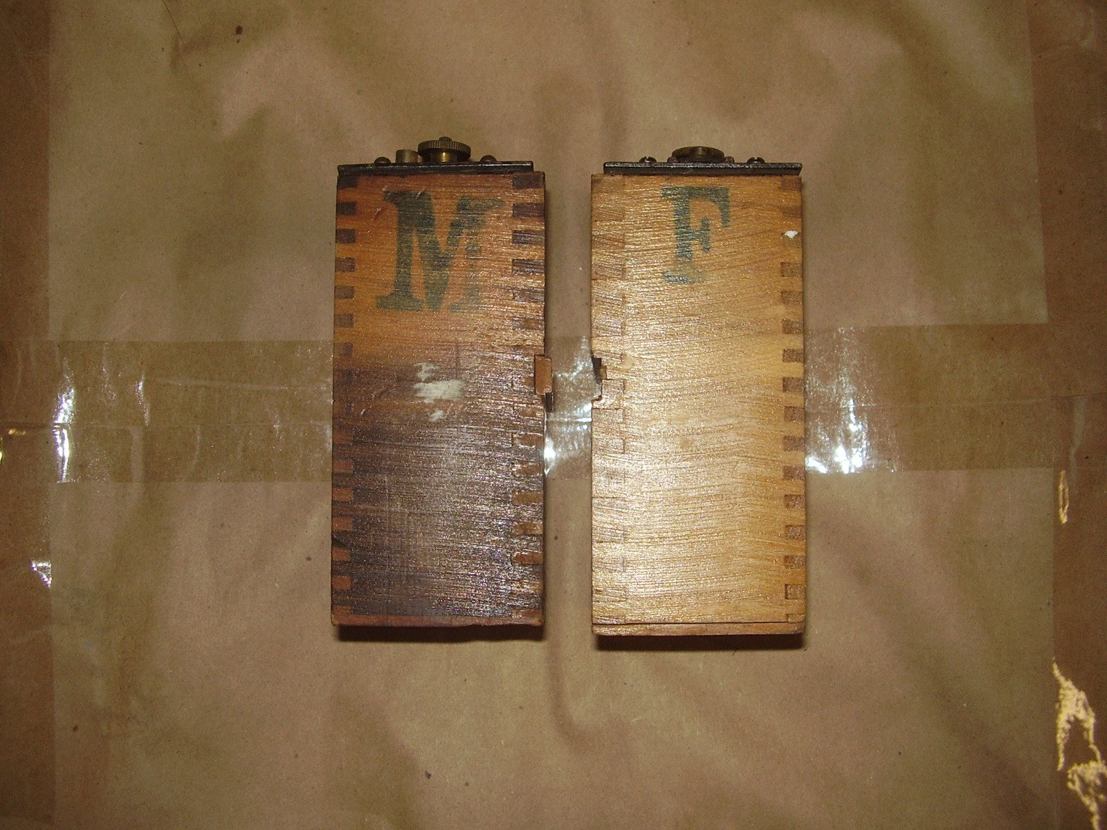

I thought I would share with you guys how I did some of the repair work to my original 1912 Heinze coil box and coils. For the most part, I've done nothing to the coil box other than clean it up a bit. I'm not sure whether I will leave it original or restore it, as it looks and performs just fine the way it is. The coils were completely taken apart and new primaries and secondaries were installed along with the correct "orange drop" capacitor Lang's sells. I decided to use the original iron rod cores from the old coils in the new coil assemblies to help them look authentic, plus they're already the correct length. I made up small wooden frames to hold all the new electrical parts, carefully soldered everything, and wrapped the primaries with good quality electrical tape. The coils were all tested with their original points before potting them with tar. The new wooden frames have plenty of holes to allow the tar to flow freely and fill every void. I did clean all the visible parts on each coil. The coils seem to get the best spark tested with a Fun Projects Strobe-Tester when the points are adjusted to between 0.8 and 1.0 amps. Now I know this isn't the correct setting for "regular" coils, but it seems to make the best spark with no "double spark" at the lower settings. Each coil was easy to set and they seem to hold their setting after a good run time. Checking them later, they still worked good. I've elected for the time being to keep everything looking original. My car is not mint condition, so neither should the coil box. I was happy to find this coil box as my 1913 Canadian touring was built in September of 1912. I don't know it I'll use the coil box long term but I have it to complete the car for authenticity. I have a nice new KW repro wood box in the car which operates great! How many of you actually use Heinze original coils in your cars?

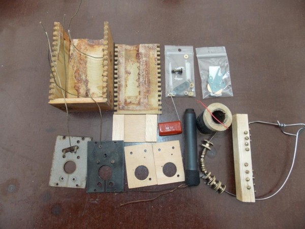

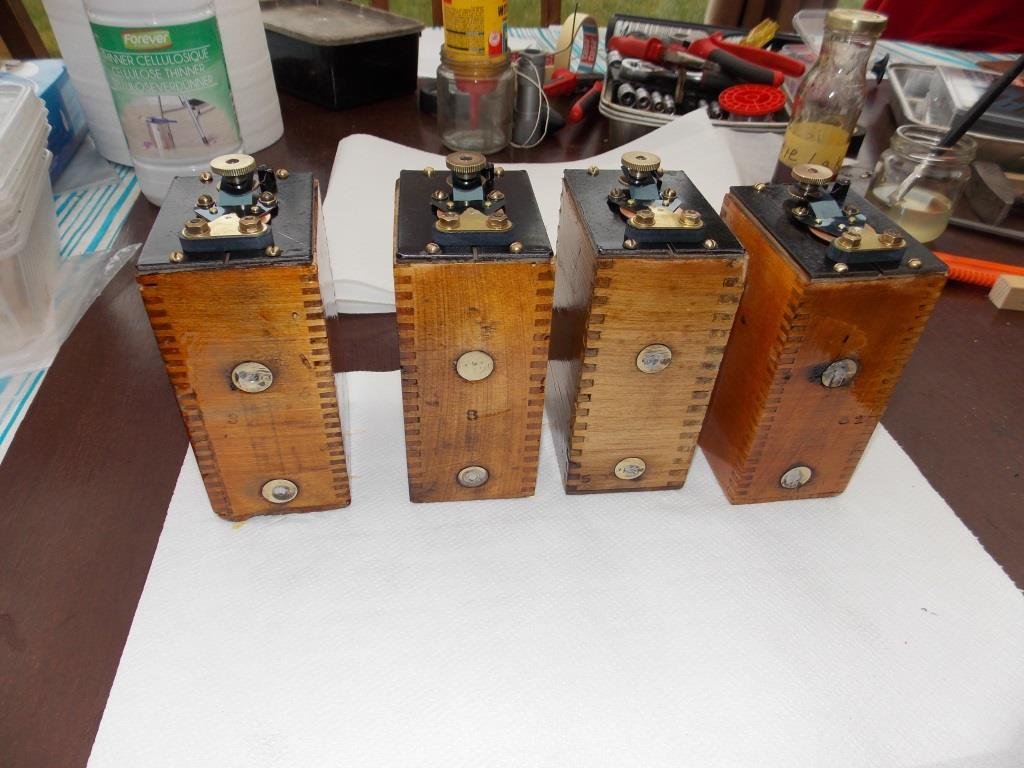

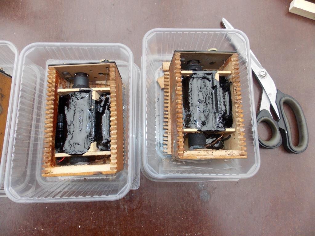

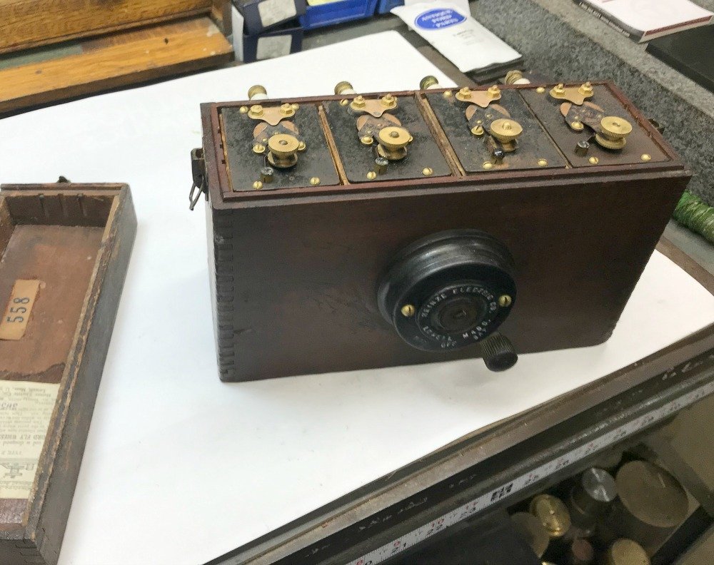

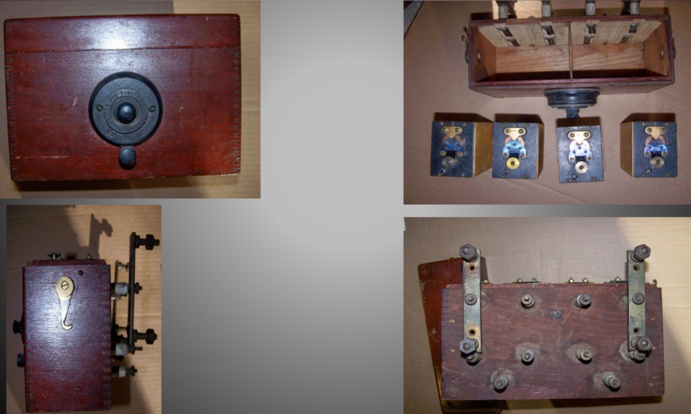

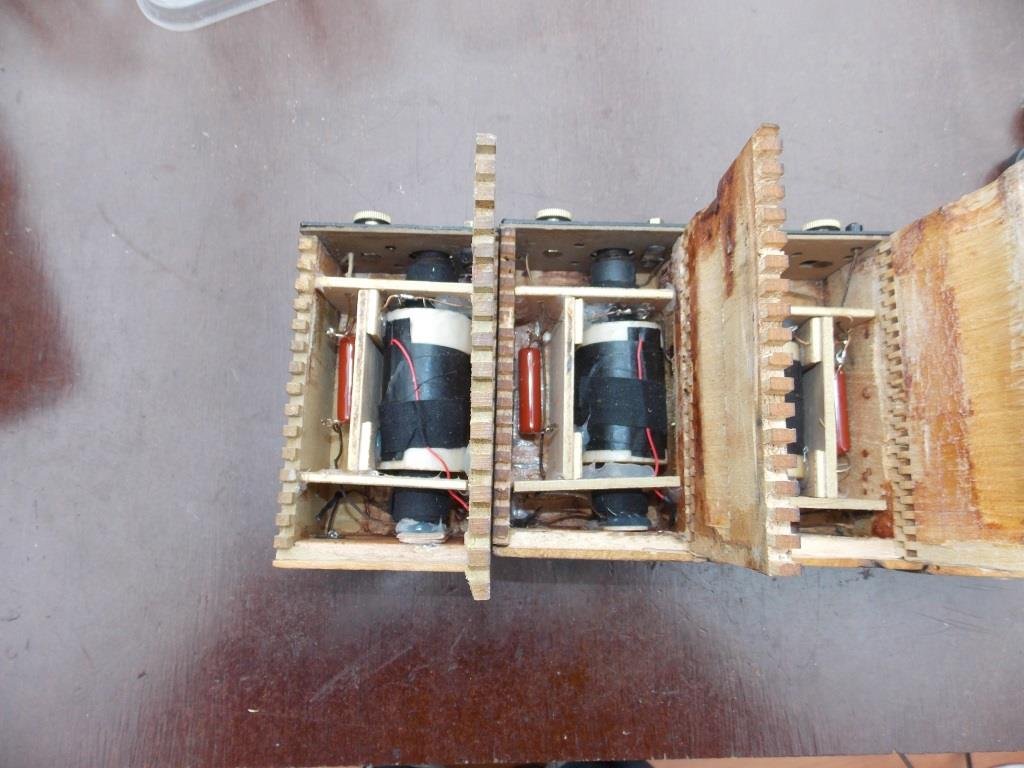

Here a few photos that tell how I did it some time ago.
First will be the photos of the coils.
Next post will be photos of the box.
Good luck
Andre
Belgium

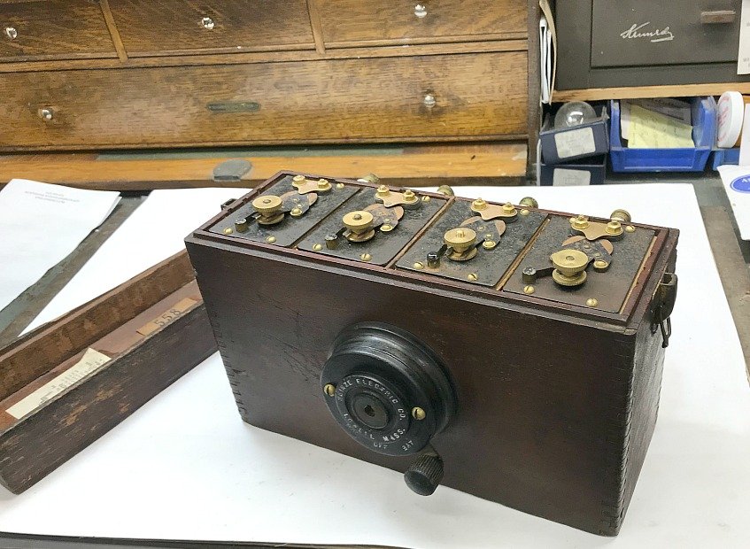

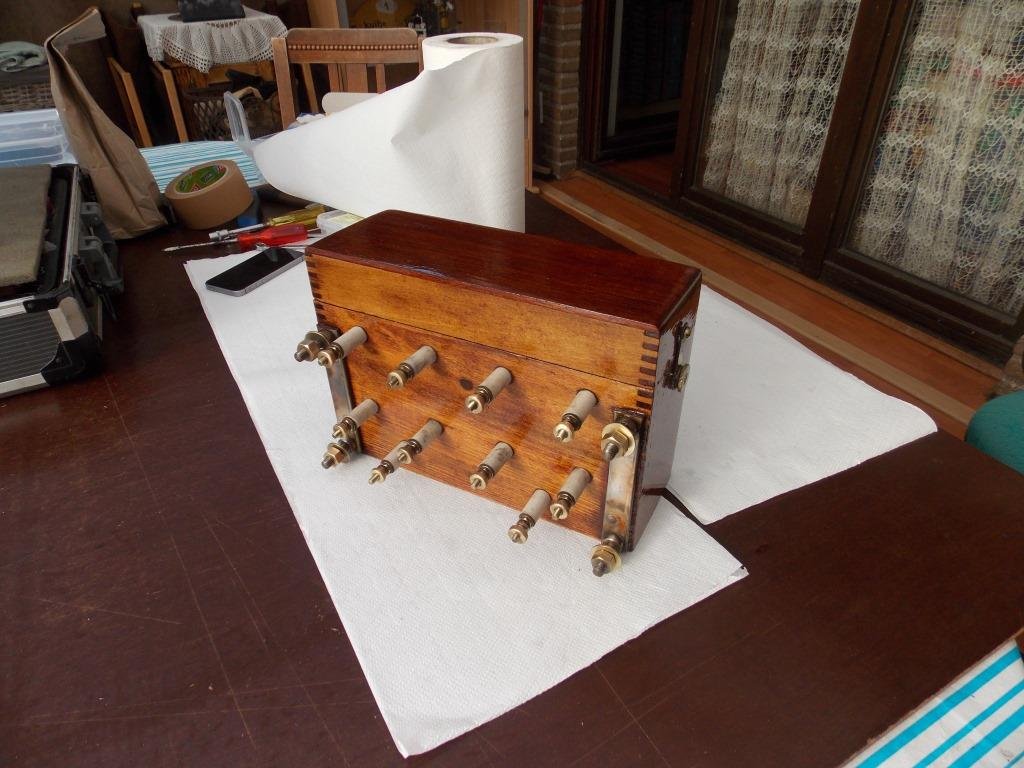

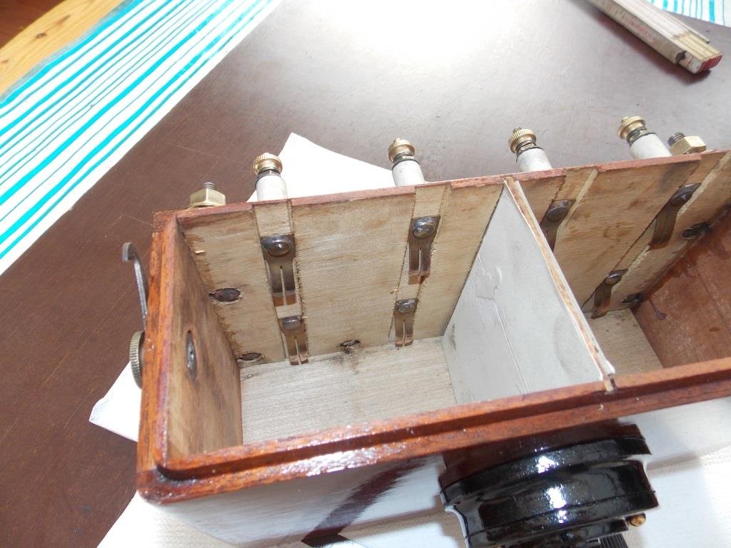

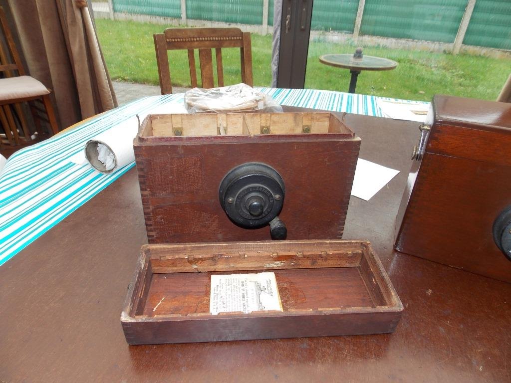

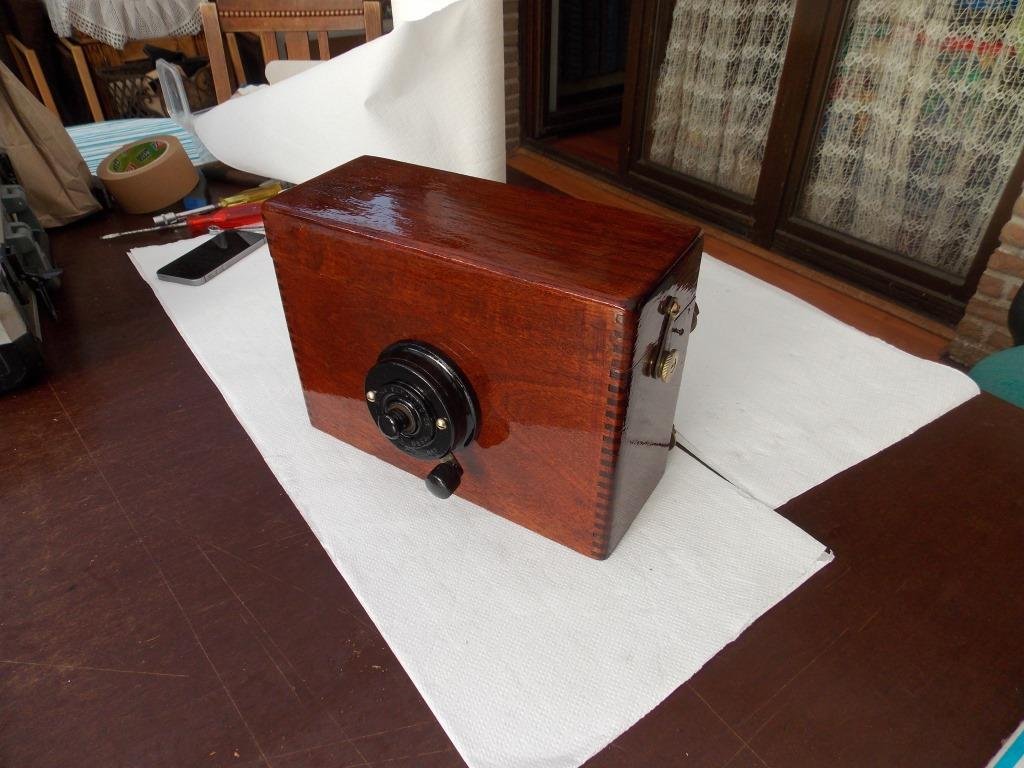

Now the box.
Andre
Belgium
Posts: 7164
Re: 1912-1913 Heinze coils and box repairs

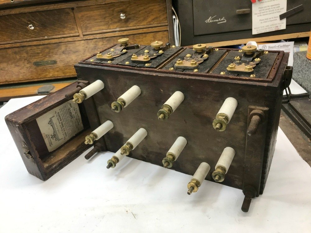

Post by Allan » Tue Dec 24, 2019 8:03 am
Andre, the one on y 1912 chocolate van is the same as yours, right down to the cam type lid latches. It is a really nice original which I refinished when I restored the car in the early 90's. Unfortunately, I lost the lid with its original matching number and paper instruction label on an interstate trip to Sydney. I borrowed an original lid to carefully build a replica and I was most pleased with my work, until I went to fit it. It was exactly the same dimension as the borrowed pattern, but 1/16" shorter than the one I had lost, and so does not fit well. Bugger. When I can find some matching timber I will have another try.

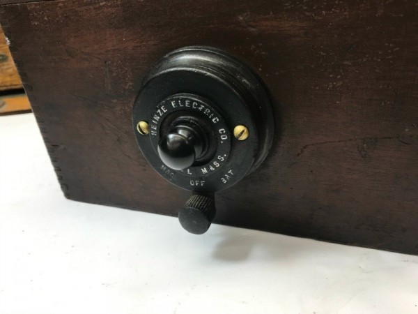

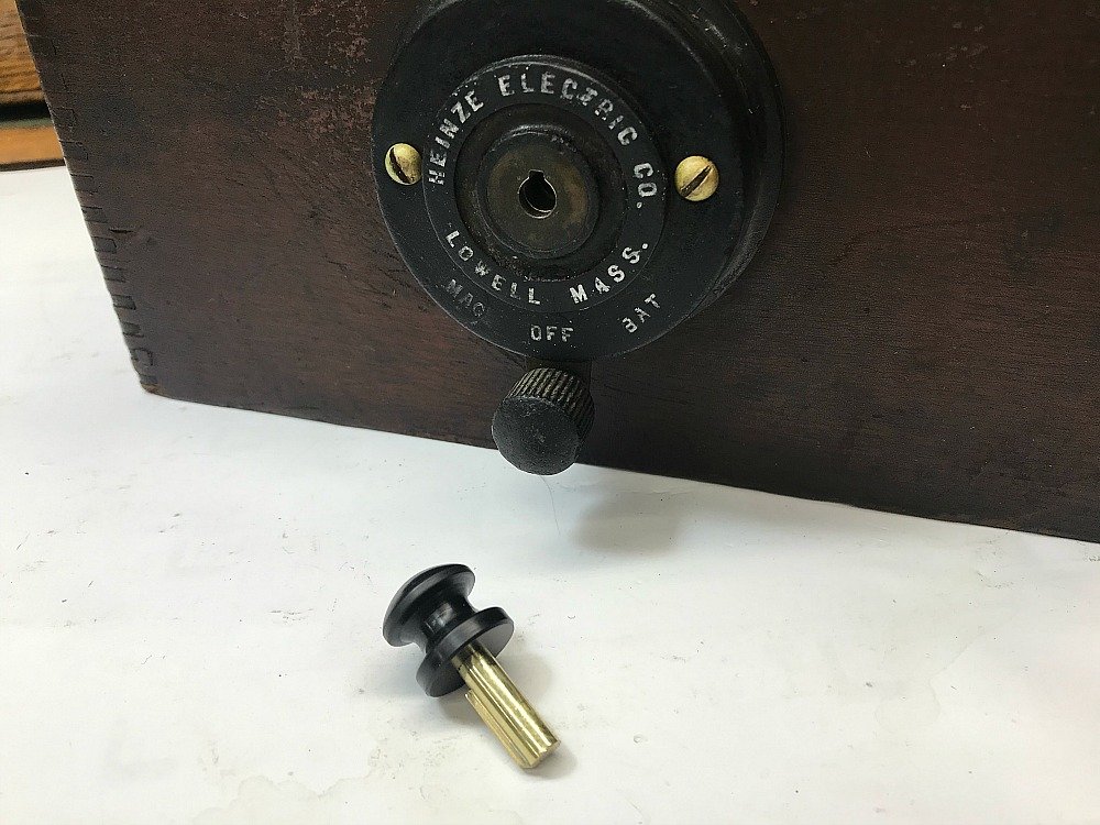

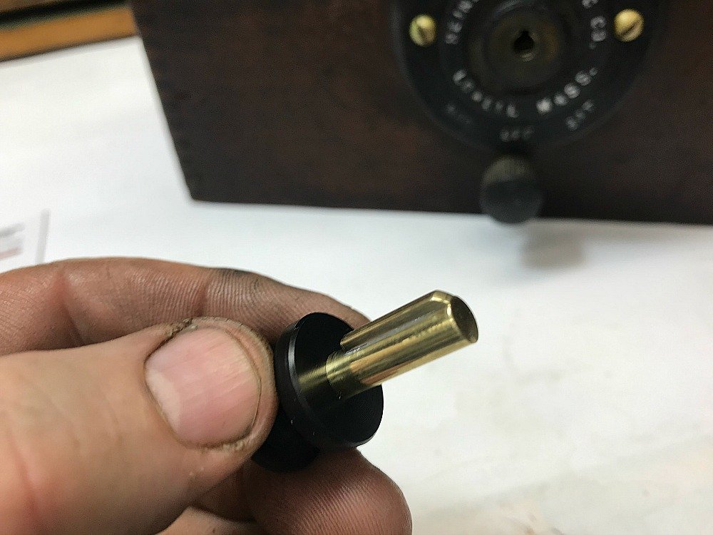

Made a key today for the coil box :)

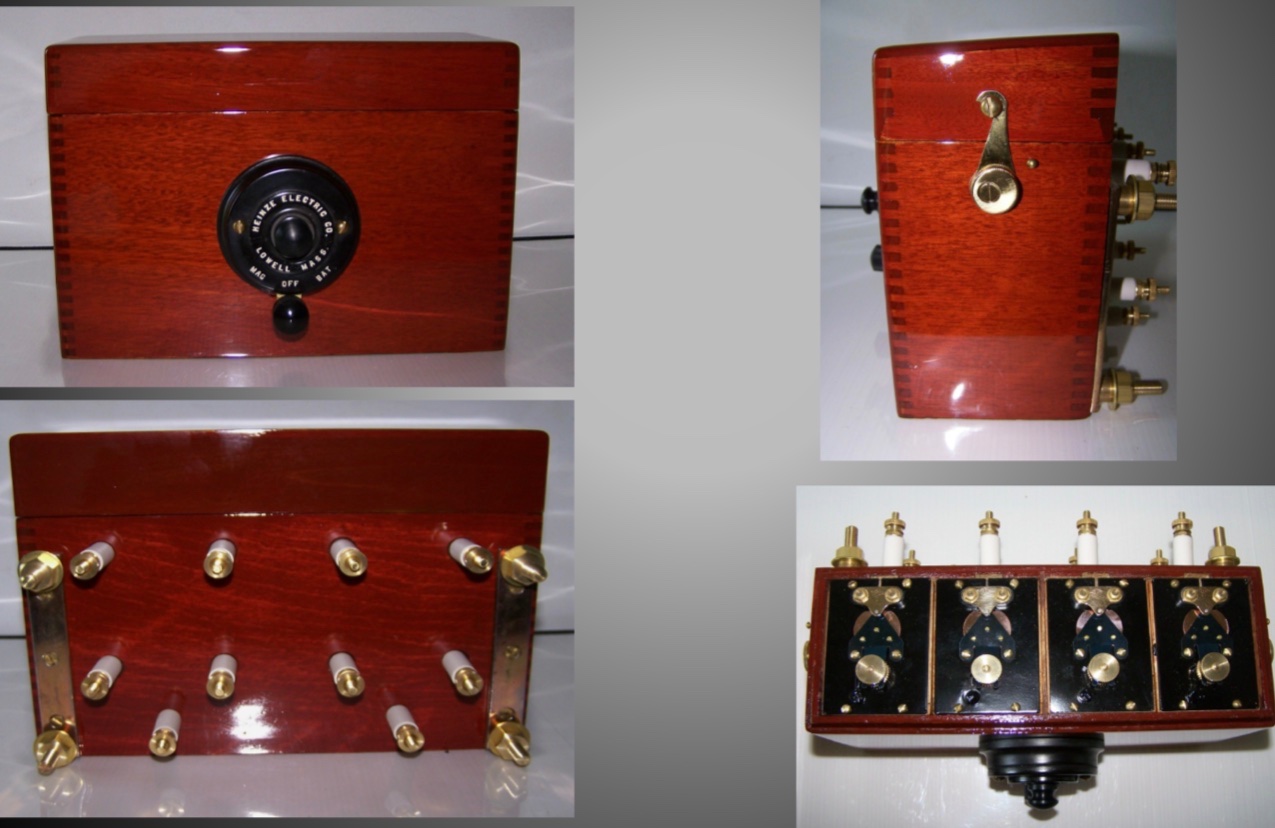

This is my early 12 box. Before and after. Excellent Restoration by RV Anderson

My new boxes are mahogany. Not Cuban, but still mahogany. Guaranteed.

Is the glue on those early coil boxes water soluble?
I have always wondered how you get 4 sets of dove-tails apart without destroying them.

Some times they came apart easely with a srew driver.
Most of the times I use a paint stripper to warm up the joints and than they separate without breaking .
Pay attention not to burn them.
Andre

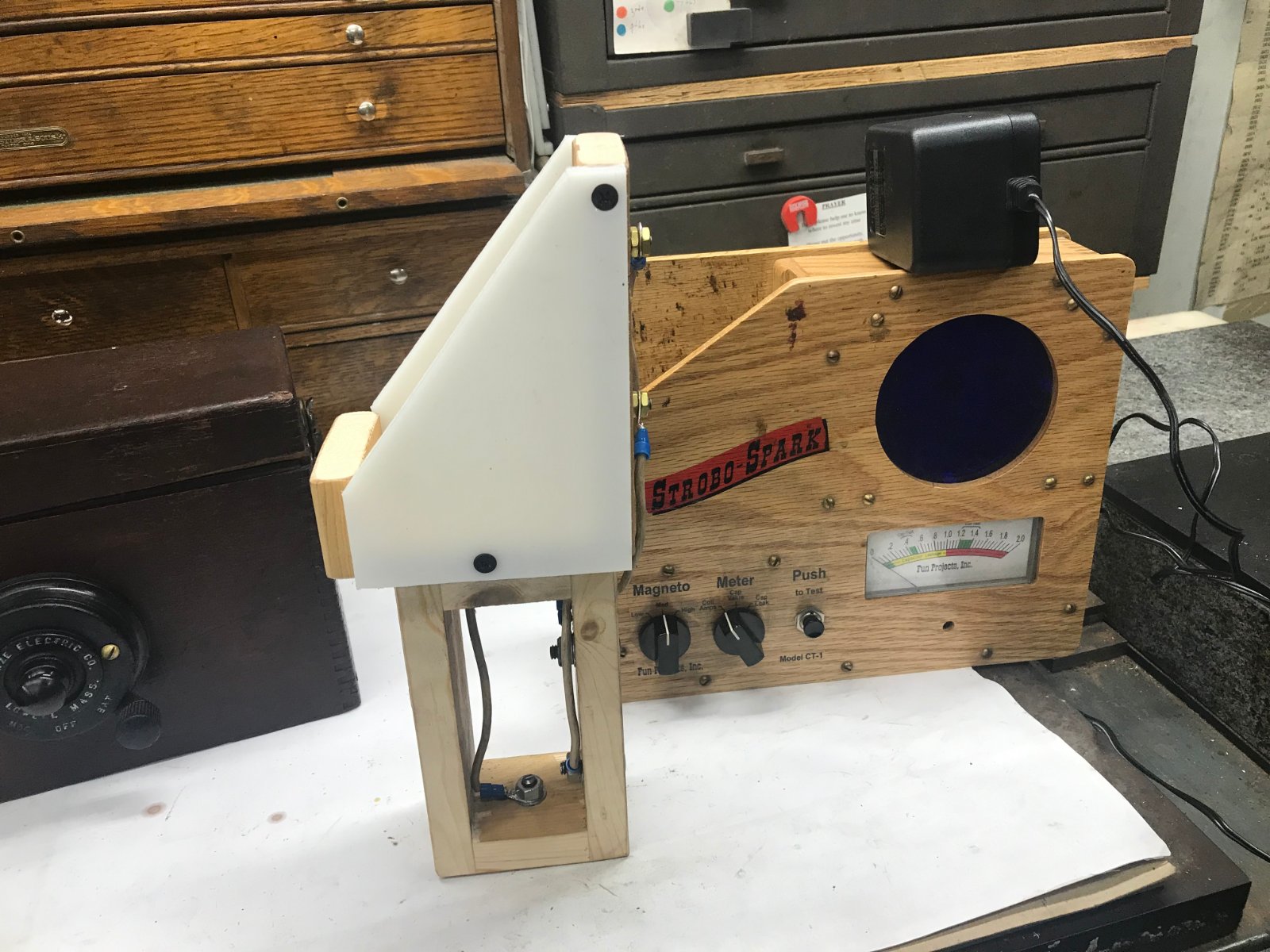

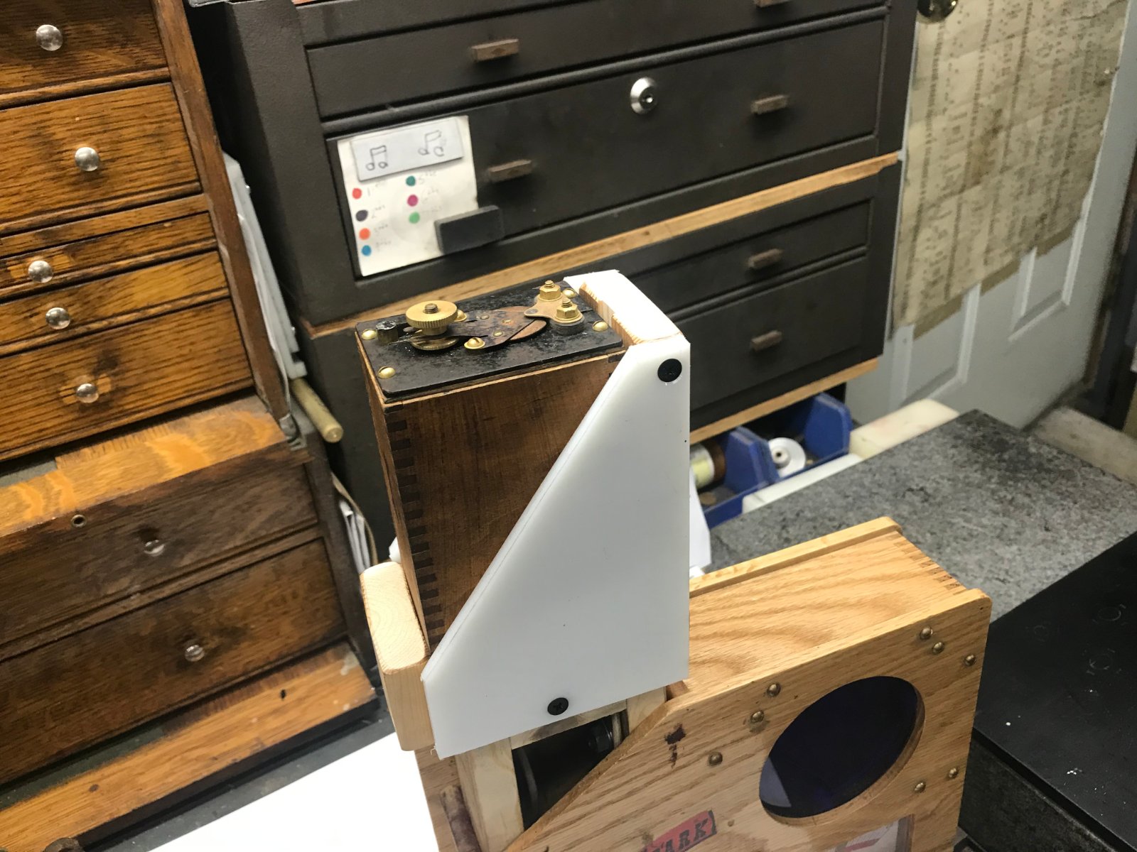

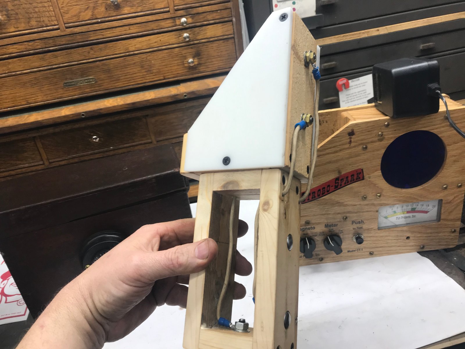

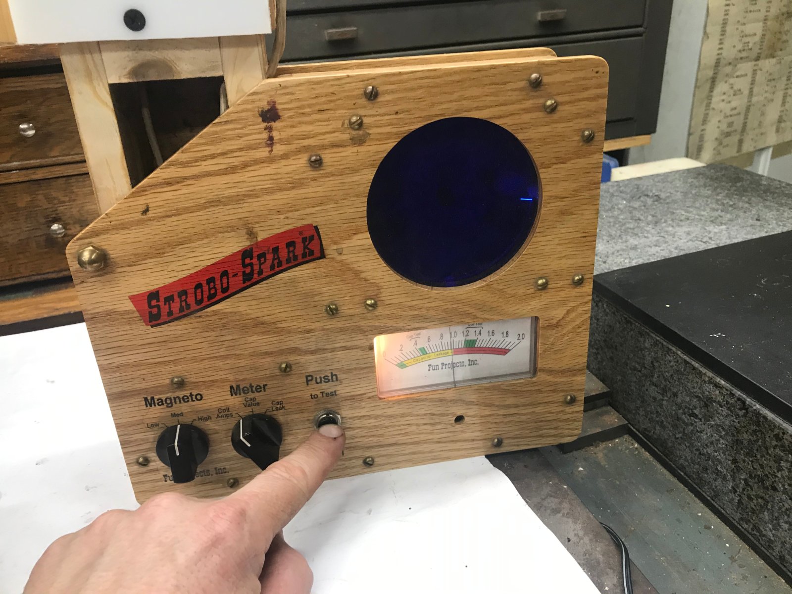

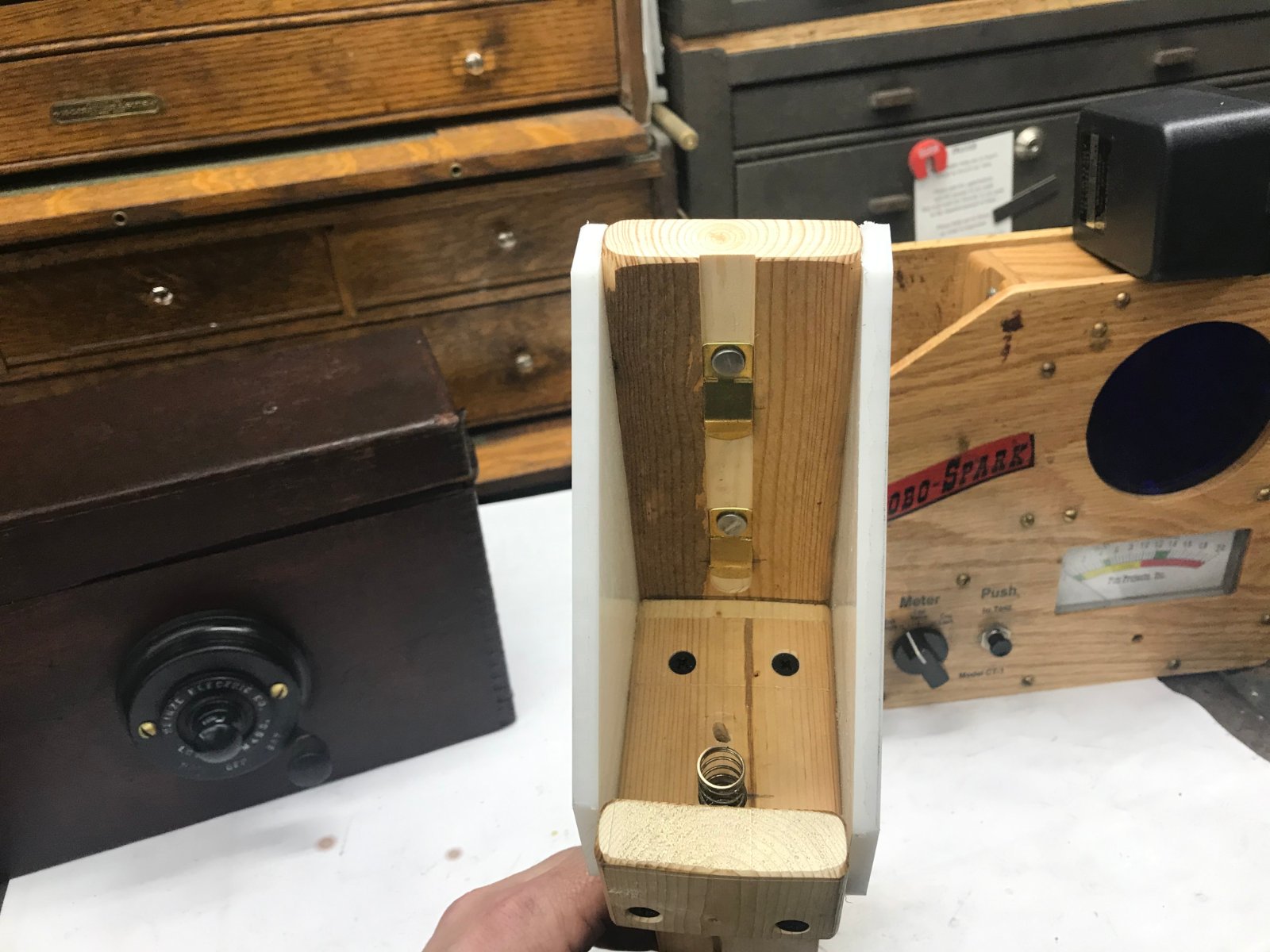

Today, I decided that if I use my coil box I would have a convenient way of quickly checking and/or adjusting them at home. I made an adapter to run them in a Strobo-Spark tester, but it will also work fine in my hand cranked coil tester! :)

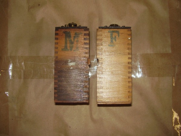

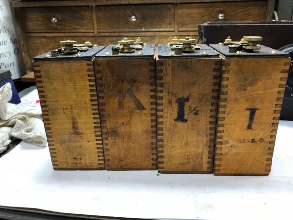

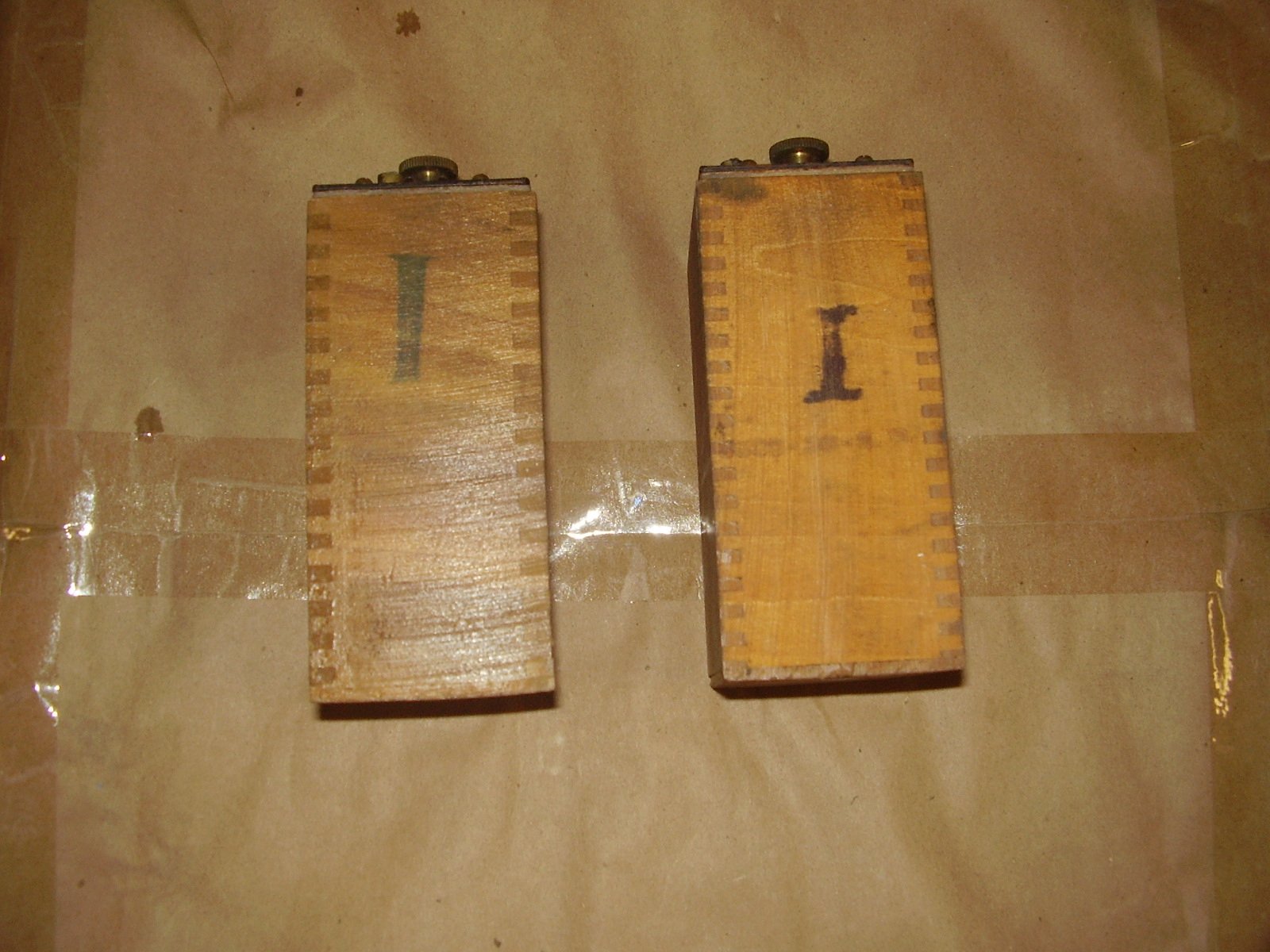

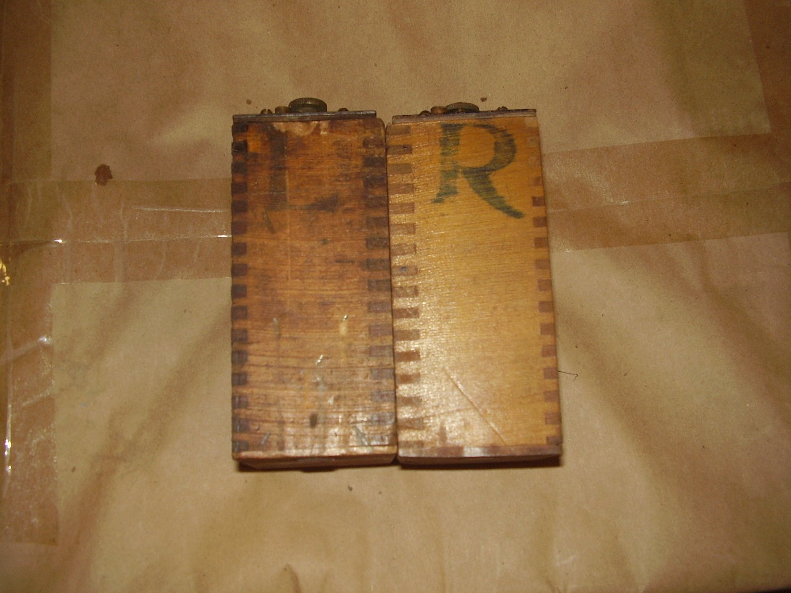

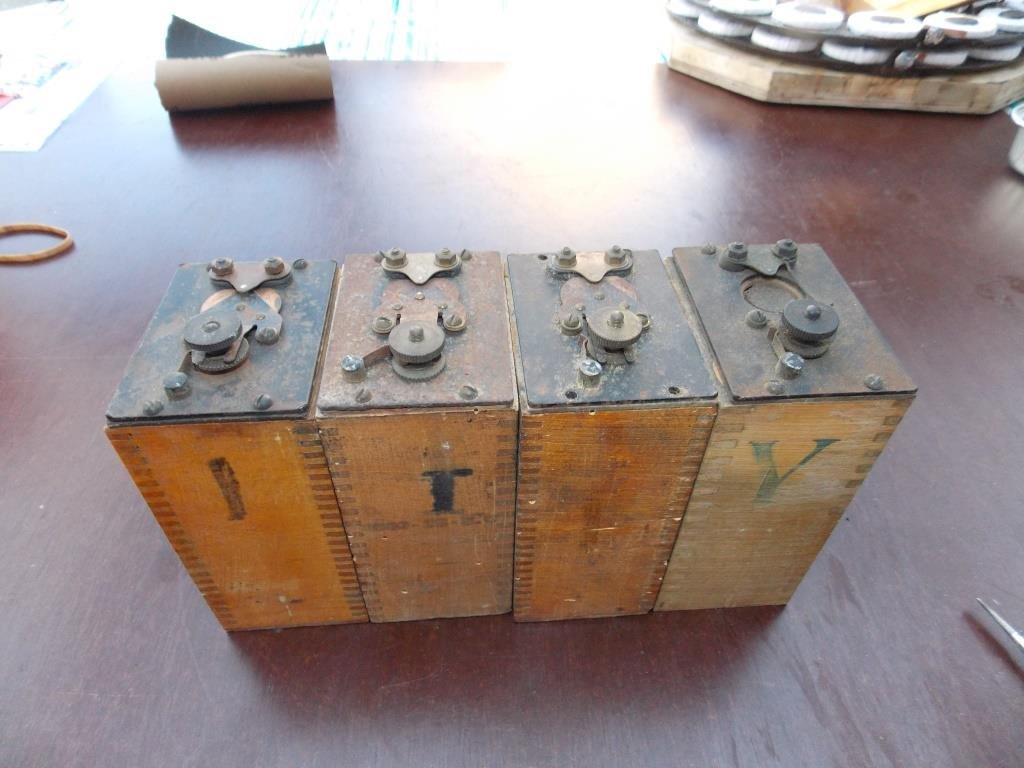

Anyone know why the coils have the alphabet numbers on them? Better yet, why the fraction on the one?
Posts: 6727
Post by Scott_Conger » Sun Dec 29, 2019 7:23 pm
Darren
a little bit of info, though not all you're looking for: https://www.google.com/search?q=mtfca+l ... e&ie=UTF-8
R.V.Anderson
Posts: 680
Joined: Tue Jan 08, 2019 6:01 pm
First Name: R.V.
Last Name: Anderson
* REQUIRED* Type and Year of Model Ts owned: 1914, 1920, 1923, 1923
Location: Kennedy, NY
Post by R.V.Anderson » Mon Dec 30, 2019 11:43 am

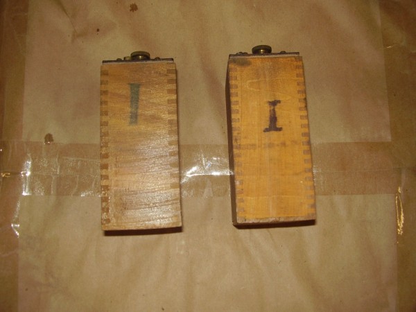

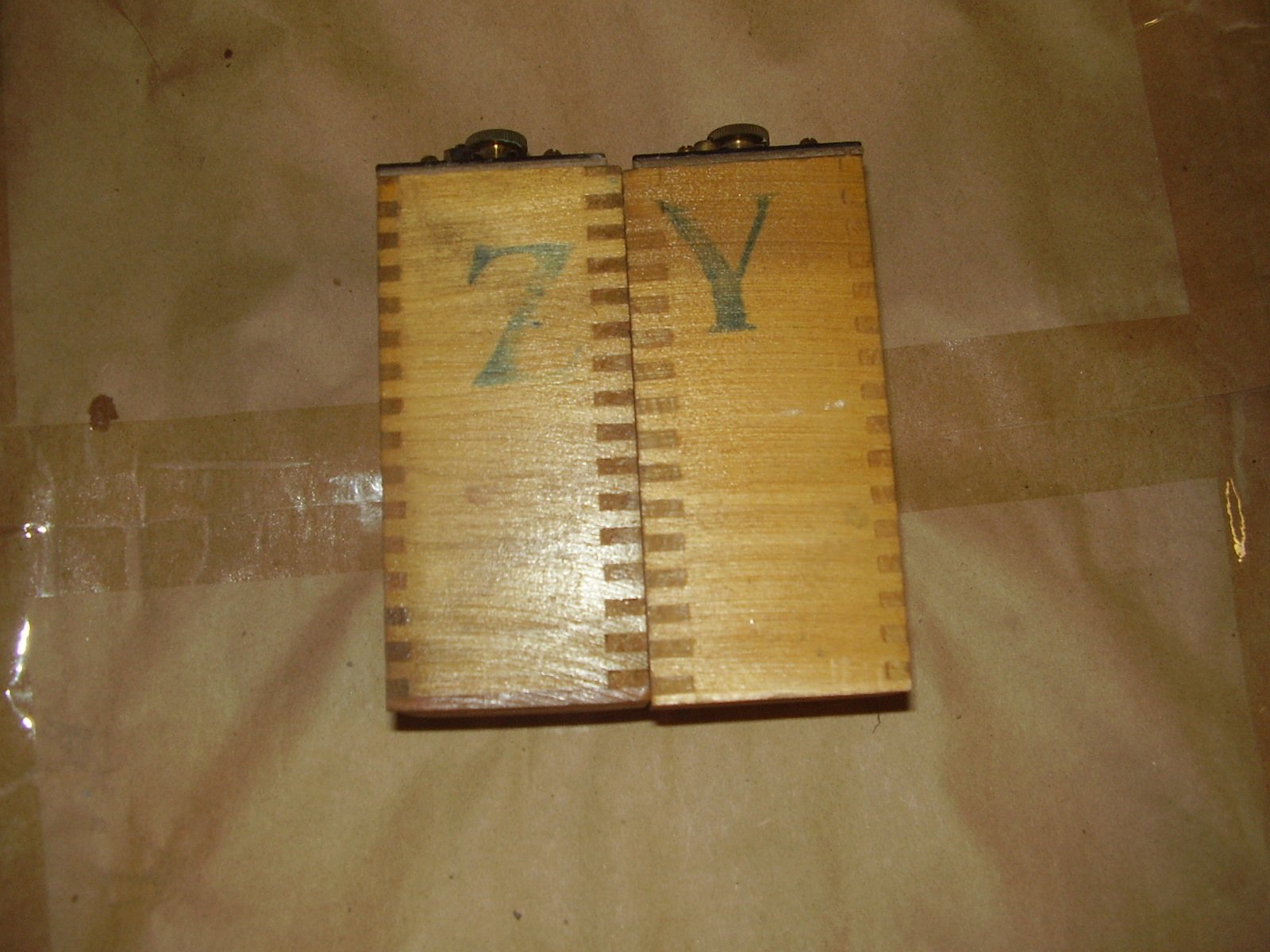

Around the time of the T's introduction, the Heinze Electric Co. patented a mortise and tenon joint between pairs of its coils. The idea was to make the units a bit more secure in the box, helping to keep them from bouncing around in the box and losing contact. This joint required that the coils be made with one thick side to accomodate it. These thick sides then had to be adjacent to those of other coils, which meant that the coils had to be made and installed in the box in pairs, with "male" and "female" sides. These coils were stenciled with "M" and "F" so the assemblers would know which coils would get the tenon glued in. This was the first style Heinze coil used on the Model T:
When the coilbox lid was changed to include a pair of notched strips that, together with the cam style latches, kept the coils firmly in place, this joint was no longer needed and was eliminated, although the thick side was continued, probably because of the cutting machinery. These units were then stenciled "L" and "R," probably for "Left and Right":
Late in 1911, the "L" and "R" was changed to "Z" and "Y:"
I have no idea why this change took place. The best guess I can come up with is that Lowell, MA, where the Heinze Electric Company was located, had a very large Greek immigrant population, quite a few of whom worked for Heinze. Many Greek surnames begin with "Y" or "Z". Perhaps that had something to do with it.
Very early in the 1912 model year, the thick side was eliminated (all sides were now the same thickness) and the stencil changed to a large upper case "I". This continued into late 1912 when it changed to a more squat upper case "I" with prominent horizontal bars. The two 1912 units are shown side by side for comparison:

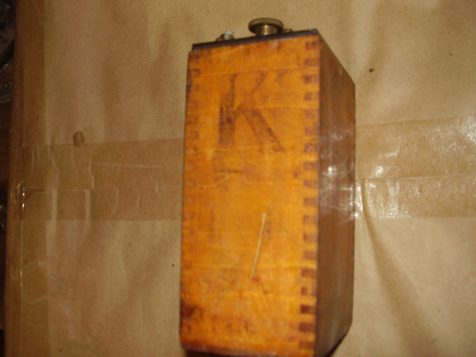

Finally, for 1913, the stencil changed to a large upper case "K":
In the quite different 1914 units, not shown here, the letters changed to "O" and later on, "A".
There are many other coil construction details accompanying these stenciling changes, but I'm focusing only on the stencils since that was Darren's question. Some markings, such as the "1/2" on Darren's coil and the long stream of small numbers on some other coils, have no known explanation. All the details I know, probably more than anyone is interested in, will appear when the article I'm working on for the magazine comes out.
