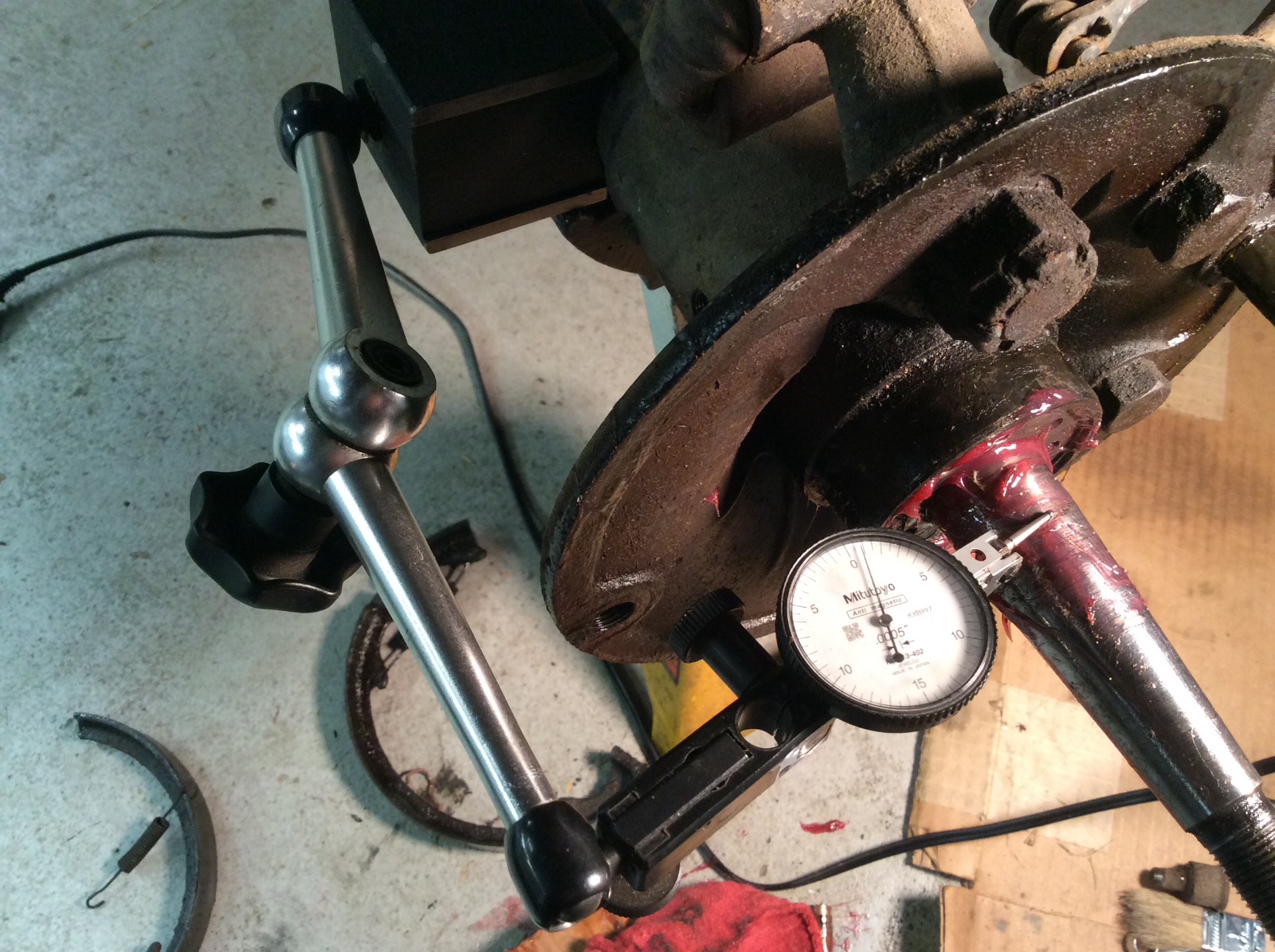

I installed a new bearing sleeve and the used bearing. The bearing was hard to get in, I actually had to tap it.
I removed the sleeve and checked the axle housing to make sure there was no dirt or grit under the sleeve.
There is only about 1/2 a thousandth play up and down. The bearing had .002” wear.
It seems the sleeve is too thick. Is this a normal problem?

I've ran into a similar situation but I had the luxury of having multiple bearings to choose from so I fit each side to each sleeve. I've also attempted to install a .497 - .498 bearing into a new hardened sleeve and it was a "no-go" ?

With the premis that the bearing cage is firmly riveted and cannot twist, I would suggest that you jack up the opposite wheel and give it a spin several times.
Your rollers may well not be fully parallel to the axle and housing and will settle in once they go around a few times with the axle shaft.
Try this and then check your play.

What you are describing can also be indicative of a bent axle housing. The original bearings and sleeves will wear in to this condition but when you install new sleeves and bearings, that have minimal wear, it usually end up
In a binding situation. This is well described in the MTFCA rear axle rebuilding manual.

Scott I turned the axle a several times and no change. The end plates are tight.

Rajo,this .498 bearing does not want to go from the start,so I suspect the sleeve.

The new sleeves can be a tad thick. I haven't used any new ones myself, but have heard of tight assemblies several times w/new sleeves. Just wondering out loud if the new sleeves might not be perfectly round after assembly. Either way, I believe a small amount of use will get things settled in in short order.

I've installed dozens of the new repro "best quality" sleeves & I believe they're also just a smidge on the thick side myself.
I use a hose clamp to compress the sleeve to insert into the housing - pretty much stay round when they go in.

This is an interesting situation. First, I welcome thicker sleeves but it would be good to know which ones and what spec. I wonder if you first check the tube for burrs, measure the tube and then use another one the same size to install the sleeve. Then hone it out to the desired size and refit it into the subject axle tube.
I recently straightened 17 housings to within about 10 thousandths of perfect and found only two that didn't need correction.

Try removing the bearings and then check that the axle shafts are centered in the housing. If they are off to one side or too far up or down, it could be a sign of a bent housing. However if the shaft is centered and the tightness is all the way around the bearing, you probably have a snug sleeve.

I believe that you will find that Norman is on target. Many of the housings have either sagged a bit under the cars weight or are bent from dropping or hard knocks. Not uncommon at all. I’ve seen guys tap or more or less force the Hyatt bearing in and it will rotate and will be tight at various spots around the axle rotation. Will not be a good thing down the road. Just my experience and opinion.

Some guys have all the luck. Take a look at the old bearing sleave to see if the wear is evan though the bore this will be a indicator of how straight the housing is. Measure the thickness of the new sleave and compare it to the old one. If the sleave is substantialy thicker and the housing apears straight than thats the problem. If the sleave is that much thicker then tell everyone with a pile of worn axles & bearings were you found them OK. Merry Christmas

Merry Christmas to all. Thanks for your helpful replies. I removed the bearing and the axle was indeed off center towards the front. I did not measure how much but would guess 1/8". Besides that problem I think the sleeve is too thick. I will look at it later and check things more. The old sleeve wore on the top surface evenly.

While the rear end housings, have to be straight, that is not the problem, this time.
There are two companies that make the axle sleeves. One uses steel sheets that are .002, thinner then standard Ford, these are NOT usable, unless that is the kind of work, that will satisfy you. The axle movement will take the seal out.
The other sleeve, is .002 to thick in thickness. pounding it together, like that, will tear everything up.
We use the thicker ones, I took a thick wall pipe, and bored out the center to a stock Ford housing, I. D., the same length, of the sleeve Plus, .500-00. I put a slot in from one end, so the sleeve dimple would slid down the slot, lining it up. It works on Right, or Left sleeves. We had them honed to Ford specks, about .002 out, and they fit perfect.
Or you can put in floating hubs, which is better, in my opinion.

Well I found the problem was a bent axle. Looks like I need to rebuild rear end.
I have a Ford bearing sleeve from the other side. I measured the thickness of an unworn area. It was the same thickness as the reproduction sleeve.
John
