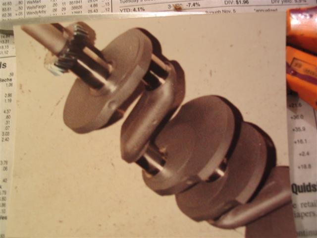

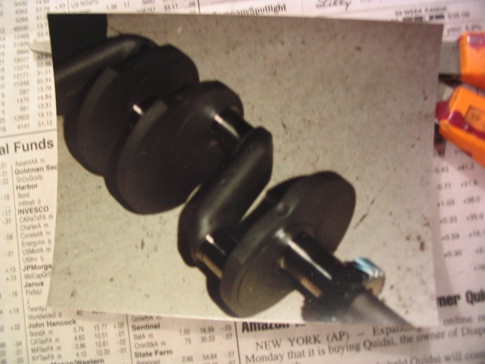

I have never had that come up. Normally, after I explain the advantages of a 4 Dip, that's what they want. But if they don't, normally again, they don't want anything, but a Ford crank. If we do use the 26-27 pan, they keep their original pan, with the car.
I know all you Guys Grind the Horse shoes, but i take it off the crank, I just don't like to refit the good parts to the problem parts.
We used to build counter, weighted cranks for the Model A's, the O. D. is the same. Here is a picture of our crank.
Herm.
