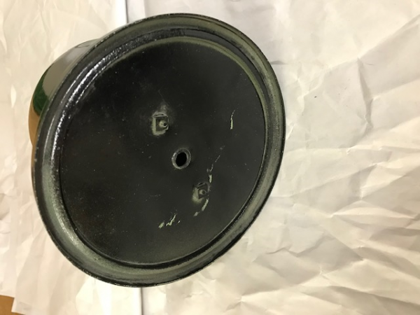

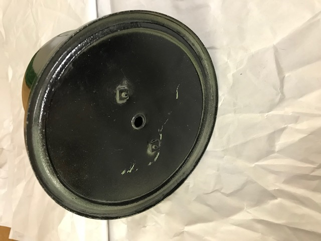

Happy New Year!! I'm trying to repair a barn find generator, but don't think it was all found.
Should there be a gasket of sorts on the bottom of the top tank? and,

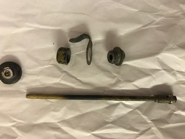

There appears to be a part(s) that control the valve stem missing or incomplete. I know the brass rod is broken at the top, but what else am I not seeing? Drawings or pictures would be appreciated.

Yes! Mine went bad and i went to a industry seal seller and had a O ring made.Cheap and it will last a lifetime! Bud.

I thought so, thanks

Anyone have thoughts on how / what to fix on water level control??

The threaded rod and seat should be able to seal off the water in the top tank,then be adjustable by drops per min.The fill cap on the top tank has a piece of brass wire through it which also is a slight vent.Bud.
