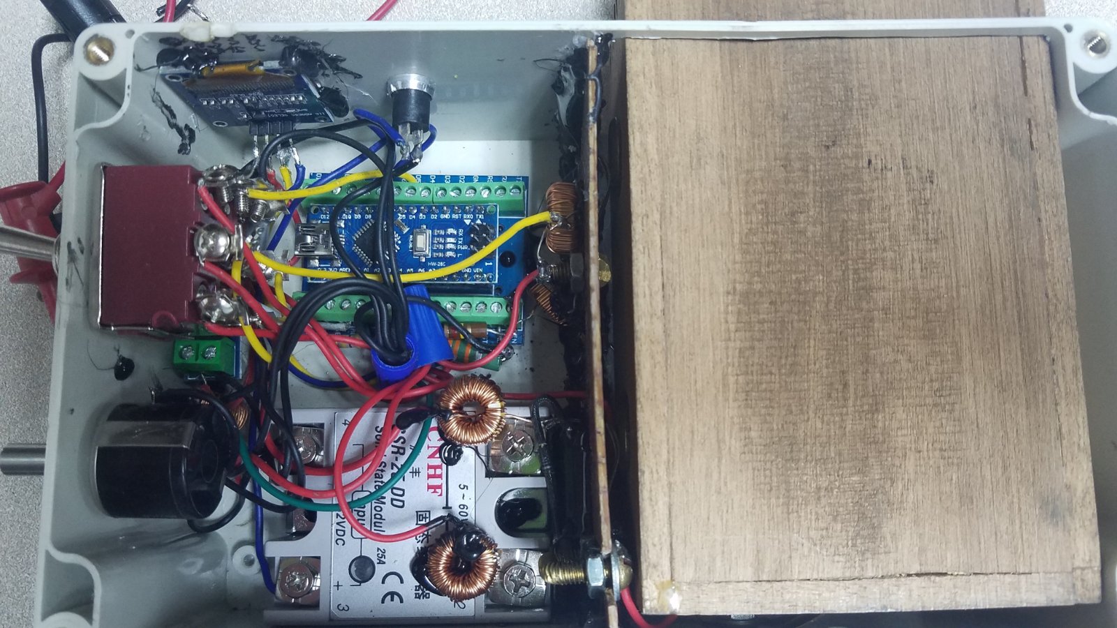

However the tester I had in mind should be portable and able to work anywhere without connection to a PC. The original idea was a small unit that would simply, easily, and reliably test coils to see if they were 'in spec' and assist in adjusting the coils if not.

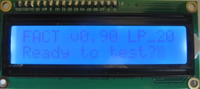

To this end I've just completed the connection of the LCD screen I had in mind at the outset, thus making the unit truly portable and able to run without connection to a PC. This doesn't finish the project because there is still quite some further beta testing and improvement/ironing out of any bugs etc to go. Additionally, having decided it would be useful, I want to add a capacitance meter, and possibly a rudimentary ohmmeter in case of any tracking between terminals across the wood (or a leaky capacitor).
However the code as it stands would make a working portable unit, so I include it here for anyone that wants to try it out. As a result of changes over the short life of the tester the original block diagram is now obsolete, so you'd need to follow the thread before connecting anything up. I won't produce a new diagram until I've settled on the other two test functions as they will require some additional wiring, but the intent is to make the basic unit even simpler to connect up than before.
Once that's done,and when the tester is more or less finished Martynn has kindly offered to draw it up so as to make it easier for anyone that wants to make one. Given this, and the attempt to 'modularise' the system I hope it should be reasonably straightforward for someone with minimal electronic experience to construct the tester, should they be interested.

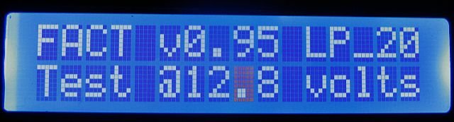

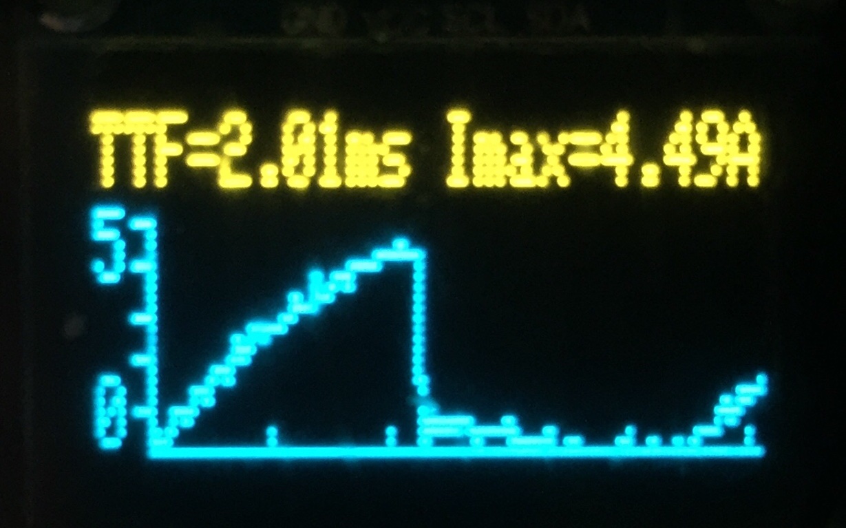

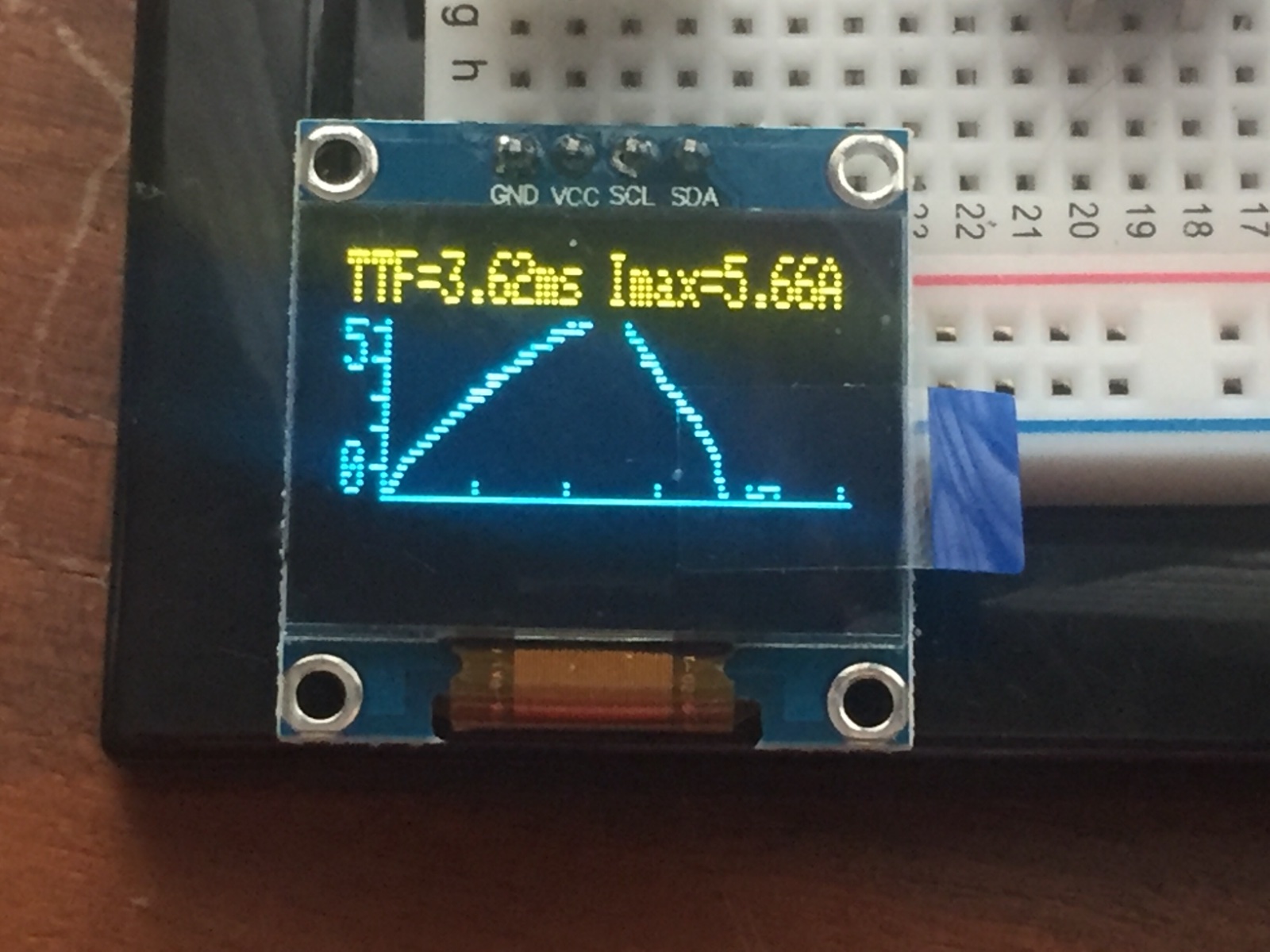

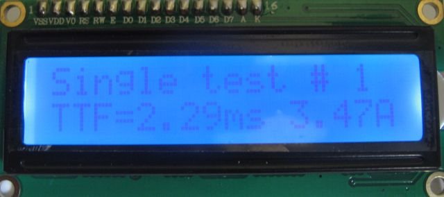

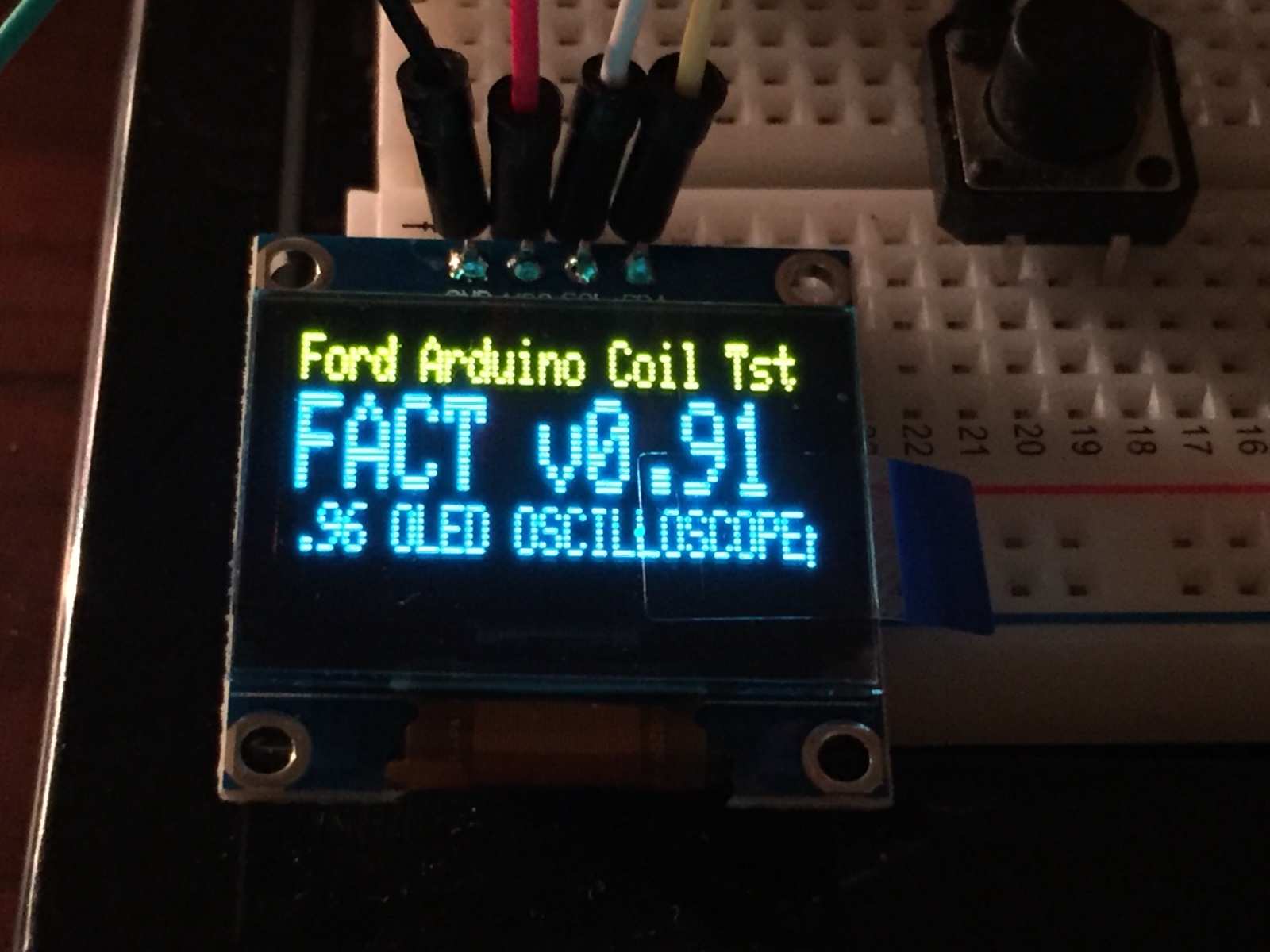

Here's what it looks like presently:
Startup display - showing software version and build number
Single-shot test results showing test number, time to fire in msec, and current in amps.

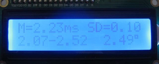

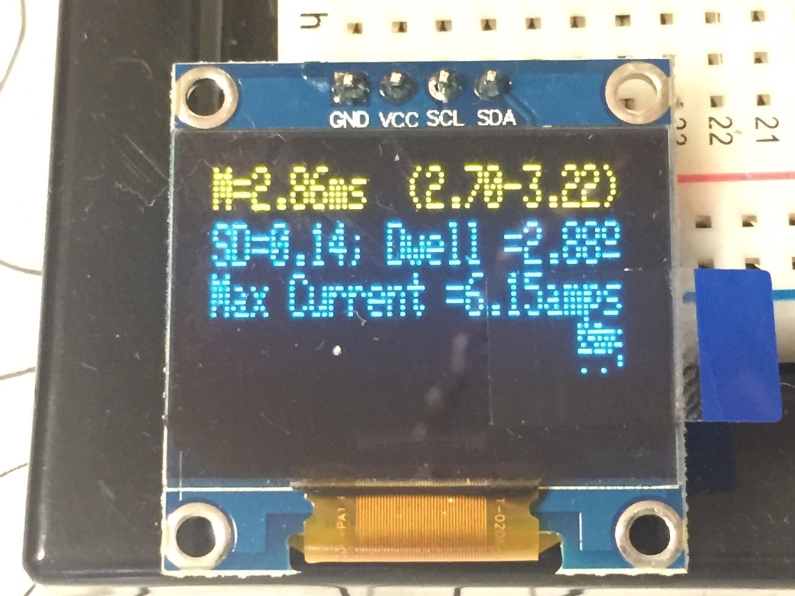

Start of multi-fire test showing RPM set
Results of multi-fire test showing mean firing time, standard deviation, min/max firing time, and degrees of rotation variabilty in firing time across the test (bear in mind this is a sick coil - JohnH's results suggest we'd expect a much smaller jitter).
Still a way to go, and as always keen to hear from anyone with suggestions/contributions and results of any tests you're doing!

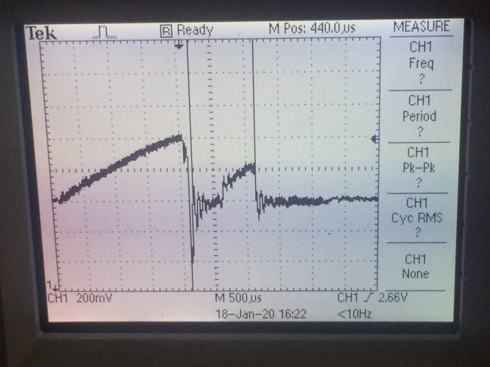

Hi Luke,
You asked... "To that end if you had a 'scope (or used the earlier code with the python plotter) and could could confirm that your 3.x msec is the main ramp and decay, or something else, I'd be keen to know?" ...Hope this helps.
VERY keen to see latest block diagram with the addition of the screen.

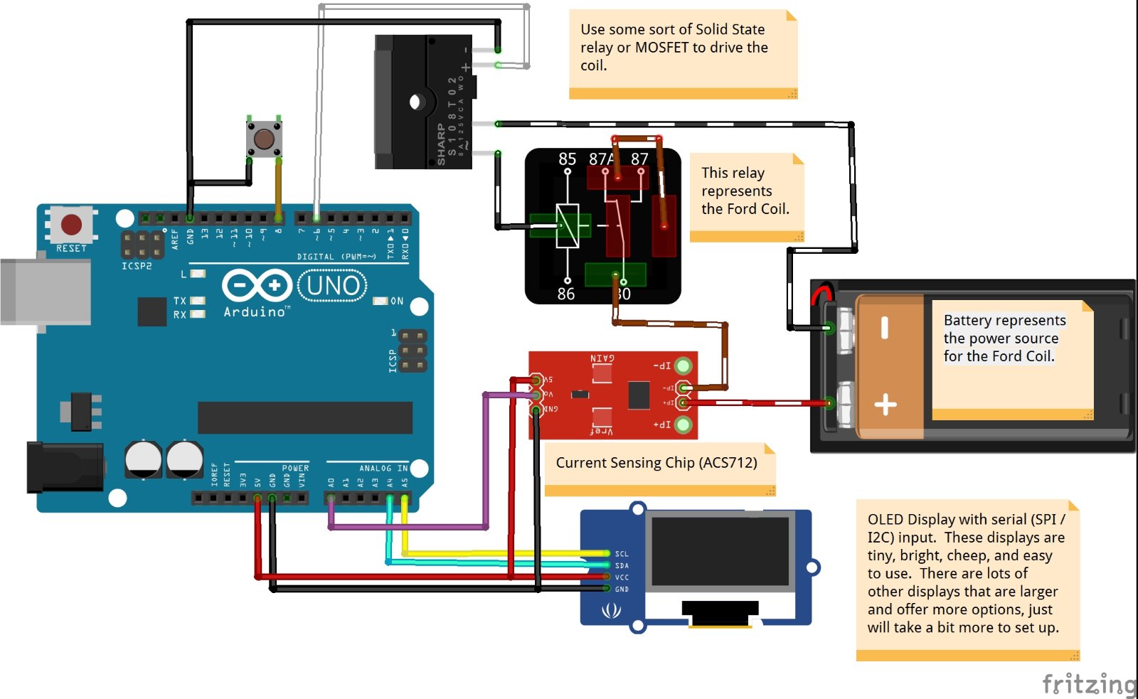

I wanted to confirm the latest Bill of Materials (BOM):
  • Price part # Description
  • $8 ATmega16U2 ARDUINO UNO R3 Development Board & USB Cable
  • $2-5 ACS712 Current Sensor Module (20A?) for Arduino
  • $3 L298N DC Stepper Motor Driver Module
  • $3-5 ??? LCD Module for Arduino
All prices are from ebay. Prices very depending on shipping location (i.e. China = waiting time).
I bring up the BOM just to confirm for myself, but also so that others can get an idea of how much the electronics cost.
Matt
Luke
Posts: 617
Joined: Fri Dec 13, 2019 1:04 am
First Name: Luke
Last Name: P
* REQUIRED* Type and Year of Model Ts owned: 1926
Location: New Zealand
Re: A new DIY electronic coil tester.
Post by Luke » Thu Jan 02, 2020 3:44 pm

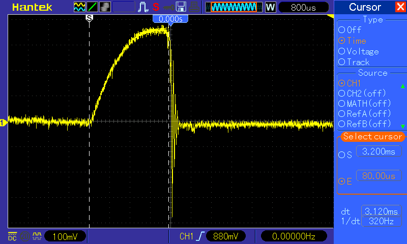

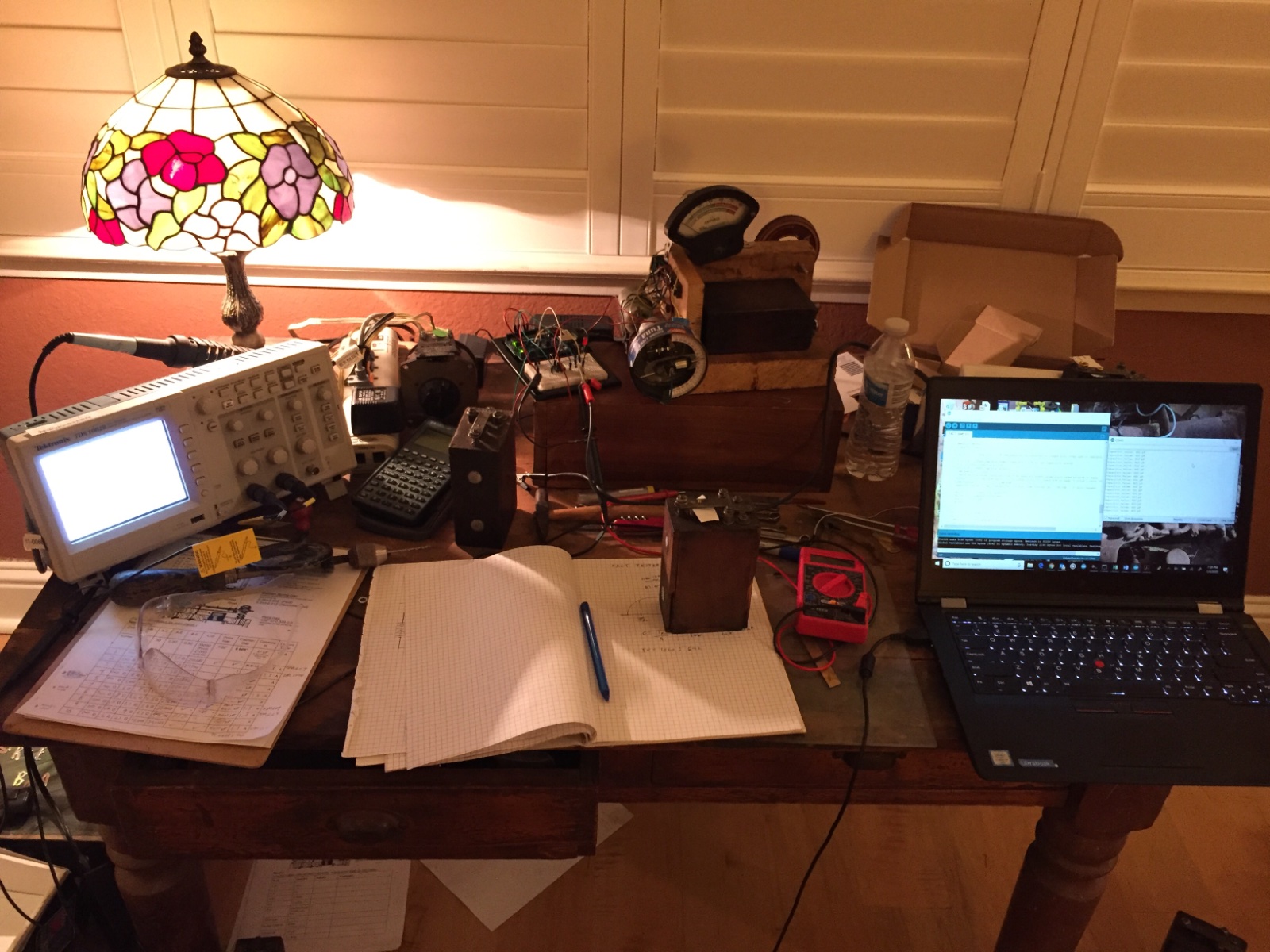

John,
Thank you, that's very helpful - your trace seems to me the epitome of what I'd thought a good coil would look like, with the possible exception of the plateau time, and with no further spikes I expect the tester will be reporting just what the trace shows.
A couple of things arise. Having re-read JohnH's article; he has good to reason to suggest that around 2msec is a good fire-time for a coil running on 12v, and more than 3msec for one at 6V. I agree with his logic in that it's more efficient and better for the coils themselves to not be on for any longer than they need to. If you're testing yours at 12V then, particularly given the plateau 'length', it seems to me it could be brought back from a timing perspective to less than 2.4msec or less.
The other is that (also given the plateau) if you're not showing any more than 4A (which I think would be right after you adjusted the ACS712 sensitivity?) then a 5A version of the sensor would be fine. It would give a little more resolution too. Should we get an overcurrent for any reason then, given how we're using them, I believe it shouldn't destroy the device as the datasheet says the devices may be operated at higher primary current levels (prov temp is kept down).
My only hesitation on that is that we've not tested many coils (at least I assume you've not!) and although the current level is in rough agreement with what JohnH reports, and what I've found, it is quite a bit less than Mike Kossor has reported in his posts, utilising his machine. It may be that Mike is also taking the reverse current peaks into account, or there's something else we're missing so until we've tested a few more coils I guess the jury is out on that. Mike?
I'm happy to put up a block diagram but in order not to have to do another in quick succession I'd like to get a working cap tester first so I know what pins I'm going to use :-)
Matt,
For me things from eBay take roughly the same length of time as direct from China, and they're generally more expensive - certainly the shipping is - so my BOM would be approx ($USD):
Arduino Nano $2
ACS712 20A $1.40
L298 board $2
Pushbutton switch $1.60 (that's for 10!)
i2C 16x2 LCD $1.95
I think I'm going to order some 20x4 LCD's for something else so will try one of them in this project - it'd mean a more intelligible display, not having to truncate things the same. The cost for them is around $3.50 so even with that the cost comes in well less than the $15 I mentioned. If we add a resistor or two and another switch to include a capacitor test then maybe we're getting closer! Mind you I've assumed that one already has some wire and a box to put the completed tester in (and a 6-12V source)...

The BOM is very impressive. If we working as it seems to be, it is well worth it. I have on order the ACS712 & L298 boards. But for now I I played more with with the MCCT and the Current Transformer. The results are looking good, but I imagine with the MOSFET switching things it will look a lot better!
LCD
As far as a display I agree a four line display is desired. I have also seen some displays with pushbuttons. That may be desired, so people don't have much soldering.

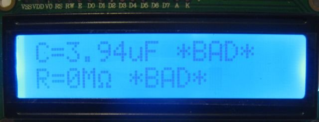

Capacitor Test
I think you could do a capacitor test buy adding a large resister in series with a output. Additionally you would want to connect a analog input between the resistor and cap. Don't forget that the points must be held open perhaps with a small piece of paper.

Some results from experimenting
Post by Luke » Sat Jan 04, 2020 2:04 am
I was going to code in the capacitor tester today but got sidetracked for several reasons.
One of these was that, in wanting to make this easy for people to replicate I'm not switching the coils the way I would do it personally (using a FET), rather I'm using a module that essentially just requires one to screw in a few wires. These modules also nicely cope with back emf, so no need to have a flyback diode etc.
Unfortunately this makes it a little harder to easily switch in and out the capacitor tester. So while I was thinking about that I thought I'd see what happened when I paralleled the two H-bridge outputs of the L298 I was using. I had wondered if it was current limiting at one point (although it wasn't apparent on the 'scope), so this seemed like a way to allay that thought.
As it turned out this gave a usable boost in current handling (the 298 is a bipolar device and as an H-bridge it has a fair voltage drop) and I could get more current at a given input voltage than before. This led me on to think about another module I had here (after making a balancing scooter some years ago - a.k.a. a segway) that could be even better - a BTS7960. This is a FET switching half-bridge with low RON and easily enough capacity to handle a Model T coil.
Having connected that up I am of the view that it's a good thing; I can now show upwards of 6A at 13.5V in, mostly I suspect due to the much lower voltage drop.
However the really interesting thing was (thinking of Tom's enquiry) when I lowered the input voltage to the coils. What I noticed was that although the current went down (and thus energy out) the timing became less erratic. If I tried a coil at ~7V it may show a SD of 0.01 and a 0.31deg variation in rotational timing at 900RPM, but if I lifted the same coil to say 13.5V it could give a SD or .12 and 2.1deg variation or so (note I'm just quoting typical results, there was some variation between each test).
Although it's a small sample set I have now tested three coils and they all show the same characteristics - timing scatter reduces at the lower voltage and, to take an example of one coil, ttf increases from ~2.2ms to ~3.5ms [mean]. I expect the latter, but not the former.
My initial thoughts are that this could be due to points bounce with a more vigorous magnetic field (and therefore contact/arm movement), however this is just surmise and I would be interested in other comments/ideas?

I've got a 2-line display here with pushbuttons and did wonder if I could utilise them. However I think for the reason I espoused earlier I might stick to a single separate pushbutton switch and perhaps a toggle switch for on/off/capacitor/coil test function (and get a 4-line display).
Yes, the capacitor test is very simple, the thing I was thinking of was how to connect it up in a way that made it easier for someone with little electronic knowledge. It would be nice if people who've never done anything like this before could have a go and be reasonably sure of having a positive result. Keeping the connections as straightforward as possible should assist that, I hope!

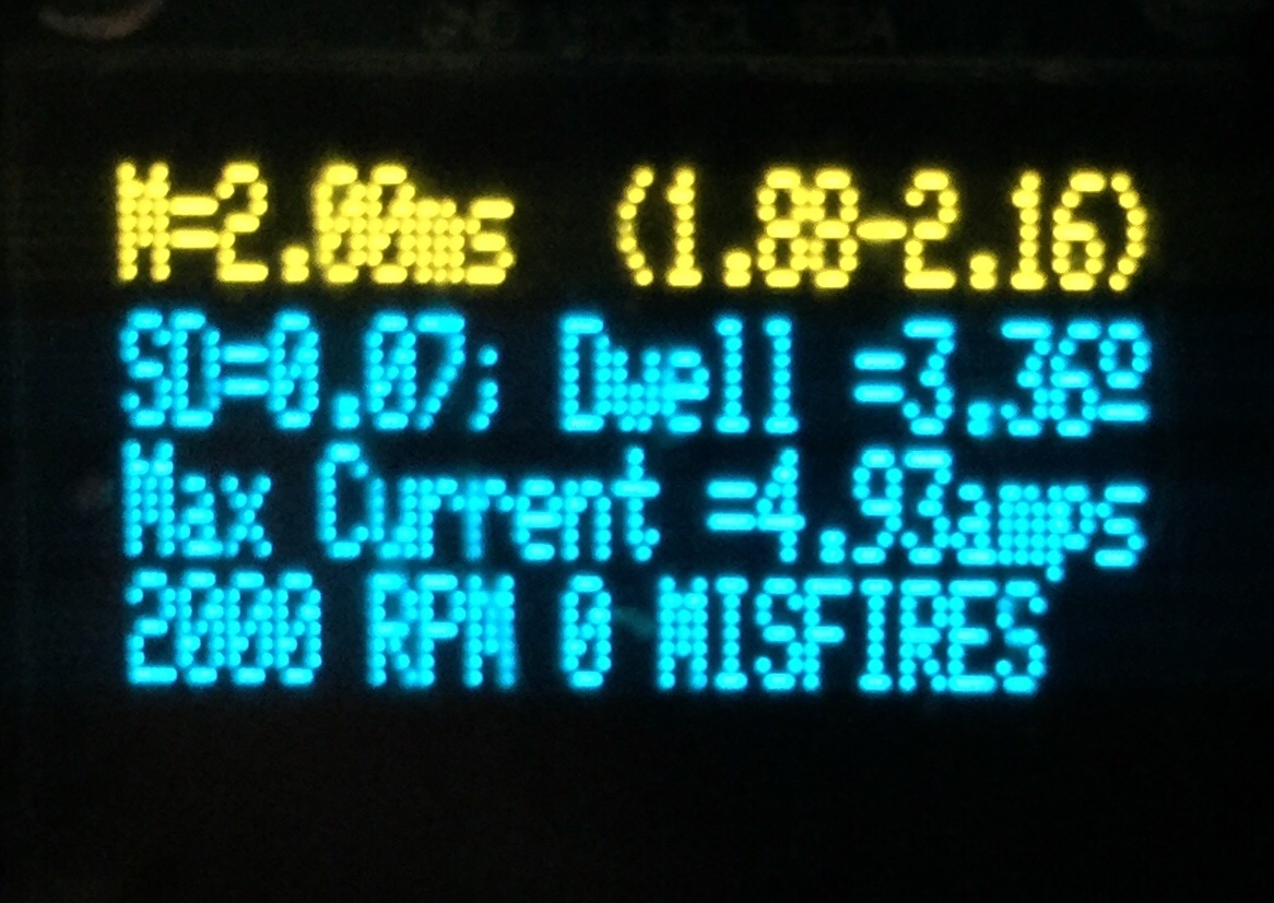

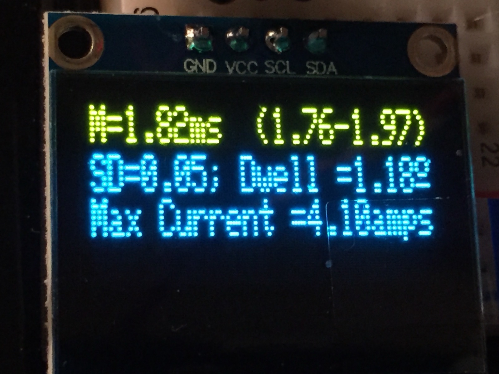

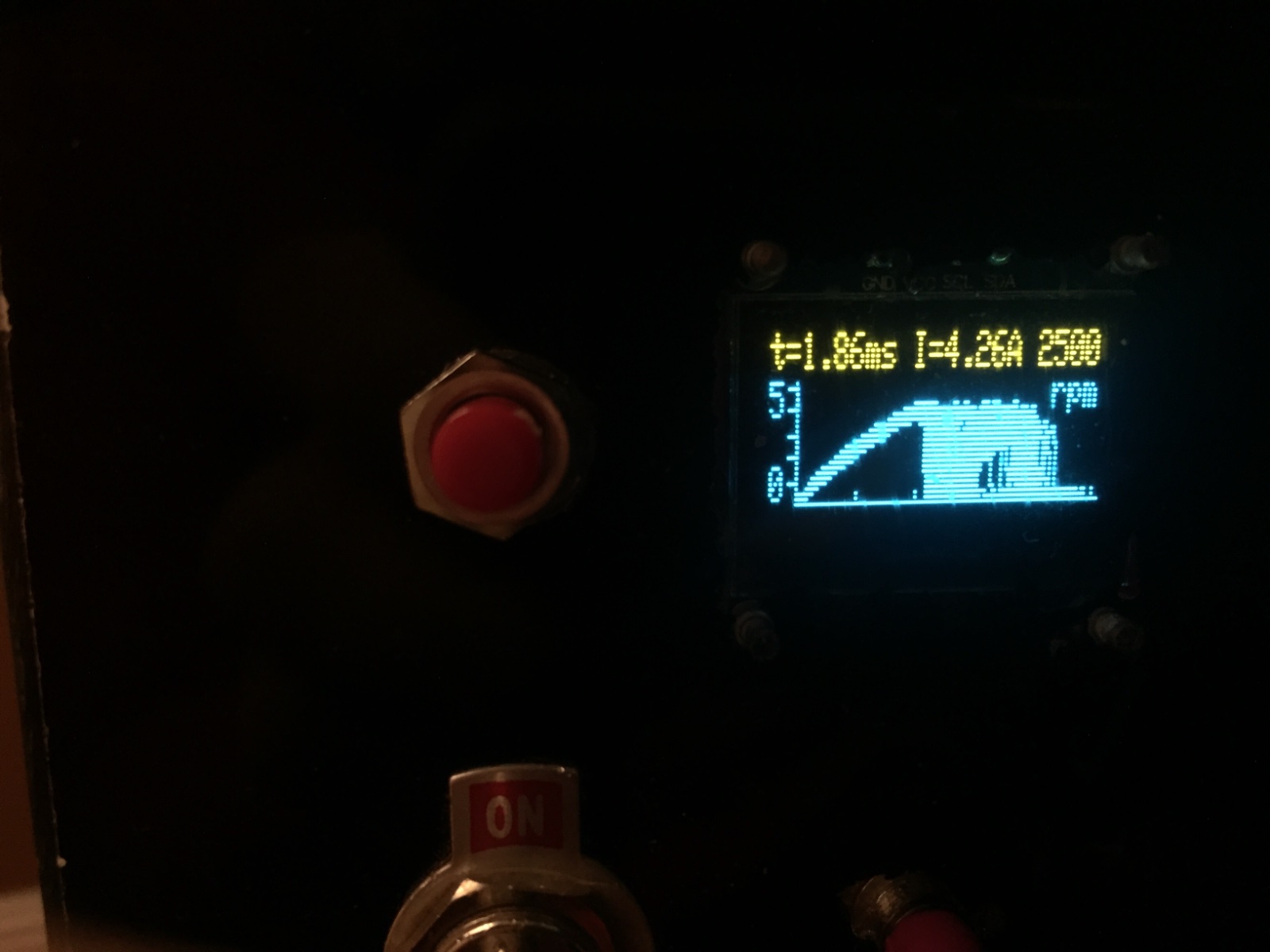

Some data from different voltage testing
Post by Luke » Sat Jan 04, 2020 5:10 pm
I had occasion to test four coils this morning. Given the intended mode of these, and the interest I had in operational voltage I did a quick comparison at two discrete voltage inputs.
All four coils were set to fire at Mean 3.31-3.33 msecs at 7V. One a multi-fire test of 50 cycles at an equivalent engine RPM of 900 they typically exhibited a standard deviation of .04.
At 12V the following typical results were obtained:
Coil 1 - Mean 2.22msec / SD .12
Coil 2 - Mean 2.08msec / SD.09
Coil 3 - Mean 2.10msec / SD .11
Coil 4 - Mean 2.16msec / SD .13
To clarify and expand a little - at 6V it was much more probable that each series of 50 firings on a single coil would give the same or a very close mean result (ie. it was quite consistent) whereas the same coils, and same test conditions - with the sole exception of the voltage change - were much less consistent. A coil could vary between Mean 2.11msec to 2.22msec at 12V, but only between 3.31 to 3.33msec at 6V for example.
I make no specific conclusion, one would need a lot more data, and be more rigorous in how it were collected and analysed to do that, however I think that if I were setting up coils for a car that was driven on battery vs a car typical driven on the mag I might set them differently...
Addendum:
All four coils had a similar capacitance at around 0.48uF but the inductance varied from 1.98mH to 2.7mH. Unfortunately I measured this later and can't now correlate between coil results above. However the difference in inductance between them is worth remarking on, and may lend credence to Tom's observations and attempt to match coils on characteristics other than just timing.

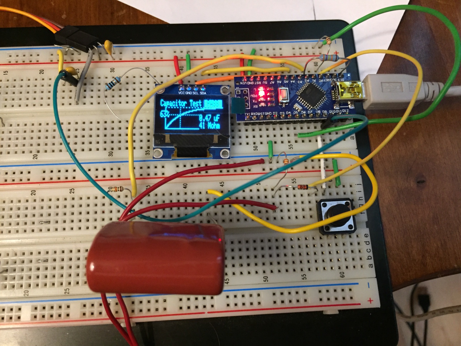

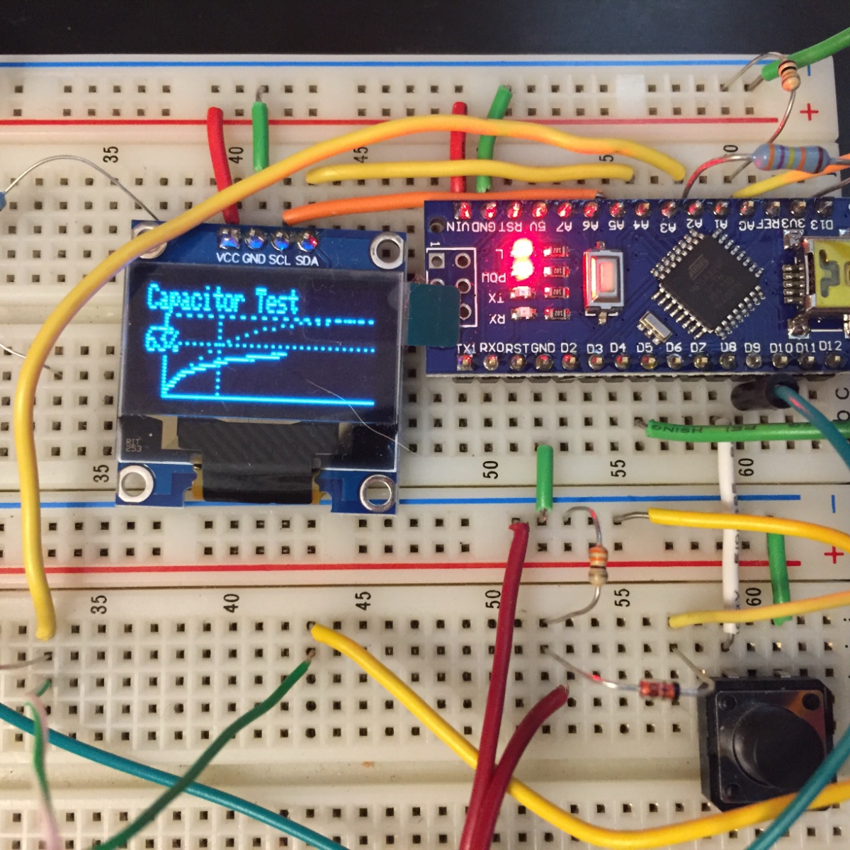

Captive Tester
Luke, I will blame you that my living room has turned into a workshop :roll:
I connected a 10Kohm resistor to an output. The other side of the resistor is connected to a analog input (A1) and the coil.
I wrote the following code to test the capacitor.
Code: Select all
     if (digitalRead(Pin_11)) //10K ohm resistor is connected to output pin; other end of resistor is connected to A1 and capacitor.
        digitalWrite(Test_Cap_Pin, LOW); //set pin 2 low so that capacitor drains
        delay (1000); //wait a second
        digitalWrite(Test_Cap_Pin, HIGH);
        time_now = micros();
        //warning this is an infinite loop if A1 does not reach value could cause program to hang
        while(analogRead(A1)<642 && digitalRead(Pin_11)); //to reach 63% voltage; 5 volts = 1020; 1020 x 63% = 642
        time_constant = micros() - time_now;
        capacitor_value = time_constant/10; //C=T/R; time_contant ms / 10K ohm  = C (Nanofarads)
        Serial.print("Capacitor_Value: ");
        Serial.print(capacitor_value);
        Serial.print(" Nanofarads");
        Serial.println();
Basically it turns on the output waits until the value reaches 63% of the full value and records this time. Since it is a 10 K resistor the actual capacitor value in pico Farads is just the time divided by 10 (T = RC or C = T/R).
I got a nice RC curve on the oscilloscope (note: it turns off right at 63%).
Here are my results on a good capacitor.
Here are my test results on different coils:
Coils with New Caps:
0.462 uF
0.475 uF
0.465 uF
0.469 uF
Original Ford Coil Capacitors:
1.433 uF
1.232 uF
1.700 uF
1.244 uF
Original KW Coil Capacitors:
0.132 uF (KW? Painted over)
0.151 uF
0.144 uF
Well if nothing else, I now have a good capacitor tester. But we need to figure out what is considered an acceptable range.

Nice work and good results. First a question, is capacitor leakage important? and if so, how difficult to measure?
I suspect the first 4 values for 4 new caps is indicative of the variation one will find in new parts. If the variation affects coil performance in a negative way, I suppose you could select and match the caps in each 4 coil set. I suspect that level of precision might not be needed, but if desired you now have the means to do so. Thanks again for all this information, jb

Good job Matt with the capacitance code I will give that a try later. Like jab35 says a leakage test of the capacitor would definitely be desirable but I am not sure how possible that would be to include in your code? A big failing of old coils is capacitor leakage. Regeards John

Yes, I don't know what it is about electronic projects but they're the messiest things around! I've taken aeroplanes to pieces (and put them back together!) that never seems to generate the same amount of cr*p :roll:
Good job with the code. You're now at the point where I was/am wrt to connecting it up to the cap under test. If it were just me it would be long done (and the switching device would be different) but I'm trying to maintain the simplest possible approach from a constructors perspective, hence the interlude to think about that.
A couple of things though - I think you might want to check your scale. Model T caps are circa 0.47uF as I recall, which would be 470,000pF. Also, in my view, they're not a precision item and anything from 0.42uF to 0.56uF or so should be fine. It'd be easy enough to test this empirically with a coil that doesn't have a cap installed (or a failed one) - you could connect them up externally and try the combination out to see how it went.
Apropos James' enquiry, and moving to my second point. In my cap tester I don't discharge at the 62.3% level, rather I use a higher value charge resistor and carry on the charge after the requisite TC point to see if there is any leakage. After a short (further) time the Arduino should read the full input voltage across the cap, if not there's a leak (which is easily calculated using Ohm's law).
To my mind while it's not common for caps to leak they sometimes do, but perhaps more importantly this is also a useful test to ensure there's no tracking on the coil box. I don't know if this is a 'thing' or not, but it's not hard to test so I include it.

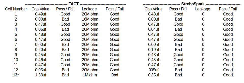

More progress

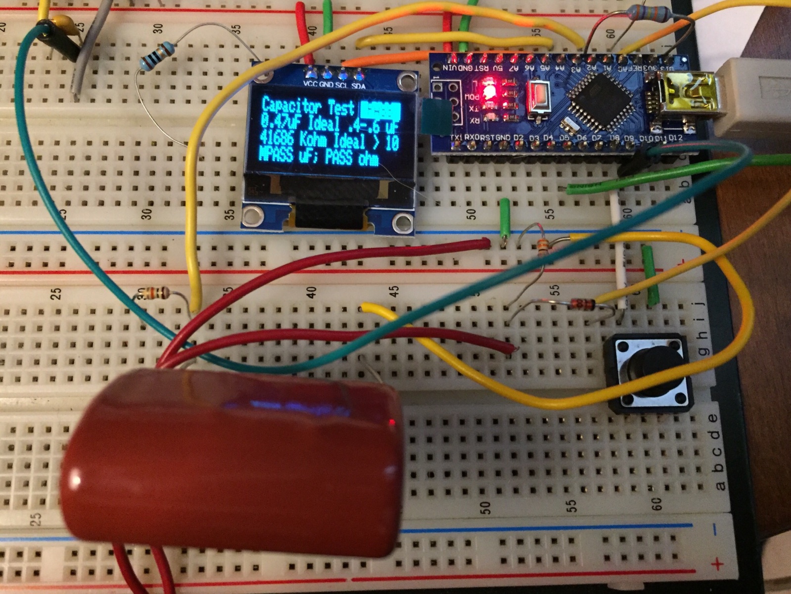

Post by Luke » Wed Jan 08, 2020 5:23 am

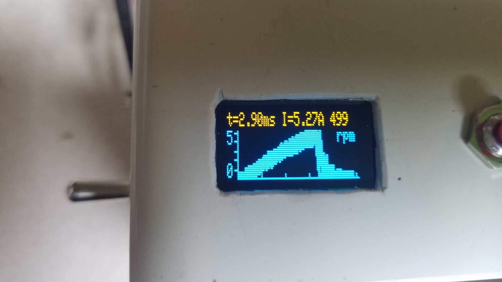

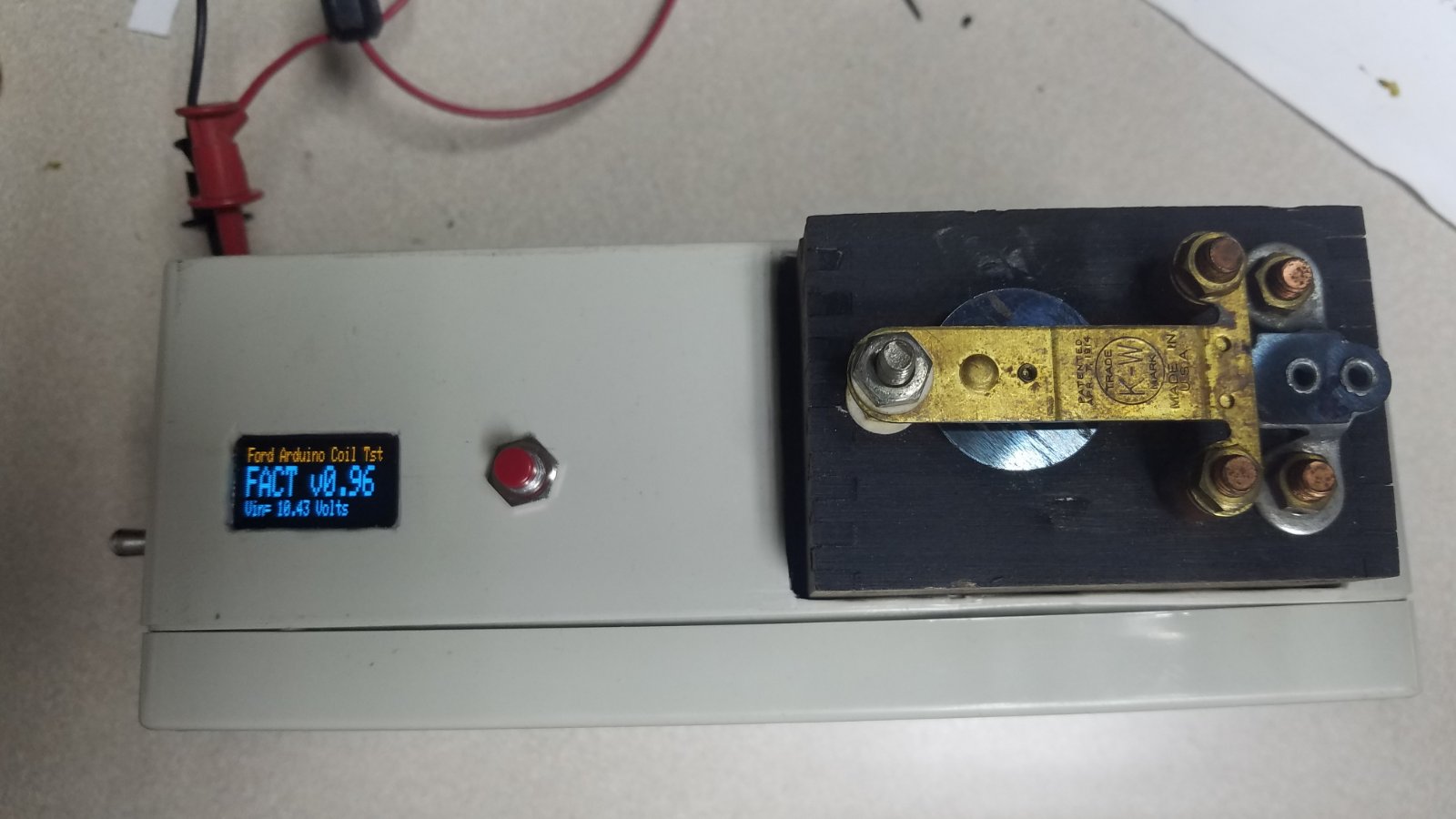

A brief report on a couple of useful things that arose today.
The first is that I was able to try out the tester on some other coils (thanks Chris), and we later tried some setup by the tester in a car.
Qualitatively the car went at least as well as it did with coils set on the HCCT. Coils set up on the 'FACT' tested well on the HCCT, and a faulty coil we'd earlier identified was also shown to be faulty in the HCCT.
The latter was a little different though, in the 'FACT' it showed as having reduced peak current cf the others (~5A vs ~6A), whereas in the HCCT it was quite a lot higher average current (3A-4A as I recall - the others were 1.3A-1.5A). A simple resistance test suggested this coil may have shorted turns on the secondary because it was showing 2.7k vs 3.3k for the others. I've yet to consider this further, so this is more information than conclusion.

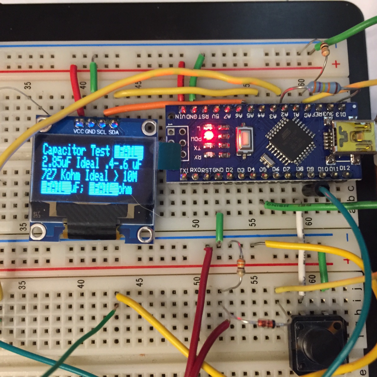

As I'd done some more on the code, and hardware wiring, we were also able to use the capacitance and leakage testing functions to ID a faulty capacitor on one of the coils (turned out to be an original capacitor), and check that the remainder were ok. This function appears to be working as expected.
Here's some more screenshots of the new function in operation:
Tester switched to cap/leak test and button pressed
Result from a good coil
Result from a bad coil
This latter coil did show a few ohms (ie. it wasn't completely shorted out) but as I'm knocking off the decimal places and reporting only in M ohms anything less than 1M will show as 0, in any event it's clearly identified as a faulty coil (which it is).
There's a bit more to do with the code before putting it up, and some testing to be carried out from there, but I think this is getting reasonably close to being a useable tool.
Chris Barker
Posts: 326
First Name: Chris
Last Name: Barker
Location: Somerset, Eng;and
Post by Chris Barker » Wed Jan 08, 2020 11:26 am
2.7 kohms is just within the range I have measured. Probably OK.
What made you think it is 'bad' - either in the HCCT or FACT?
I would be tempted to try to 'mend' (re-set) it using either the HCCT or the FACT, then, if successful, try it in the other tool.

Chris,
The faulty coil showed a low current draw in the 'FACT', and IIRC it had a reasonably high SD. In the HCCT it was also erratic, but it showed a particularly high averaged current.
These issues continued after several attempts at setting the coil, including a new set of points. Although not a perfect test the lower secondary resistance, coupled with the current anomalies, suggested possible shorted turn(s).
We need to consider this further, my recollection of the shorted turns tester I made nearly 40 years ago (for a TV LOPT) was that it used an AC signal to measure the inductive reactance of the coil. As the HCCT uses an AC source with a series AC current meter, I suspect it could effectively become a shorted turns tester of sorts.
What I don't know, and to which I ask in general, is whether it's common to have such a fault in the coils? Given their age, and the secondary voltage, and knowing how often LOPT's died as a result of shorted turns, it wouldn't surprise me - but there are several factors that contribute so I guess until we got a steer on that it's hard to know.
It's interesting that you've measure some coils at 2.7k, I assume they worked ok? Were you using the Strobospark with them, if so does that measure average current too?
Matt,
I'd deliberately reduced the precision on the resistance display because (1) I wanted to fit it on the screen! (2) I don't think it matters much - if it's more than say 20M why would one want to know to ten digits, and conversely if it's less than say 1M what does it matter 'cos it's clearly too low? Also it's a fairly crude test and I'm not sure it's highly accurate (but it is accurate enough for this purpose IMV). Anyway it's easy to change in the code if personal preference dictates more detail :-)
I'm sorry but I'm not sure I understand your question on the cap value?
This good coil had a replacement 0.47uF cap in it. That the tester displayed .01uF more doesn't bother me, I expect the cap will be a 20% component and in any event I don't think it's terribly important if it were a few nF either way in this location.
The bad coil was outside the tolerance I'd set, and had significant leakage anyway, so I'm ok with that too.
Incidentally the accuracy of both tests would improve if I were to more accurately determine the source voltage at the start. This appeared to float around a little so maybe some more work on that is warranted at some stage, but right now I think it does the job reasonably well?

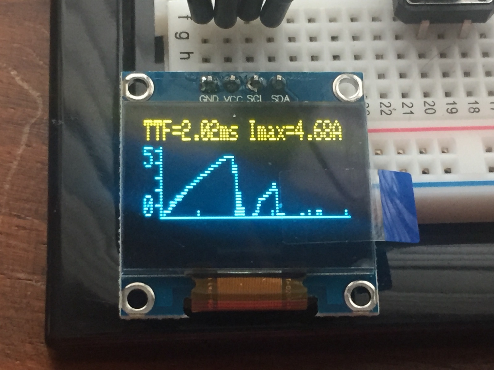

Please ignore my comments above. I confused the secondary resistance and the capacitor leakage resistance. I don't recall anyone having a concern with leakage resistance in the past. It took me a little while to understand how you were calculating the leakage resistance. I still don't have a 100% grasp on understanding the "leak" equation. I plan to do some testing in the future and see if the blue spark is greater with higher leakage current.
ACS712 & L298N- In the last few days I received ACS712 current chip and the L298N motor driver. So I was finally able to test your code to determine the standard deviation. (Prior to this I was using the MCCT and with the bounce on the switch it was not reliable.) I did use the the 20 amp current chip and changed the calculation from divide by 66 to divide by 100. I believe that the ACS712 is the way to go and we should not plan on using that CT in the future. I was not pleased with the ramp I received with the L298N chip. It became clear that the current was limiting (rounding off) and giving a waveform like Chris has above (see Jan 2nd). I connected two inputs/outputs in parallel on the driver chip got a sharper ramp as I desired (similar to Mike's post on Dec 21st). Eventually we may want to use a different driver, but I am really pleased with the results when I connect to outputs in parrallel for now.
RFI- When I do the multi test I loose USB connection with the PC sometimes. I think that noise interferes with the USB chip. It is likely that if I were able to clean up my wiring things would improve. At this point I am not too concerned because the micro-controller seems to keep running just fine. It is just an issue for me displaying stuff on the serial monitor on the PC.
LCD- I see that you are using the I2C to control the LCD. I wanted to confirm that you are connecting SDA to A4 and SCL to A5.
fritzing- I was looking at some youtube videos related to Arduino and came across some software called "fritzing". It allows you to make schematics, pictural diagrams and layout PCBs especially for Arduinos. It cost me around $8 to download. When we have a more finalized design I can draw up something. Here is an screen shot of the example LCD program (this is not I2C, so it is likely different than the wiring that you are using).
PCBs- Recently I found jlcpcb.com can make some very cheap PCB's. They have a special of $2 for small boards. I used them a couple weeks back. I had 10 2x2" boards made and it costed $18 including shipping and I had them in 1 week shipped from China. Additionally they can add SMT components for a fee. I was thinking as we settle on hardware this may be a way to go vs. multiple modules.
Matt

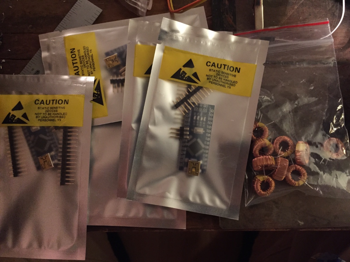

I felt it useful to to do a resistance test because I thought there could be a fault from leakage across the old coil box, or a leaky cap that might otherwise test ok.
In order to grasp how it works just consider the cap as a resistor (leak) and what you'll get is a simple resistive divider with the A1 pin of the Arduino measuring the result. Ordinarily I'd expect the 'ground resistor' (cap) to be infinite, so [once the cap is fully charged] it should present the full source voltage to A1. I hope that makes sense?
Yes I think you need to parallel the L298 outputs, you'll see I'm using a BTS7960 now... sorry, that's one of the things about public prototyping!
Likewise with the ACS712, I now believe it works better than the CT in this environment. With the latter I've had a few odd traces where I suspect there was no change in current so the output dropped to nil, even though there was current still being drawn (i.e. when the current draw was effectively DC). It's also much easier to calibrate than the CT since it has a standard known output.
I've passed my USB cable a couple of turns around a toroid, this reduces the connection issues you've noticed. If you use the unit completely standalone with the LCD it continues to run happily regardless of what's going on at the USB input. I expect that shortening the cable runs and boxing the unit would assist further, along with a little decoupling if needed.
Yes it's an i2C LCD (less wiring needed!), and you have the correct pin connections.
It would be nice to produce some wiring instructions and perhaps a PCB once the prototyping is finished. Martynn has kindly offered to draw some of this up but while we're changing things around that fritzing software you have looks useful.
As for a PCB I think if you were going down that track it may be best to solder on a simple FET with some flyback diodes etc for the switching? It would reduce the bulk somewhat, and maybe make the switching easier. Anyway that'd be a good project for you perhaps? Certainly I'm not big on PCB design these days and I've more than enough other things to do now!
Unfortunately I've still no steer as to whether shorted turns are a common thing with these coils or not? I'd hoped we may have had some responses, but perhaps no-one has come across the issue before, or has dismissed the coil as faulty for some other reason. Based on my earlier experience with LOPT's, and the issues that Chris' coil exhibited, I'd have thought it wouldn't be unheard of so I've been mulling over my ideas around a testing regime for this.
Once again it's less how to write the code or utilise the hardware so much as keeping the connections as simple as possible that's been the issue. I hope to have decided that in the next day or so. There are several ways to do it, none are inherently 'wrong', but I like to think of any possible impact a little further down the track before settling on things.

A brief update.
I made up a quick shorted turns tester. I was happy with the theory and it worked well enough in terms of what I'd expect, but in testing the Model T coils I wasn't sure it was reporting quite what I'd want (if it were faulty).
Chris has been kind enough to lend me the coil that was giving trouble and which originally led to this question. Hopefully I'll have some time to investigate further in the weekend and see how it checks out. With luck that will lead to a conclusion.
There was also another interesting development with some other coils that we tested. I won't report on this right now because there is an issue around these that needs to be resolved, but suffice it to say the tester was able to identify some specific problems that the HCCT couldn't. This isn't to put the HCCT down, it's just a function of the different and additional capability of this device.
Of course I've now been apprised of a further possible test function that could be useful, but perhaps I should stop for the moment :geek:

One could include an inductance test in this tester but, as John rightly comments, if you can adjust a coil to where it needs to be and there's a decent output then is there any advantage in going further? I don't want to over-complicate the tester unnecessarily, hence my call for those with experience to comment on the issues they've found, and if it's a non-issue then we can dispense with that..
I guess what piqued my initial interest was this odd coil we tested a few days ago. As I've now got it and can run further tests I need to check it out to see how its inductance pans out and whether it's significantly different to any other. Even if it proves to be then I think for all the effort it may be better to simply use an external inductance meter for the odd time such tests would be useful.
With regard to the coils you're saying fail the resistance test - in what way? Are the they completely open-cct, or just higher resistance than they should be? Assuming them to be completely open then yes I'd tend to agree with your surmise on a spark jumping the break.
Not completely clear on your comment re making the coils fail, but I should think that running them completely disconnected on the output wouldn't be the best idea around. More so than a megger I'd anticipate this could result in arcing across areas you wouldn't want things to track, however a 1/4" - 3/8" gap in free air should be ok at the output (and is what I use).

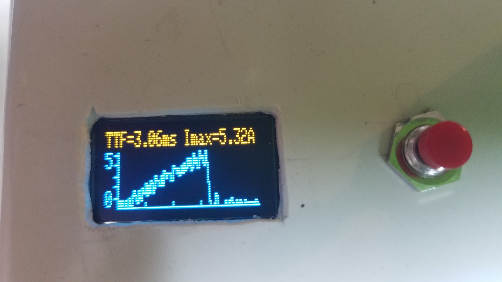

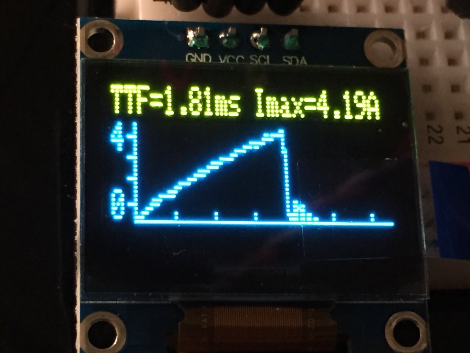

Yesterday I received this display and stayed up late making my $5 Oscilloscope (for the display only)!
Here is what I got on my Tektronixs real scope:
Here is what a good coil looks like on the 128x64 OLED display.
Again on a coil that has issues (double spark?):
You can see it on the cheap display:
I have some ideas on improvements, but as I said I stayed up to late last night. And even these results are satisfying!
Matt
Last edited by Matt in California on Thu Jan 16, 2020 1:30 am, edited 1 time in total.

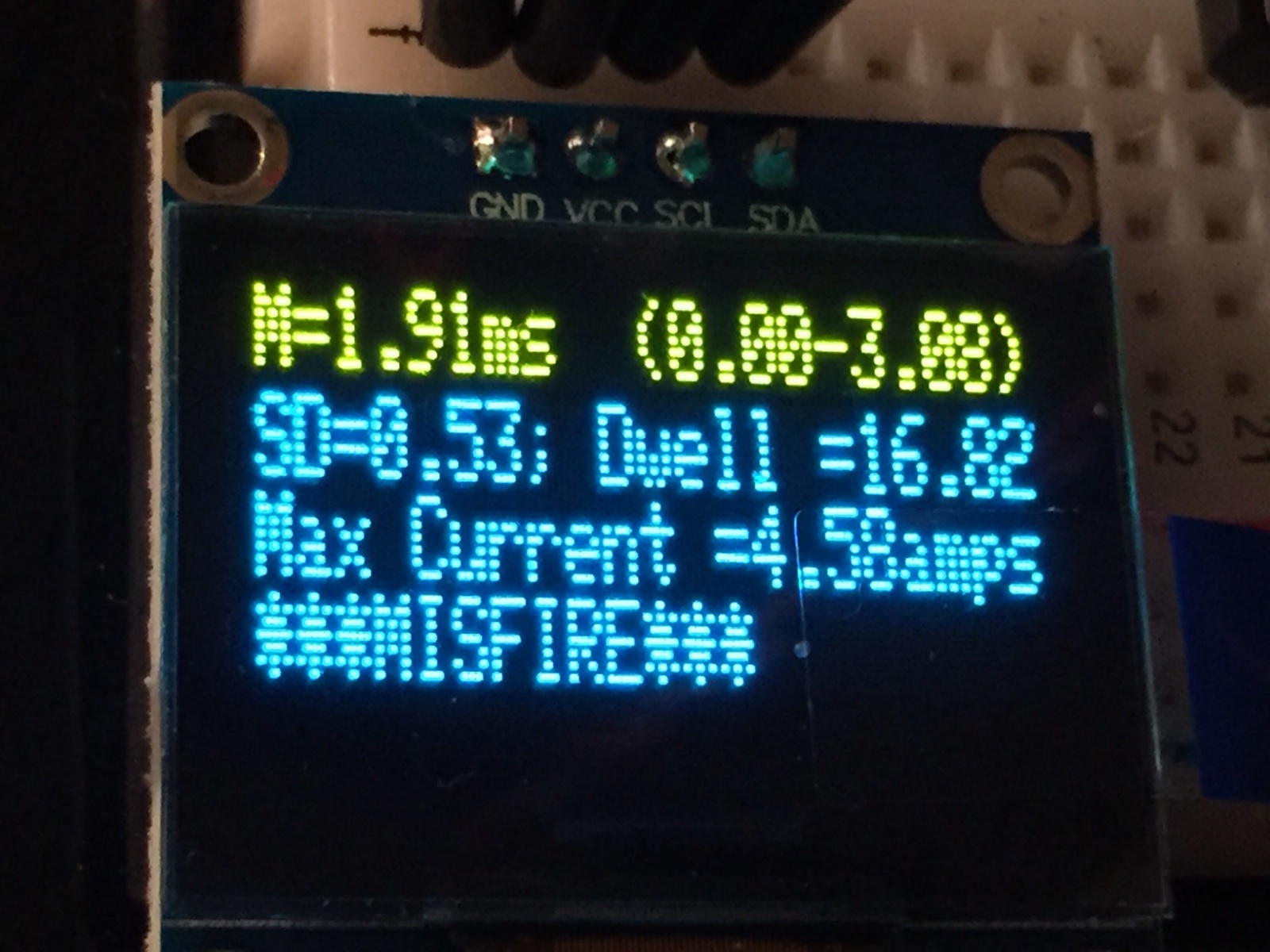

Here is the multi-fire test results:
Here is when I forced a misfire (just to verify the display):
Enjoy,
Matt

I worked on the Oscilloscope a bit. I needed to adjust things, so that I could see issues with bad coils.
Here is a coil with a double spark:
Here is a coil that was not sparking very well. But notice it is obviously getting plenty of current.
The reason it doesn't have a sharp drop on the back side of the ramp is because the points never open.
I am still working on the code, but if anyone is ready for the OLED IIC (I2C) Display code, I can post it here. Just let me know. I am looking into a larger display, but I the touchscreen that I got is not I2C and takes a lot of I/O pins. A larger touchscreen would be nice.
Anyway, I am now ready to try to make a match set of coils. I understand that we want 2ms dwell. But wanted to confirm the operating voltage and the desired current.
Matt

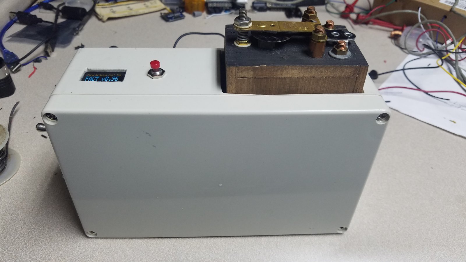

Someone contacted me regarding wiring up there own. Here are the parts that I am currently using:
  • Solid State Relay- I am using the L298N motor driver with two inputs/outputs connected in parallel. (Luke is using BTS7960.)
  • Current Sensor- I am using the ACS712-20Aamp chip/board.
  • OLED- I am using the0.92 inch 32X128 I2C display. This is a tiny, but powerful display. I would like to find a larger display because I want to make an Oscilloscope for another project, but in reality this tiny display is doing the job and could be idea for making a small coil tester.
  • Microcontroller- I am using a genuine Arduino Uno. I don't see any issue going smaller or using a generic as long as the voltage levels are correct for the peripherals (5 volts in my case).
Picture Schematic-Here is my attempt of making a schematic. I found that the Fritzing software does have a ton of different Arduino add-ons. Not necessarily generic ones, but close enough. In the future it would be nice to make a shield (a board to plug into Arduino) with the push button, solid state relay, current sensor IC and a header for the display. Here is my attempt:
If anyone sees any issues let me know I will fix them and update the picture above. Yes, you will need a battery larger than a 9 volt battery :roll:
I hope that this helps anyone attempting to build one of these. Obviously these are still in development, but I imagine more than one person who is lurking on the forum is attempting to get in the action.
Matt

Matt, nice job indeed. That oled screen form factor looks more like 128x64 rather than 128x32? If so I have one in my junk box so would be interesting to have a play if you are prepared to share your code? I have Lukes 1602 screen and his code here running at the moment, works well. Thanks John

Post by Luke » Sun Jan 19, 2020 7:01 am
Matt & John,
I use a Nano, it's a bit cheaper/smaller than the Uno, and you can solder directly to it if you want. It has the regulator just like an Uno so you can run it on 12V. Just commenting here - there's nothing wrong with the Uno!
With the diagram just bear in mind there's another switch to go in when I have a moment to review the code and post it. This to switch in the capacitor/leakage test. Sorry I've not got to that yet but as it's past 0100 here I'm not going to do that now!
I do intend trying a Nextion screen when one arrives for a different job. These are connected via serial and should allow some control back to the tester, as well as provide a reasonable display (they're available in several sizes). Downside is that they only have M$ based software to lay them out :x
So for me at least there's still some prototyping going on. While I think the code is working reasonably well - and it's pleasing to hear that from John too, thanks - I'd suggest if you wanted to make a board up it might be useful to hold off in case there are any more changes'/additions that come along. I should add that, in addition to the cap test, I include a source volt meter in this later code because it's important to know the supply voltage for the absolute timing value.

Post by Matt in California » Sun Jan 19, 2020 10:49 pm
John,
I bought the display as a 0.96" 128x64, but even if you look at the pictures I think you can count and see it looks like a 128x32. (My understanding is these 0.96" come in both sizes.) I also switched to SCREEN_HEIGHT 64 and nothing displayed) Perhaps I made a mistake, either way please let me know your results either way.
Here is the code that I have:

  Arduino   device
  Ground    OLED ground
  +5VDC     Vcc
  A0    input for data read from curren sensor (5 VDC limit)
  A1
  A2
  A3
  A4    SDA (if no SDA pin)
  A5    SCL (if not SCL pin)
  1
  2
  3
  4
  5
  6     Output to Solid State Switch (MOSFET)
  7
  8     Pushbutton (other side connected to GND
  9
  10
  11
  12
  13

You will see for the most part I just commented out the code that Luke make and put my own in.
Luke, The Nextion display looks great! Please enlighten me on what is needed to develop code for that. I would like to find something a bit cheaper, but something like these would defiantly make an amazing display. I posted with the Uno because that is what I am using, but I agree there really is no major difference. Could you please send me the info on the wiring changes? I can just update the drawing above. (BTW I am using pin 6 because I burned out pin four on my module.
Jeff, I agree that $2 for a pcb is amazing and I appreciate your experiences in the past, I can relate. My brother-in-law shared with me a story of how he used the mask upside down, and he really needed to complete a board so he bent all the IC pens upside down on each chip...
As the design seems to solidify I look forward to making the "shield" board.
Matt

Version 0.95
This version introduces testing for capacitor value and leakage of the cap or across the box. This is a useful check to run through before first testing a coil as it will determine whether it's worth going further and/or it may confirm certain characteristics of the firing test (excessive sparking at the points etc).
The tester will also display the test voltage in use when first turned on. Given some of the things we've discovered I think it may be worthwhile for some to test their coils at different voltages, but more importantly this allows flexible adjustment of a target TTF based on the input voltage.
Remember that a lower voltage returns a longer TTF, and if we assume it's a reasonably linear relationship it should be a simple thing to automatically calculate and include the target time within the code and display as necessary. This display could take the form of presenting the target time alongside the test time, or internally comparing it with the actual test time and declaring the coil a pass or fail - or some variation on this.
At this point I've shied away from being so definitive but it may be time to consider it now? JohnH, I seem to recall you saying that the optimum time at 12V was 2msec, and at 6V it was something around 3.3msec? Was that dead on 12V (ie. not 13.8 or whatever?), and do you still consider these times to be optimum?
Connecting it up
Here's a quick/rudimentary block diagram of how to connect things up.
I view the tester as still in prototype so this could change somewhat, and whatever screen, switcher, and current sense you use could affect the connections you'll need, however it should be enough to get a keen person underway
Before you power it up I suggest you check for any wiring mistakes (mine included!), there's definately no warranty here!
Some more detail below.
Capacitor test
Cap test is via resistor from D13 to A2, then from A2 to one side of the coil input, the other side to ground. I used a 487k resistor, which is why that value appears in the code, but it could be anything reasonable (100's of k's). You can just change the code to whatever value you wish to use. I happen to have some odd value resistors and this one fitted the bill for this task.
When this test is run the connection to the high-current switching device needs to be cut, and an input on the Arduino grounded to tell it which test is to be conducted. To this end I used a double-throw triple-pole toggle switch that takes the two wires to the coil and connects them either to the two pins above (A2 + GND), or the switching device. It also grounds pin D5, telling the Arduino we're performing a capacitor test.
It's important to get the switching right because otherwise A2 could receive some unwanted inputs well above its capacity!
In order to run the test the toggle switch needs to be in the correct position, and the coil points held open via an insulated device (pen etc, or you could just stick some plastic between the points). Once ready just press the main switch once.
I've previously shown LCD screen shots you'd expect here. There is no change to them.
Voltage test
Voltage test conducted via a resistive divider from +ve & -ve in to pin A7 (A7 being the centre point where the two resistors connect to each other). The higher value resistor goes to +ve, the lower value to -ve. The ratio should be around 3:1 or 4:1, and be in the 10's of k's or more. Again I just happened to use what I had on hand, and you can set the values you're using in the code, as you'll see.
Voltage will be displayed by the initial startup screen. If you change the input supply and want to re-check just reset the Arduino (or if you turned it off to change it will correctly display the new supply voltage).
At some point this will probably update itself as changes occur. Here's a shot of the the present initial screen.
Operation
As the code is at present the system should continue to work if either, or both, of these new test facilities are not physically connected. IOW if you just upload this code it should work, although the initial screen wouldn't display the correct voltage.
On that, I've not included some of the niceties that one otherwise might if this were for a more wide-ranging test unit. In this case we've got a relatively homogeneous device under test, with an anticipated capacitor value and leakage, time to fire, and current draw, and we use a limited input voltage range. As a result we have expected outcomes within a certain range and anything outside of that can simply be treated as foreign - but at present it may give an 'odd' reading in some cases rather than nicely zero something, or declaring it void.
These things can be addressed as part of a final tidy-up, once the dust has settled on the main function(s) of the tester and it's running more or less as we'd like.
As always please let me know if you run across any bugs, have some useful input on what we might expect from our tests, improvements to contribute etc:

    lcd.init(); // setup the LCD for printing
    lcd.backlight(); // turn on LCD backlight
    lcd.print (F("FACT v")); // initial text on lcd display at startup
    lcd.print (ver); // prints version number from define
    lcd.print (F(" LP_20")); // build number
    lcd.setCursor (0,1);
    lcd.print (F("Test @"));
    lcd.print (input_volts,1); // print voltage to 1 decimal place
    lcd.print (F(" volts"));
    lcd.blink();
    lcd.createChar(0, omega);

void single_test()
    int maxv, ttf, test; // declare variables to use
    mVolts = 0.0;
    collect_data(&maxv, &ttf, &test);  // get data from collect_data function
    //collect_data(&maxv, &ttf);
    // uncomment two lines for ACS712
    mVolts = (maxv / 1024.0) * 5000.0; // raw analog read val to millvolts
    amps = ((mVolts - 2500.0)/66.0); // millivolts to amps (utilise scale factor for ACS sensor range
    // uncomment for CT
    // amps = (maxv * .0222); // millivolts to amps (utilise scale factor for CT
    // write results to serial port
    Serial.print (F("*** Test number "));
    Serial.print (test);
    Serial.println (F(" ***"));
    Serial.print (F("Total cycle time (to fire) = "));
    Serial.print (float(ttf)/1000.00); // convert to ms
    Serial.println (F("msec"));
    // write results to LCD
    lcd.clear();
    lcd.setCursor (0,0); //set cursor first col, first row
    lcd.print (F("Single test #"));
    lcd.print (test);
    lcd.setCursor (0,1); //set cursor first col, second row
    lcd.print (F("TTF="));
    lcd.print (float(ttf)/1000.00); // convert to ms
    lcd.print (F("ms"));
// DEBUG    Serial.println (maxv);
// DEBUG    Serial.println (mVolts);
    Serial.print (F("Maximum current = "));
    Serial.print (amps);
    Serial.println (F("A"));
    Serial.println();
    lcd.print(F(" "));
    lcd.print (amps);
    lcd.print(F("A"));

void multi_test()
    // do some calcs on rpm as needed for delay (four-stroke, so single cyl ign fires every second cycle therefore div 2)
    byte rpmdelay = ((60000 / rpm)*2) - (interval/1000);  // attempts to roughly account for time in data_collect process ('interval') - byte means not much slower than 500RPM
    y=0;  // reset array
    // begin proper
    for(byte i = 0; i < numTests; i++)  // number of test firings
       resultVals[y][0] = (ttf); //1st col of result array gets ttf
       resultVals[y][1] = (maxv); // 2nd col of result array gets max current
       y++; //increment array
/* use for debugging output from collect_data function
    Serial.print ("*** Test number ");
    Serial.println (" ***");
    Serial.print ("2Maximum current = ");
    Serial.print (long(maxv) * 120.5);
    Serial.println ("mA");
    Serial.print ("2Decay time = ");
    Serial.print (ttf);
    Serial.println ("usec");
    Serial.println();
       delay(rpmdelay); // sets 'rpm' delay between each test firing,
   testnum = 0;
   float results_sum = 0;
   float results_std_dev = 0;
   float msec_ttf = 0;
   float results_mean = 0;
   float results_var = 0;
   float results_max = 0;
   float results_min = 10;
   boolean miss = 0;
   byte discard = 2; // first few results from multi-test show higher ttf than normal, discard to give more accurate result
   for(byte i = discard; i < numTests; i++) // get results from each test and print to serial
       testnum = (testnum + 1);
       Serial.print (testnum);
//       Serial.print (float((resultVals[i][0])/1000.00)); // convert to ms
       msec_ttf = ((resultVals[i][0])/1000.00); // convert to ms
       results_sum += msec_ttf;
       if (msec_ttf > results_max)
           results_max = msec_ttf;
       if (msec_ttf < results_min)
           results_min = msec_ttf;
       Serial.print (msec_ttf);
       mVolts = ((resultVals[i][1]) / 1024.0) * 5000.0; // raw analog read val to millvolts
// uncomment for CT
//       amps = (long(resultVals[i][1]) * 0.02222);
//       Serial.println (mVolts);
    results_mean = (results_sum / (numTests - discard)); //get mean of array results for ttf ***using testnum cost of discard
    for(byte i = 2; i < numTests; i++)
        //results_var += pow(results_mean - (float((resultVals[i][0])/1000.00)), 2); // get variance
        results_var += pow(results_mean - (((resultVals[i][0])/1000.00)), 2); // get variance
        results_std_dev = sqrt(results_var/(numTests - discard)); // get std deviation ***using testnum cost of discard instead numTests
        if (results_min ==0)  // if we have a 0 for ttf it suggests firing issues
         miss = 1;
    Serial.println ();
    Serial.print (F("Mean time to fire = "));
    Serial.print (results_mean);
    Serial.println (F("mSec"));
    Serial.print (F("Standard deviation = "));
    Serial.print (results_std_dev);
    Serial.print (F("Results Max = "));
    Serial.print (results_max);
    Serial.print (F("Results Min = "));
    Serial.print (results_min);
    Serial.print (F("mSec"));
    if (miss)
     Serial.println (F(" *** MISFIRE ***"));
    else
     Serial.println();
    Serial.print (F("Range = "));
    Serial.print (results_max - results_min);
    Serial.print (F("Degrees of variation at "));
    Serial.print (rpm);
    Serial.print (F(" RPM = "));
    Serial.print ((results_max - results_min)/(float(60000 / rpm)/360));
    Serial.println (F(" degree(s)"));
    // LCD print
    lcd.clear();
    lcd.print (F("M="));
    lcd.print (results_mean);
    lcd.print(F("ms"));
    lcd.setCursor (9,0); //set cursor 9th col, first row
    lcd.print (F("SD="));
    lcd.print (results_std_dev);
    if (miss)
        lcd.print(F("***MISFIRE***"));
    else
        lcd.print(results_min);
        lcd.print(F("-"));
        lcd.print(results_max);
        lcd.print(F("  "));
        lcd.print ((results_max - results_min)/(float(60000 / rpm)/360));
        lcd.print ((char)223); // let's print the degree symbol!
        Serial.println();
        lcd.print(F(" "));
        lcd.print (amps);
        lcd.print(F("A"));

void cap_test()
    mVolts = 0;
    int cap_time = 0;
    int r_volts = 0;
    long r_val = 487000; // charge resistor value in ohms
    float cap_val = 0.0;
    long leak = 0;
    digitalWrite(cap_chg_pin, LOW);
    lcd.clear();
    lcd.print (F("Capacitor test"));
    lcd.print (F("in progress..."));
    delay (90); //ensure the cap is discharged via charge pin low
    digitalWrite(cap_chg_pin, HIGH); // use digi pin 13 to charge the cap via a resistor
    time_now = millis();
    for (int i = 0; i < 2000; i++)
        time_gone = millis() - time_now;
//        delay (1);
        mVolts = analogRead (A2);  //use analog pin A2 to read volts across unknown cap
        Serial.print (time_gone);
        Serial.print (" - ");
        if (mVolts <= (source_volts * .632))
            cap_time = time_gone; // time at which cap charge has reached 63.2% source_volts
     cap_val = ((float)cap_time/r_val) * 1000.0;
     leak = mVolts * r_val / (source_volts - mVolts); // calculate the resistance of the unknown resistance (leakage) in voltage divider cct
     lcd.clear();
     if (leak < 0)
         leak = 20000000; // if we get variable source volts then could go negative - may need to say 're-test!'?
     Serial.print (cap_val);
     if (cap_val > 0.4 && cap_val < 0.6)
         Serial.print (F("uF"));
         Serial.println (F(" **OK** :)"));
         lcd.print (F("C="));
         lcd.print (cap_val);
         lcd.print (F("uF *OK*"));
     else
         Serial.println (F(" **BAD** :-("));
         lcd.print (F("uF *BAD*"));
     Serial.print (leak);
          if (leak > 10000000)
          //if (leak > 10000000 || leak < 0)
         Serial.print (F(" ohms"));
         lcd.print (F("R="));
         lcd.print ((leak)/1000000);
         lcd.print ("M");
         lcd.write (0);
         lcd.print (F(" *OK*"));
     else
         lcd.print ("M");
         lcd.write (0);
         lcd.print (F(" *BAD*"));

Luke,
I have been running old version FACT without capacitor tester very successfully. Just looking to upgrade it to your latest version but I am having some difficulty understanding the switch wiring arrangement in your diagram. Is the switch a 2 way 3 pole switch you are using? Thanks John.
Luke

Yes it's meant to be a triple pole two-way switch - not my best diagram I'm afraid. It's simply there to switch the coil to either the FET/H-bridge, or the cap test pins on the Arduino. I agonised for some time over the best way to do the switching, by the best way I mean the simplest for others to reproduce, not sure I achieved that, sorry.
If one continued down this track (rather than using electronic switching of some sort) I have a quad-pole triple throw switch that to my mind would be ideal. This would be centre off, one side to cap test, other side to coil test, the fourth pole being simple power on-off to the whole thing. They're less than $2 and keeps the switches on a completed unit down to two - this one and the press switch.

I now have the latest FACT version running with the capacitor tester. I have 13 coils to restore here so did FACT / StroboSpark capacitor comparison check. The results are below which are pleasingly comparable except coil 13. The Strobospark has an analogue meter which is not as easy to read as FACT but I did my best to be as accurate as possible. They all agree capacitor pass / fail but I am unsure why the Strobospark did not read any leakage on coil 13 also the capacitance readings for this coil are very different. I measured it on an external capacitance meter and it was 0.68uf, different again, I suspect this is something to do with the leakage. As I restore these coils I will continue doing FACT / StroboSpark comparisons along the way.

John,
Thanks for putting that data up, and good to see the correlation.
The way I've done the cap/leakage test is fairly crude but should be good enough for this purpose. In some instances it could report things a little differently than another tester might, but in terms of pass/fail I'd be reasonably confident of what it says. Certainly that last coil warrants some investigation.
Slightly puzzled re the penultimate coil though - was that a typo or did it really read 0.005uF on the Strobospark, and the 'FACT' 0.05uF ?

I apologise but I'm still waiting for components to arrive before I do much more on this. They're taking a very long time, I assume it's to do with the virus.
As I don't have an OLED screen the same as Matt's I can't test any changes I'd make to the code, hence it's best that he does that at this point.
I'm keen to utilise a different screen for my next version, as the OLED units seem a little small for this task (?) and typically don't offer control input. Although ordered in January I'm still waiting for that as well as other things...
I also wondered about trying an e-ink display out of an old e-book reader, but there's only so much time so perhaps someone else could give it a go?
John Housego

Well I boxed mine up and decided to use a larger 4 line screen, its been working great! I agree with Luke it needs a larger OLED style screen also I would like to see a way of measuring double sparking so a combination of Luke's and Matts software would be ideal on a larger screen.

Bravo John! That looks great! Is that An OLED or LCD display?
Luke and everyone,
I did order a larger 1.3 OLED, but it looks like I received the same display:( I took my tester to a Horseless carriage meeting and asked people twice my age about the display side/readability. They all seem satisfied. Yes it is small, but the numbers are readable. If we go larger how large should we go?

Good to see it in a box, and with the 4-line screen. That's what I was going to leave mine at, but Matt's idea of showing the ramp etc is a good one.
It may be possible to have both the LCD and OLED screens running if you'd want - as long as the i2c address of each unit is different, and the Arduino has enough residual memory. In this way you could increase the trace size as it wouldn't be necessary to report figures on the OLED screen.
Otherwise I mentioned that I've had a larger screen on order for a while, not sure how it'd go and until it arrives and I have time to interface it I won't be able to report on that, sorry. Like Matt I've got busy after the christmas break and have somewhat less time right now.

Well, well, well! I hope someone finds this entertaining. Things came to a halt on the weekend for me. The EMI burned out my Adruino last weekend. I bought some coils and a handful more boards.
Matt

Update:
After some work I was able to get the FACT electronics in the box.
closed case
closed case
FACTO 1.jpeg (73.01 KiB) Viewed 47479 times
Case open
Case open
FACT0 2.jpeg (72.63 KiB) Viewed 47480 times
Here is a shot with a single test oscilloscope (one of three time to fire tests).
Here is a 50 test ensemble and average time to fire and current:

I did get the capacitor test working.
Here it is with a good replacement capacitor with the graph:
And now more details:
Here is a bad capacitor:
I believe it is helpful to have the graphing function to see the issues.
I code is now a bit more refined. I plan to post a updated version soon.
Enjoy;)

Pin Connections
Arduino device
Ground OLED ground
+5VDC Vcc
A0 Input for data read from current sensor (5 VDC limit)
A1 Input for RPM_Set control potentiometer (0-5 VDC)
A2 Input from where timer connects to coil (note resistor connects to D13)
A3
A4 To OLED/LCD SDA (if no SDA pin)
A5 To OLED/LCD SCL (if not SCL pin)
A6
A7 Input to measure power 6-12 VDC (R1 ~10 Kohm A7 to ground, R2 20-30 Kohm to input power)
D1
D2
D3
D4
D5 Input Cap Test switch (other side connected to GND)
D6
D7 Output to Solid State Switch (MOSFET) to connect where timer connects to coil
D8 Input Run Test Pushbutton (other side connected to GND)
D9
D10
D11
D12
D13 Output Cap Charge Pin (connect to A2 with a resistor 300-500+ Kohms)

   Added code for .96" OLED.  This code also is set up for graphing current.  Set numReadings = 150 (170 caused trouble).

I was hoping that someone would take a detailed look at the code that I hobbled together. Your response shows that you paid attention to details and yes I (not Luke) left some things for you to find.
Item 1: capturing more samples than what was intended
Thanks for pointing this out. Each sample represents on pixel of screen on the OLED display. Rather than take the time into account I decided to just delete that. The only risk is that it may look like a double spark, but I think with the auto adjust scaling for different voltages it should be okay.
Item 2: array index out of bounds
You are correct I replaced 'x <= numReadings' should be changed to 'x < numReadings'
Please note I made the changes and edited the post from April 19th. My thought is if I post the code too many times it will get very confusing if it is only minor changes.
Also, JohnH tested the code and told me it seemed like the voltage display (at start up) was off. I just doubled checked and for me it was .3 volts high.

I finally finished my coil tester today. I’d like to thank everyone that contributed to this project. Now I need to get my spare coils setup.
Steve

Steve,
It puts a big smile on my face to see your set up! Nicely done!
I like the box that you put it in! I think it was a great idea to use the breakout board with the Aurdino Nano. It was a real hassle for me to try to solder and fit everything in. I didn’t even accomplish the capacitor test in my main unit, I did it separately because I had too many issues with EMI... so I would say that yours is better than mine. What are you using to trigger your coil (i.e. MOSFET)?
I really need to make PCB to avoid the spaghetti wiring. wonder how your graphs look, I get a good amount of noise likely because of the wiring picking up EMI.
Great job!

Post by sedalia » Sun May 31, 2020 12:44 pm
I also have noise on my display. I believe it is usable as it is. I’ll try to setup some coils and see how it goes.
I’m driving my coil with a dc solid state relay.
Steve
