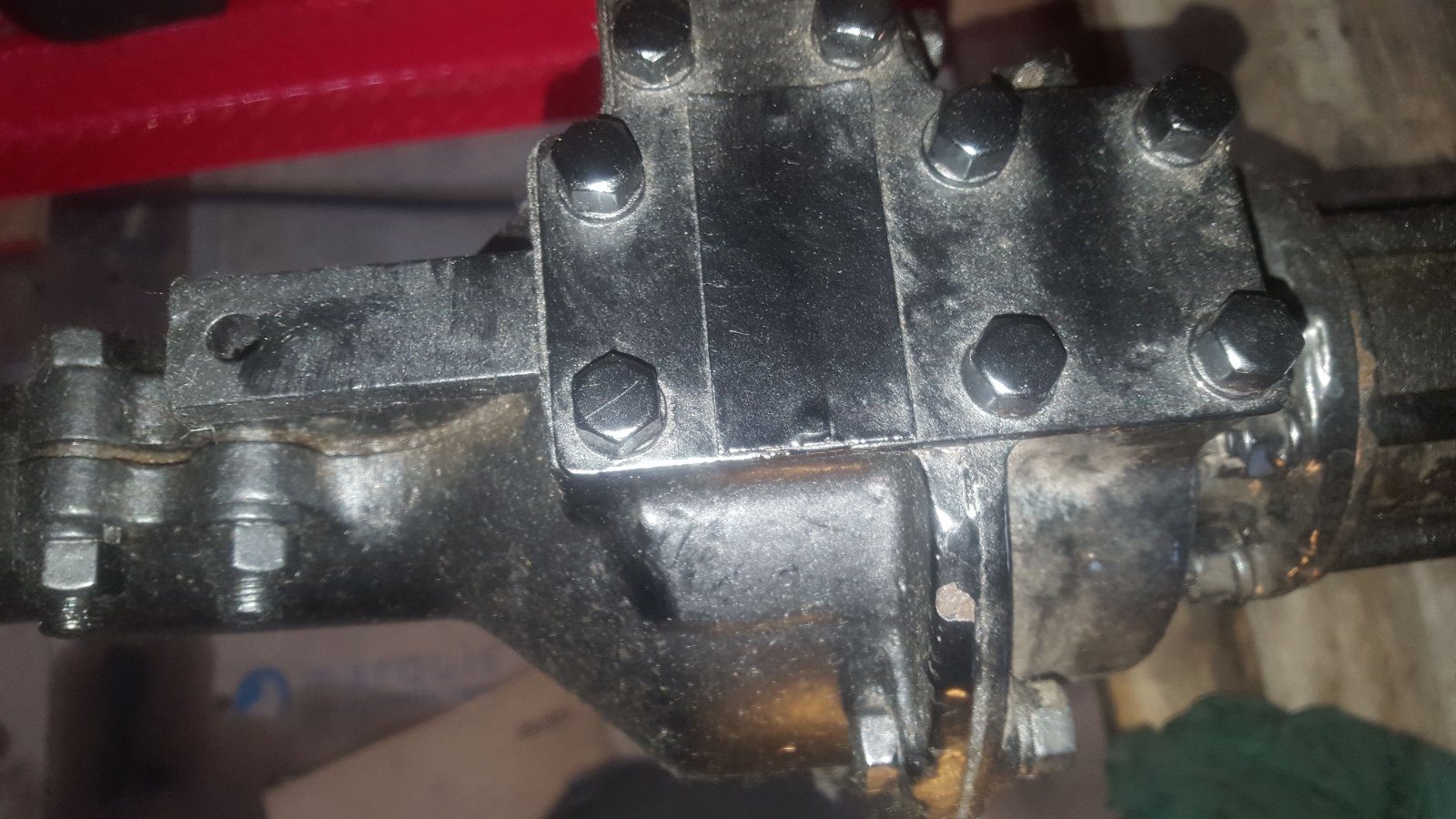

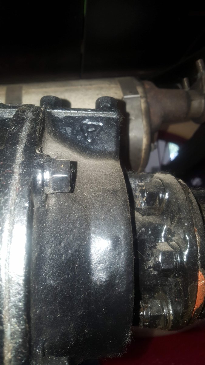

Help ID this auxillary transmission - Planator

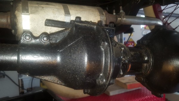

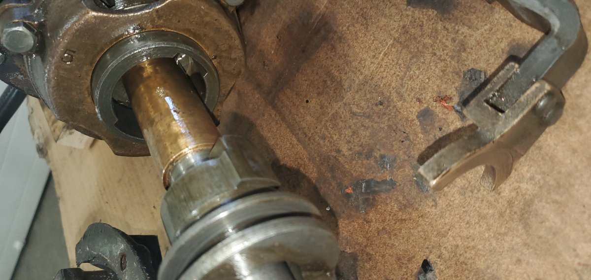

Mounted in front of rear axle spool.
Side view. Piece outlined against muffler is how unit is shifted, not sure which way is which. Close up of P in a triangle Top view

Re: Help ID this auxillary transmission
Pretty sure it’s a jumbo planatar. It appears that it may have been locked into one position.
Tim, why do you think it is locked into one position?
I don’t see the shifter mechanism on it. If it’s a jumbo, I don’t think that flat plate should be there. I have a complete one here. If you need better views to decide what you have there, just ask.
This looks just like what I have.
I see it now, Chris. I’ve not seen a shifter mechanism like that before.

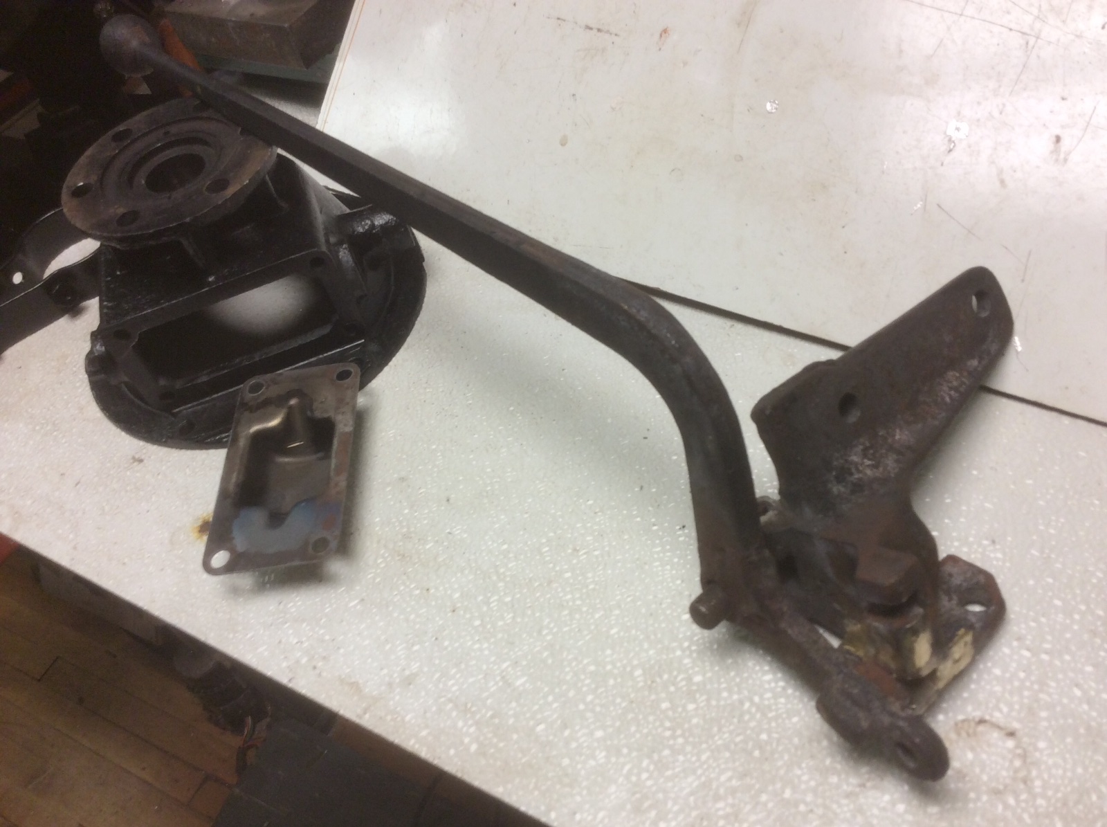

ChrisB
Topic author - Posts: 405
- Joined: Thu Jan 03, 2019 1:38 pm
- First Name: Chris
- Last Name: Brancaccio
- * REQUIRED* Type and Year of Model Ts owned: 1909 Roadster 1915 Coupelet 1923 Coupe 1926 Touring
- Location: Calgary AB
I'm pretty sure it is in direct at the moment as I have been driving the car without a shifter for a couple of years now.
I will fiddle with it tomorrow to see if I can shift it.
I have purchased a left hand Ruckstell shifter from one of the vendors but have not installed it yet.

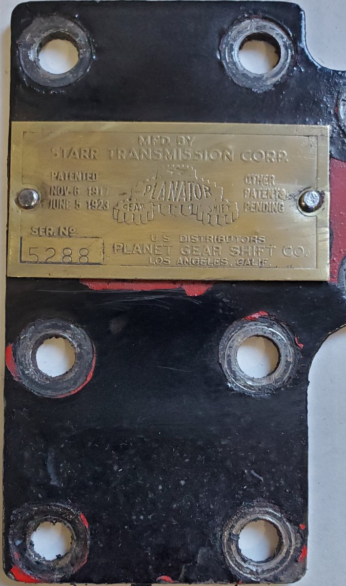

It looks to my like a Starr Planator. They later sold out to Jumbo. I have three of them here. They are all slightly different. Two are for Jim Burns in Texas, the third is a parts one for those. The shifter was a problem in the Starr. Jumbo made at least two different designs.
Without looking up some notes and doing some searching, here is how I remember the story behind these.

How far should the shift rod move from high to low?
I tried moving it by hand today. Out (towards the front of the car) seems to be high which is where it has been for the last couple of years.
It wants to move in (towards the back of the car) but I can't get it to go very far.
I have a left hand shifter but I can't use that until I determine where the arm needs to go and weld it on.

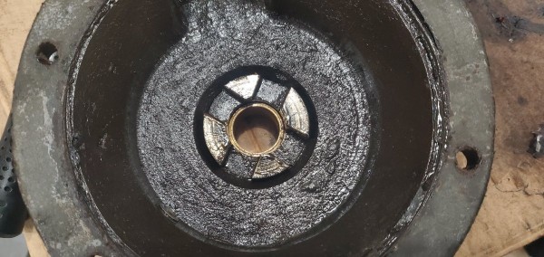

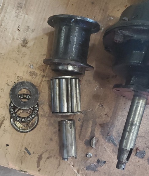

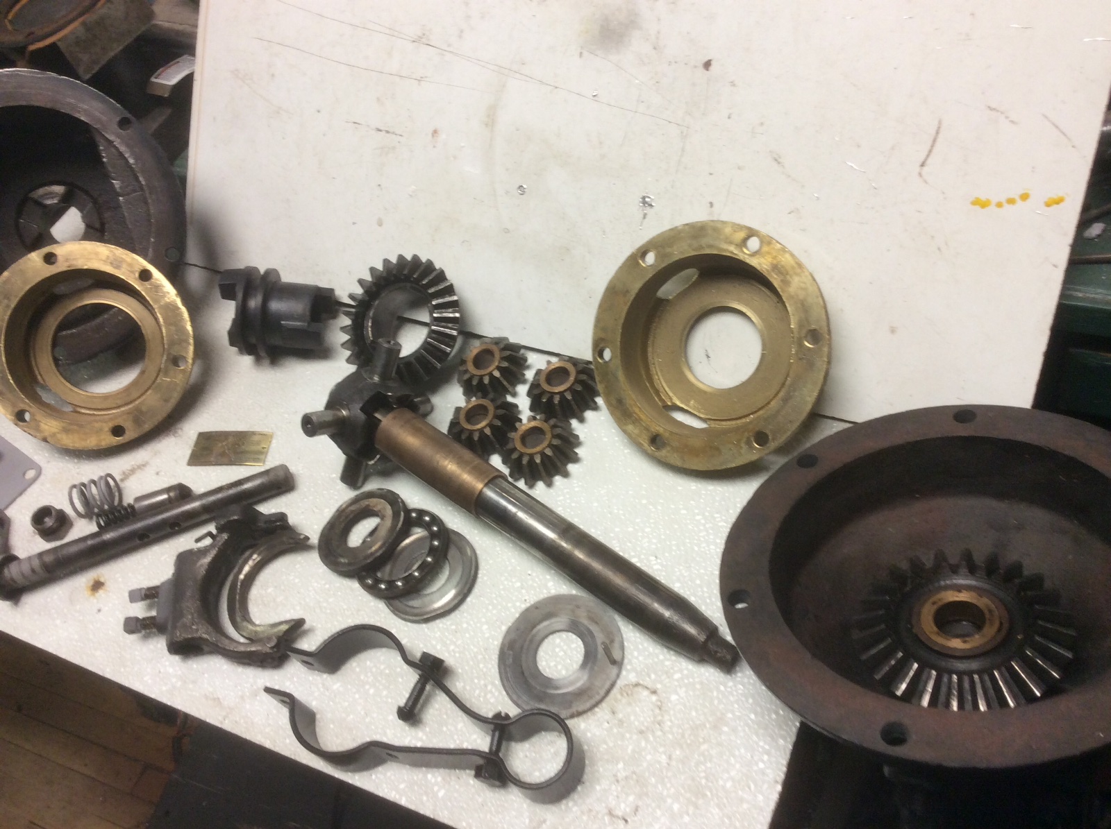

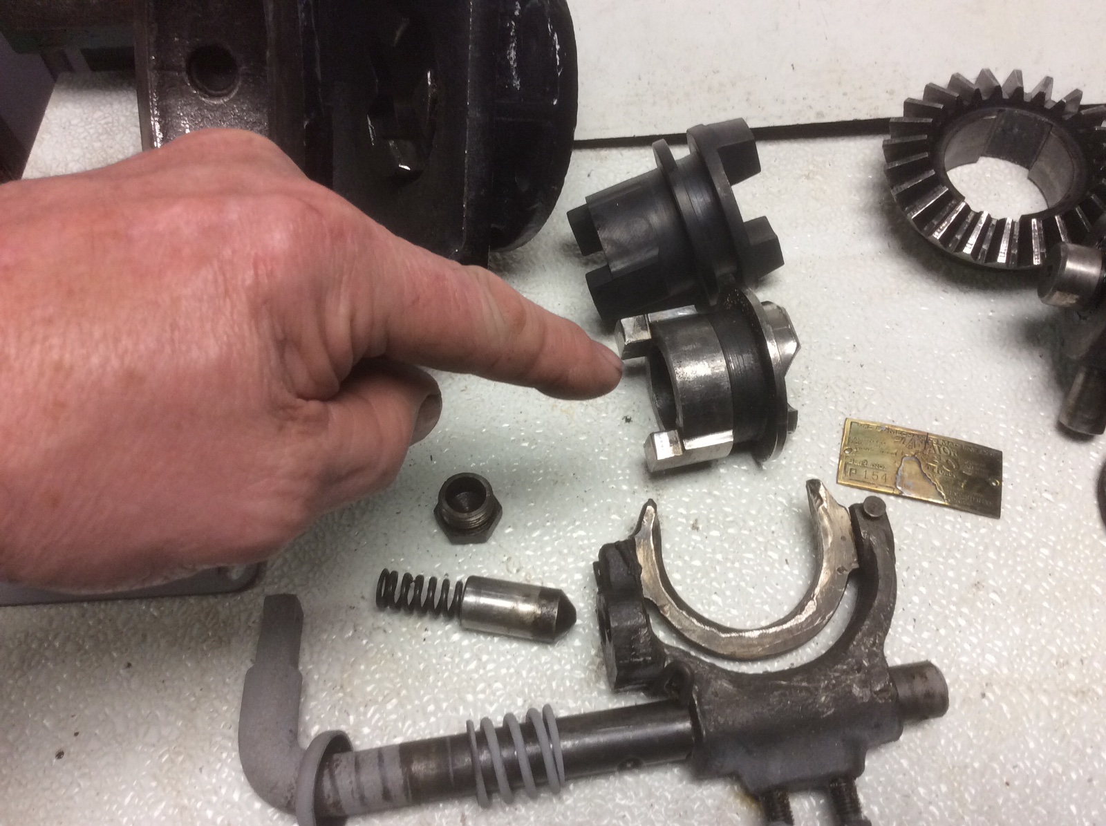

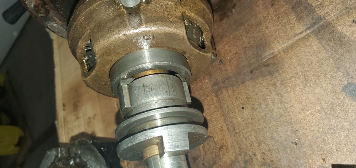

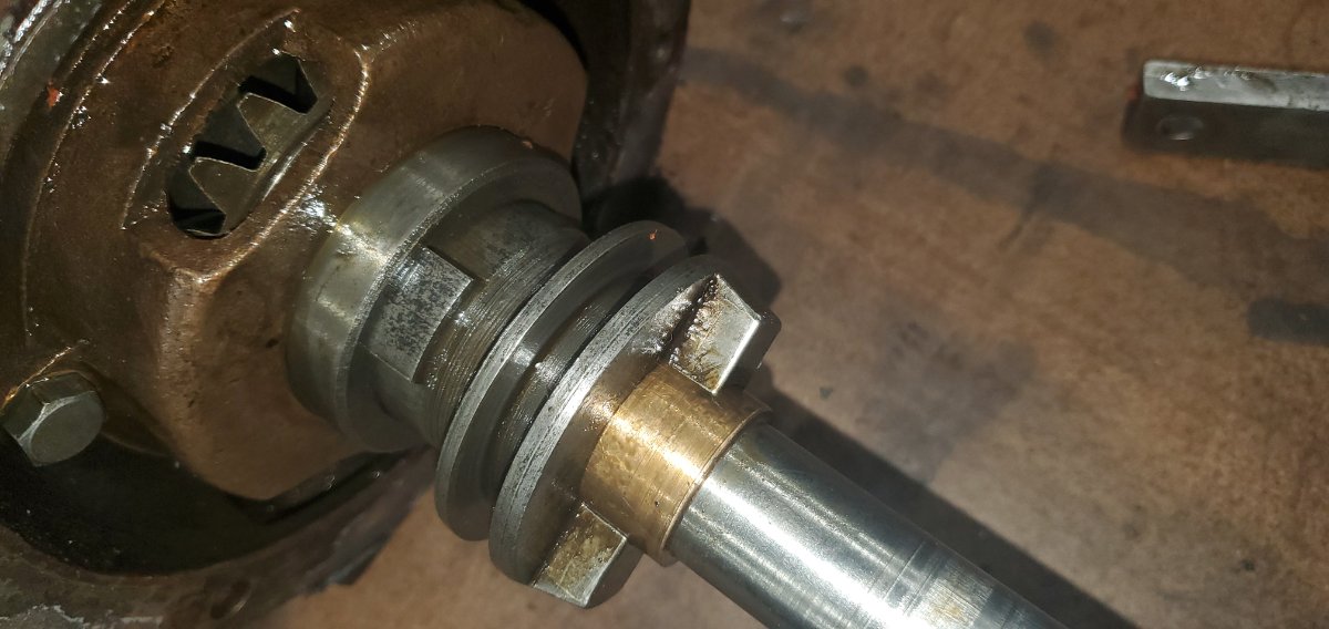

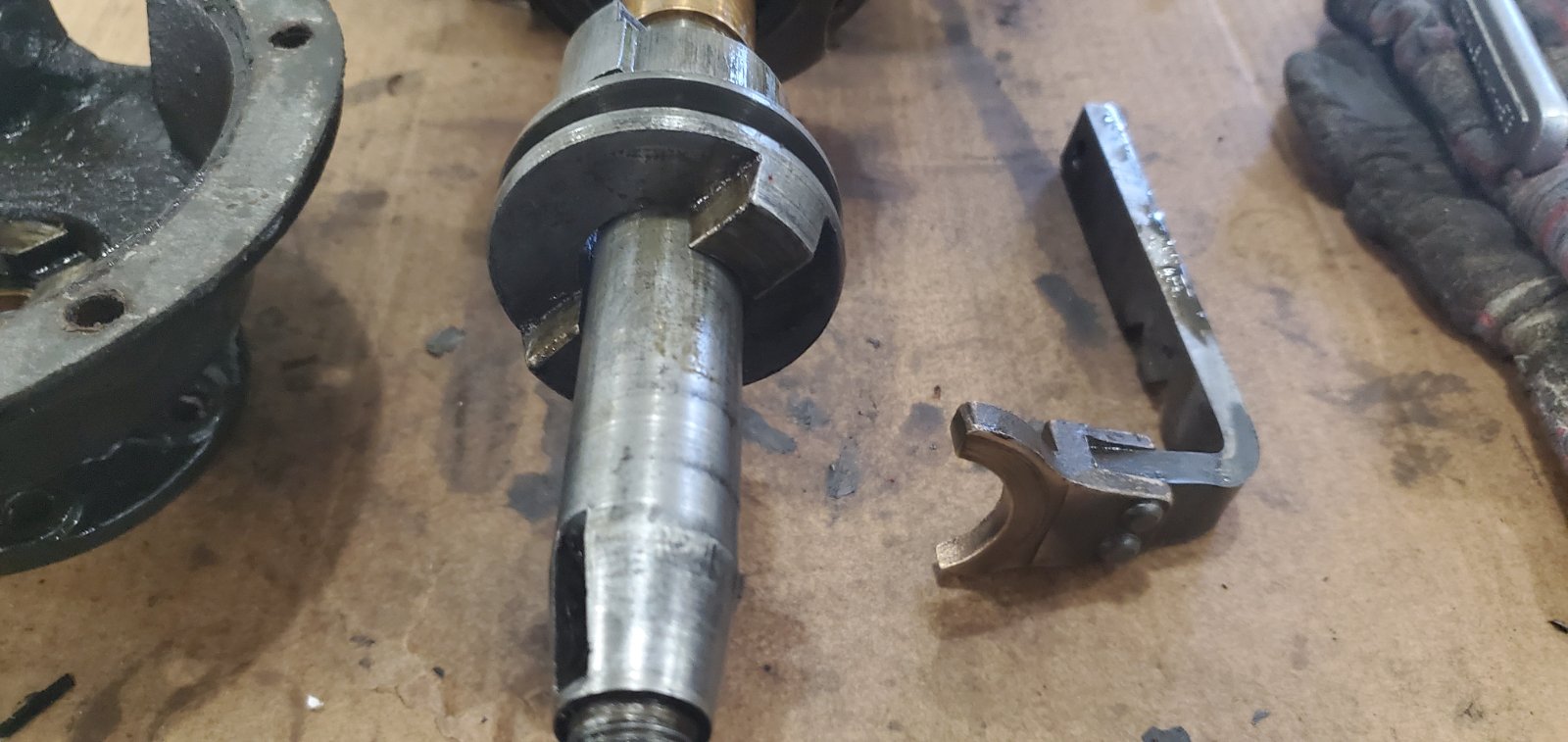

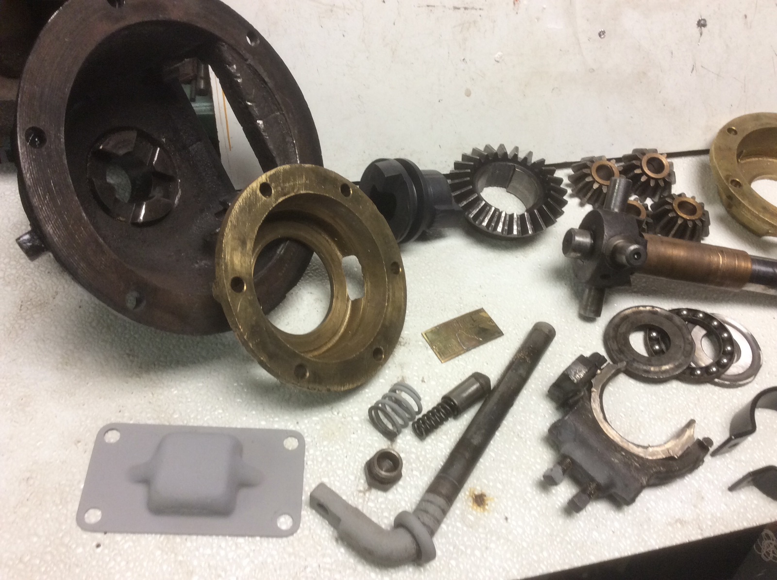

pictures of innards
Chris, these are the requested pics of the insides. Keep in mind, these are from a jumbo planatar , and as I’ve never seen inside the version you have, I have no idea if they will be any help. Mine has a heavy spring loaded ball detent that should keep it in one gear or another. I have searched for awhile with no success for what the actual shifter looked like. The early ad copy is sometimes notoriously inaccurate. This unit is either in one gear ratio or another, there is no neutral, unless something is seriously damaged . I was able to find a great early shifter that has a very positive lock in one direction or another. I feel this will be a good insurance instead of just relying on the heavy ball detent. In one picture , I’m pointing to the part that was damaged in mine. The throw is somewhere around 3/4” , from one ratio to the other. Just a guess but likely if the rest of yours is the same, the throw should be about the same. My opinion Is that the planatar was a well built unit, and the big selling point is that it used primarily ford gears, which are easy to find. Also, much less work to install than a Ruckstell is. I’m surprised there are not more around.

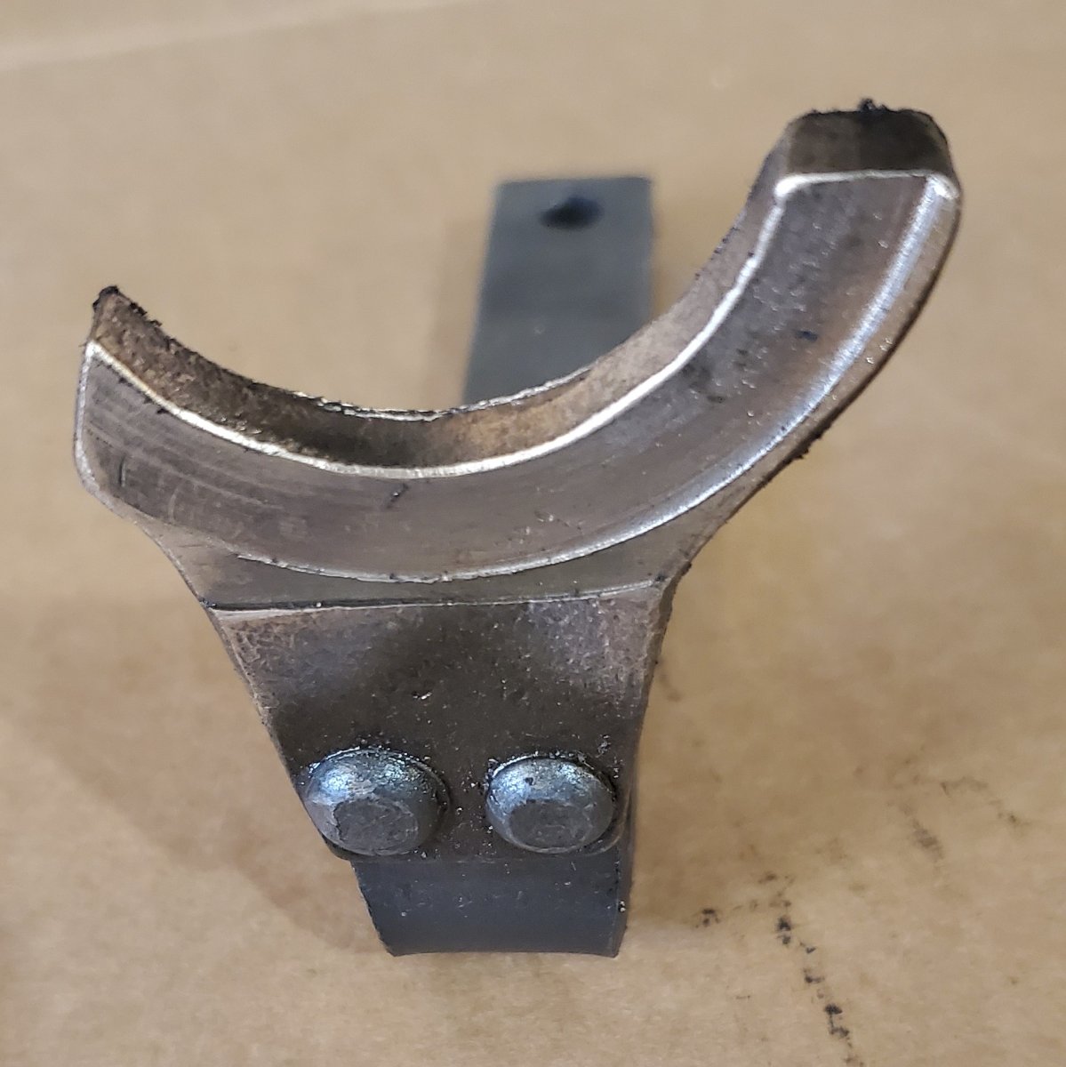

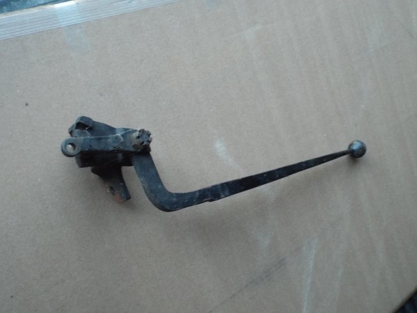

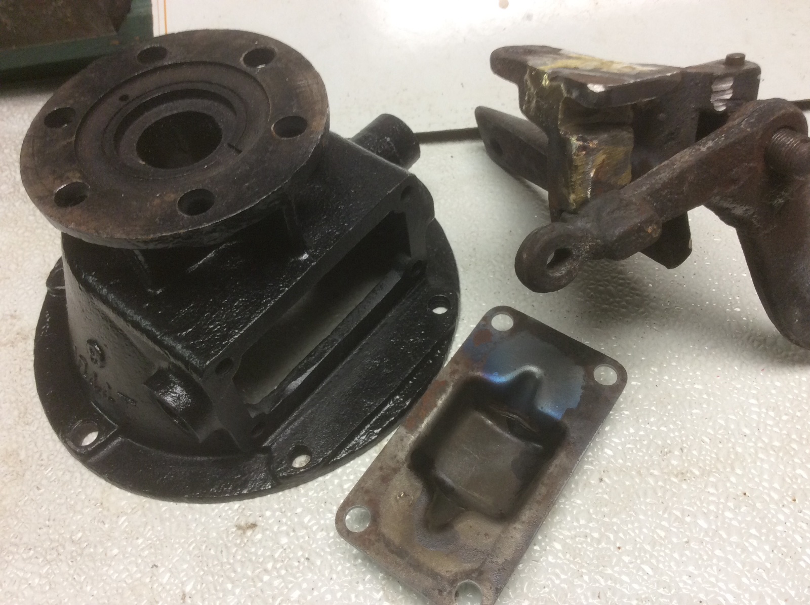

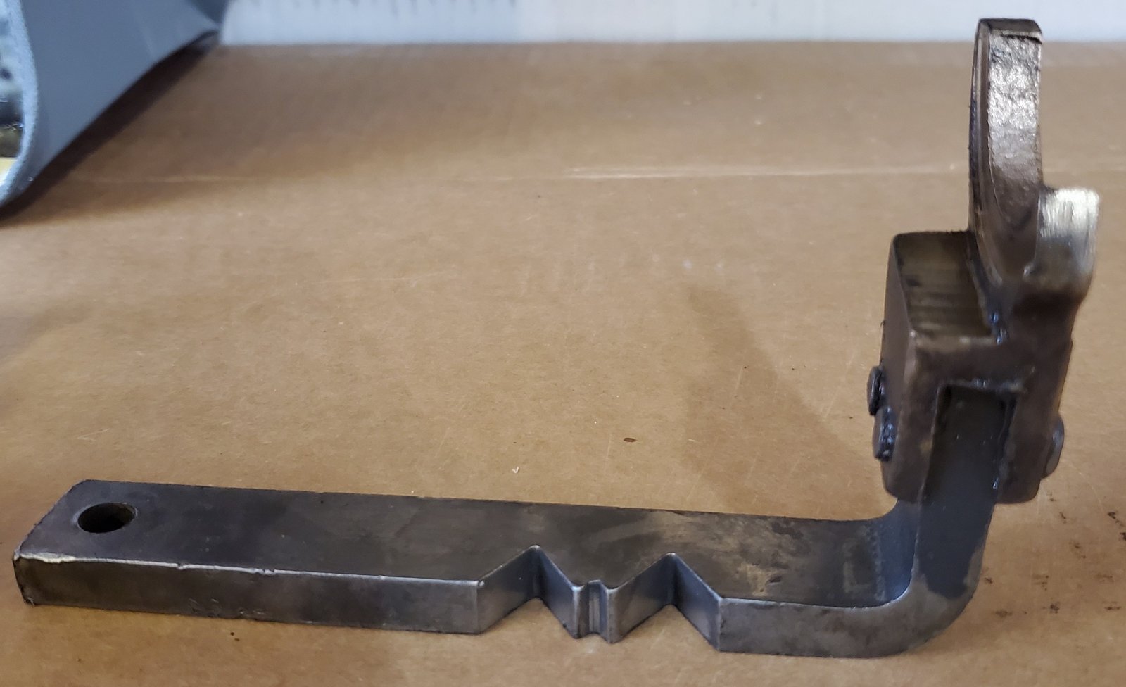

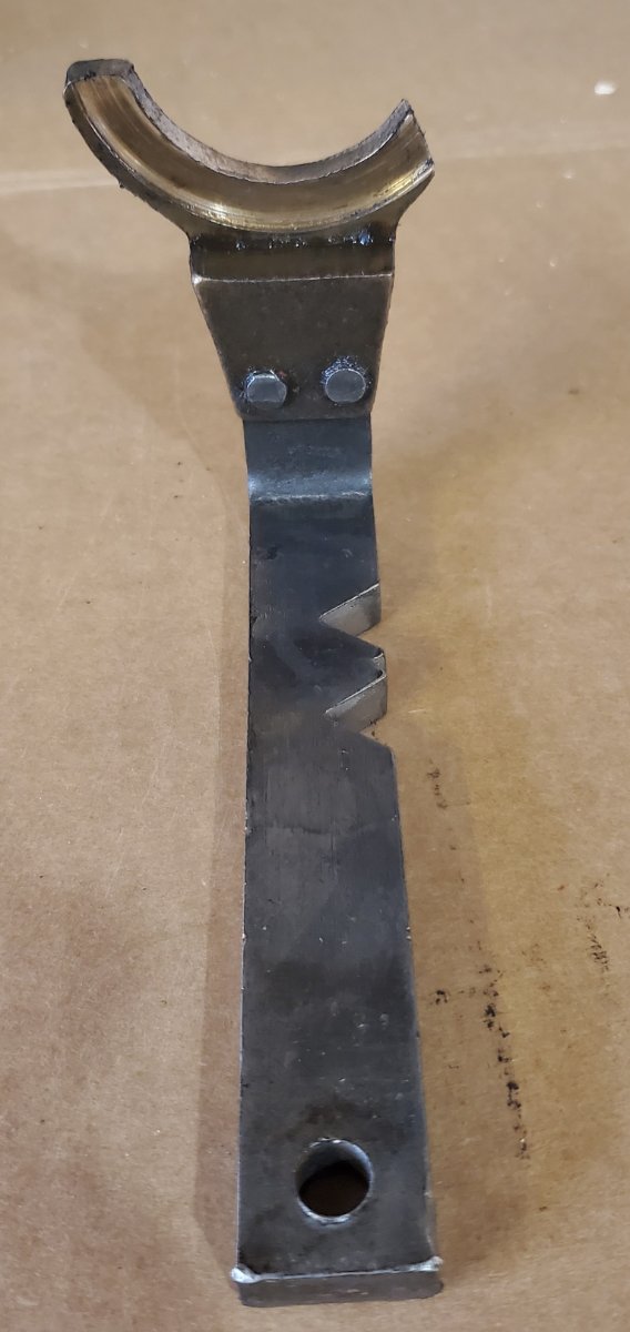

The Starr Plantor shifter is different. It is a flat piece of steel with two notches in it that moves a shift fork to engage one or the other of the gears. There are at least two and I think three different versions of that shifter, which must have been a weak spot in the design. The ones I have seen have all been brazed at least once to build them up.
Chris, if you are ever coming through Helena, you are welcome to stop and go through all the stuff I have. I have two that I have been going to rebuild for years, one for parts and not much else.
I have never seen the original shift lever and rod setup. As Dan said, the drawings are notoriously unreliable.

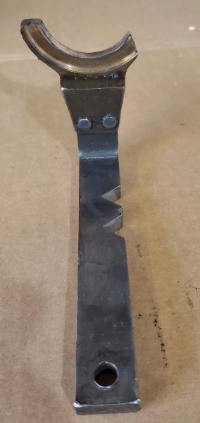

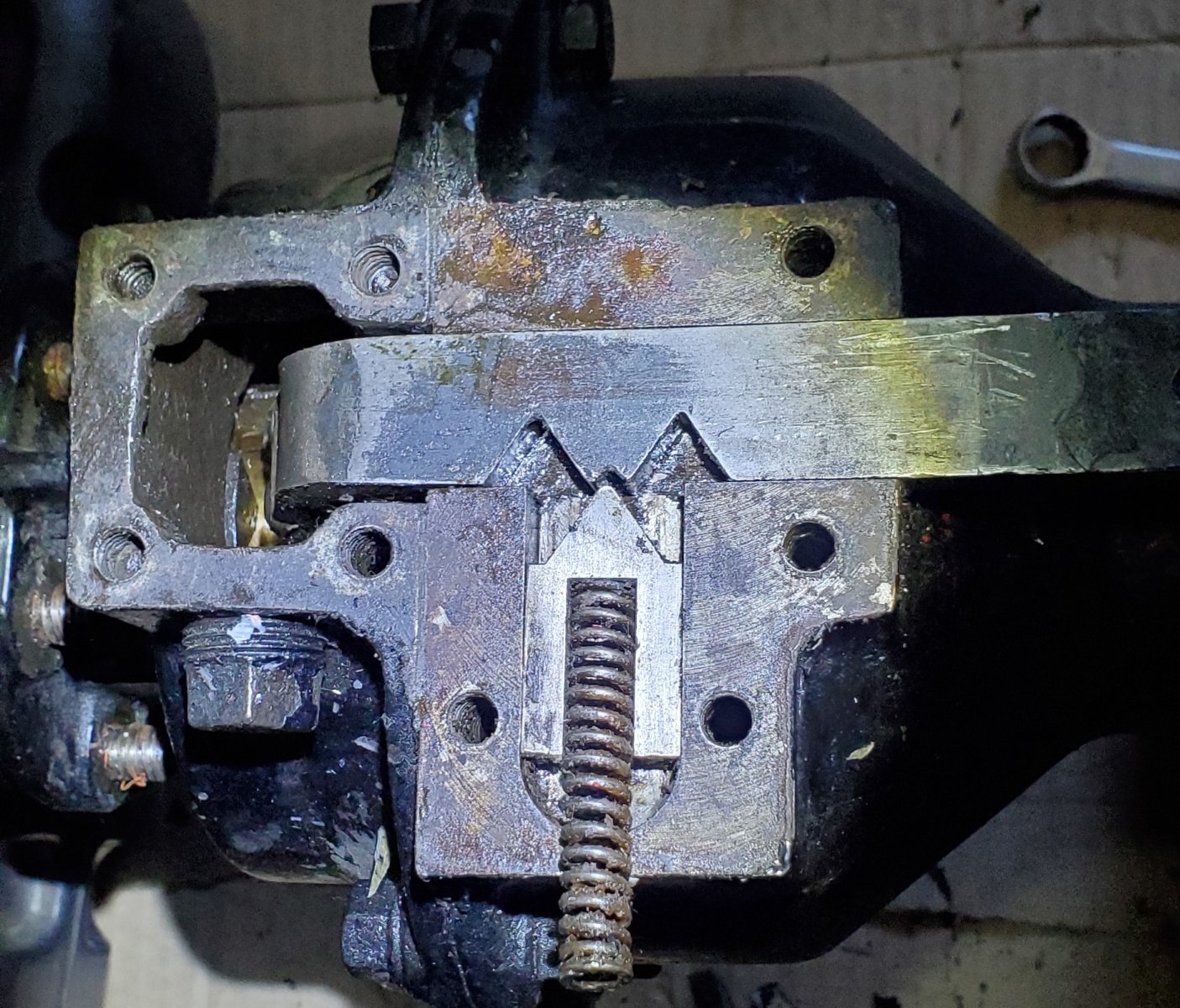

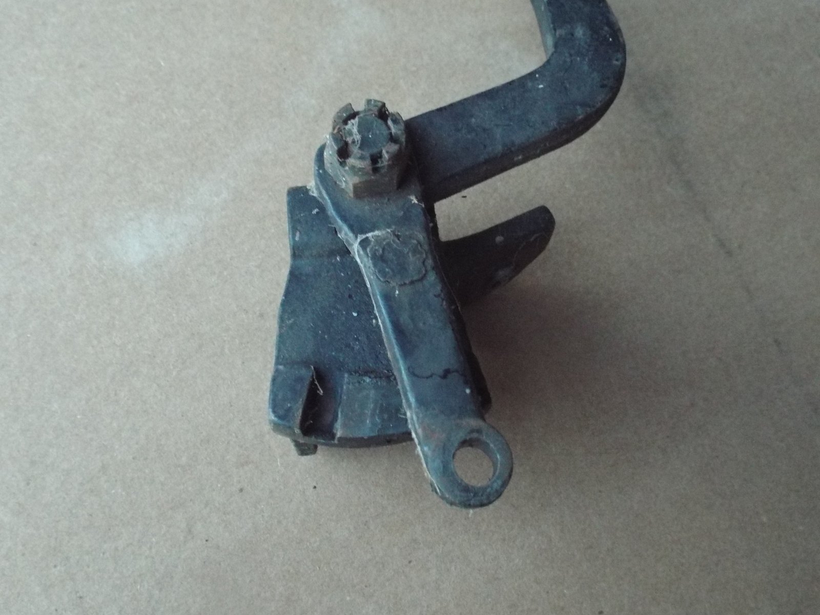

shifter mech
Chris, if you look closely, this is what your unit shifter mech looks like . If you can believe the advert, It was still being offered by jumbo in this earlier shifter version.
Tim, yes the picture above looks like the top of my unit, 8 bolts on mine, only seven show on the picture but I think they just missed one.
I got mine stuck in both gears somehow and it would not move off the hoist. Pulled the shift bar out and got it so it would move.
Now will have to take apart and see what I have.
Thanks for the pictures.
It will need to turn up to 180degrees to engage. If you can leave it in gear and revolve one rear wheel, it should change gear ratio. Good luck

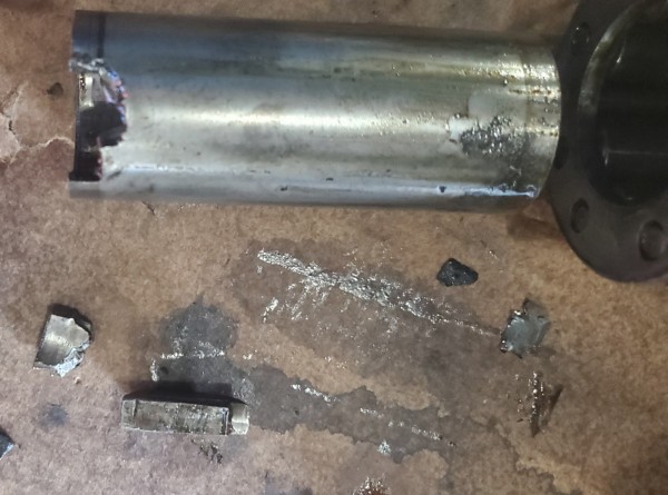

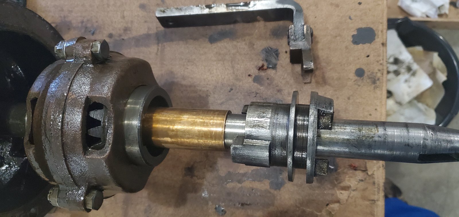

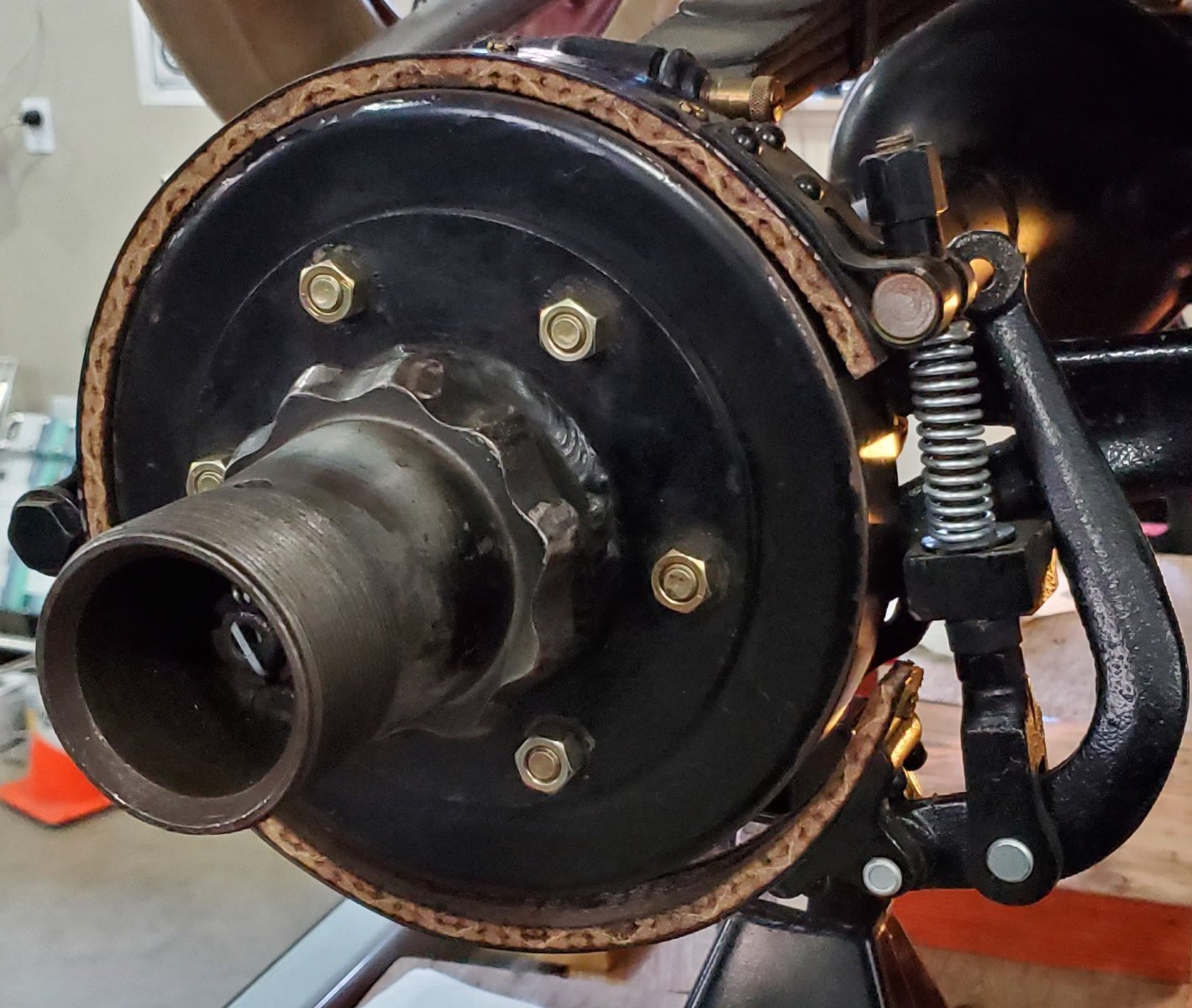

Have come back to this and have removed the rear axle from the car.
It is a Planator mfd by Starr Transmission Co. There was a piece of tape that was painted over covering the data plate!

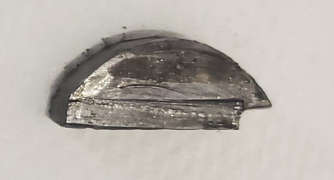

There is a detent between the 2 notches, for neutral ????
There is a lot of gunk in there and the shift rod has paint on the inside. Cleaning it up will certainly make it shift better.
Does anyone know if the car needs to be moving to shift?
Dan, yes put the AC reproduction brakes on before I toured with the car.
A little more progress, pictures of the shifter. It was pretty gummed up needs a good greasing, think that was part of the problem with it not shifting.
Does anyone have a picture of the same shifter? Not sure that the brass part should be a half circle?
Chris: Attached are pictures of the Jumbo shift lever at the hogshead. As you can see it has 2 definite notches to keep the transmission in gear. I don't know for sure if the Planator used the same shifter .

Re: Help ID this auxillary transmission - Planator
More progress on the disassembly, but problems found (as usual).
The pinion bearing sleeve is a slip fit on the end of the driveshaft and a little piece fell out when I removed the pinion gear.
You can see the damage on the end of the sleeve.
Also I believe someone notched the woodruff key which I believe is incorrect.
... and solid roller bearing.
I believe that "notch" is from movement, Chris.
I have one on my '27. It has neutral. I have been told that it should not but it sure is nice to have a true neutral and since it shifts fine and has never slipped out of gear I have to believe it was intended. Perhaps earlier versions did not. Planetor low is great for loading into the trailer or maneuvering in tight places and Planetor high is great for climbing hills or running down bumpy dirt roads with the throttle closed!
- Posts: 6732
Steve
this is well beyond my knowledge/expertise, but long study of that picture leads me to believe you are correct in thinking it does not belong there. I would bet there should be a "pause" there...a flat spot on the shifter for that period of movement. It just doesn't look right...from lack of symetry or anything else.

It has been a while since I had mine apart but it also has the detent in the middle. I can easily shift mine with the car standing still. In fact that is usually what I do when pulling into the garage or the trailer.

I can't see how mine would shift standing still, the 2 dogs in the sliding collar have to fit into the notches in the case.

A few more pics of the guts.
