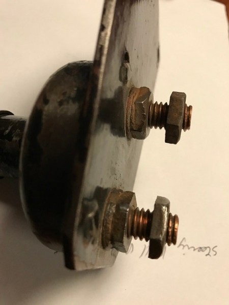

My starter switch had a bad habit of failing to do anything-I bought a replacement switch and installed it. Now, every time my heel depresses the switch, the sparks fly like sparklers and nothing happens. Naturally, it’s shorting out when the circuit is completed.
I’ve checked my connections. On tight. Is it possible that when I replaced the switch, I may have lost some form of insulating rubber/fiber washers to the frame that may have served as an “insulator?” As of now, everything is simply bolted metal-to-metal. Meaning the switch plate is simply bolted to the frame. Did Ford use any such thing? I’d like to help the fellers out a bit in advance-As well as possibly save them some diagnostic time! Thanks, gang!

So, sparks at the newly mounted starter foot switch? Indeed you have a wiring problem.
The foot switch only interrupts the positive cables from the battery to the starter motor.
The battery cable goes to one terminal on the foot switch, the starter cable goes to the other terminal on the foot switch.
So, there must be a ground somewhere when you hit the button with your heel. The switch internals are insulated from ground, mounting the switch plate to frame won't make a difference. Guessing a dead short in the starter motor may be a cause.

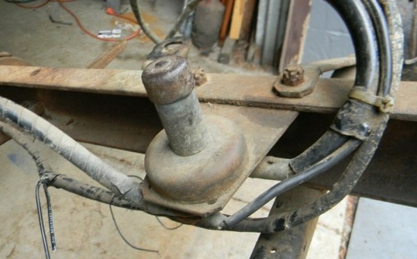

You could have a short inside the switch or in the wiring from the switch to the starter motor. Discount the wire to the starter motor and then see if there is continuity from the starter post that it was connected to to ground. If so bad switch. Any other wires connected to that post? Should have insulators around posts inside and out. I'm using a solenoid too ever since I saw the inside of the FORD starter switch - afraid that I may shock myself stepping on that thing. When you step on the plunger a bar on it completes the connection across the two posts. Everything is surrounded by metal - think about it

Steve, I am trying to build a period, 1919-1930, speedster with minimal innovations outside that era. It isn't going to be a racer, just a fun project. The switch I have is the one in the picture above. It wasn't designed to clean the bus bar and that is why I don't use it. The Model T was designed with the technology of the time (which was excellent "at that time"). Whenever improvements were realized (less expensive, safer, less maintenance, long lasting, etc) Ford and other manufacturers incorporated those innovations in their products. We all do that to so degree - hardened (tie rod, etc) bolts, voltage regulator, paint, tools we use, etc.. I do share the Keep It Original attitude too (alternators :evil: ) Having said all this, occasionally some reproduction parts aren't up to par and the only alternative is to either find a good original part or choose an alternative method. I chose the latter.
