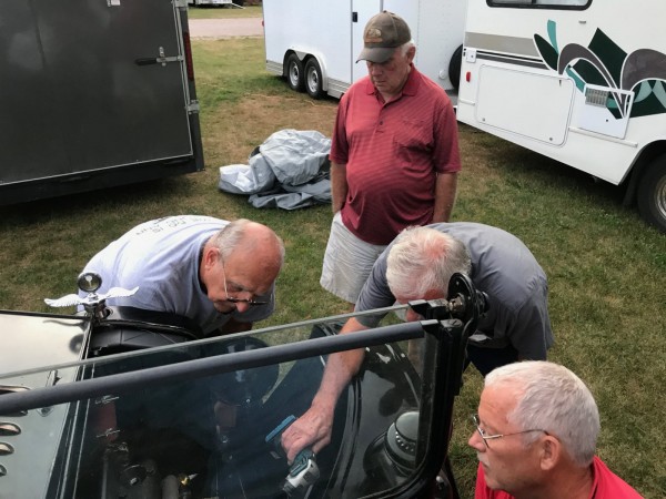

I've had similar experiences where strangers have stepped forward without hesitation to provide elbow grease and parts to get me going.  On my first tour I learned the quickest way to meet people it to open the hood on your Model T.
Men at work - Michigan Jamboree 2019

No Tim, old men deep into Therapy!
