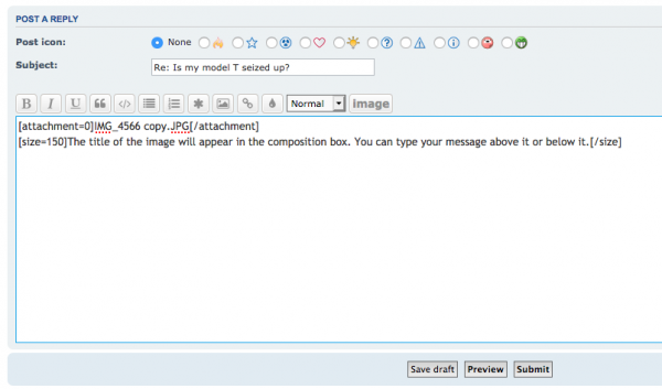

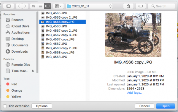

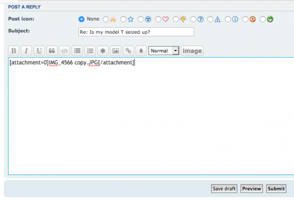

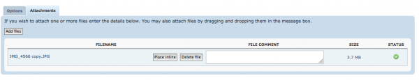

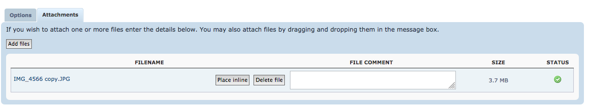

- Posts: 7401
Re: Is my model T seized up?
Click Attachments.
Click Add files.
Select the photo on your computer that you want to post and click Open.
When the button appears click Place inline.
The title of the image will appear in the composition box. You can type your message above it or below it.
Click Add files.
- Posts: 7401
Click Preview and you should see your image.

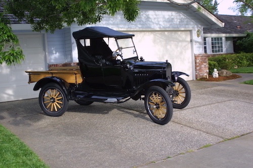

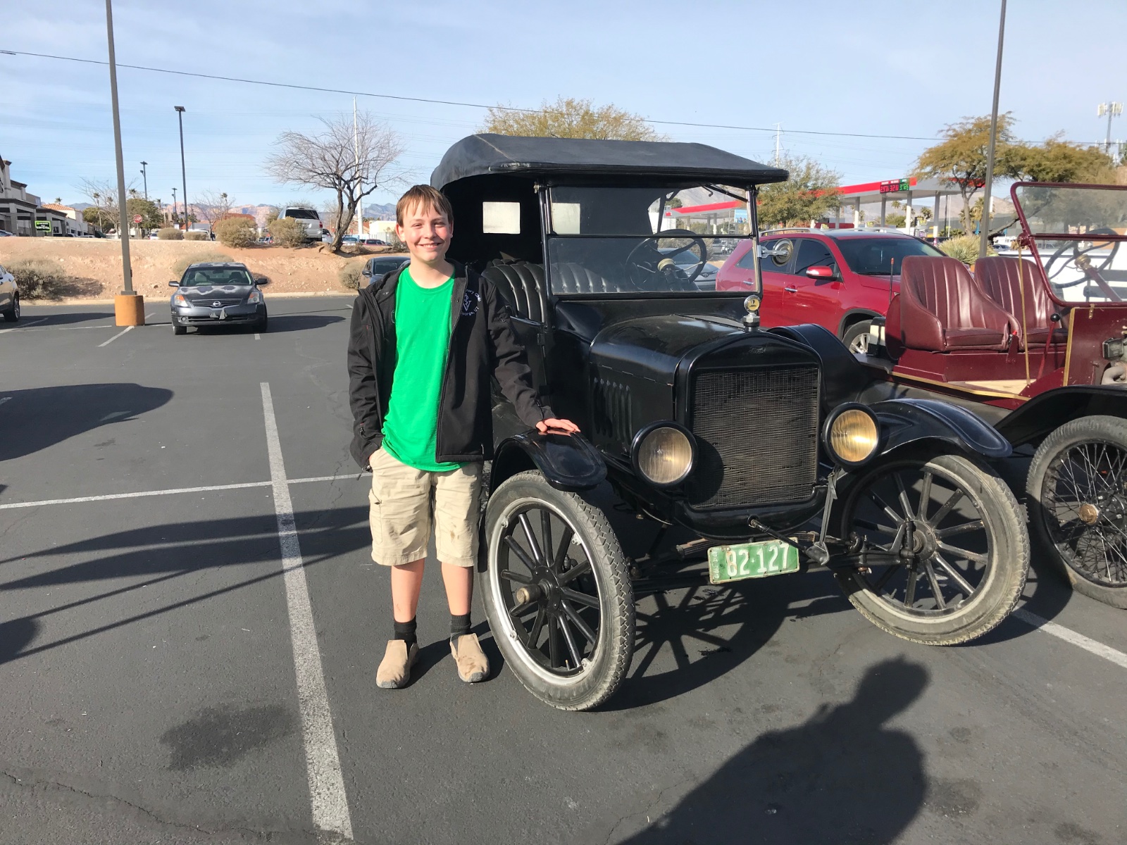

this is my t!

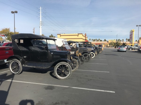

Mr man
Topic author - Posts: 67
- Joined: Fri Jan 17, 2020 6:51 pm
- First Name: Carson
- Last Name: Combs
- * REQUIRED* Type and Year of Model Ts owned: 1924 touring, 1923 roadster pickup project
- Location: Las Vegas, Nevada
Sorry a bad photo. Here's another.
Great looking car and your bad photo is better than most of my good ones. Drive as often as you can in circles or a pasture that is how I learned to drive in a 48 pickup. The Model T is much more fun.
