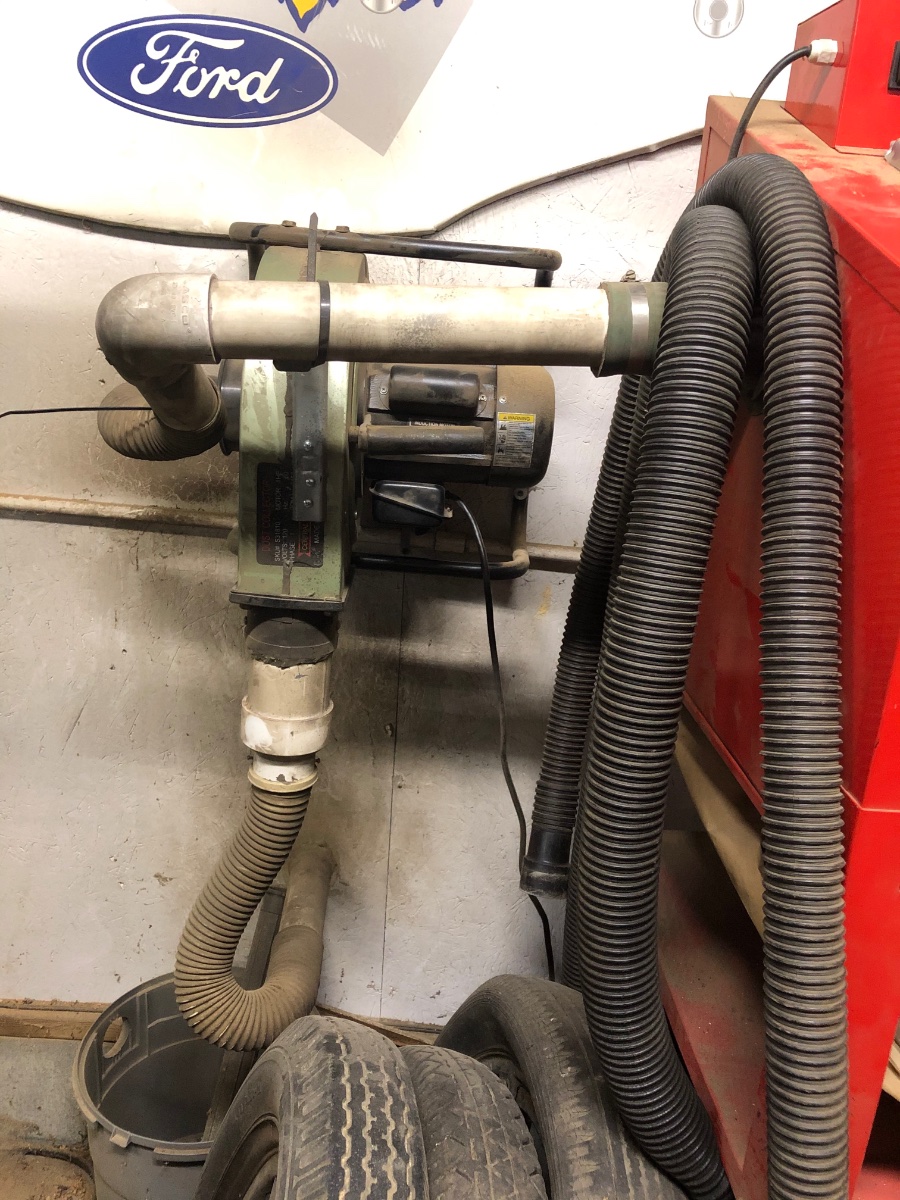

I use a Harbor Freight dust collector to vent my sandblaster to the outside. It would work well for exhaust fumes also.

Here’s the set up I use for the sandblaster, saw dust vacuum etc. should work for exhaust fumes as well.
