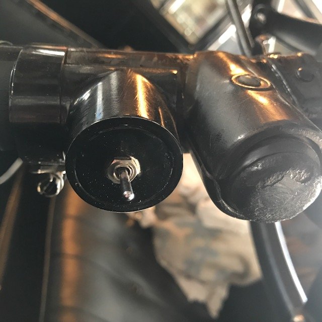

There was a photo, I think on the old forum, where someone put a toggle switch for turn signals in a standard horn button housing. Mounted on the steering column, it didn't look out of place.

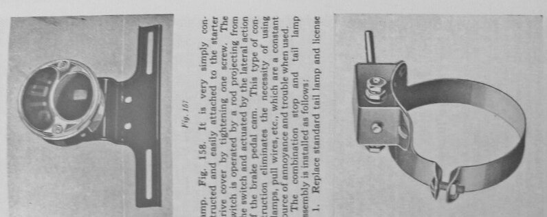

You can buy at your local auto parts supplier a turn signal switch that clamps to the steering column and ties into the brake light circuit.
The right side bracket is available from the usual suppliers.
A 28 Model A tail light looks pretty good on a T and has the extra filament in the bulb.

One using a horn button housing and one using a modified PVC pipe "T". If you are going to combine the turn signals with the brake light using the schematic above you will have to add some diodes to isolate the front from the back.

Richard....make it easy on yourself, and just get one of these. It's all you need, except of course you supply your
lights, and wiring. If you REALLY wanna make it easy, spend another $95 or so and get the "ready made" wiring loom, but why spend the money? If you're like me, you've already got plenty of "scrap wire" around the house to make up your own. I did this on my '25/'26 "overlap" Fordor and they work great!
https://www.modeltford.com/item/T-SIGN-SW6.aspx
