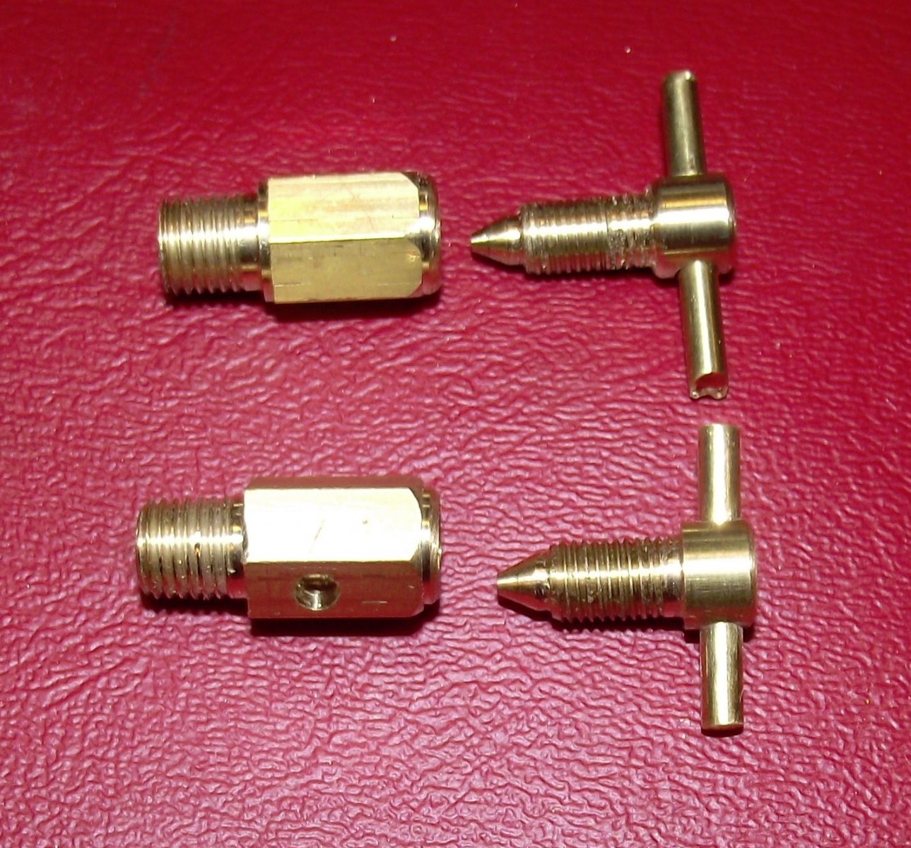

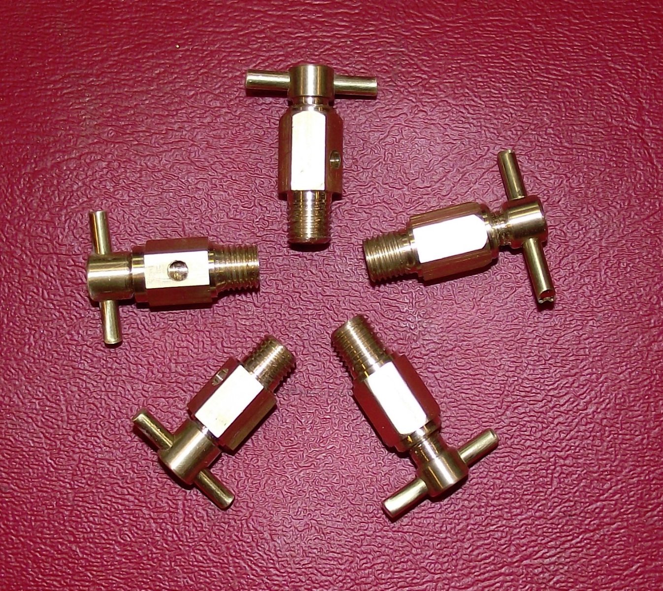

These little petcocks are made from unobtainium. They are used in the early Kingstons, some of the Holleys and a few others. Most often the need is for the early Kingston 4 ball with the short inlet -- the one with the inlet half way up the chamber. They are always missing, broken or leak.
They are 1/16 NPT pipe thread. I have never been able to find drain cocks in this size and have wasted all sorts of time trying to get old ones to not leak. So Saturday night I made some.

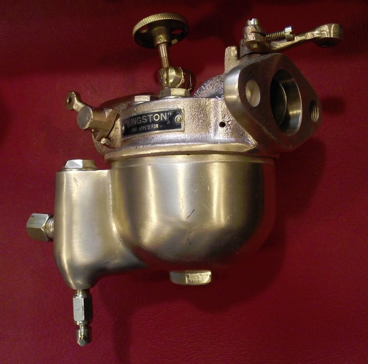

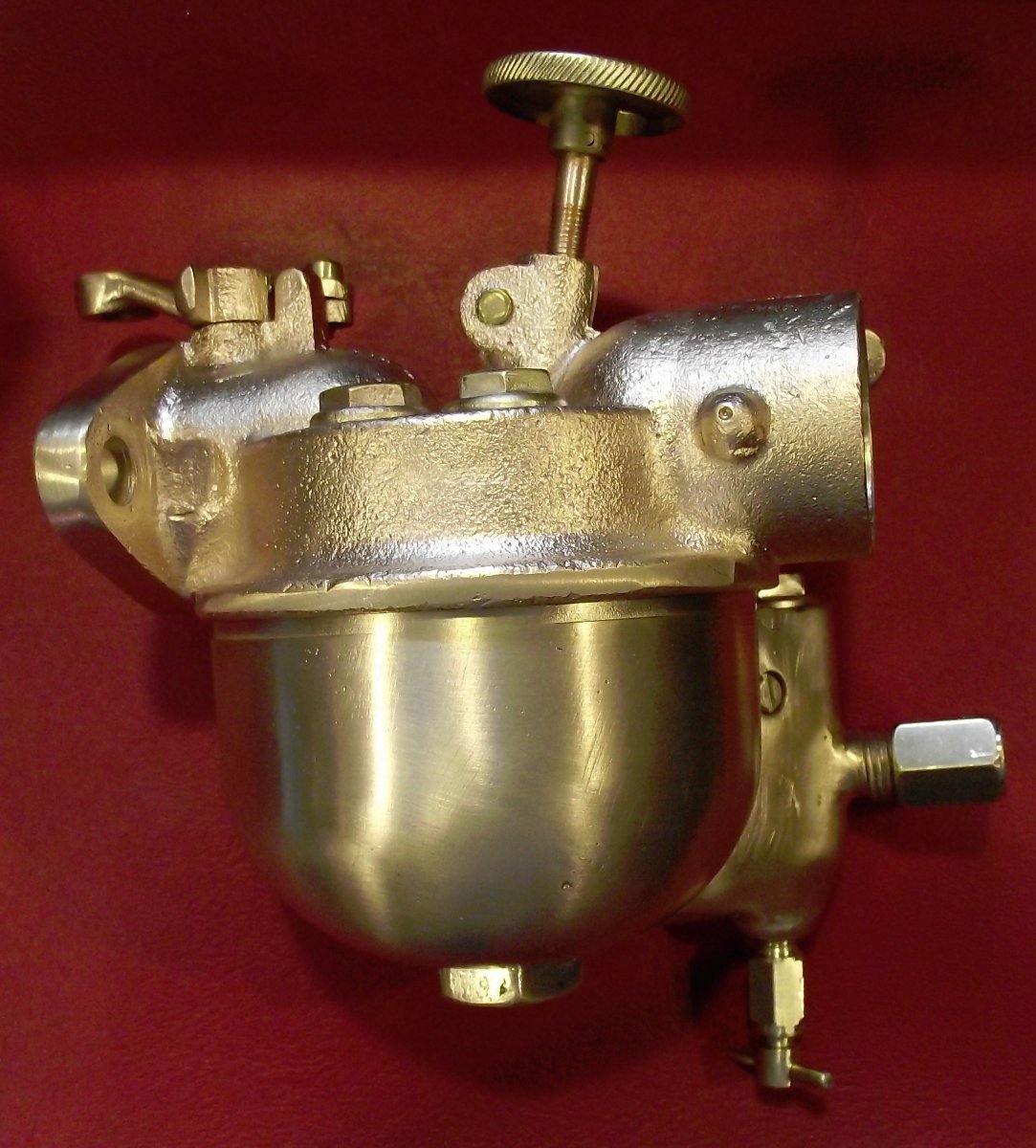

First photo shows where they fit in the Kingston 4 Ball.
Made some petcocks

In answer to the question I will certainly be asked, "How do you form the tips?"
Answer: I grind the tips on my valve grinder, which is an old Snapon that I have made adapters for the smaller sizes needed for these sizes.

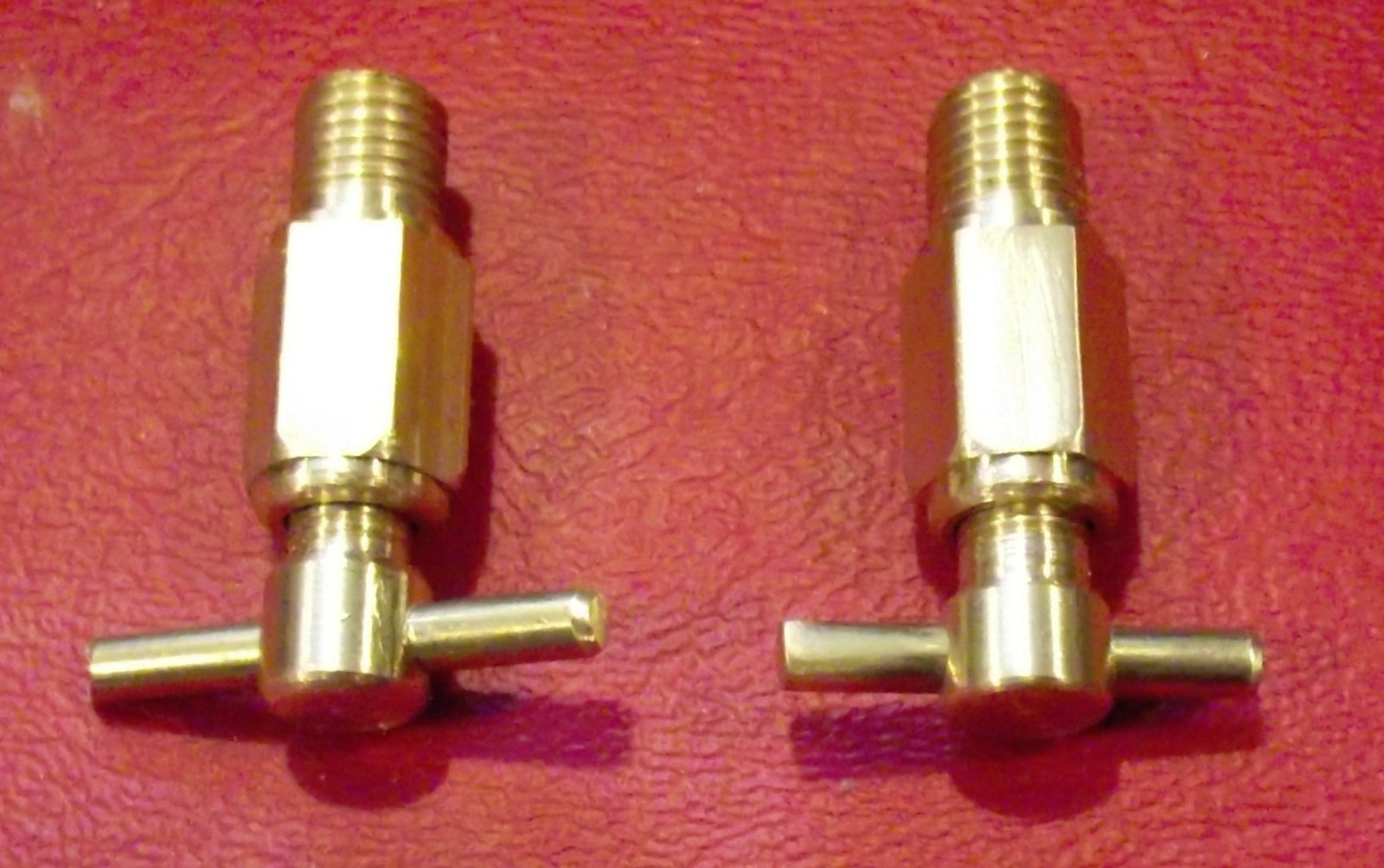

I've seen a couple of those like you show. IMNSHO ( in my not so humble opinion =) ) the problem with them is that they are intended to seal with tapered thread but there is no hex to get a wrench on to tighten with so you are using a pair of pliers to tighten them.
Ah, I checked them out on the website and it looks like they have 7/16 flats to tighten them.
I think they are made for Model Engineer projects in England and they wanted about $25 each plus shipping. Anything tapered thread is expensive.
On the other hand, you can't lose the plug which you could do with the ones I made. With enough time I could make them so the plug would be retained even when loose.
I made some with drain holes on the side and and some with no drain hole. Guess why?? So you can whittle a little wooden plug if you by chance lose the drain plug.

There are lots of ways to retain the plug but I used 1/4 - 32 threads which should tighten up very well and not unwind themselves. It is also easier to whittle a plug if you do lose the turn plug and easier to send out a replacement.
Yes, the brass loads up the stone, even with a big glob of goop and a steady stream of coolant on the contact surface. I have the surfacer for the stone and a couple new stones so it will probably all outlast me.
