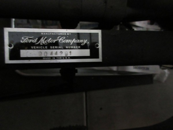

serial number name plate 1st used?
I have this 1924 Model T roadster with the serial number plate glued or cemented to the frame rail. It doesn't look like it was from the 1924 era or put there by the factory. Does anyone have an idea as to when this plate was first used and on what vehicle?

It looks like something from the V-8 era. I'm glad to hear it is not a permanent plate. If I had your car, I would carefully scrape it off.

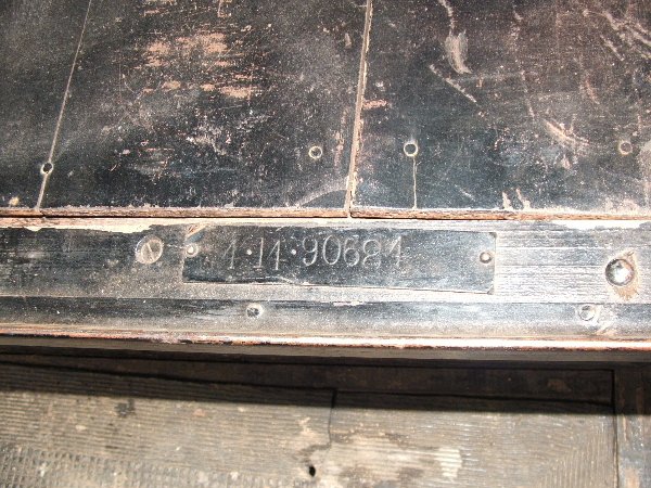

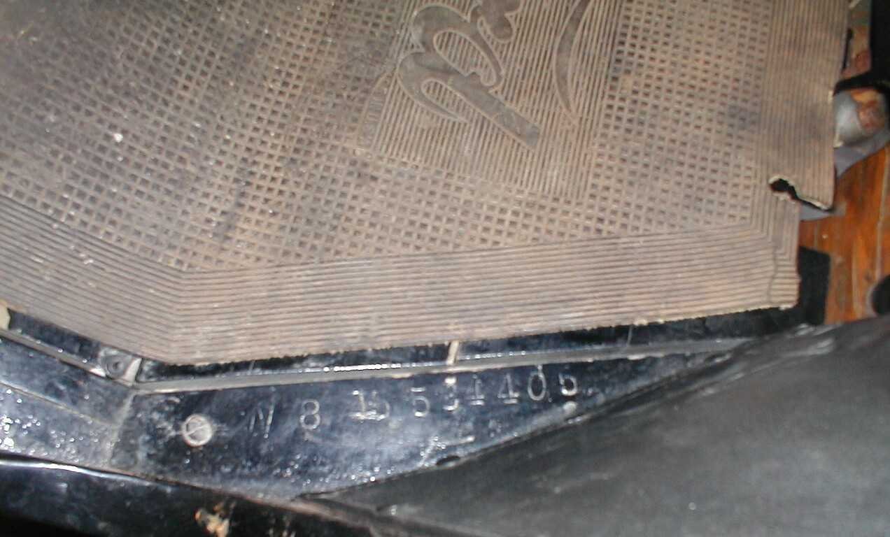

Here is a good tread to answer the original question when were serial number plates first used. I also added a photo of one from the tread. So save your money get a strip of copper and number punch set and have at it. And it looks original and no one knows that it supposed to be the engine number.
http://www.mtfca.com/discus/messages/50 ... 1215997352

The images you a show are body numbers, assigned by the body manufacturer, not the serial number or Vehicle Identification Number assigned by Ford.
-Keith
-Keith

Thank you all for your input. Especially Dan for the picture of a vin plate from vintage parts.
So I got my answer that the plate on the frame rail was not issued by Ford.
It's on the passenger's side under the floorboard so it doesn't bother me.
I am leaving it because it is the only thing that proves to the dmv, police, and insurance company (according to title) that the car is mine.

Keith, thank you for correcting my error. I got carried away with the idea of number stamping a strip of tin/copper and affixing it to the frame. With a little tarnish/paint it would look much more "authentic" than a repro data plate.
