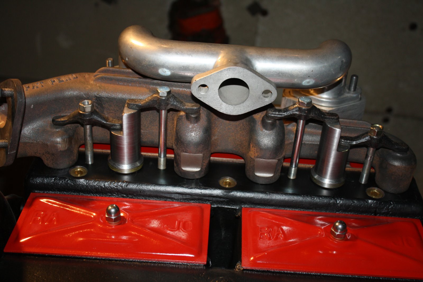

I am installing the dual exhaust manifold on the speedster project engine. Since I have been unable to find 3/8-24 double ended studs 5-1/2 inch long I am going to make them myself. My question is what material is best. grade 5 or grade 8. I will be taking a 6 inch bolt and cutting off the head and rethread one end. My gut feeling is grade 5. I say that because it will be able to stretch a little and be more likely to keep tension on the assembly. ??
But I have been wrong many times before ....
Any help will be appreciated. Im almost ready to put the engine in the car after 5-1/2 years of work (fun). :)
Here is a photo of the bolts in question. In the photo, the manifold is held in place with two bolts for the "tall" clamps. I want to switch to studs instead of bolts. The stands are combination intake port plugs and manifold clamp stands that I made last week ....

Henry, Good suggestion. I will look at adding a brace.
I had some old US made 6 inch grade five bolts. So I cut them off and rethreaded them on the lathe, then I chased the threads with a die nut. Turned out nice. From the input above I think grade five will work OK.
Dennis, I tried turning the clamps over. But the way the clamps and dual cast iron manifold are made, they did not fit well. I would need to grind some of the manifold to get the clamps to fit.
Scott, The block is a 1919. Due to leaking "freeze plugs, and some really crappy exhaust manifold gaskets for a homemade model A manifold conversion, the "freeze plug" seats were badly rusted away at the bottom. So since this is a speedster engine I just drilled and tapped the block for the screw in plugs. I know they are not correct, but it saved an otherwise. good engine

Donnie, your photos show some thread still not engaged when you install the studs. If there is enough thread, you could run a nut on first, run the studs in and the tension the nut as a locker. That will stop them winding out if you ever have to remove the manifold.

Allen, The studs and bolts shown in the photo above are temporary bolt/studs. The new studs I made, have full thread engagement. I will use double nuts to lock them into place.
