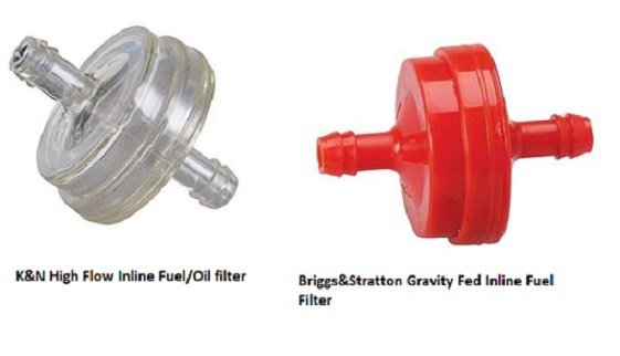

I looked into using a lawn mower filter. The labeling mentioned "for horsepower xx" or "with fuel pump" both looked like the attached photo of the red one. Then I looked into K&N having one of the best reputation for filters and saw a similar one that indicated a high flow rate. The price difference $4 vs $10. Both have the same screen surface area as the brass screen in the sediment bulb but may have a difference in screen mesh size. The K&N is clear so one can see inside.Charlie B in N.J. wrote: ↑Wed Feb 19, 2020 10:57 amIf you're after a pump that's one thing however if it's just filtering you want go to a mower shop and get an in-line filter for a gravity fed system. Most riding mowers are gravity fuel fed. I have used this type of filter for quite a while with no problems.

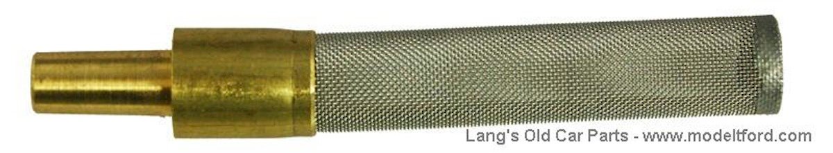

It won't hurt to use one of these. No pump needed. If your tank has enough crud to overwhelm this, you need to fix or replace the tank.
https://www.modeltford.com/item/2903BSC.aspx

They have larger in-line filters than the ones you pictured. They are for smaller engines. As for those in tank screens: you can't get 'em out easily. Pass on that as far as I'm concerned.

Correct about the red one and similar red ones are for lawn mowers and low HP engines. The K&N filter shown above per K&N "The K&N 81-0241 In-Line Gas Filter is perfect for racing applications and can be used with a variety of oils and fuels including methanol. The 81-0241 stainless mesh in-line fuel filter has a flange diameter of 5/16 inches. It comes with a 1.55 inch body diameter by 1-3/4 inch overall length"Charlie B in N.J. wrote: ↑Wed Feb 19, 2020 9:05 pmThey have larger in-line filters than the ones you pictured. They are for smaller engines. As for those in tank screens: you can't get 'em out easily. Pass on that as far as I'm concerned.
" lots of fitment .... This product will fit the following Mustang years: 1964.5 thru 2019"
