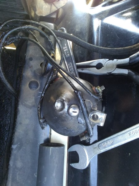

That's my timer. The guy I bought the t from replaced it before. He says a tiger brand timer. I pulled it off and noticed a nut was very loose. Could this be part of the problem?

The nut that holds the brush on the shaft? In a word, "yes" it could cause problems if loose. Also check that the contact surfaces are clean.
- Posts: 5504
Re: model T problem
It's a Tiger and a later imported repro, at that - orange colored insulator is how to tell from a vintage Tiger which has a maroon insulator.

It's where the roller runs around in a circle. That needs to be very smooth - no ruts or bumps or ?
- Posts: 5504
Re: model T problem
Oh, what nut was loose ? A contact wire terminal nut or the roller retaining nut ?

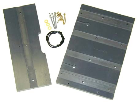

Rebuild the coilbox with the plastic kit from fun projects. Readjust coils properly on coil tester. Make sure timer and wiring connections are all correctly functioning. Otherwise, you will be chasing your tail for a bit.

One of the 4 nuts on the outside that holds on the wires was loose

It was the contact wire terminal bolt was loose. Oh, and the timer had a bunch or crud in it, so I cleaned it out and put it back on and put in a newer plastic coil, and now 2 coils buzz every once in awhile.
