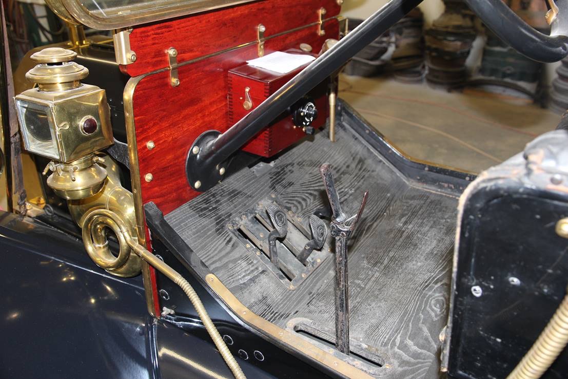

Can someone give me the measurements or post pictures for the notches in the front floorboard for an 11 Touring to clear the bottom of the steering column and the back of the engine head and speedometer cable? I have new floorboards with no notches so they will not fit without hitting the rear of the engine. The picture of floorboards on the langs site shows notches. Thanks, Art

Ok Art,
From the drivers side the cut out for the block is about 12.5 inches in and about 4.25 inches wide, centered. It is about an inch deep, cut vertical.
The cutout for the speedometer is 3.75 inches in from the pass side. 1 inch wide, 3inches deep cut vertical.
Make sense?
Don
Make sense?
Don

Re: 1911 floorboards
Don, Got it! Thank you, Art
