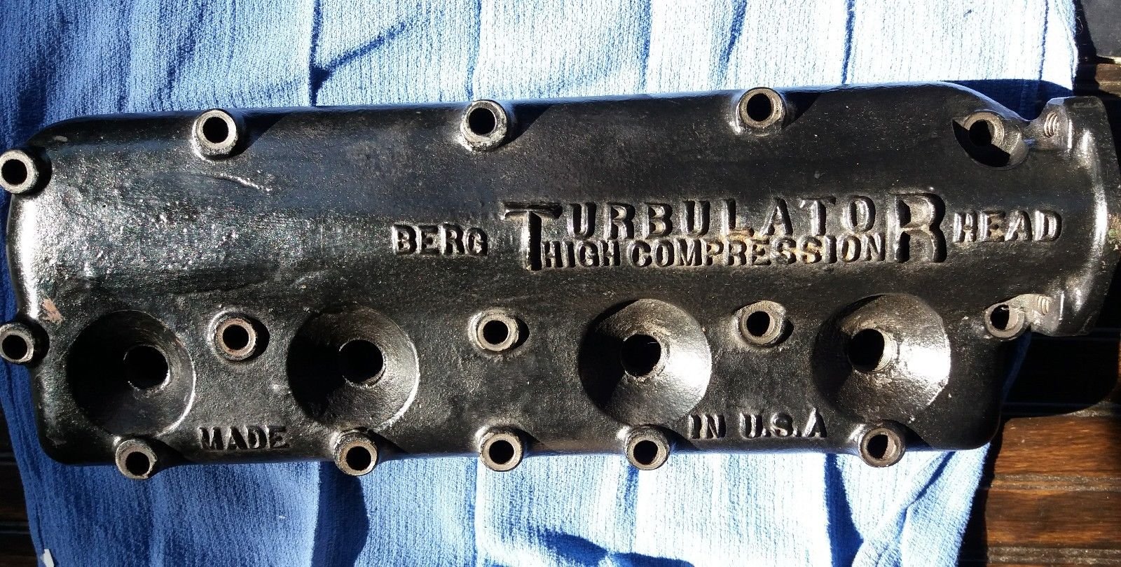

Several makes of heads that have different combustion chambers and claim high compression. A Waukesha Recardo, Sherman and a Prus.The Prus is on the right in the combustion chamber comparison photo. As you can see the Sherman has very high compression. I was told not to run it on a stock lower.
kelly mt

Post by kelly mt » Sat Feb 29, 2020 3:08 pm
Couple more heads.
