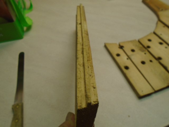

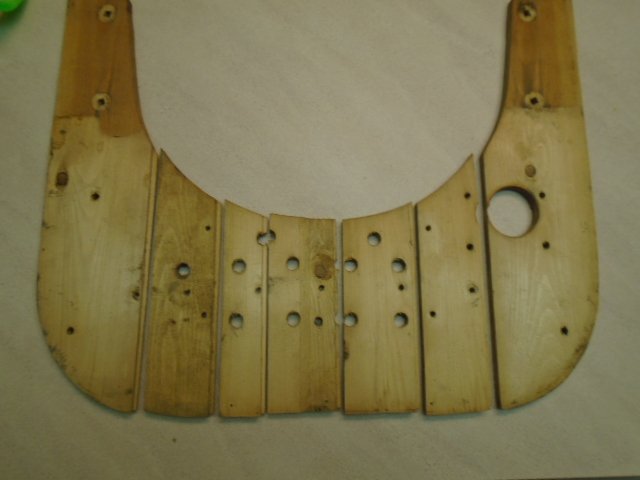

I read about wood firewalls mostly being wood/plywood, on my Canadian 1915 the firewall is wood that consists of 7 individual pieces tongue and grooved with a thickness of 21/32" then skinned with 1/16" cherry veneer to a total thickness of
3/4 +-. The tongue and groove design would all for movement where as solid plywood would be stiff with no movement. However with the cherry skin over the solid tongue and groove the movement causes the cherry skin to separate and soon all you have is bare tongue and groove wood, although it still allows for movement.
