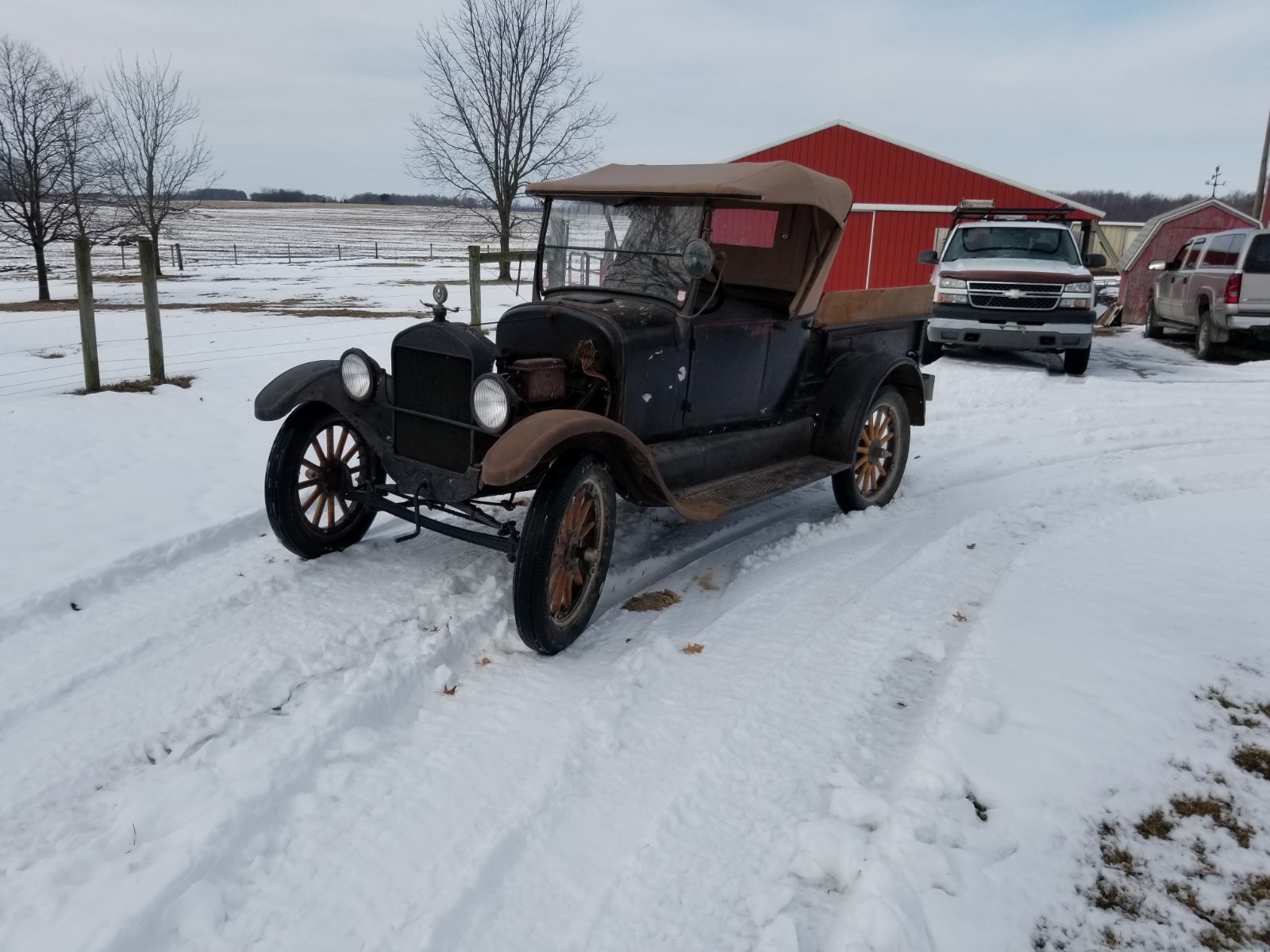

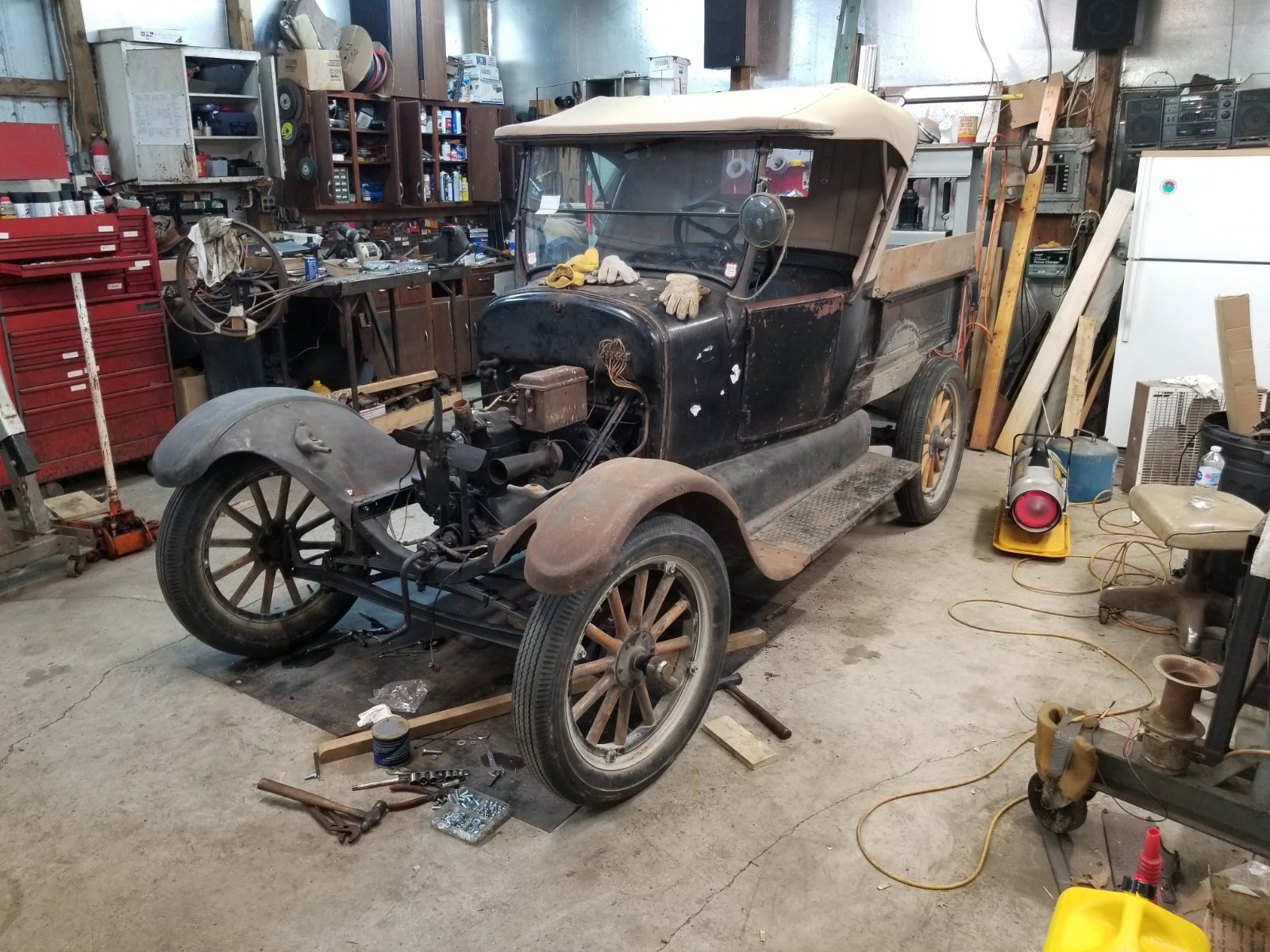

No not me! I have a correct year rebuilt engine for the 26 pickup. Also a Muncie 3 speed to install along with better front fenders. I started removing the fenders yesterday and the are 33% metal, 33% rust and 33% bondo. I knew the front cross member needed replaced because of rust. After removing bondo to find the bolts and I got all the metal removed, I found a bigger problem. The driver side frame rail had been grafted on about 20 inches from the front and it turns out at the front about a 1/2 inch. The passenger side rail has the top bent doen and is bowed in. The driver side frame horn that supports the fender brace is 1/2 gone due to rust.
Well after taking a deep breath and pulling up my britches, I decided its easier to replace the frame than fix this one. I set about removing parts to remove the body. It will make the engins swap and tranny install much easier also. I have another frame thats straight so no problem. I have rebuilt spindles for it waiting on the shelf. I have some wires and 8 bolts to remove and the body is ready to lift off. All this stuff was hidden by sheetmetal. Passenger frame rail Welded frame driver side Driver side frame horn Crossmember

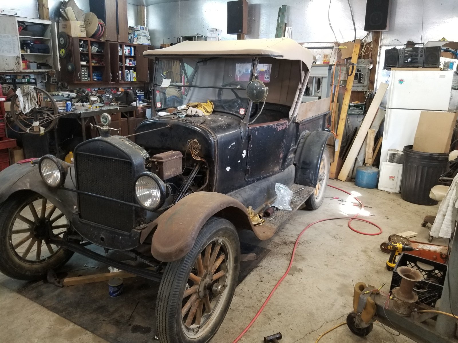

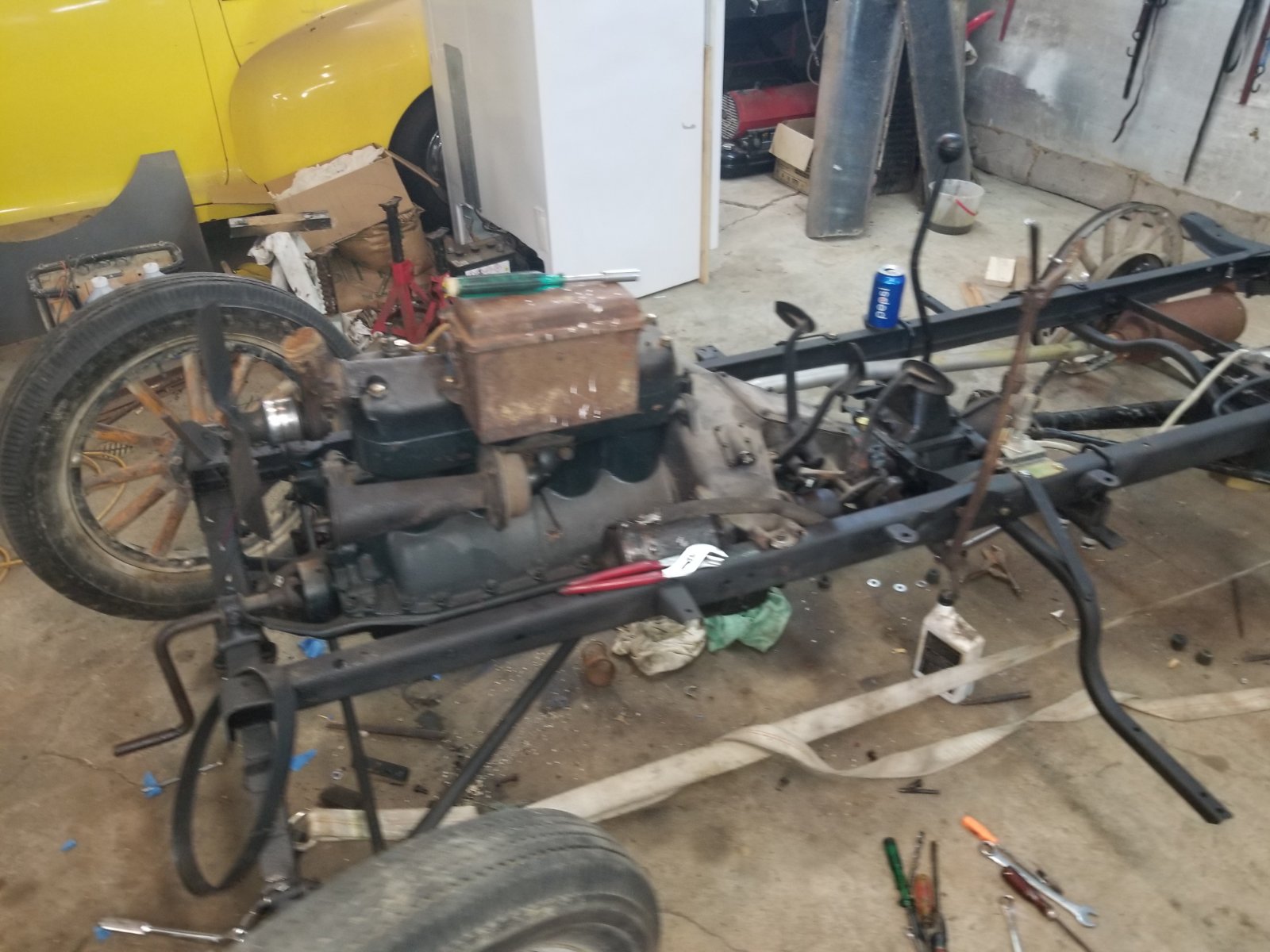

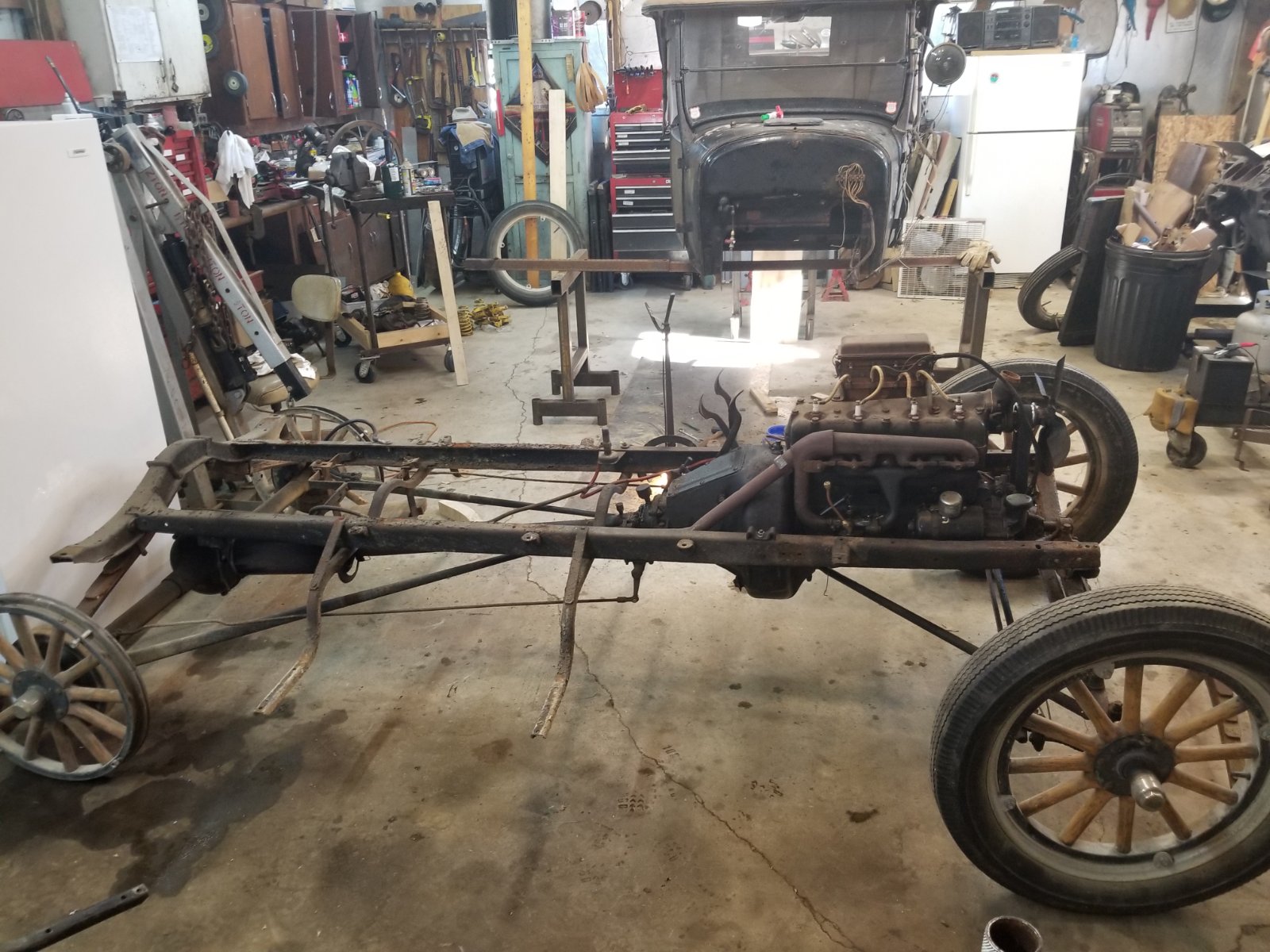

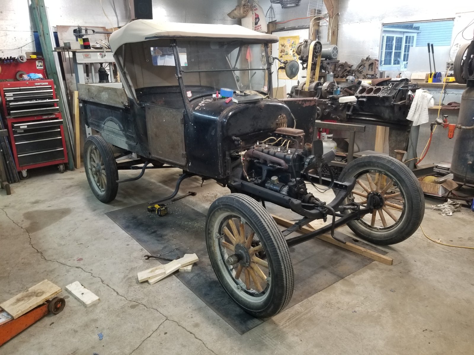

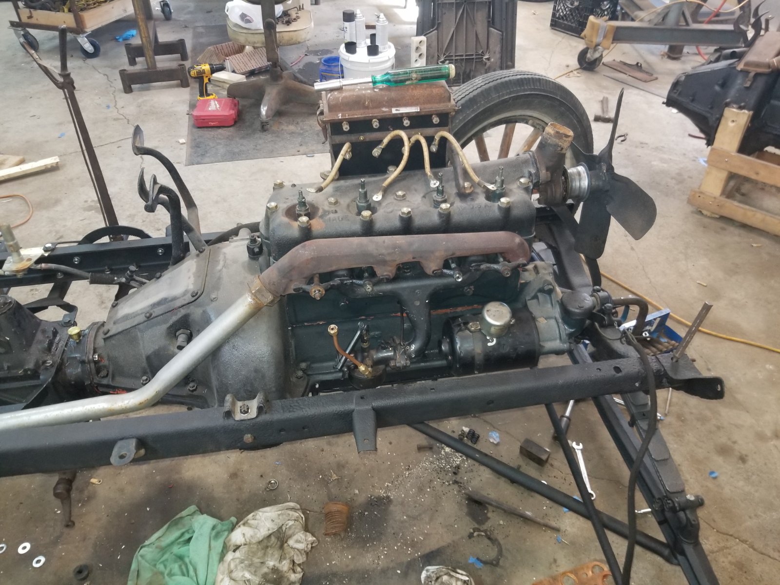

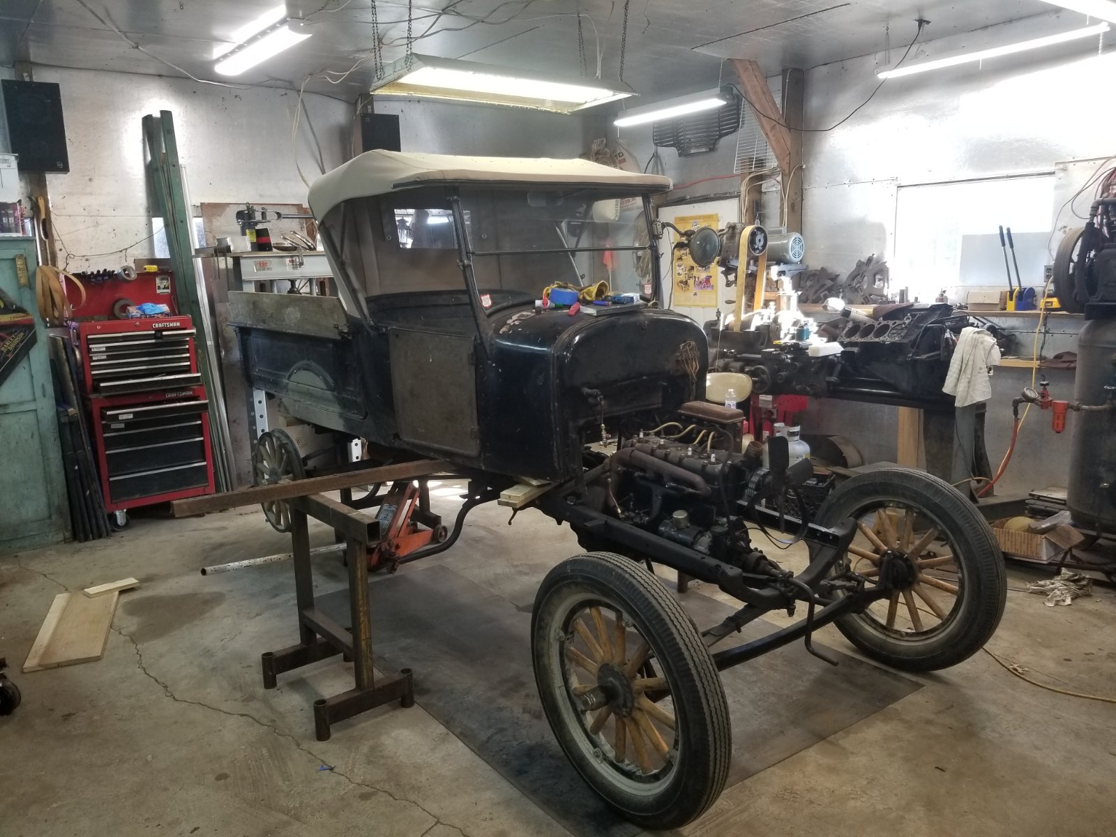

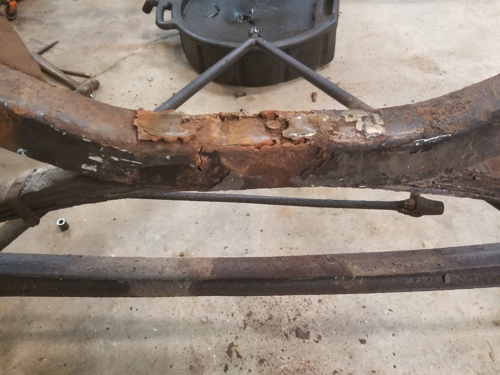

So this is how she looks now.

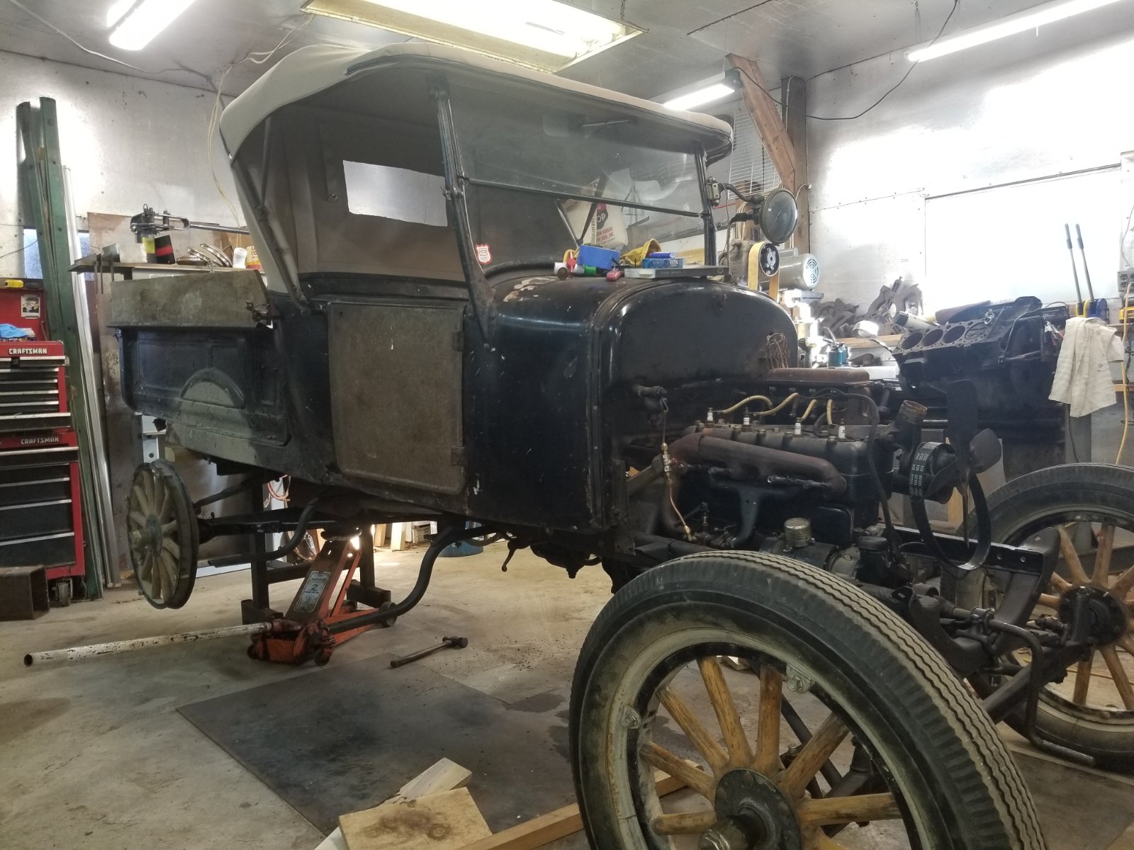

No sense in crying in my beer, I have most everything I need. I have about 4 hrs in removing parts as of now. About an hour more and it will lift off. I need to get the other frame home, stripped and blasted and painted then the fun begins. I also can get back to work on the fenders for the 8in1 bed while Im waiting. I am not doing a full blown restoration. Making it safe and fun.

Wow!! you are lucky that the fenders didn't start flopping like a Gooney bird taking off. Or even fall off while you were driving. Might have looked like a Laurel and Hardy Model T.

Jim, the headight cross bar held it up I guess. I was more concerned with the crossmember

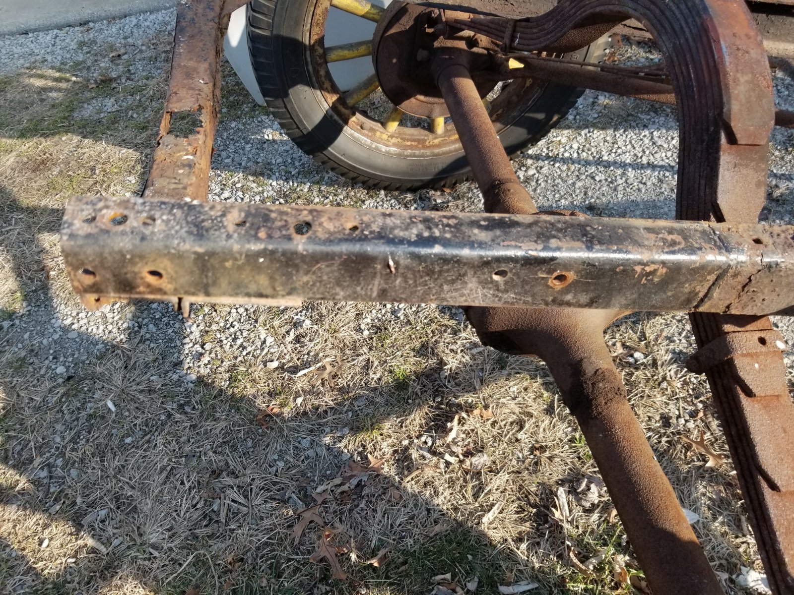

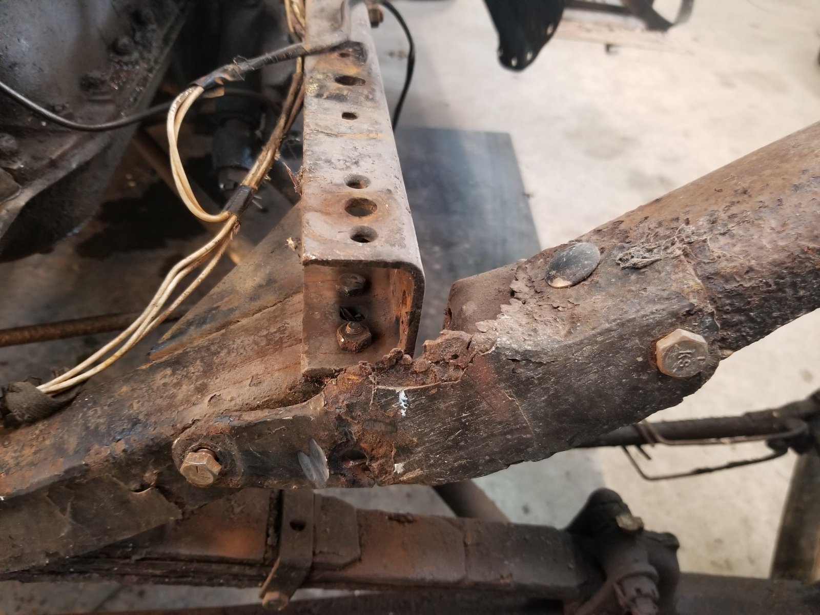

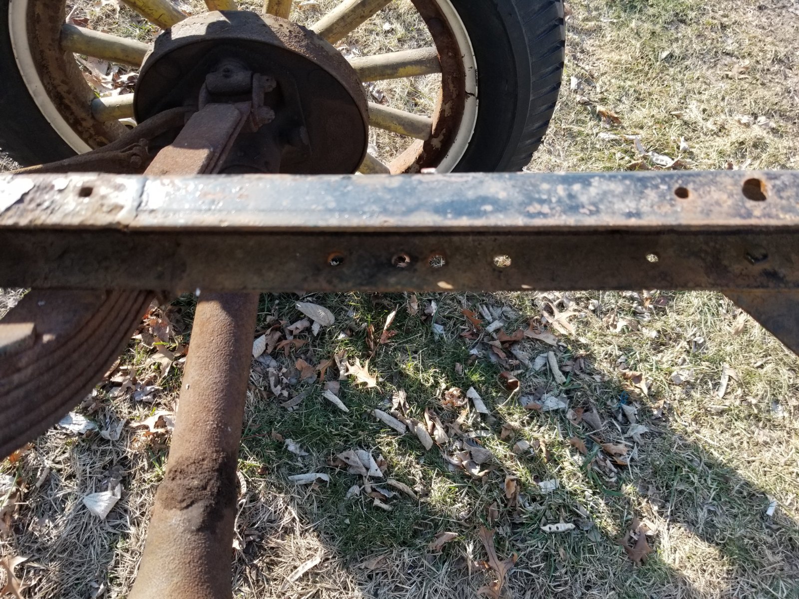

I am sure somene out there would be tickled to get the fenders you took off considering what new cost.
Wow,that cross member has seen it's better day and it appears someone has already welded on it some.
Glad you have another frame.

Mack, the fenders I removed as I discribed. Yard art is about all they are good for. They dont have enough metal content to scrap!

You have been driving this thing around for how long now? It should be just fine for another few years, shouldn't it?

Body filler and paint hide alot Wayne ! I have had a ton of fun with the old girl. Its kind of known around the area. Like the 6 million dollar man. We can rebuild it ,better, faster ,stronger! Well maybe not but good as new with a used farm truck face.

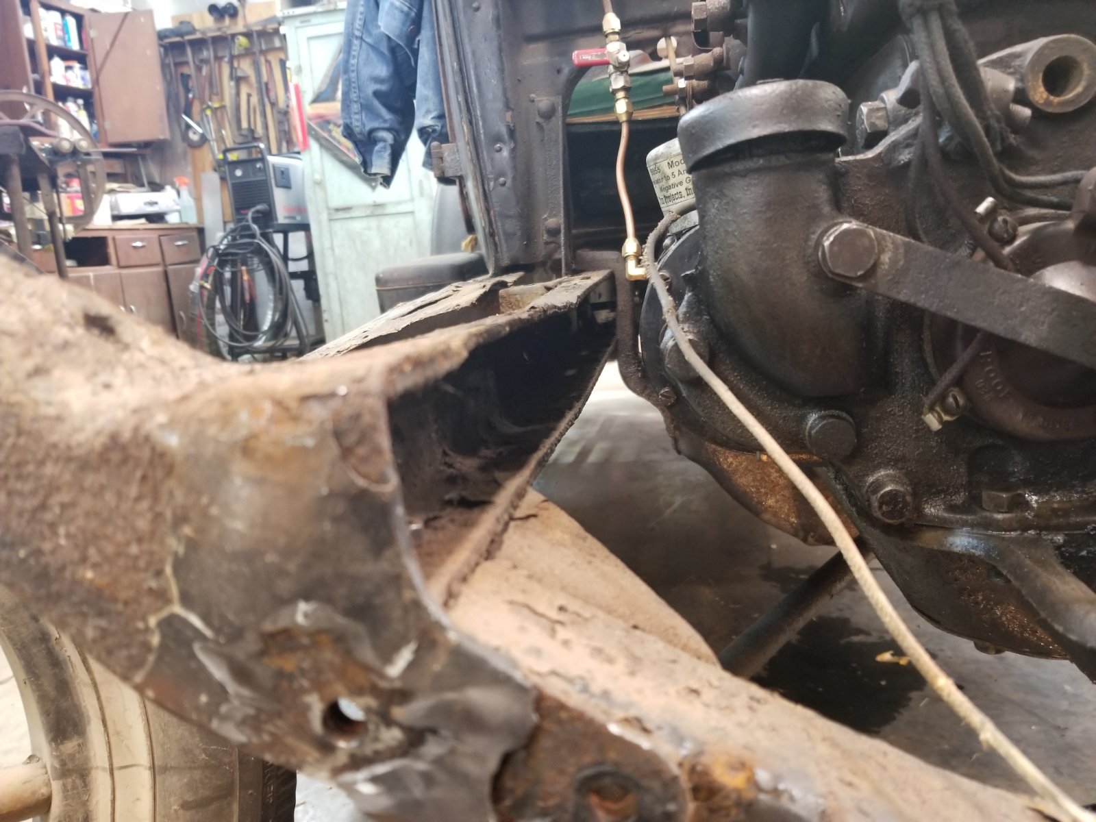

My goodness....glad you found it on your own terms. That's pretty rough looking stuff. The parts chassis that I bought kind of looks like that. It reminded me that these cars were just tools in the past and were patched together however possible so they could be put back to work.
And you're right, the engine swap will go from being kind of a hassle, to being borderline fun since you're doing it on a bare chassis that's just sitting there with no body, etc on it. You'll have to do what I do with my "weathered" car however, and resist the urge to make things too perfect and purty.
The RPU will be a better machine after all this. Looking forward to seeing your progress.

That frame is not only rusting apart, but bolted together. I agree, a better frame is the way to go.

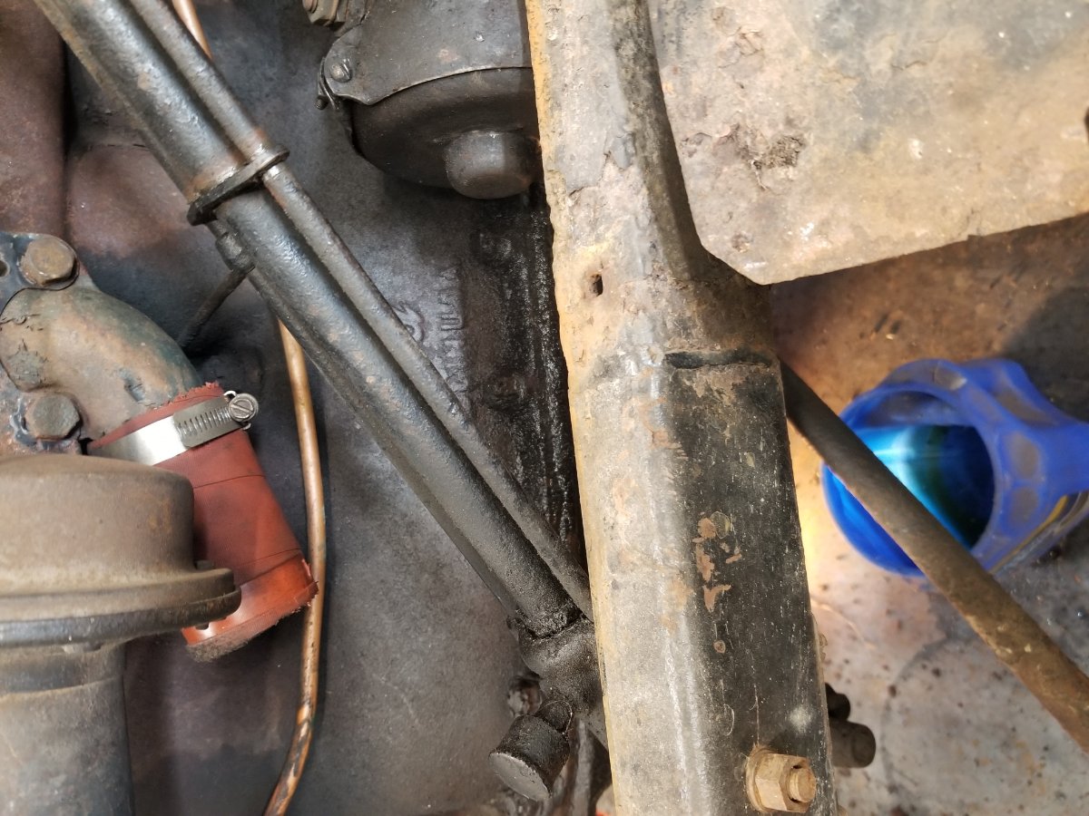

Don't forget I think it was mid 26 they started stamping the engine number on the frame on the passenger side under the floor board.So the replacement frame may have a number and you will have to stamp your current number on it or something in case of resale

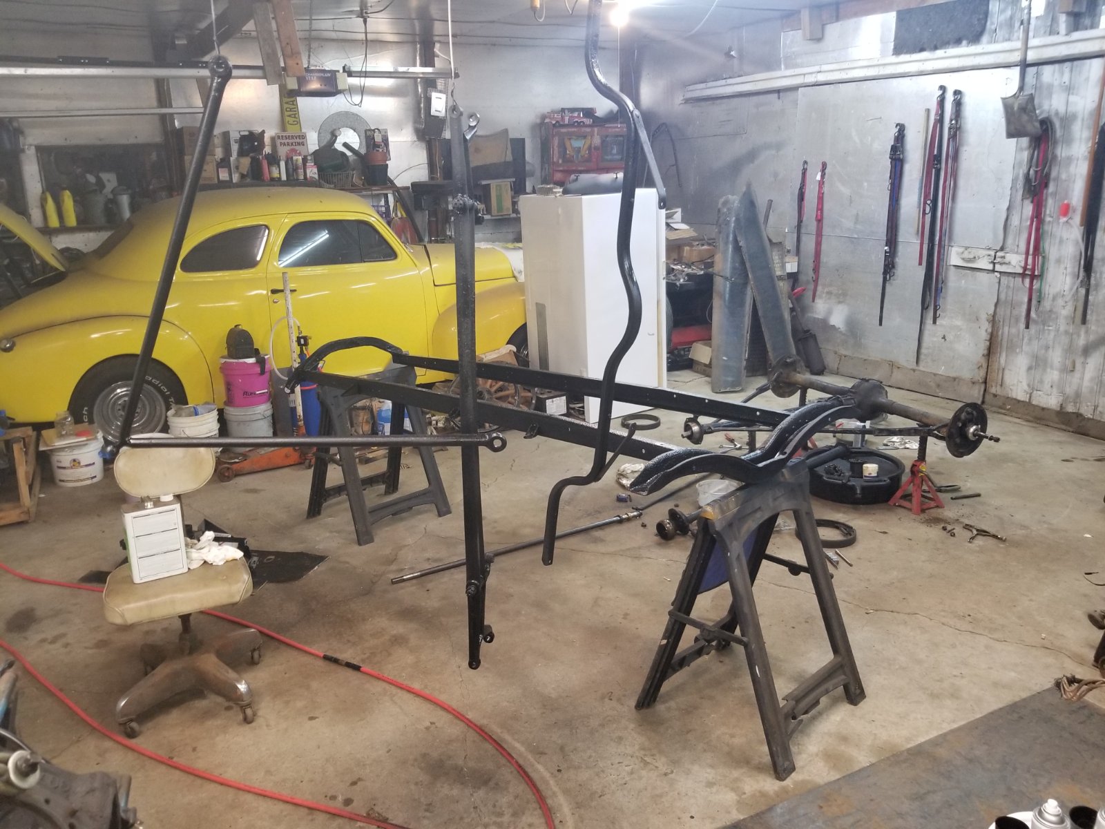

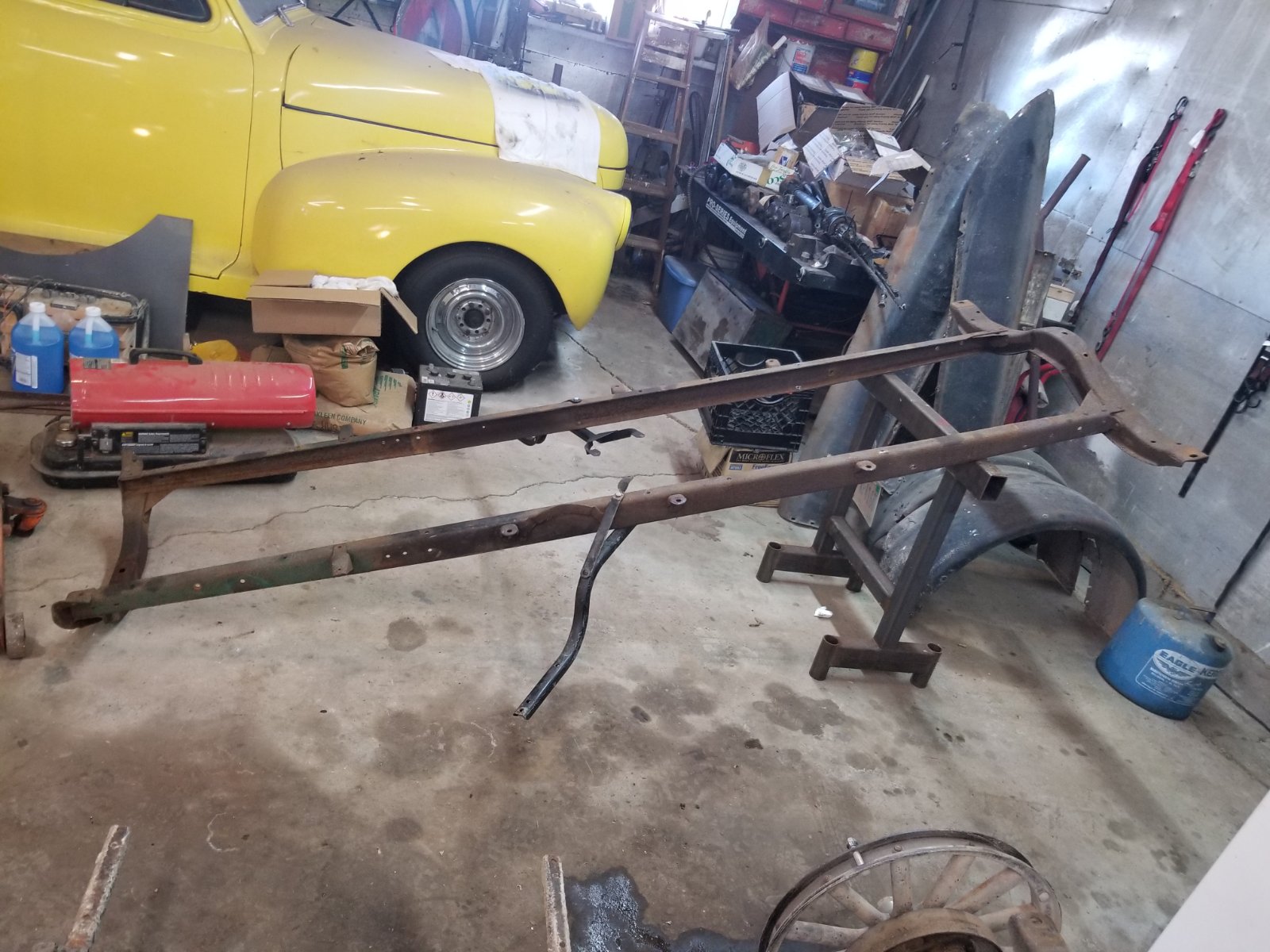

Problem solved.

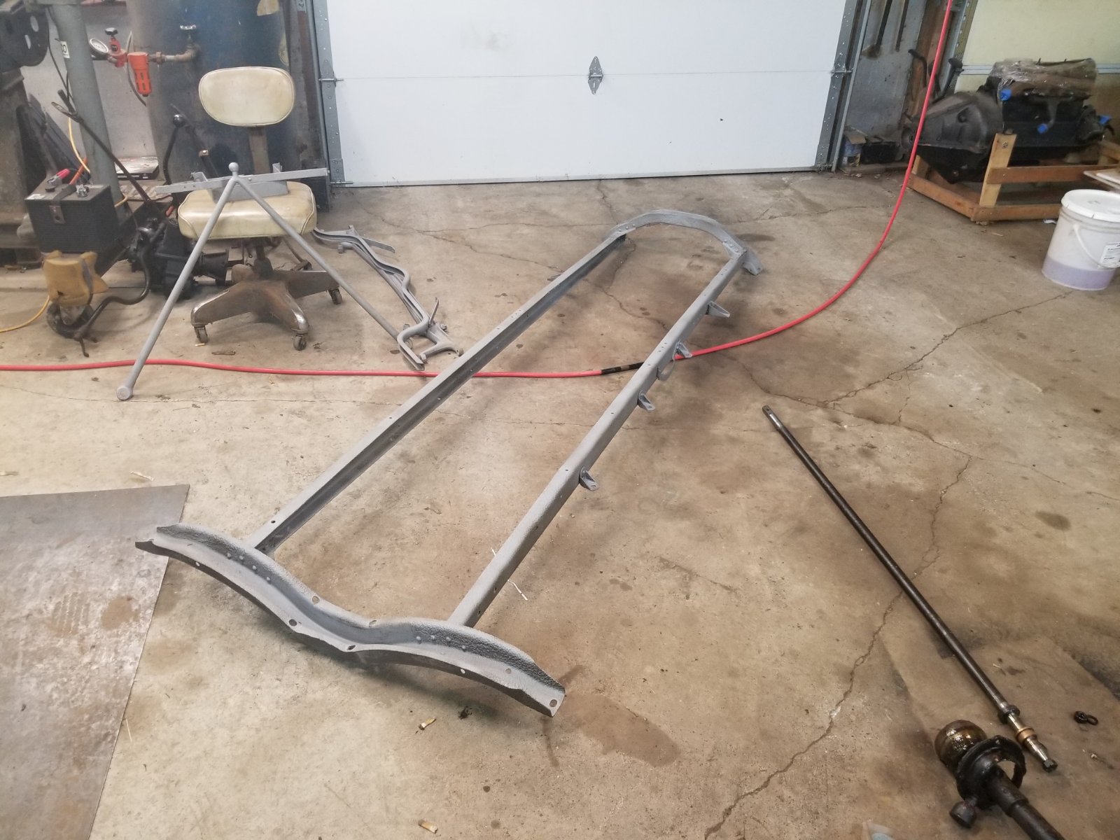

So it’s been about 3hrs since you posted the pictures of the replacement frame....you should be about ready for a test drive, eh Dallas ??

I have a bare frame lying on the shop floor Dave. The running board brackets were cut off so I removed what was left. Not ready to drive yet, I took a nap after lunch!

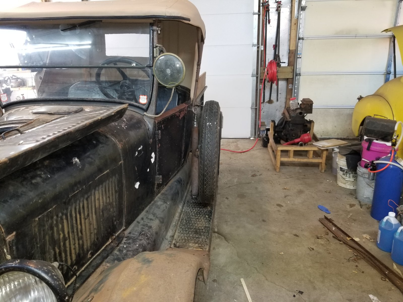

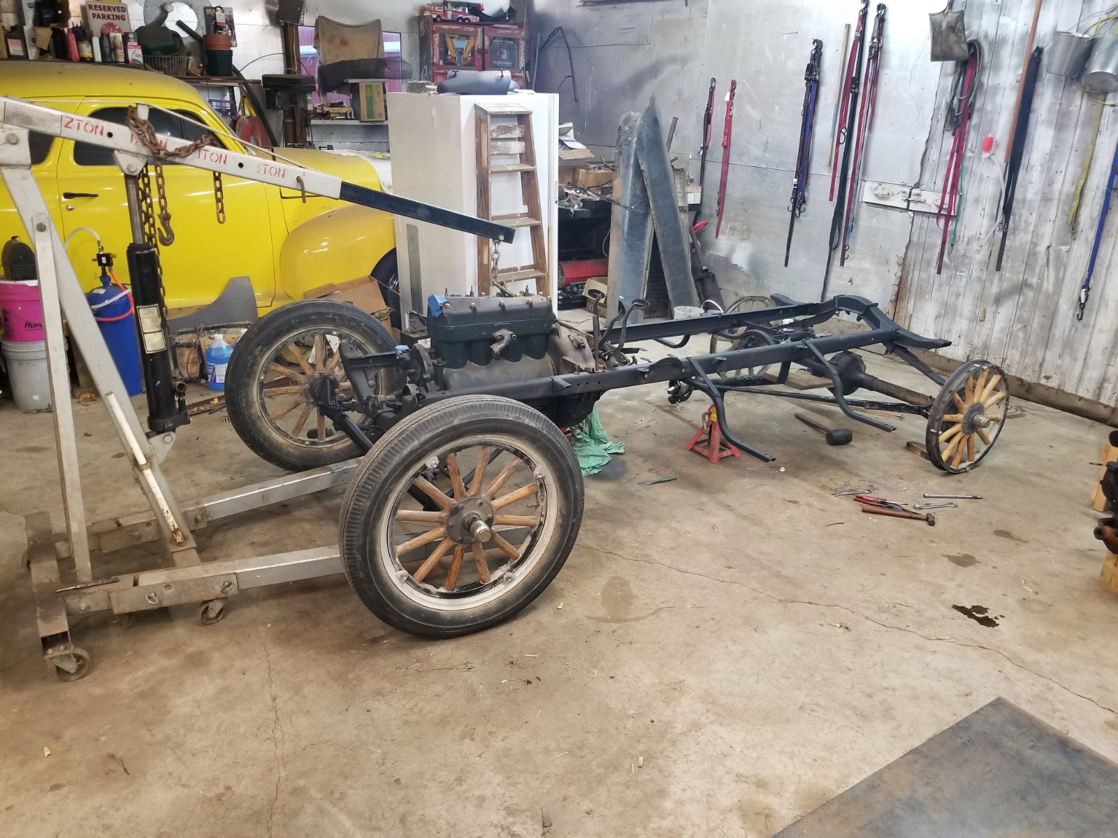

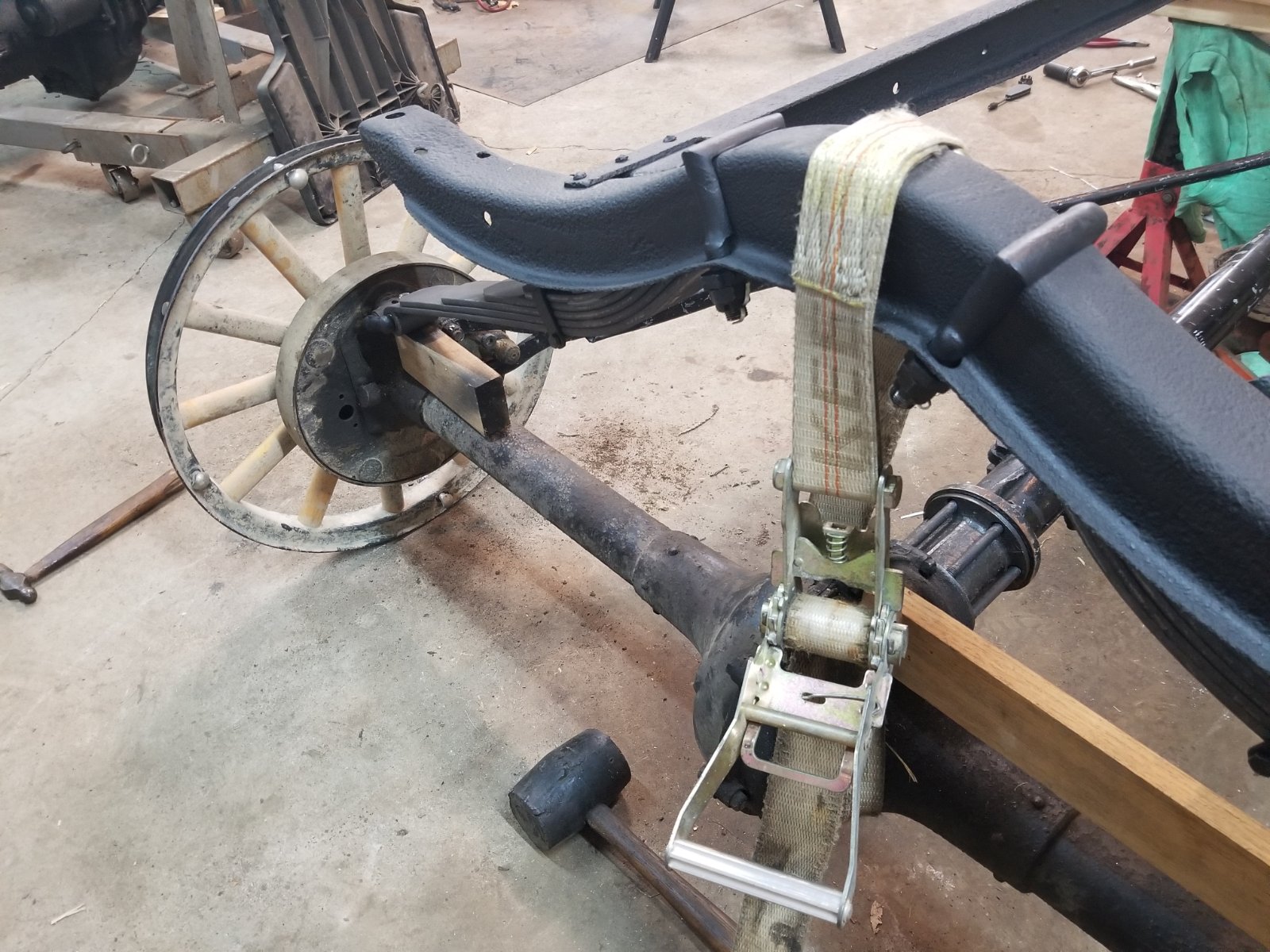

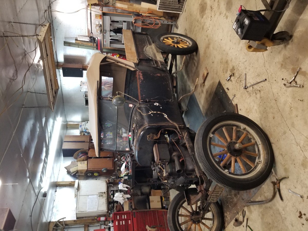

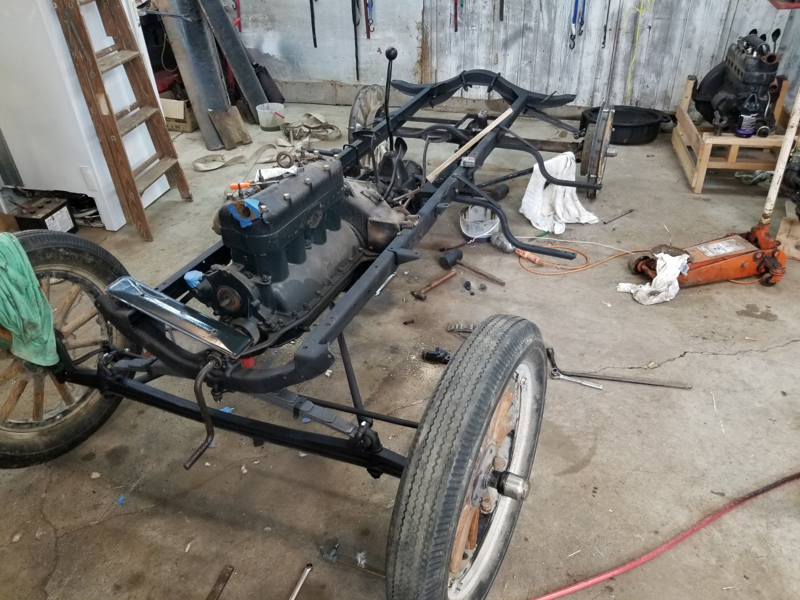

Here is the doner I brought home yesterday frame
Body is off and " not shown" engine is out.
We had to pull the engine in the doner chassis yesterday at my buddys shop. So far my wife helped move one metal stand under the metal brace holding up the body because my hands were full lifting. She is my go to when I need help.

I found brass cotter pins in the front spring perch castle nuts on the doner chassis. At least they were not rusted in. The castle nuts were 1/2 gone with rust. It still amazes me that nuts rusted that bad turn right off.

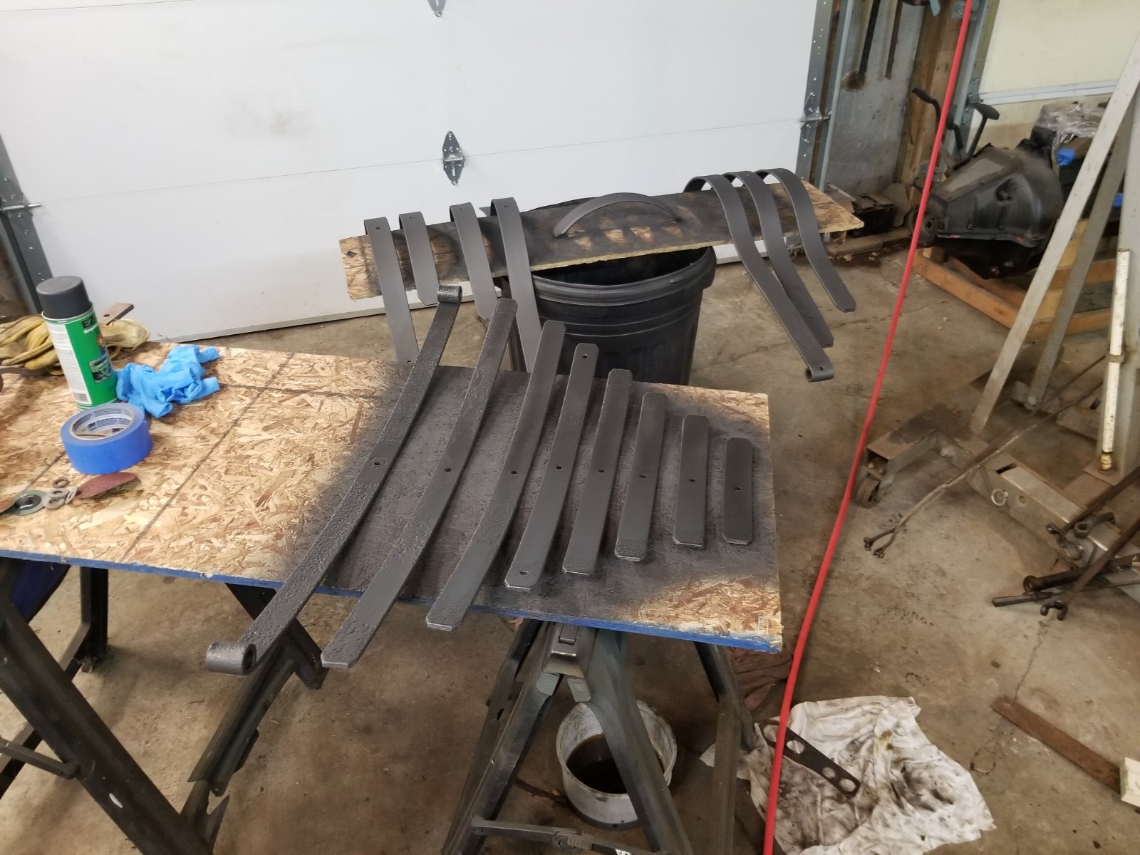

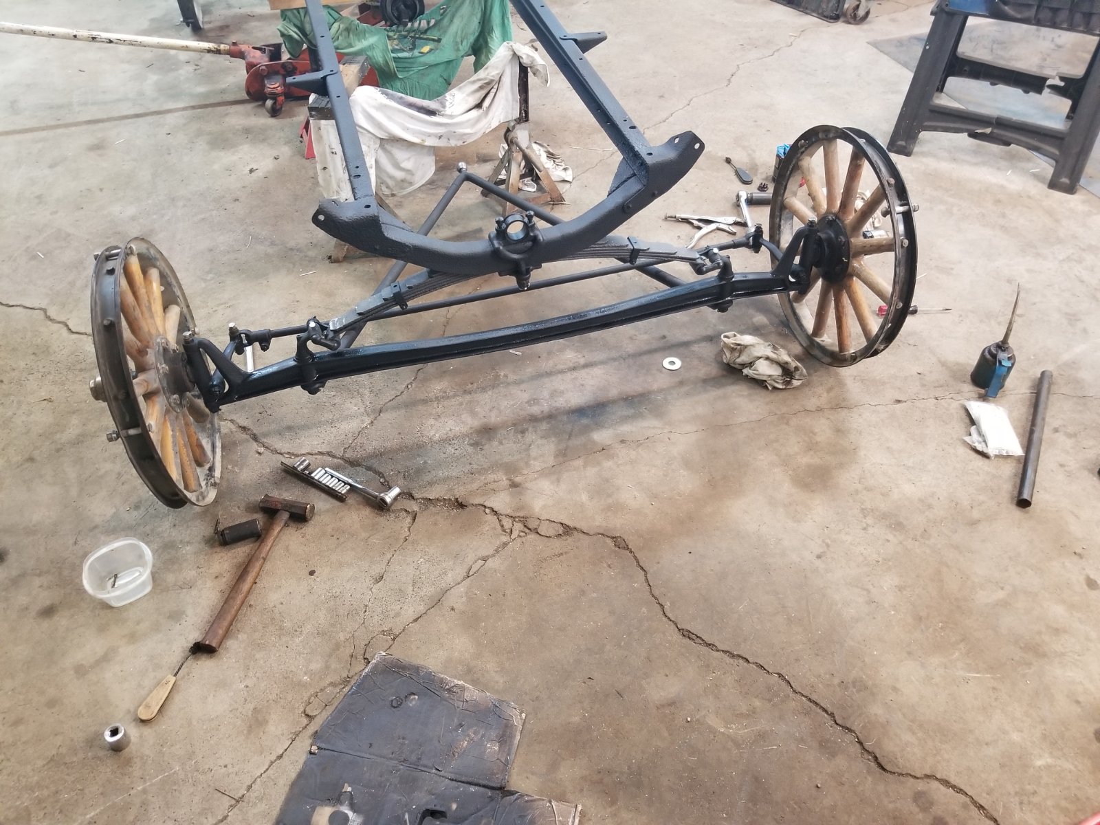

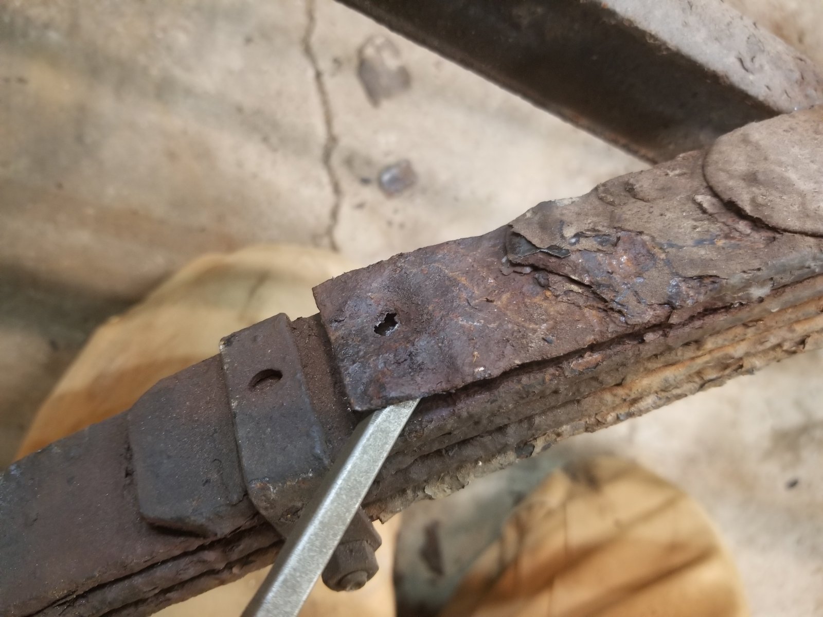

Finished stripping the original frame today. The doner front spring is apart. Rear spring ready to come apart. I have a box of bushings and other googies coming to get the suspension up to snuff. Putting it all back together is the fun part but alot of cleaning parts in order 1st. Have to thank the man in Tin- O- See for sending me some much needed bits.

Good day! I picked up my replacement frame from the sandblasting guy today after work.
After a little prep, I got some paint on all the raw parts I have been waiting on. All the suspension parts are rebuilt and painted.
This weekend I will be happy to start putting it together. Finally!

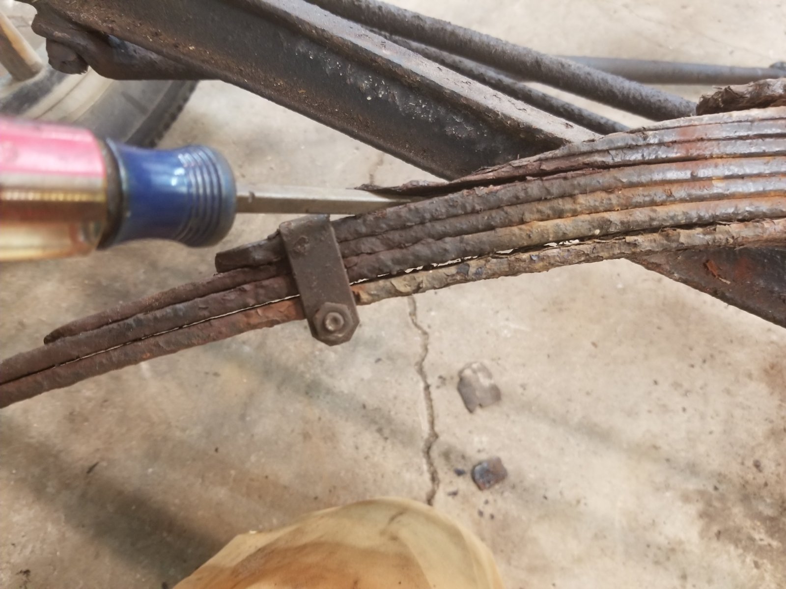

Don't put any more paint on the springs. Just slip coat between the leafs and paint the pack when assembled. Looks like it's coming along and space to do it in to boot!

I hung the front and rear springs, front axle and spindles on the frame last night. Hope to have a roller with an engine soon!

No body on the car to use a jack, so here is my solution to get the shackles in the spring. One hand on the ratchet strap and one on the shackle and it slid right in.
Better hurry Don, I will be driving soon!

Re: Major surgery to ride again.
BRILLIANT !! I like it when it slides right in...Dallas Landers wrote: ↑Sat Feb 01, 2020 1:29 pm20200201_130915.jpg
I should’ve done something similar when I installed my rear axle. That was one occasion that nearly made me question why I was messing around with T’s.

It has and engine again ! I spent more time looking for my front wheel bearings than installing the rear axle
I always ( almost) put them in a coffee container with a lid to keep them clean till I need them. Not this time, wrapped in a white cloth behind the front wheels on the floor.
I located the spindle arms by installing the tie rod also. I need to install the Muncie to locate the support for it. Then Im thinking I can slide the whole thing forward to get the driveshaft hooked up.
- Posts: 5450
I would have put the Muncie in first then the rear end. You may have a fight on your hands trying to fit the rear end into the back of it. Maybe
Looking good!

Mark, I may have to go that route. I had two fire calls today and visitors to the shop . It was a good day!!! If tomorrow goes good, I should have all major components in place. 50 and sunny tomorrow. Garage doors open? This weekend is it for a while as I leave for Iowa thursday to call coyotes with my buddy. Will be stopping to see Dave Stroud while Im out there. Yup, thats your warning Dave!
Hank, if it was all easy, everyone would have a model T. I had a good therapy session today.

A little update. I had sme time today to spend in therapy. I got the Muncie hooked to the reat axle and everything bolted in place. Hook the front radious rod to the pan and the drag link and the chassis will be complete. Next step is swapping things from old engine, carb , generator, ect...
I snapped this before today.

After looking things over, I used the Mark's method. Removed rear axle and went that route.

After the grand daughters ball game this morning I hit the shop. Installed the manifolds , carb, exaust system, starter switch, starter and cables,generator, coils and all wires to coil box, timer. Looked over everything for cotter pins and tightened bolts.

After a cleaning up the shop and putting tools away it was ready for the body. The nice thing about the model T is you can install and remove the body by yourself.
After a field fire interuption this afternoon, I have the body bolted to the frame once again. Looking forward to firing this new engine tomorrow!!!

DO NOT install the starter until after you install the firewall support bolts on the driver side! Dont ask me how I know this.

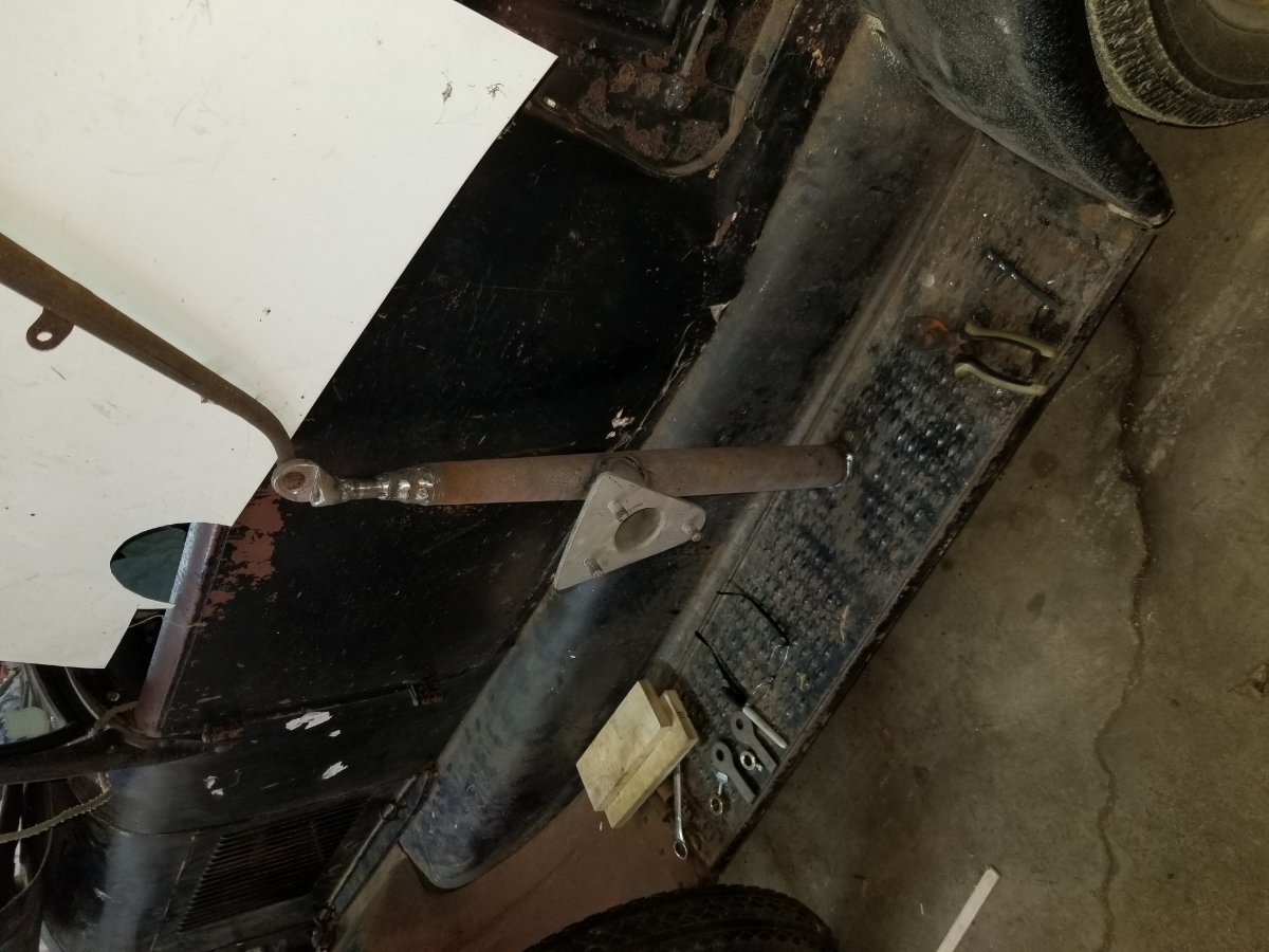

A little side track this morning. Installing the steering column and found the holes did not line up in the frame. I checked the old frame and discovered why! Everone needs options but I didnt want any extra holes in the frame. ( you can see where the section has been welded and extra holes drilled on the old frame)
I had to install the correct frame mount on my column. After a call to Pops in Tin O C , I was off and running. Well I was able to install the column anyway. So now Im moving forward again.
Stay tooned for further broadcasts!

After some untwisting and straightening the front fenders are hung. These are not the fenders that were on the truck. They were full of bondo and were falling to pieces.Last evening some more sheet metal went on. With 8 inches of new snow on the ground, the urge to burn something should slow down for everyone. The parts pile is getting smaller. Maybe I can get things buttoned up and get ready for a shakedown drive by sunday.
Topic author - Posts: 2832
- First Name: Dallas
- Last Name: Landers
- Location: N.E. Indiana
Well it looks like a truck again.
Better than a couple months ago.
I brought it to temp today and it starts and runs great. Spent some time adjusting things this afternoon for a possible drive tomorrow. Cant wait to see how it rides and drives after suspension and steering work.

Thanks Don. Just trying to make it safe and fun and give it alot of years of on the road use.
I took it down the road before noon. The snow and ice was not a problem but needed some more band adjustments, so back in the shop to cool down.
I made the adjustments and went back down the road a few minuts ago. Adjustments worked but the fact I have no floor boards in it was a bit wet in the cab with 2 inches of slush now! Since I have the correct year engine and not a 22 like it had, I need to make new floor boards. I was very pleased with the Muncie. The only gear noise I could hear was in 1st.

Dave that was last weekend. This weekend we have snow. Next weekend will be dry again. Gotta love Indiana weather.
My trips today were only about a half mile and back. Just a shakedown for any problems and adjustments. I did enjoy it ! I see alot of miles ahead of me.

Well I managed to get it lined out and running like a top. I drove to town and filled the tank for some road time. Now I need some nice days with less wind. Its going toward 60 degrees sunday.

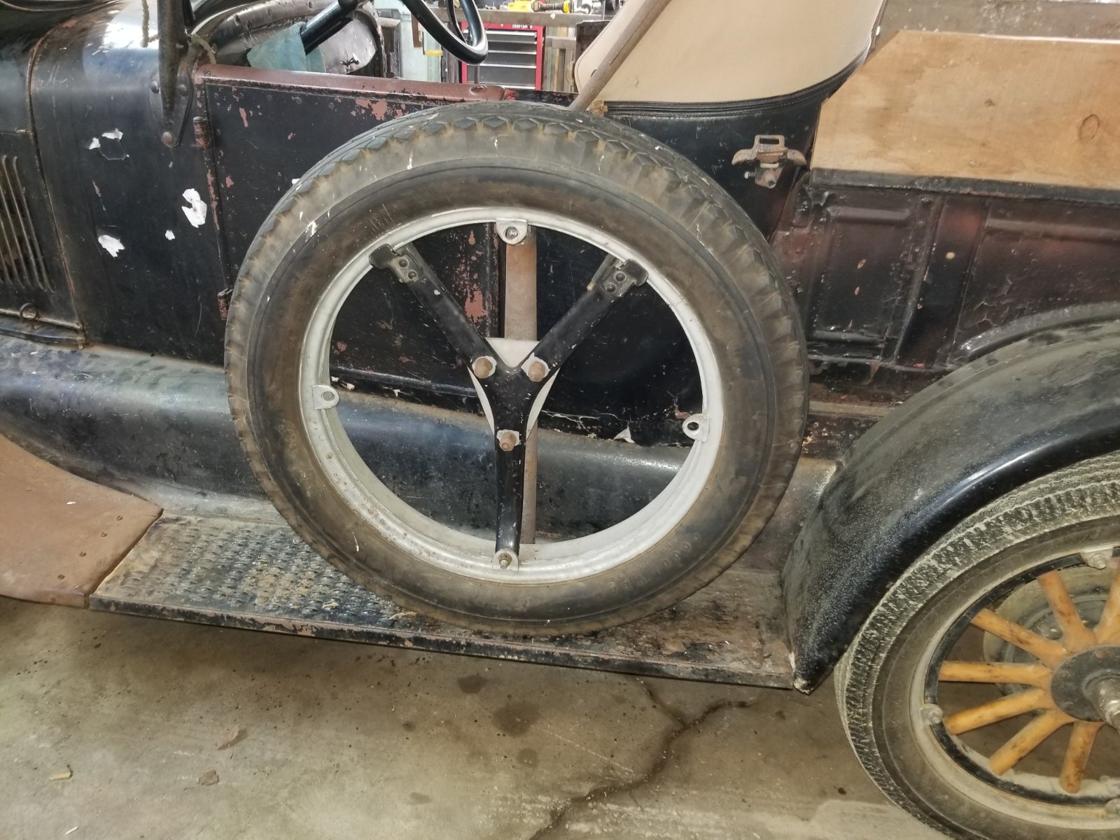

While I was in the mood, I installed my spare tire carrier. Thanks to Hank and a kind of "do it yourself kit" I put it all together and turned out perfect for my farm truck. It is made of model T parts so its all good. At 25 mph it looks original.
