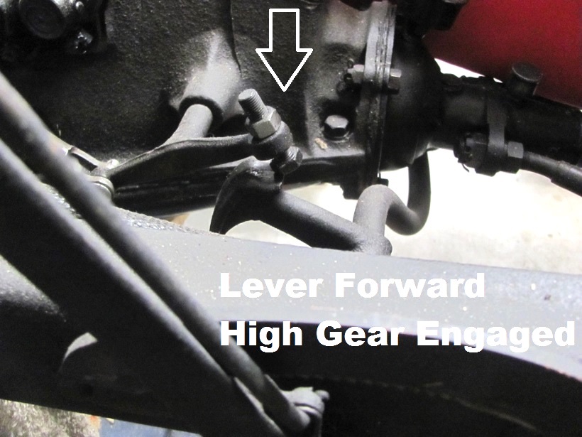

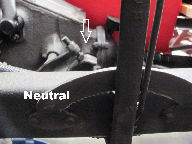

Refresh rings might be good idea, and check the valves, if original they have two holes on the top for the old time valve grinding tools, those original Ford valves are iron head and steel shaft, known to come apart. Best to fit new one-piece stainless steel valves if you are doing a whole short block refresh.
Stiff clutch plates is rather normal in a T, as no true neutral, the disc stack runs in engine oil and that old oil can set up the discs to be stuck some what.
Just be sure the clutch/emergency brake lever is up near vertical, to pull the clutch lever adj. screw up, that will release the 100 lbs. clutch spring pressure off the discs so the clutch can be mostly free. When that brake lever is forward, the clutch is engaged for high speed.

Ok. Thanks for the information . I tried the park brake lever what I thought was straight up, but it still wants to pull forward when I turn engine over. It’s been setting awhile with no oil in engine. Maybe once I get pan back on maybe fresh oil will free it up. The valves in block do not have any holes on the face of them. Maybe they aren’t the old style. I thought I would lap them by hand, I’m hoping they have the adjustable lifters installed. Thanks again for the help.

That should do it, just add oil :) The T really likes oil, everywhere, and will cast it off regularly.
Those metal discs sitting tight together dry won't want to spin on each other's faces :shock:

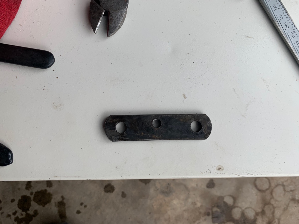

Just found this plate while trying to dig a rod bolt from
Under the flywheel. Could someone identify this before
I go any further. The oil pan was already taken off this car
When I purchased it. I tried to add the picture- maybe it will show up. Thanks

Not for sure thats off of a T. Could be a piece from the garage floor that was picked up by the magnets if the pan was already off the engine.

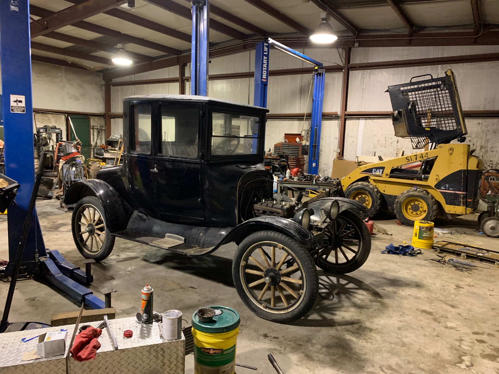

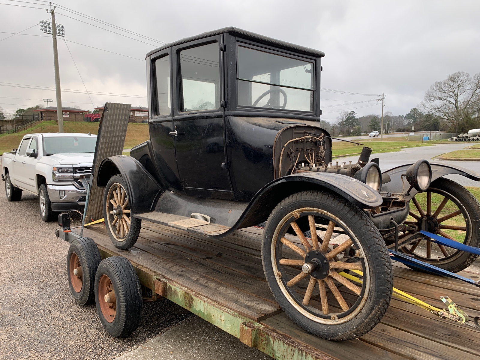

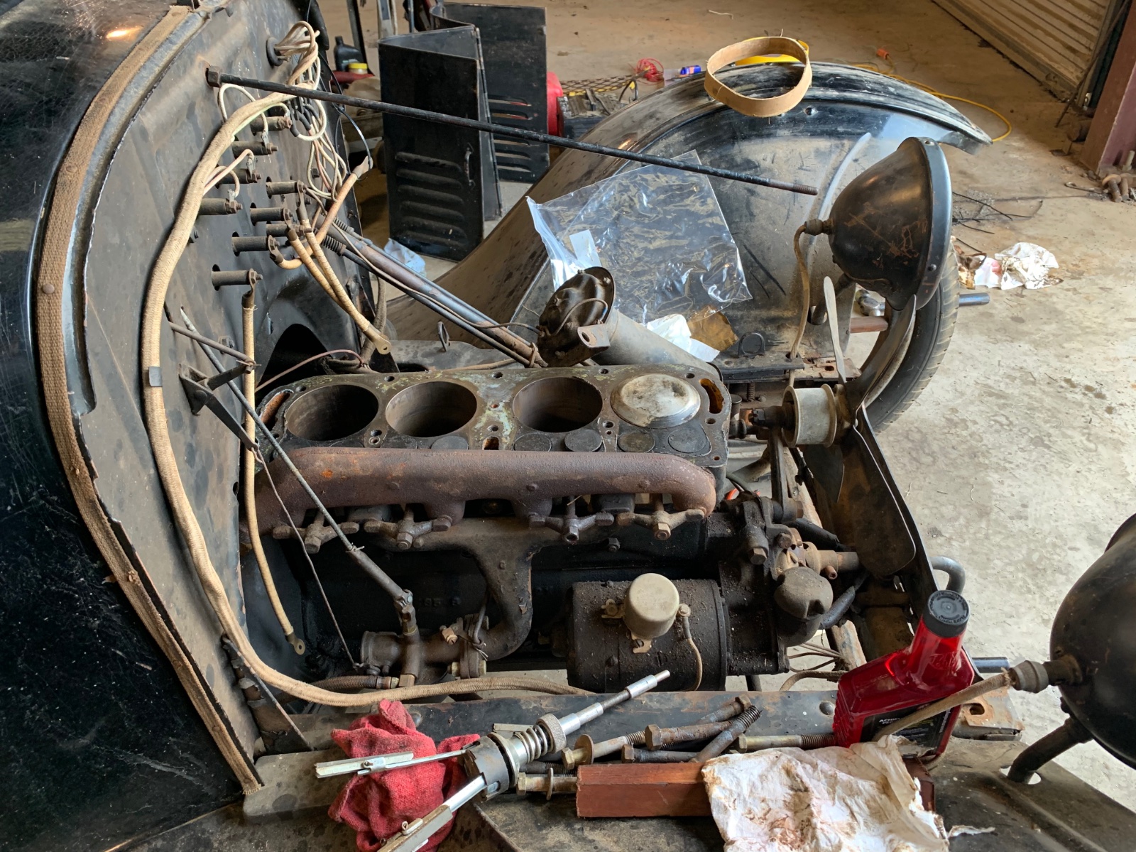

Here’s a couple pictures of the Coupe. Not too bad shape
For sitting over 20 years.

That’s a nice 24 and better than fair condition! It’s great that the car wasn’t left outside behind a barn. They wind up that way sometimes and the weather just ruins them after many years. Not this one though. I’ll bet the wood is still in overall good shape.

Yea, the wood seems to be in good shape, I saw some
Powder post Beetle dust on the running boards when I bought it, but no rot anywhere. Interior is good, but is starting to
Rot in a few places.

That piece of steel is a 188 outside chain link that I had made millions of when working at my old job before retiring at Wesbter Mfg, except for the hole drilled in the center of it, would know them any where!

Thanks Joe, no telling how it wound up in there. I’ll put it back
For a time when I can get around to going through the transmission- just in case. Now if I can just get that #%!% rod bolt out of There. May try removing the starter and trying to access it
Through that hole. Thanks for everyone’s reply.
