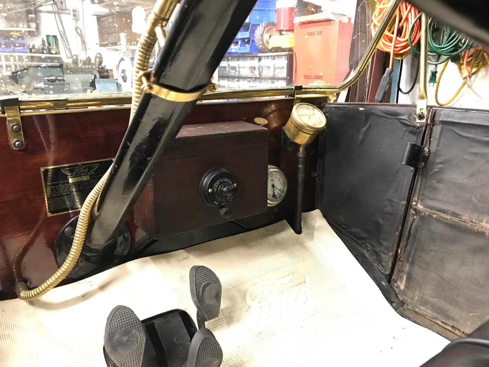

After working on my original Heinze coil box and coils all winter, everything was installed today. Car started right up and runs great! I rebuilt 7 of these late 1912, early 1913 coils during the winter, and NONE of them have any issues or double sparking! They all have new windings, points, and capacitors. All of them set up beautifully on a Strobo-Spark tester with an adapter I made to cater to the Heinze coils. My car is a 4 generation family owned early Canadian Touring sold new in Tavistock, Ontario, Canada, about 10 miles from where I live now.
I decided to do as little to the coil box itself as possible cosmetically. I just upgraded/cleaned and protected the original finish which was still pretty good. Making sure all the wiring is good and all the contacts clean. My car isn't a show car, nor will it ever be in my lifetime. Keeping as much of the car unchanged but correct as possible is fun for me. I guess time will tell how long the coils will stand up. I see no reason why they wouldn't last another lifetime. With a spare '13 steel coil box under the back seat with 4 rebuilt coils in it, I'll never need it and the Heinze unit will probably keep me going down the road reliably! This has been a fun and very rewarding project!

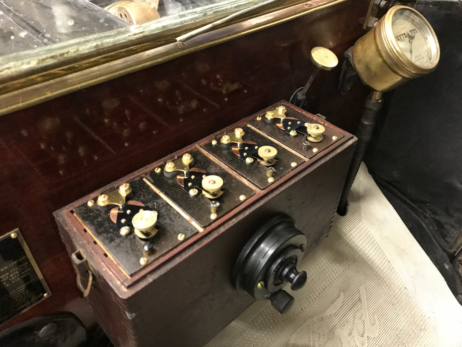

What I found when setting them up was firstly, I had to bend the lower point assembly a little bit back and forth to get the amp draw on the coil to be within the restrictions of the brass knurled knob adjuster. Sort of a "coarse" adjustment. The 1913 coil's knurled knob assembly are a riveted assembly which prevents people without a small machine shop from taking them apart
The 1912's can be unscrewed completely.
I used a setting of 1 amp on the strobo-spark coil tester. This seems to be the sweetest spot to set them at WHEN you are using regular off-the-shelf windings and not the original styles like RV Anderson provides. I'm not sure just why, but it seems to work. I had more trouble getting rid of double sparking when I tried to set them to 1.3 amps. I also had to make additional spacers on my lathe to go under the upper point assembly to accommodate the fact that the same points used on the regular Ford coil points are used on the new Heinze points sets, so the higher clearance is required. The air gap under the lower points seems to be best using the top plate as the reference to measure from. My primary cores are as close to flush as possible with the coil's top metal plate from studying the originals carefully before I gutted them. Roughly my air gap seems to work out to about 0.015 - 0.020". When setting them up I did initially get some minor double sparking, but I found that using a very fine set of smooth needle nose pliers, I could very slightly raise or lower the top point assembly with a teeny tiny amount of bending, and that got rid of the double sparking! I could get nice fat sparks consistently, and checking the coils later on, the setting stays stable.
I see no reason moving forward why these coils wouldn't work trouble free for years and years. I guess time will tell and I will gladly report back here as time goes on.
