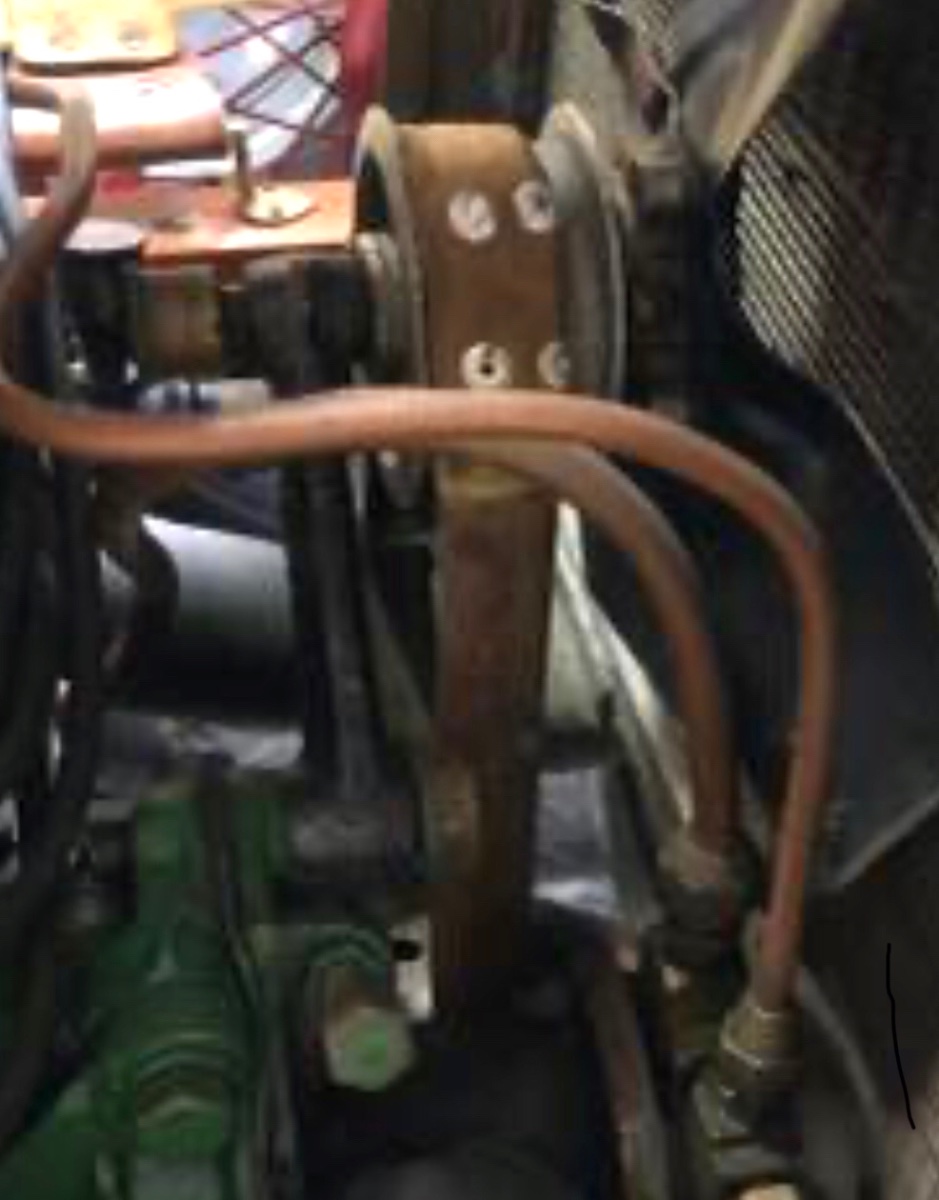

Must go fast enough to burst the fan belt into two pieces.
It’s been repaired with Pop rivets :D
