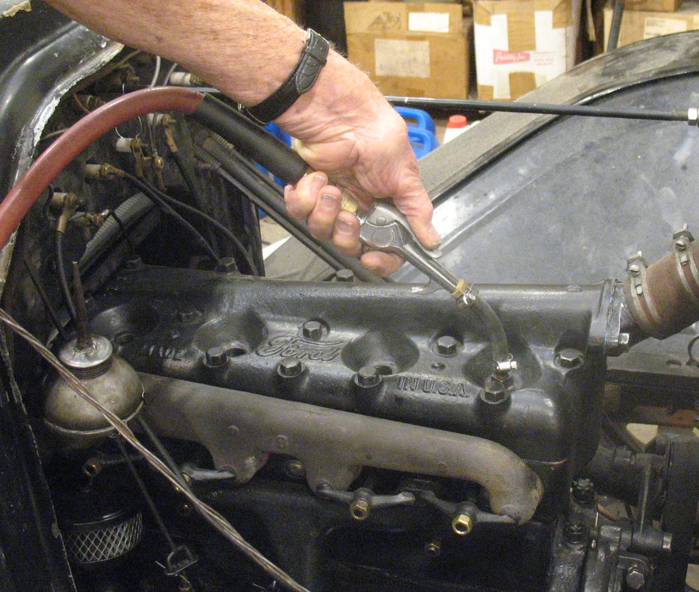

If you haven't already, Try adding compressed air through the spark plug holes. That may help in determining where the compression pressure is escaping.

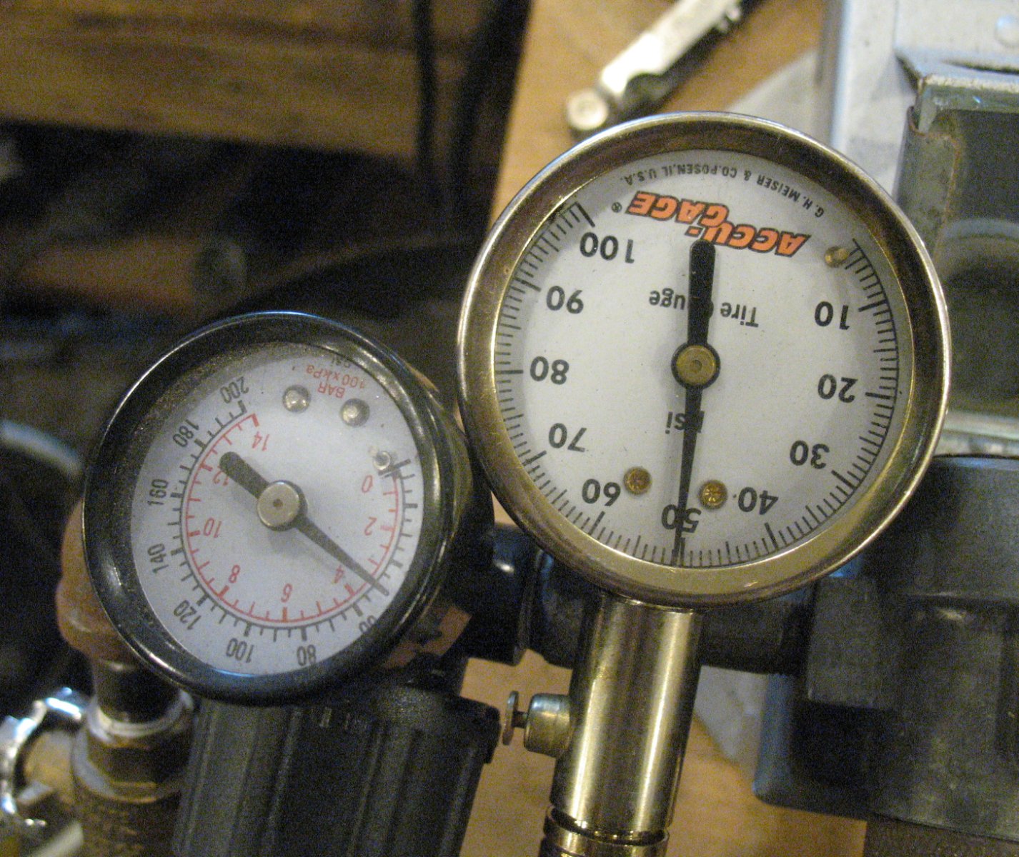

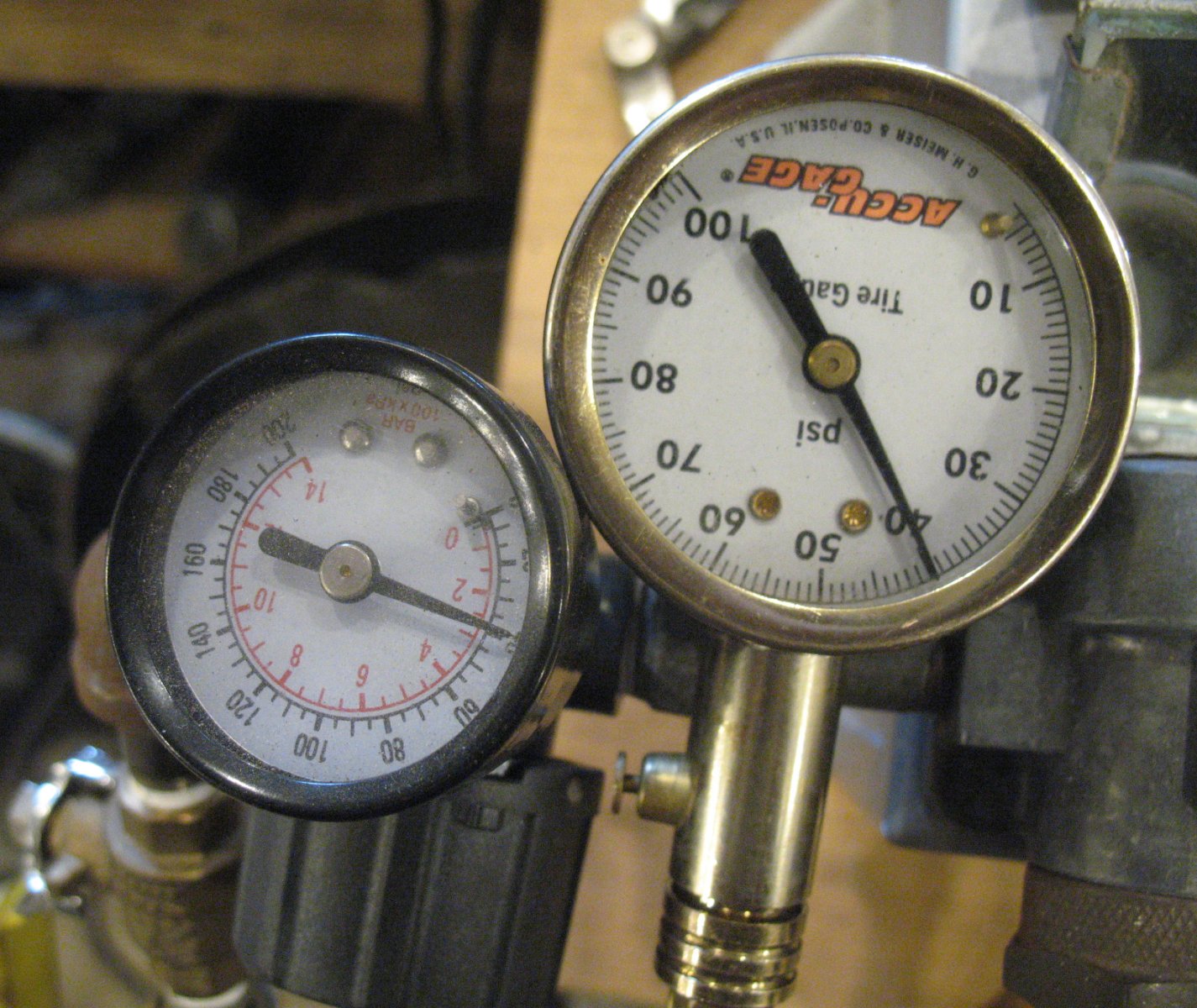

Your gauges could be messed up. Are you using a screw in gauge or a gauge that is pushed into the plug hole and held in place while cranking?
Screw-in, good and tight. Wondering about the accuracy, I screwed it into the spark plug tester and checked it with the regulator.
Setting the regulator at 40 psi, the tester shows 40 psi.
Setting the regulator at 50 psi sends the tester to 501/2 psi. All those bad numbers were real.

Well that rules out bad tools,scratch that off the flow chart

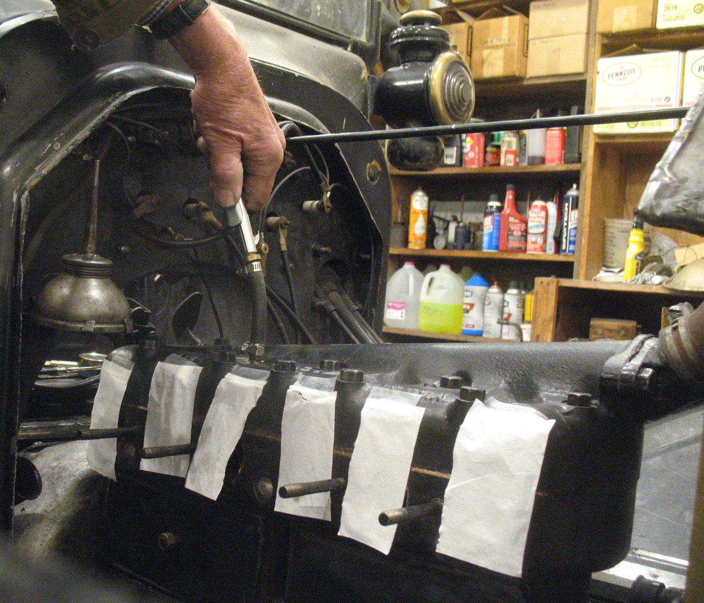

I’m with Art....TDC on compression stroke, hold engine from turning and blow air into respective cylinders. Air should be escaping somewhere, crankcase, intake or exhaust. If not, I would be double checking valve timing.

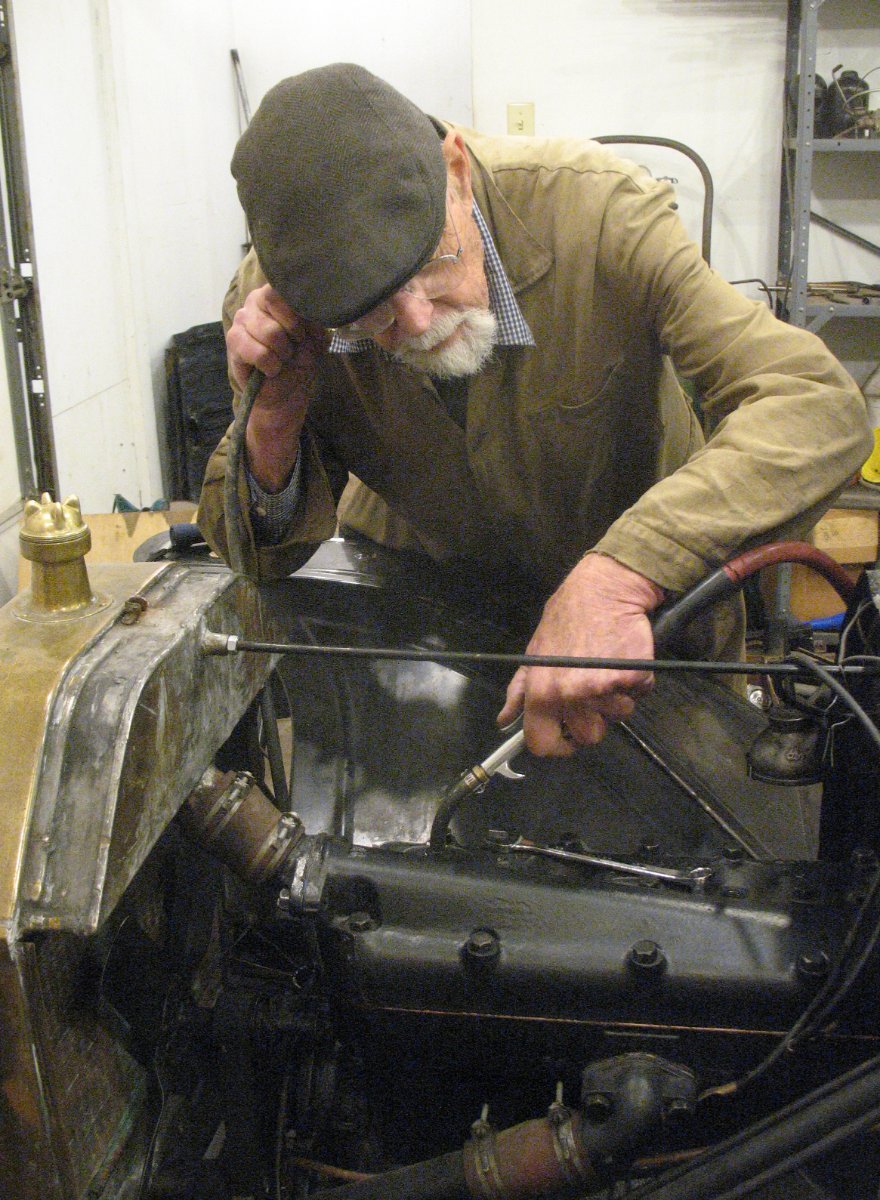

at TDC compression, do a leak down test and listen to intake, exhaust, crankcase, for sounds of air escaping. One test each for all 4 cylinders. You will find the source of non-sealing pretty quickly with no guessing. Have the car in gear, wheels chocked, throttle open, and don't use too much pressure. This is a simple, gross test which will lead you to the correct source(s).

Post by Steve Jelf » Tue Mar 17, 2020 4:52 pm
I haven't done this before.10 psi enough, or more?

No I would use 60-80psi. Just make sure the valves are closed and the engine can’t turn over.
A little air from the crankcase is normal, but virtually none should go past the valves.

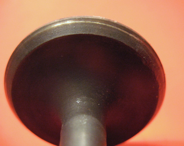

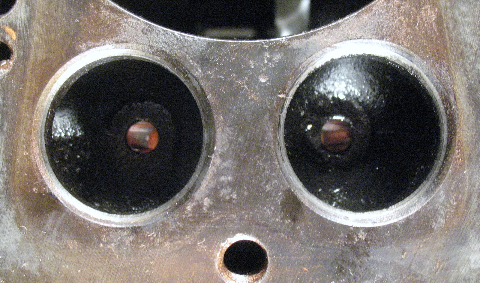

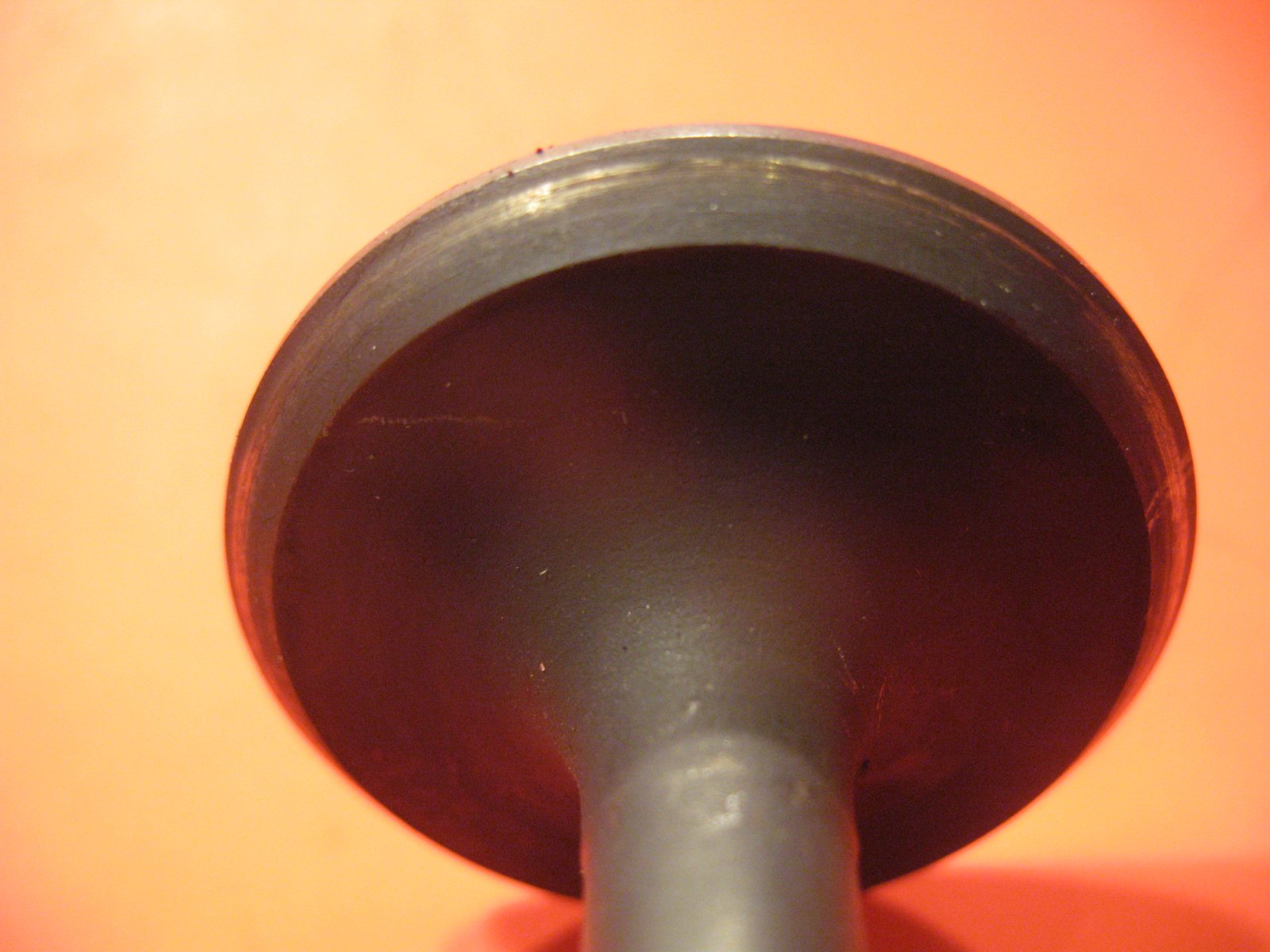

So I have been watching this thread grow in popularity since your original post, and I finally read thru the whole thing. There are a number of good suggestions, a few good stories, and a little bit of thread drift. So I’m going to do my best to keep on topic...
You already identified your hard starting issue... low compression. But what’s causing the low compression...?
Is the head gasket sealing? Yes! A couple times you report the same compression readings after swapping the gasket and surfacing. This is an easy one to get right too
Are the rings sealing? Arguably they are leaking as shown by the wet compression test... but are they leaking too much? I don’t think so. You had the head off to change the gasket, my guess is that you would have noticed an 1/8” of ring gap...?
Is the cam out of time? Easy to check with the timing cover off... not so easy without! You could look down thru the spark plug hole and pull the engine over with the hand crank. The valves should have near equal “overlap” at the top of the exhaust stroke. If you are a tooth off, the overlap will be offset whatever 1 tooth equals in crank degrees (15?). You should be able to see this without a degree wheel. But in reality, this is a hard one to screw up during assembly, and all 4 cylinders would show the same issue
Are your valves sealing? This is the one I feel you should consider the most. Model T valve springs are reaaaaaly weak, and it takes spring pressure to seal the valves. Valve seat pressure is the simple formula of spring force divided by the surface area of valve contact face. If you double the contact width, you half your spring pressure! The 3 angle valve grind is not a performance grind, it is the bare minimum to achieve proper seat contact area, maintain seat pressure, and therefore ensure a good seal. Of course you can have concentricity, roundness, and guide clearance issues that will all negatively affect the quality of your valve job. As stated above, it’s common practice to grind your valves and seats 1 degree different. This technique ensures the maximum spring pressure due to minimum contact area, and so wears away almost instantly. Also, when you do your leakdown, try using the 10 pounds you questioned originally. The 80 psi suggested above could actually force the valves closed and cause them to seal better and provide you with a false sense of security. The same effect that causes an old motor to start hard and “run fine”. Run the test again with the lower pressure, and the leak may be obvious!
Why do your compression readings vary? You are hand cranking! We all get tired... your readings show a relatively consistent pattern and so I can believe they are relatively accurate, but I believe some of your wild wet/dry readings could be explained by the additional top end lube and/or operator fatigue
My .02 cents... pull the head, throw away the lapping sticks, and grind em right! She’ll probably purr like a kitten

After taking April off to attend to other things, I got back to this today. A month of sitting didn't cure the compression: 33,15, 25, 20.
I tried the leak-down test and it didn't make me any smarter than I was before. I set the regulator at 60 psi, set each cylinder at TDC, and shot in the air. I could hear air moving somewhere, very, very faintly. I think it may have been in the exhaust manifold, but the sound was so faint I'm not sure. With a stethoscope I couldn't hear anything at all. I think this engine needs to go to somebody who knows what he's doing. :(

A stethoscope won't do it. a piece of vacuum or fuel line will help. Put one end in your ear and hold the other near the carb, muffler outlet, oil filler, radiator filler, and other spark plug holes. With a piston on TDC compression, air out the carb is intake valve, out the exhaust is exhaust valve, a little in the oil filler is normal ring gap, while a lot is broken ring, ring land, or head gasket. Other spark plug holes or radiator filler is also head gasket.

Post by Steve Jelf » Thu May 07, 2020 10:04 pm
Well, I did the test today following Marshall's suggestion of removing the manifolds.
With strips of tissue hanging over the ports it wasn't hard to see air movement. #3 was the worst, and you can see the tissue on #3 exhaust blowing in the wind. Most of the valves leaked at least a little. I'll do this again and take notes on which valves are especially problematic.
I also stuck a hose in the oil filler and listened to the crank case. I could hear air on every cylinder. I think Fred and Mack are on the mark with their suspicion of fried rings. It probably happened when I ran out of coolant in Illinois last September. I hope that incident didn't damage any more than the rings. I shot some oil into #3 and listened again as I applied the air. I could still hear air leaking past the rings, with a little gurgle of oil blowing through. Looks like those pistons will be coming up.

Great job Steve !! Sounds like you’ve made some positive conclusions and can move forward now.
I also hope there’s no major hidden damage to the block. Probably a scuff with a hone and new rings will cure the bottom end.
I would double check valve clearance before removing them, just to see, but the valve seats should be obvious once the valves are out.
Carry on....
Great idea about the tissue paper, I hope you can salvage some for the bathroom. :lol:

That was going to be my suggestion too Steve, the rings...everything else seemed to be sort of correct. One thing though, did you also grind the valve seats on the block when you did the valves? I mean did you do them separately from the valves? It's important to level the playing field first, then fit the valves to the seats. And if you've done all that, then check the rings, in particular the oil wiper ring. Also might be a good time to re-hone those cylinders too, just to give those new rings something smooth to travel on. ;)
I always buy the biggest package for the lowest price, so I had a stock to last several months when the Great TP Panic of 2020 arrived. :D

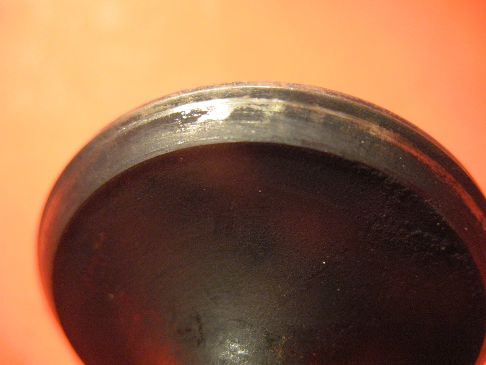

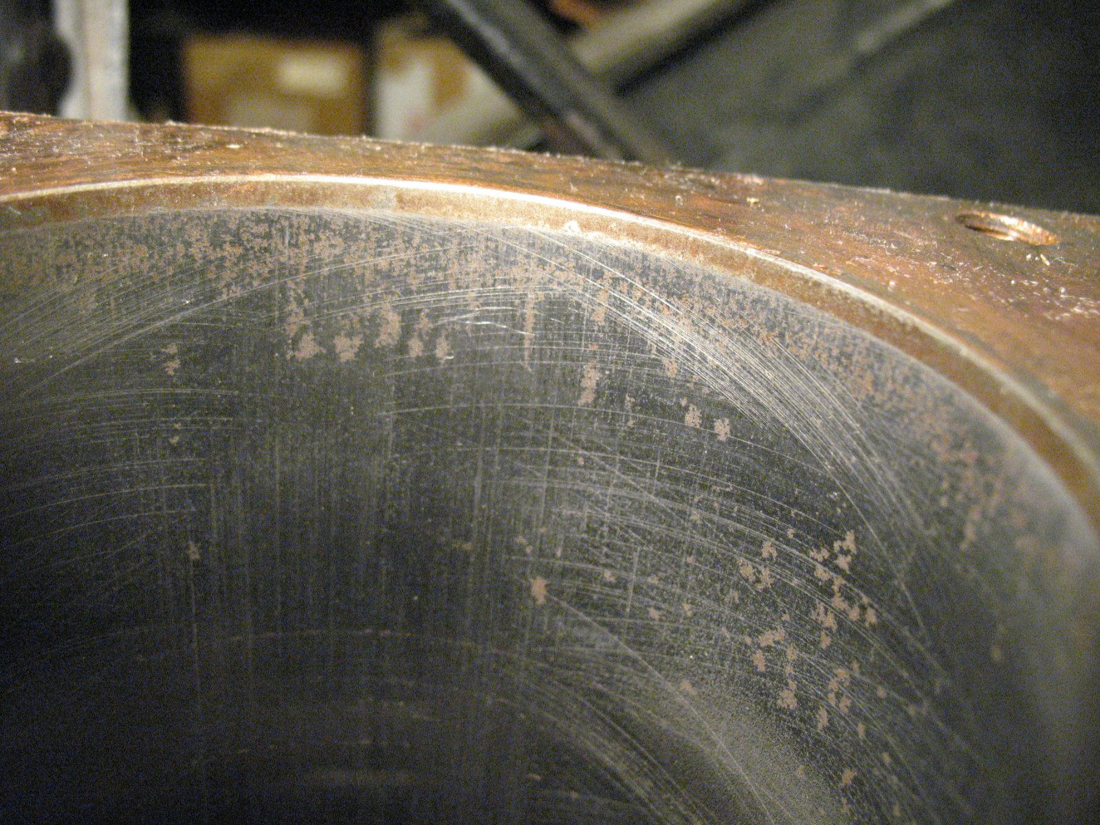

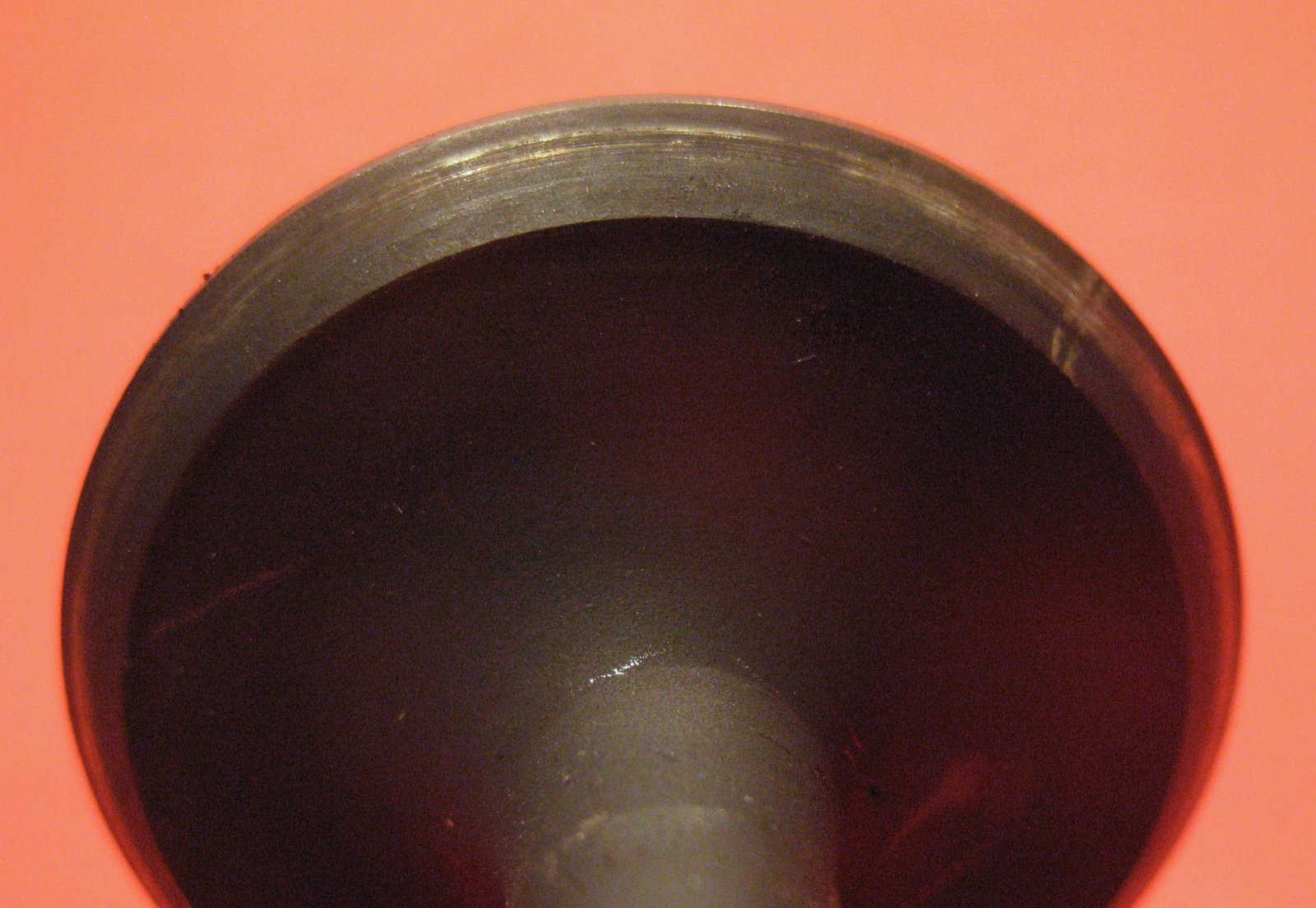

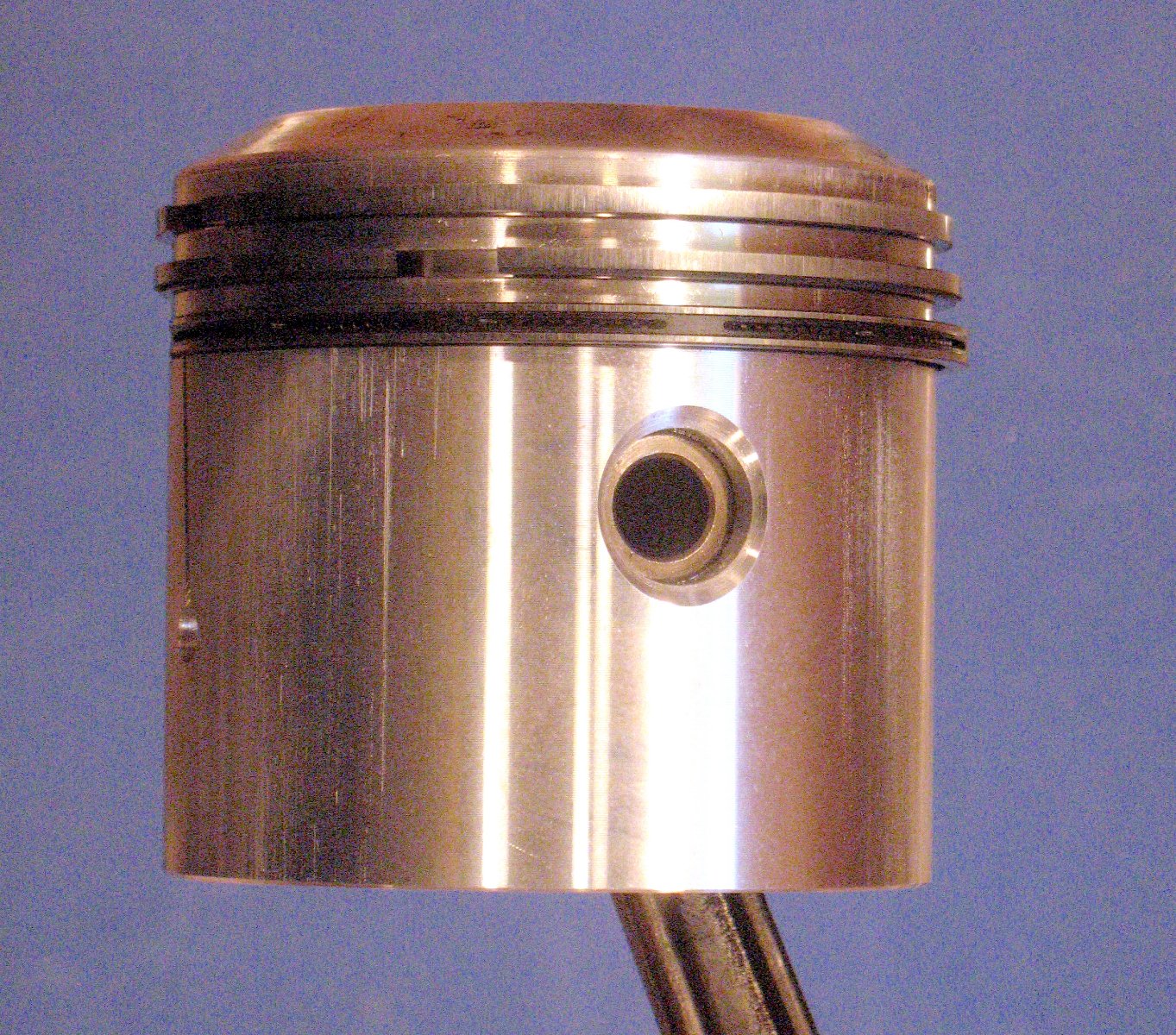

Post by Steve Jelf » Thu May 14, 2020 12:00 am

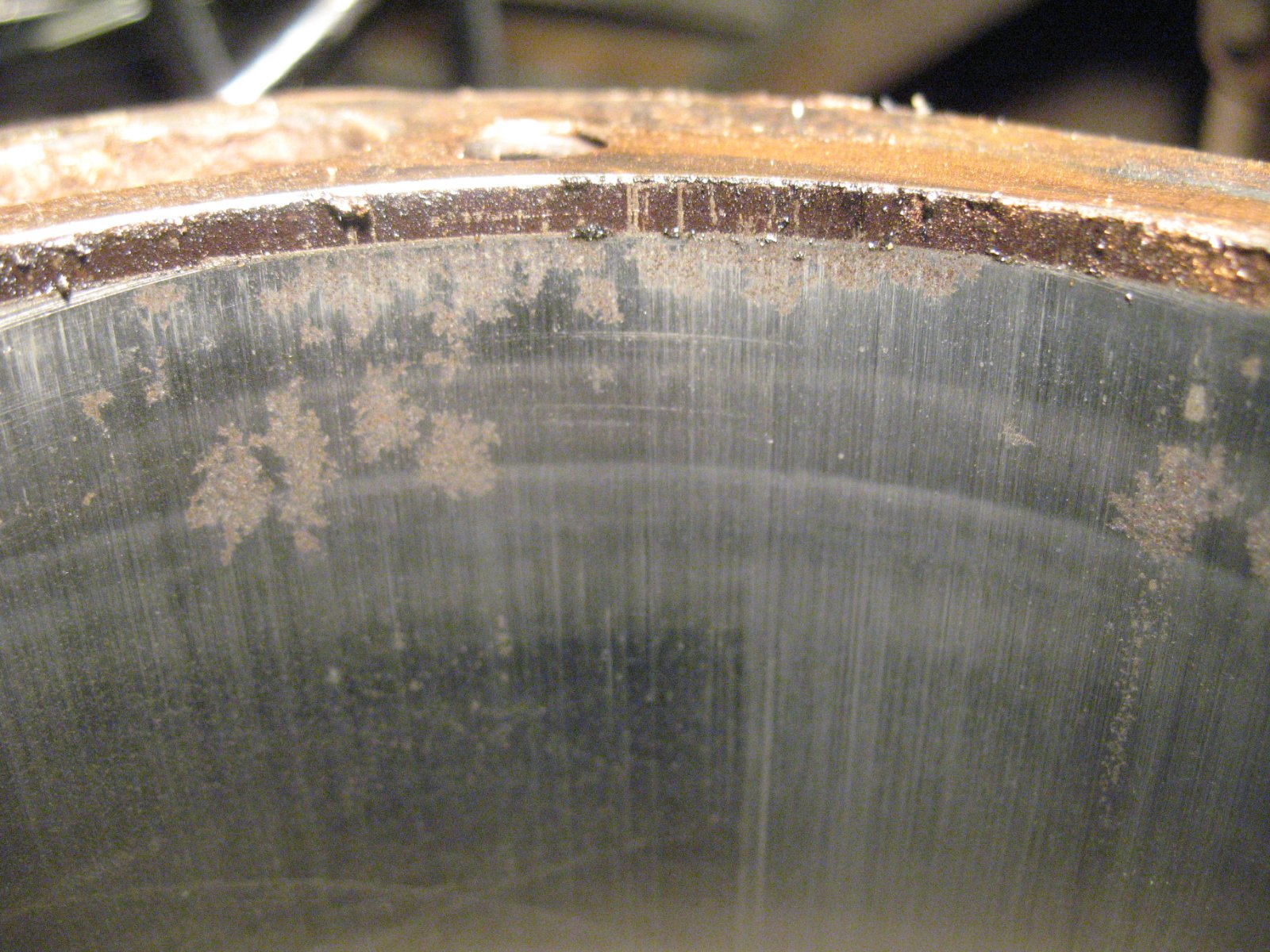

Today I finally pulled a piston to look at the rings.
After previous discussions I was expecting the rings to be fried and breaking apart, but I can't see a thing wrong with these.
What I did find wrong was what look like rust spots inside two of the cylinders. This is in #3. They aren't terribly deep, but I can feel them with a fingernail. I suppose they must contribute to the leakage, but they can't be the main problem. There are none of these in #1 and #2, and #2 had the worst compression of all.
These are in #4. I suppose they must have come from a leaking head gasket, but I didn't find any coolant in the oil.

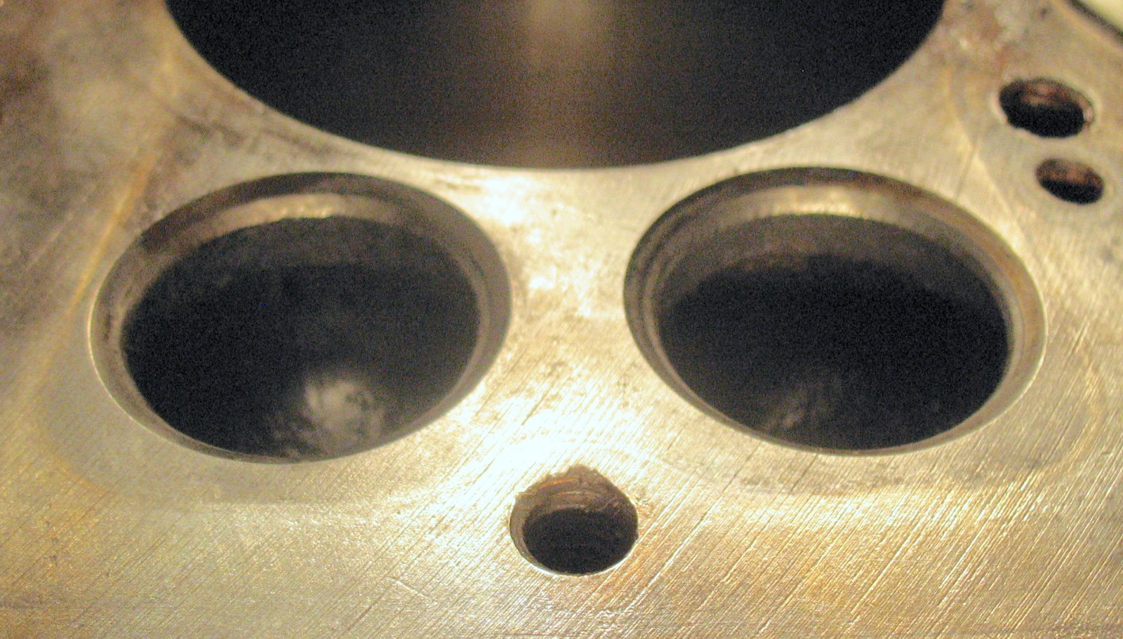

I think the main problem is valves.
Posts: 7401
Re: The frustration of incompetence
Post by Steve Jelf » Thu May 14, 2020 12:02 am
Kevin Pharis
Posts: 1647
First Name: Kevin
Last Name: Pharis
Location: Sacramento CA
Post by Kevin Pharis » Thu May 14, 2020 12:36 am
The gasket leaks that I have experienced leave drip trails from the leak point, and also leave a rust ring where the water sits on the top ring. These rust spots look more like condensation to me...?
The valve contact area on our valves looks really inconsistent, and we already know they were leaking... but you neglect to show pictures of the valve seats or discuss how the valve seats were cut/ground/lapped

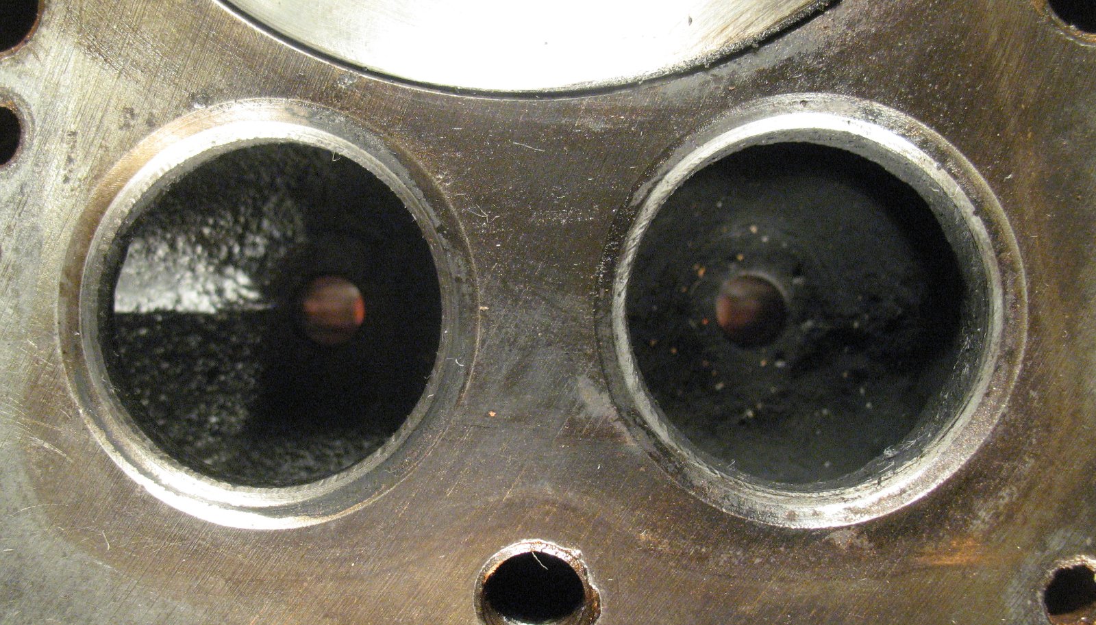

Steve, I don't think that pitting in the cylinders is causing any detectable issues. I do see some slight scoring o the piston skirt, but nothing worth worrying about. Are those cast iron, or chrome rings? Chrome rings can withstand higher heat ranges than cast iron rings.
Can you show us pictures of the valve seats? Did you ever check and see what the valve lash is? Also, check the clearance between the valve stems and valve guides.
AZTerry
Posts: 105
Joined: Wed Jan 16, 2019 11:18 pm
First Name: Terry
Last Name: Loftus
* REQUIRED* Type and Year of Model Ts owned: 26 Speedster
Location: Phoenix, AZ
Post by AZTerry » Thu May 14, 2020 1:44 am
Hello Steve,

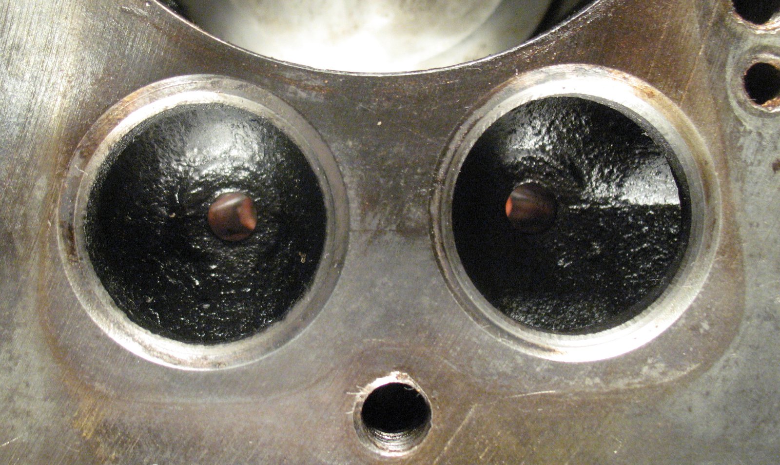

I will cut to the chase. With the vertical scoring completely around all three rings, the rings are trash. The vertical scoring on the piston and cylinder walls also leads me to believe the piston and possibly the rings started to seize in the cylinder. If you can feel the vertical scoring in the cylinders with your finger nail, the cylinder scoring is excessive. This appears to be your main problem to me.If I remember correctly you did state the engine was overheated at some time during your travels.
Now for the rust pits you can feel with your finger nail. Those types of rust pits can damage rings, although I do not feel it is the primary cause of the ring failure at this time. If it was my engine and I wanted it reliable I would be re boring it.

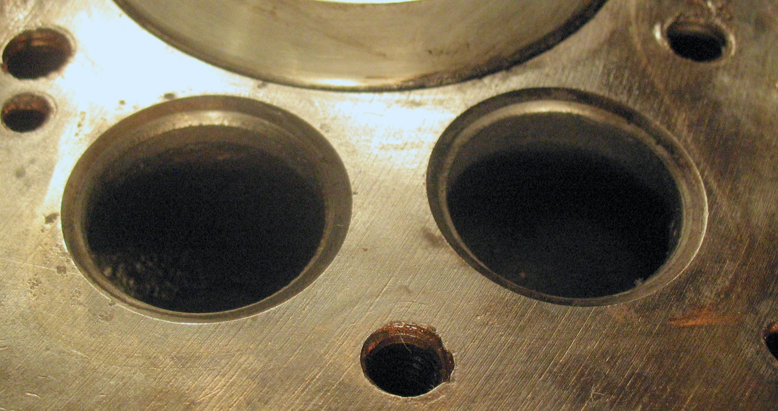

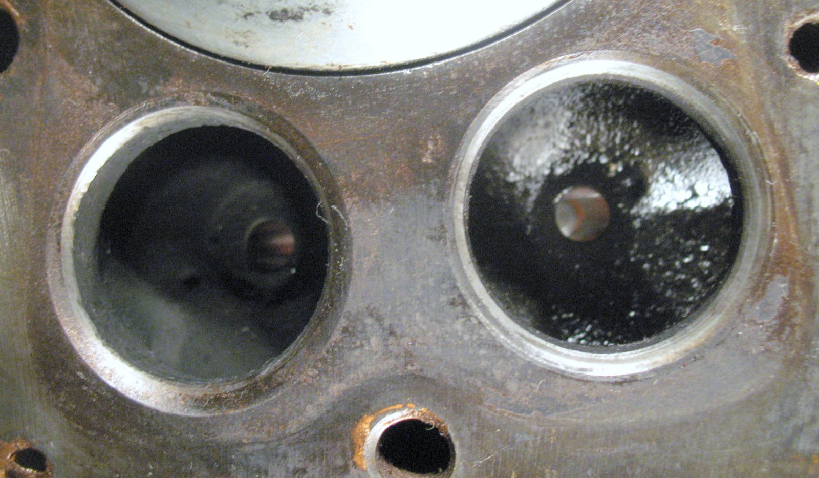

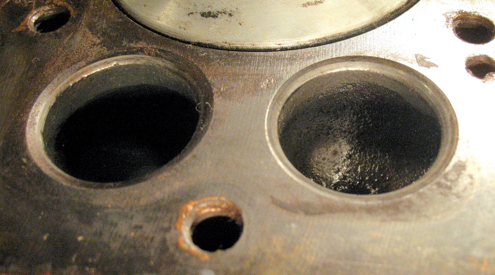

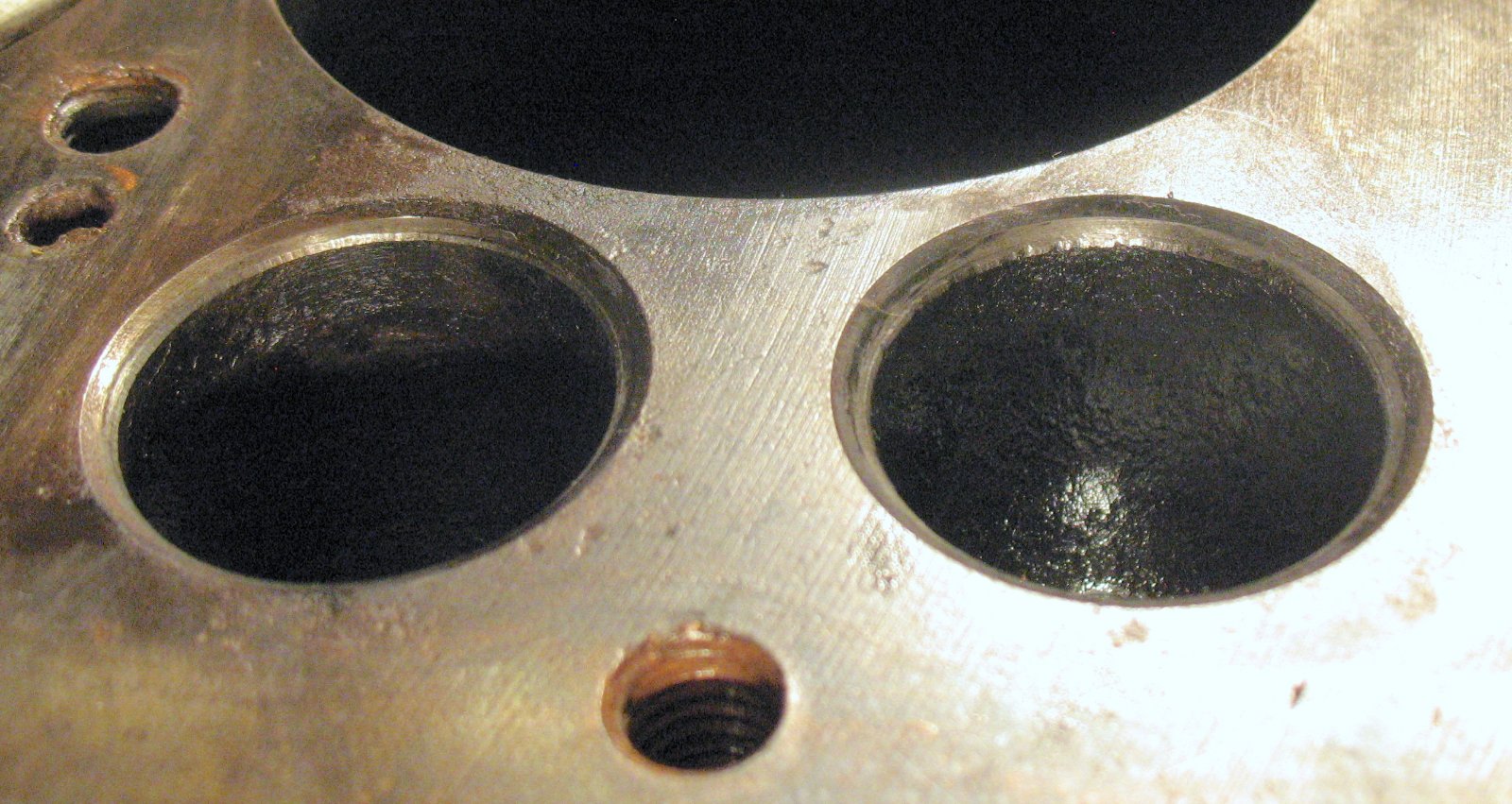

On the valves. It looks to me like they are basically seating about one third of the way down from the top of the valve face (the shiny area) which is correct. What I see wrong is the seat width is not wide enough and is inconsistent around the diameter. I believe this is a secondary problem that should be corrected as well.

Charlie B in N.J.
Posts: 783
First Name: CHARLIE
Last Name: BRANCA
Location: Brick N.J.
Board Member Since: 2010
Post by Charlie B in N.J. » Thu May 14, 2020 7:46 am
The compression would not have gone up with the addition of oil to the cylinders if the rings were good. It's not rocket science. It's n.g. rings. The valve seating is nothing to scream about either BUT re-read line one of this post.
Posts: 7401
Post by Steve Jelf » Thu May 14, 2020 11:42 am
OK, I don't know if the pictures are good enough to show anything, but here are the valve seats. There are two shots at each cylinder, one from straight above and one from the side.
#1:
#2:
Posts: 7401
Post by Steve Jelf » Thu May 14, 2020 11:43 am
#3:
#4:
A couple of questions before I go check some other things:
1 This engine is already bored .080" over. That's the safe limit isn't it?
2 Would a cylinder hone be an adequate alternative to reboring?
Posts: 6731
Post by Scott_Conger » Thu May 14, 2020 1:18 pm
Steve
you absolutely MUST change the rings. It isn't terribly expensive or difficult, but if you do not, Charlie will haunt you forever. It will of course not fix any of the air blowing past the valves, but at least he will be able to sleep at night.
I think you have a pretty good grasp on what needs to be done, including figuring out why so much moisture got into #4. That thing looks nasty and I wonder at this point if you don't have a crack in the head somwhere that bead blasting and dye penetrant testing might uncover. That's a lot of rust in the top of that cylinder to not have a blown head gasket obviously showing up
