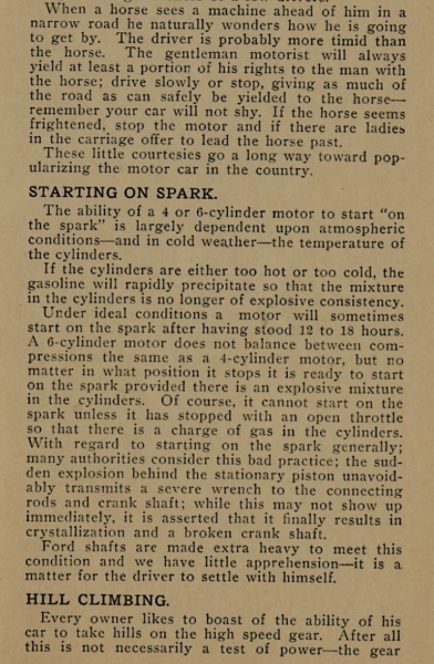

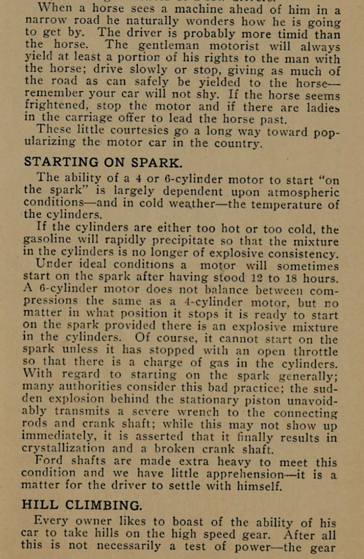

This was Ford's position on free starts, in 1907.
Also good advice when meeting a horse:

Rob, thank you much for posting that from the Model K manual.
So, according to Ford, a "start on the spark" (aka a "free start") can break a crankshaft, but then it's stated that "Ford shafts are extra heavy to meet this condition . . ." So they ain't worried ? and so it's up to you ?
Was this before vanadium steel ? Does that matter ?
(Still good advice regarding horses !

THANK YOU ROB! you guys can inject all your this and that's on this subject why then is the t the only one born with this problem. I just read ROS post, that says it all, don't it .i'm going to bed with a big SMILE.
