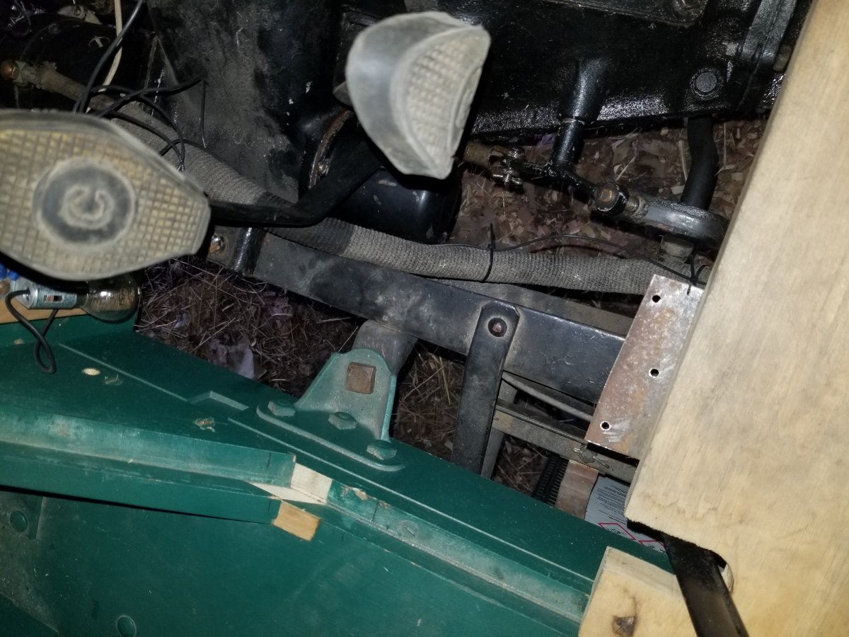

I like the looks of the C cabs and I'm looking for something easy to make. I've got 4 tabs on the frame that I think are mounting holes for the cab, but I'm not exactly sure how the cab and floor attach to them. I'm 6'3" so I'll probably extend the cab a bit to make it adult sized.

My cab and bed are both bolted to bearers that run the length of the chassis back from the firewall. These bearers are bolted to the rear cross from, the large 'lugs' just behind the petrol tank and to the lugs just behind the firewall. An extra angle bracket is used to fit to the front lugs (just like in Dallas' post below).
The cab and the deck are built on these bearers. Dallas' cab is separate I think? Both possibilities will work.

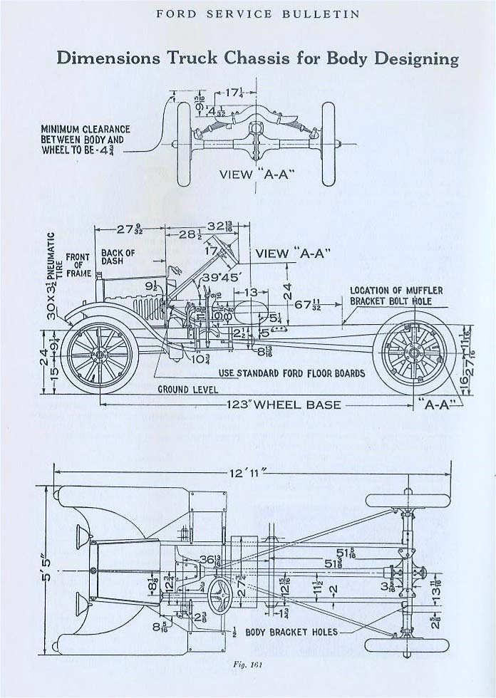

Here is that dimension picture - may be useful

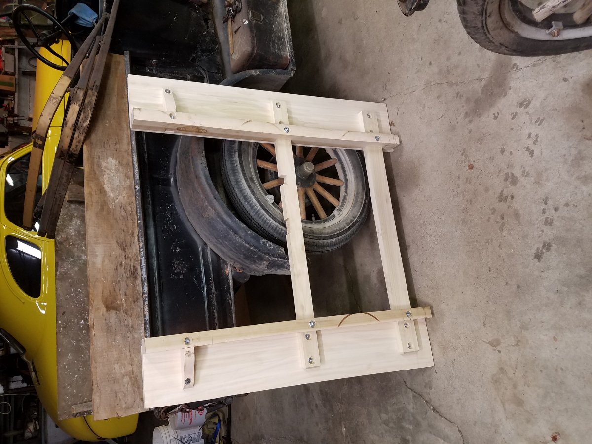

This is the main floor for my wood cab and brackets to attatch to frame tabs. Bracket bolt to the main wood runners on floor system.
Its hard to see in photos when all together. The most critical part of the floor build is the angle and placement of the front portion so peddles work as they should.
