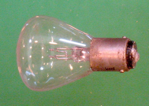

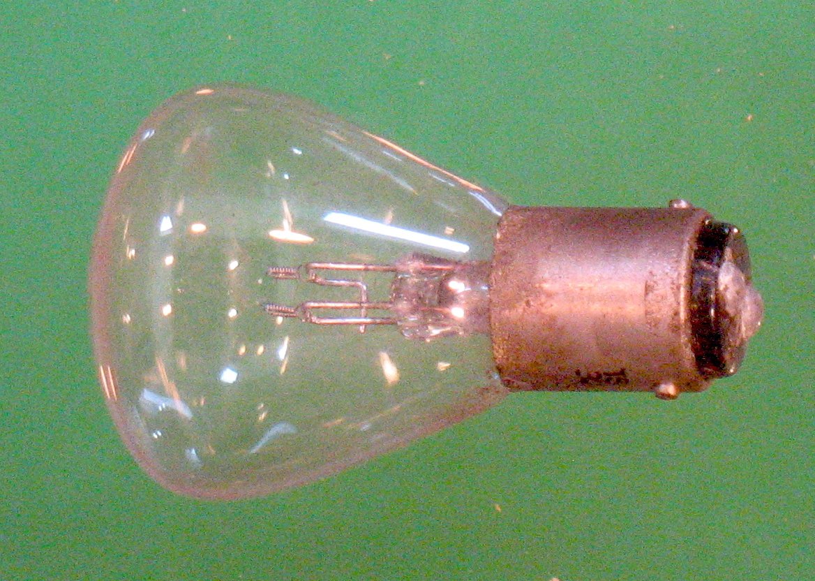

You have the wrong bulb. The correct magneto headlight bulb will only have continuity across the two contacts on the base.

Even pins, two contacts. These are pretty common at swap meets. They're not specifically for mag lights, but they work. Despite being marked 6-8V they last pretty well for me. A problem with bulbs a hundred years old is that sometimes when you put them into the socket and try to twist them into position the glass turns and the base doesn't and the bulb is wrecked. I put glue around the seam to prevent that, but I haven't found out yet if it works.

I suspect that you either have the wrong bulb or a bad socket. A standard 6V or 12V bulb grounds the filaments through the base. A magneto bulb is not grounded through the base, the filament is connected to the two contacts only. Old sockets often have had the little springs between the thimble contacts and the bulb contacts overheated and may have lost their "spring" and may be touching the side of the socket and grounding.
