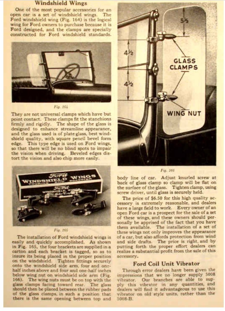

Post by DanTreace » Tue Mar 17, 2020 8:58 am
While no glass dimensions are given in the Service Bulletin, you might get close to extrapolate them from the sketch and measures of the clamp placements.

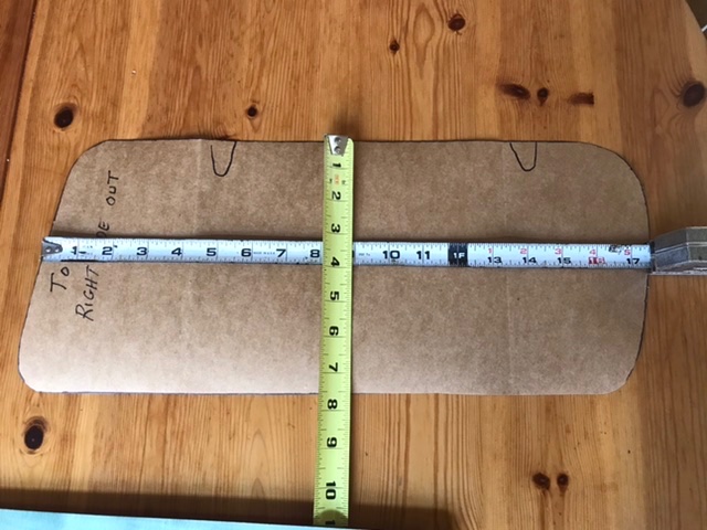

Russ T Fender
Posts: 471
First Name: Val
Last Name: Soupios
Location: Jupiter Florida
Re: Wind wings
Post by Russ T Fender » Tue Mar 24, 2020 10:48 am
Steve, here is the template I received. I don't have access to my car right now so I can't hold it in place to see how it looks but it seems to be very close to the glass pictured in the Ford brochure posted earlier in this thread. The bottom of the glass is somewhat rounded on the template but I would probably make it parallel with the top. Hope this helps.
Russ T Fender
Posts: 471
First Name: Val
Last Name: Soupios
Re: Wind wings
Post by Russ T Fender » Tue Mar 24, 2020 10:58 am
Let me try that again!

Re: Wind wings

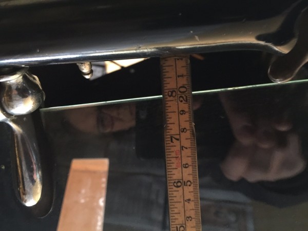

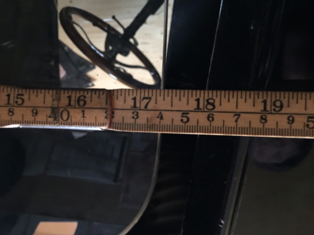

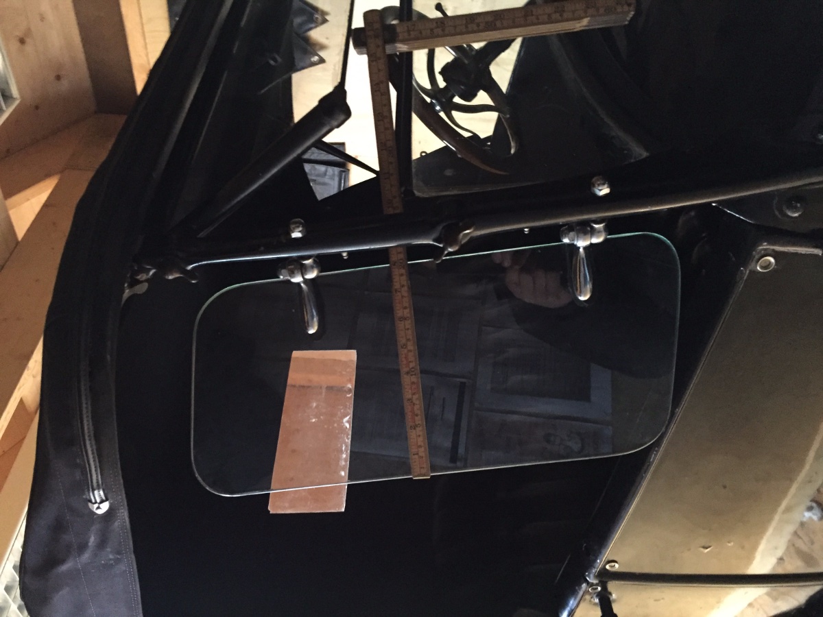

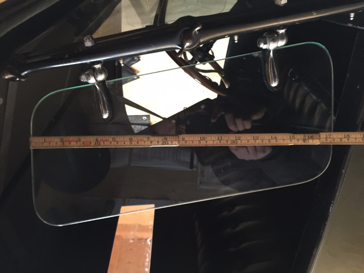

Post by Roffe » Tue Mar 24, 2020 12:24 pm
Hi. Took some pictures of my 26 roadster. Seems the sides are parallel sideways and up-down. 200mm X 440mm.
