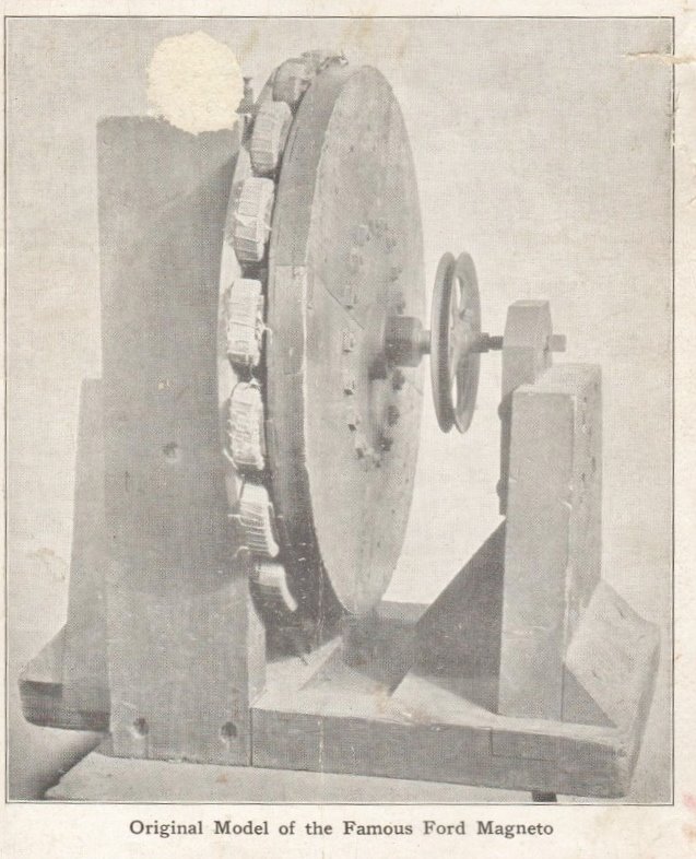

Thanks for re-posting that thread, remember reading it and the novel approach for those magnets!
Reminded me of Ford's and Huff's original for patent application....the magnets used weren't the famous horseshoe, but simple flat plates of magnetized iron embedded in the wood disc. :P
