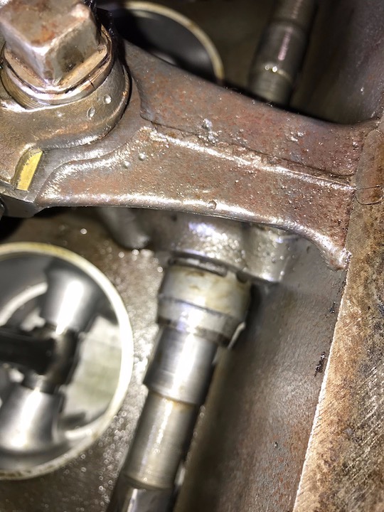

OK I ran into a bit of a problem with getting the CAM Shaft out. I took out the two bolts that hold in the bearing and I started to slide it out and it stopped moving on the center bearing. I tapped the CAM on the back with a big punch. It started to move and looked as if it was not together. I know they are held in with a clip. So I used a thin punch and tapped on the bearing and was able to get the bearing back into a circle. I then tried to tap it again and it won't move. The front bearing moves with the CAM no issue. Am I missing something.
You can see the bearing coming out.
This is the other side.

Ouch!
Another bad engine rebuild, rods around the wrong way and no oil holes in the pistons for the wrist pins :(

Cam Shaft cover was off, valves are out and lifters are out of the way. Kerry you are correct. This motor and trans was bad at almost every turn. J&M Machine did an outstanding job on the transmission. I know the risk I'm taking with the pistons and some other parts. Just wanted to make sure I wasn't going to hurt anything. The Cam shaft seems to slide in the center bearing so the cam lobe hits the side of it.
