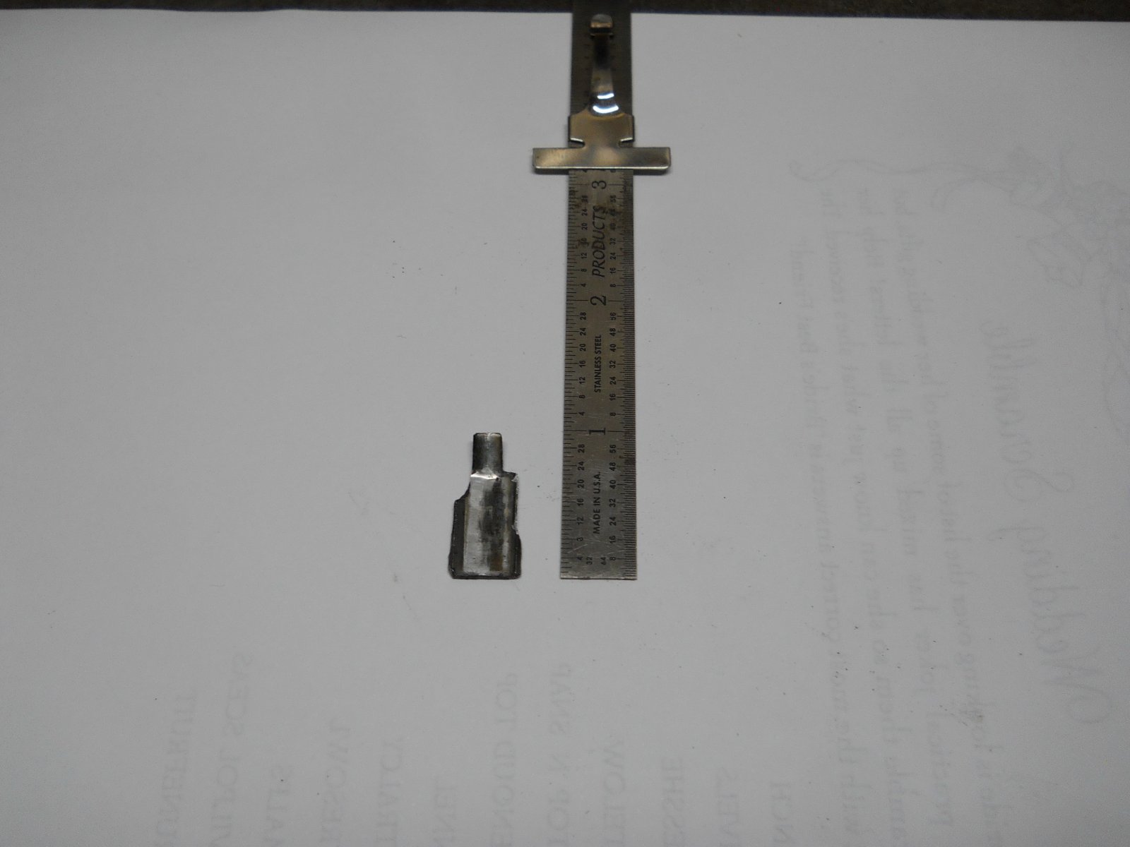

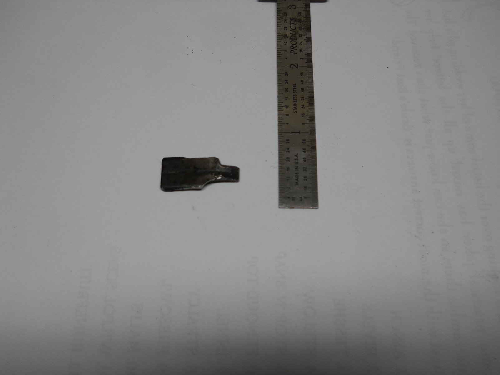

I found this in my oli screen...scary...any thoughts? thanks rl

My best guess is that it is a clip that goes inside the brake drum that the clutch discs ride on. If that is what it is there are more pieces missing. This part would only be in late 25 to 27 transmissions.

Think I will take that back. There doesn't appear to be a detent to ( lock ) it in place.

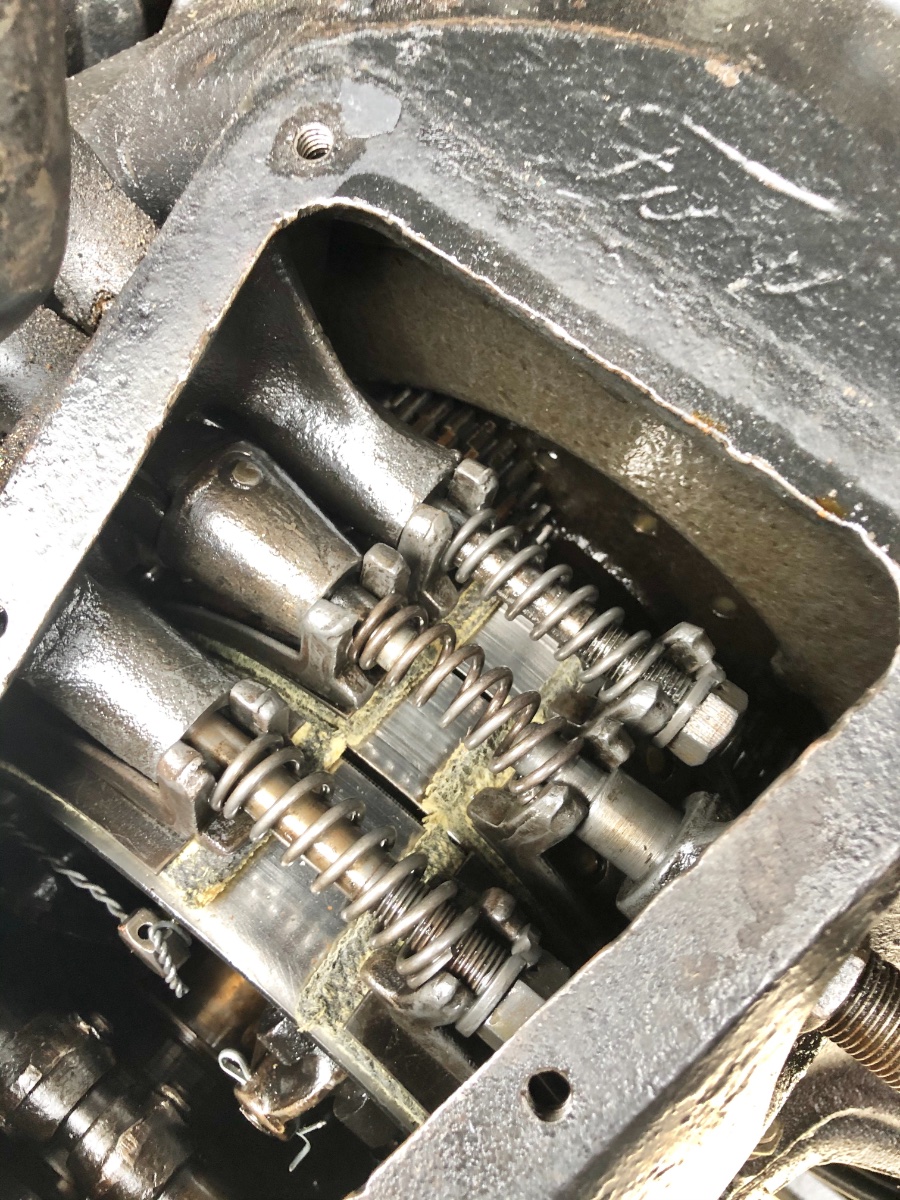

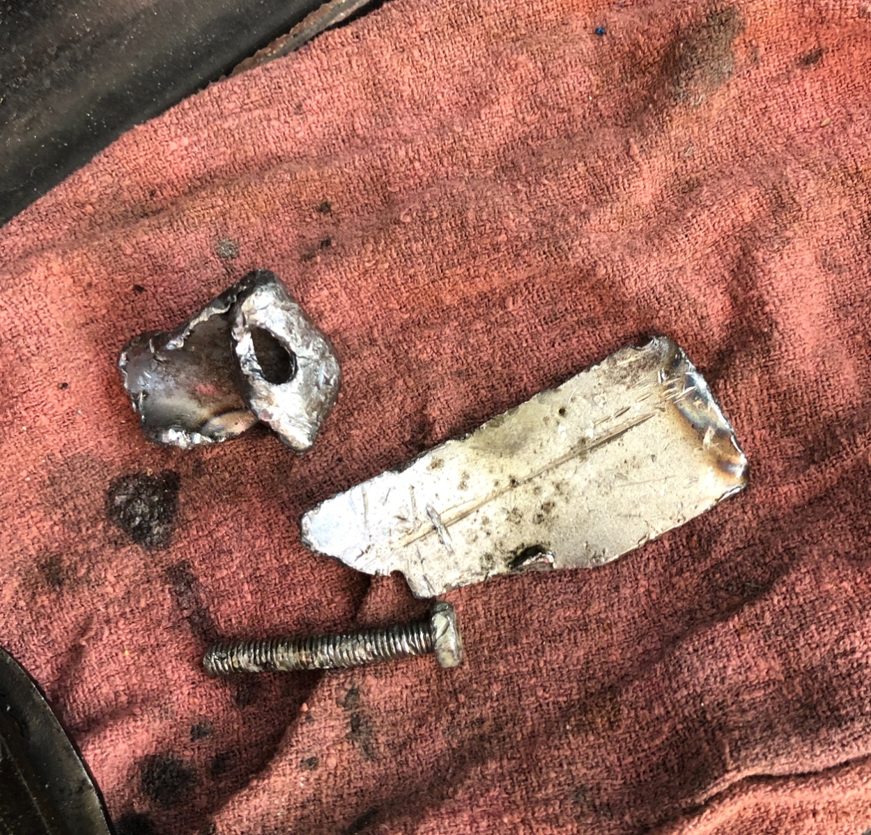

Just talked to a T guy in town, his made a racket from the trans, shut down. Flatbed the T to the auto shop where his son works. Opened the cover over hogshead. They pulled a piece today that was flat with hole on end, and his T has distubator and no magneto innards.
Seems from phone discussion it may be a wayward home made flapper from the flywheel, as he saw three on it and space where another should be. Going to see it on Wed. and get the details.
Update:
Just got back from looking over Fred's '26 runabout, and the piece of metals found that were causing the noise in low pedal. Sure enough.
The parts are from a 'slinger ' added when the magneto was removed. Shop guy Craig found 3 more on the flywheel edge, he tried to move them but they are still snug, so plan is to button up the cover and get by as the others will likely stay in place with luck. If one more comes loose, then pull engine time.
Update:

With the magnets removed from the flywheel, it is common to add flappers to churn the oil. Contrary to what many people think, the flappers are not needed, especially if there is a starter ring gear installed. Also, the flappers are prone to breakage if not built strong enough. I have seen that happen.
I have run our car for many years without flappers. A while back, on one leg of a tour we drove between 40 and 45 MPH for 140 miles. It was a busy 2 lane road with lots of semi trucks, and we were trying to not impede the traffic. While the car made it just fine, the four occupants of the car wished they had chosen something different to do for that day.

THAT HUNK OF STEEL LOOKS VERY MUCH LIKE THE TIP OF A BAND, THEY DID MAKE THREE TYPES THAT I KNOW OF BUTTON---SLOT---AND I DON'T KNOW THE NAME OF THE THIRD, BUT THE END OF THE BAND LINK HAD A TAB THAT FIT INTO A HOLE , I WOULD LOOK AT YOUR BANDS. HOPE THIS IS HELPFUL.

Whatever it is, it looks as if it's been through the gears, hence noisy low gear??
Can you post a better, larger picture? One that fills the whole frame? I know we can click on it and zoom, but still it's hard to decipher what we're seeing.
- Posts: 4638
Re: where did this come from???
The shinier side of the piece looks like it has a curvature to it going by the pic. That makes me think of a piece of one of the drums. Maybe take the transmission inspection cover off and have someone slowly turn the engine over to what may be broken? That’s what I would do.
- Posts: 4408
How thick is it? Is it steel, or cast iron?

ok. so per Dan its a slinger. Is it not going to be thrown out of balance without removing the others?

Well I found out what is was a part of...transmission brake drum shoe...which let the steel clutches get bound up also..and took out two teeth on one triple gear a 0ne tooth one another...it's been a fun day...that's why they call it a hobby....Happy motoring rl

So, what is Dan's posting above all about? That's not your car he's referring to? I give up...halftracknut wrote: ↑Wed Apr 15, 2020 4:37 pmWell I found out what is was a part of...transmission brake drum shoe...which let the steel clutches get bound up also..and took out two teeth on one triple gear a 0ne tooth one another...it's been a fun day...that's why they call it a hobby....Happy motoring rl
- Posts: 6730
Kudos to Steve M for diagnosing it right away. Steve, I'll bet you can see the detent now, knowing that you were right...right?

Guess perhaps I treaded on Randy's original post. I had made observation in my reply post that maybe the metal piece was a chunk out of Randy's (low) drum . Seems it was from a drum, but as Randy posted, a shoe from his brake drum.
Sorry for the mention of what other metal can get loose in the tranny. Just happened the same day of the post a buddy had called me about a similar noise too.
Just adding to our T fun ....that's what my posting was all about.

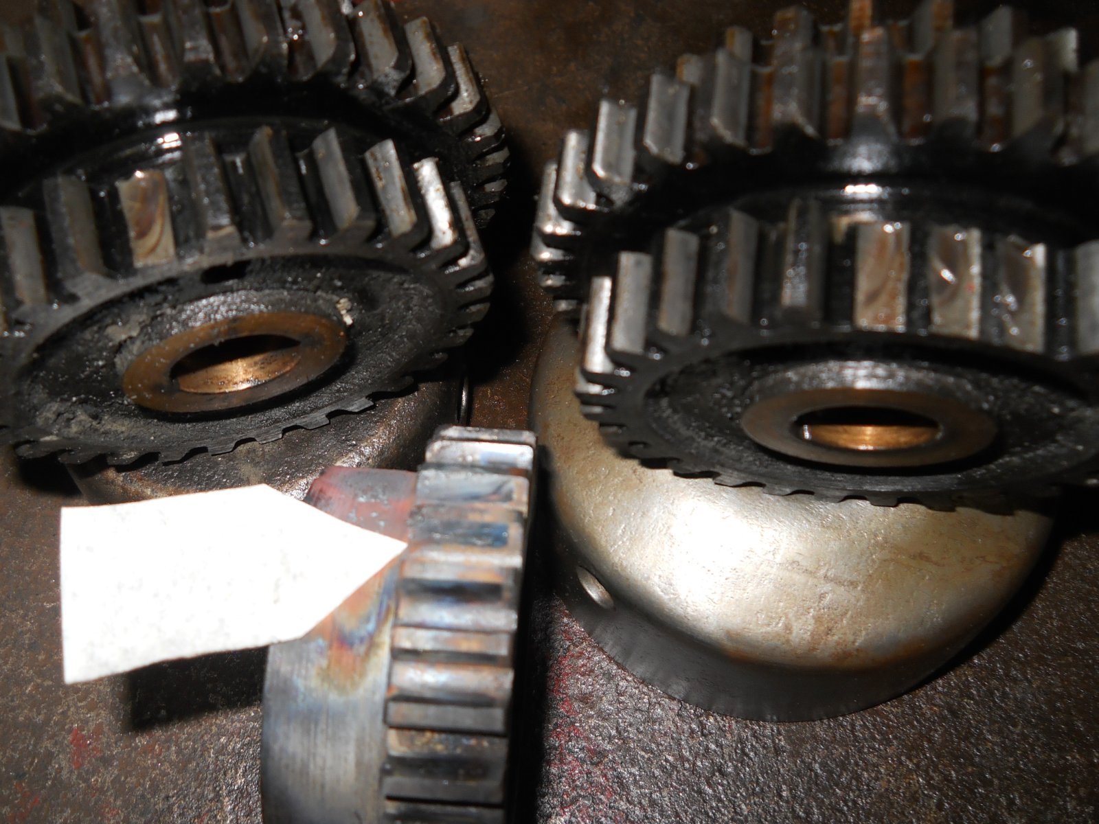

thought you might get a kick out of photo...
...As Sergent Preston would say "well king this case is closed"......rl
