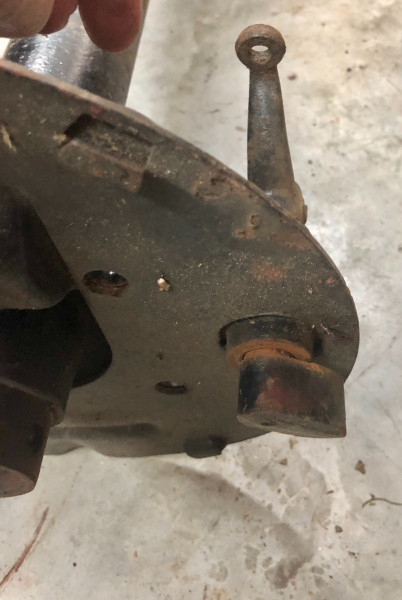

It has been 2 years getting my 24 Roadster ready for the road. I left the emergency brake for one of the last items in order to move it around the shop easier. I mounted the wheels over the new brake linings and ran into a problem. In order for the cam to line up, the brake lever had to be pushed all the way forward (second gear). Now, obviously, as I pull back on the lever the brake engages before handle is straight up. What do I try next?

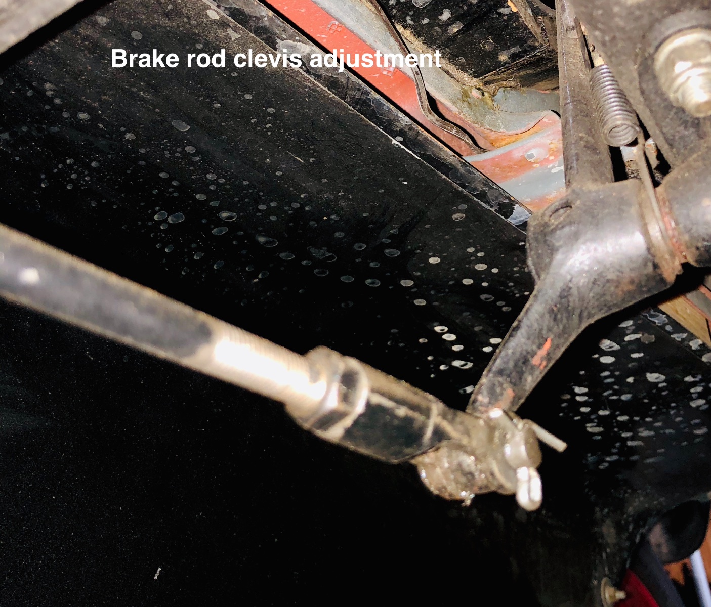

Adjust the clevis

Are the brake rods original to the car (ie. for the right year)? I found it easiest to adjust the emergency brake with both rear wheels lifted off the floor.

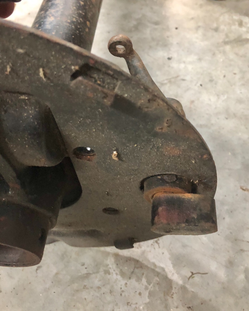

Re: Emergency Brake Issue
The shop in which my T resides is 100 miles from me. I can only work on it on weekends. Myself and a mechanic looked at the linkage system today and found no way to adjust. They are adjustable at the front of the brake rods via the threaded portion. They are extended fully and will not lengthen any more. Maybe they are the wrong rods. They are 52" long. Anyone have a measurement on the "24 brake rods?

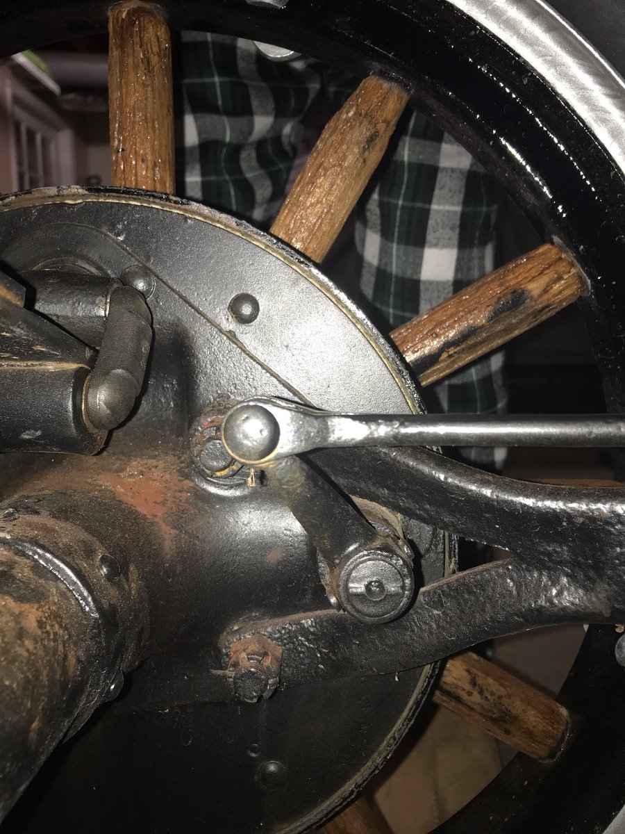

I attached this photo. If you zoom in you can see the cam is parallel to the ground and the handle is in the maximum forward position. Based on everything else I've read, when the cam is parallel to the ground, the handle should be approximately perpendicular to the ground.
[image][/image]
[image][/image]
- Posts: 7257
Lee, you need the shorter of the two types of T brake rods for your 26-7 rear axle. If they are still too short, they have been modified. Other cars have some clevises with longer arms, and these may help. Check Snyder's A model catalog for these.
When adjusting them, I like to adjust them with the handbrake right forward, as it is when driving down the road. That way you have no drag when in gear. With the handle forward, push the levers on the cams back as far as you can by hand and then adjust the rods to suit that length.
As the lever is brought forward into the neutral position, the cams will come into level, giving you the best chance of a free neutral.
Further pull back on the lever will then engage the brakes.
If your cams, brake shoes and drums are worn, this may not be necessary, as there will be enough slop in the system to allow the brakes to be free when in gear, and still have a good free neutral.
Hope I have explained this well.

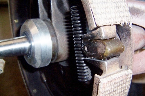

- Posts: 4081
Lee
When you do get back to your chassis, be sure to recheck the position of the emergency brake shoe lever on the backing plate. The lever should be in be in the 'up position', and rearward prior to assembly of the brake shoe, as it can be flopped down in the wrong position.
As others mentioned, you may have to cut and rethread the rods, if they won't fit correct with the backing plate lever and the handbrake lever in the right position.

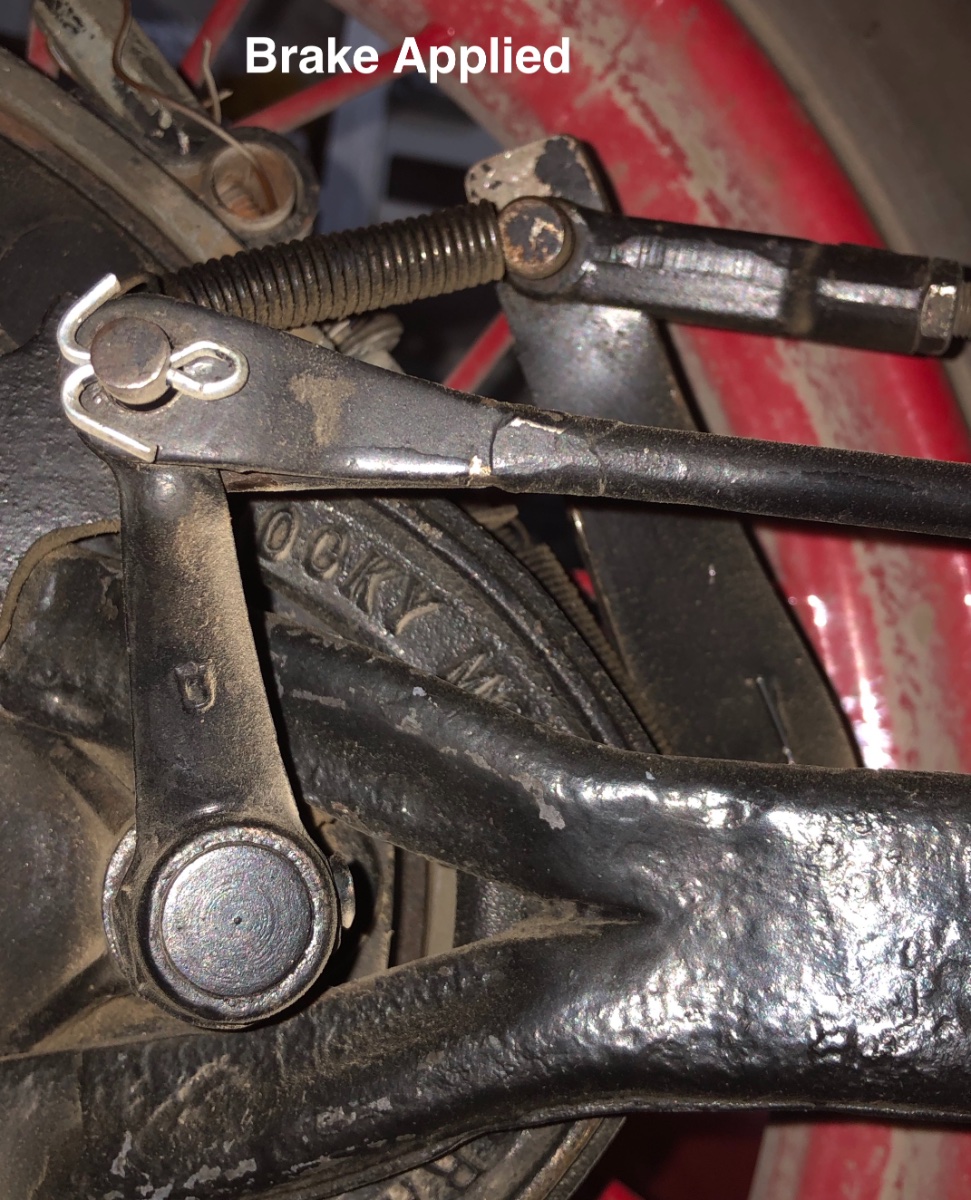

These photos may be of help to you.
- Posts: 6785
Lee
your length question was answered 1 post before you asked it.
A close picture of the backside of the brake plate would be useful for those responding, and of course, Dan's description of the brake cam levers being "up" and tilted toward the rear of the car when the cams are parallel to the ground. Ideally, when the brake handle is straight "up", the cam levers that the brake rod attaches to, should be pretty well straight "up", too.
Since the rods appear to be or are at least acting like they're short, as fitted presently (correctly or incorrectly as we cannot tell yet), you can figure that cutting them off and rethreading them will probably not result in them being longer when you are done.
- Posts: 4454
Another issue might be that the brake cams are swapped over from right side to left side.

- Posts: 4081
Lee
Something is amiss. Could be your cams are riveted to the lever shafts wrong, if you restored with new.
These levers and cams are Left and Right, have to be that way.
Here is the right housing, with cam lever rearward. Relaxed brake shoe.
Now the brake is applied, pulling the cam lever about vertical. Brake shoe expand and locking hub drum.
Relaxed, emergency brake shoe closed, no expansion of the shoe.

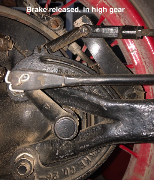

Here is a photo of the Cam Lever position when the brake shoes are fully relaxed. The Brake handle is fully forward/2nd gear.
[image][/image]
[image][/image]
- Posts: 6785
that is quite different than
Later you asked if the drums should rub when the brake is "off".
You have finally provided the information and photos to make a judgement call: You do not have a brake rod problem.
If you will go back to one of my earlier posts mentioning
That was way more difficult than it needed to be...
. Yeah, they're upright (and backward facing as well as several people have mentioned is correct).With the Brake Cam Levers upright, the cam itself is parallel to the ground
You have a slightly oversize lining on your brake band. Fix that and everything will work.So long as the car is held in neutral by the cam on the brake lever and you have somewhat of a neutral even if the lever is forward of vertical, that's fine.
