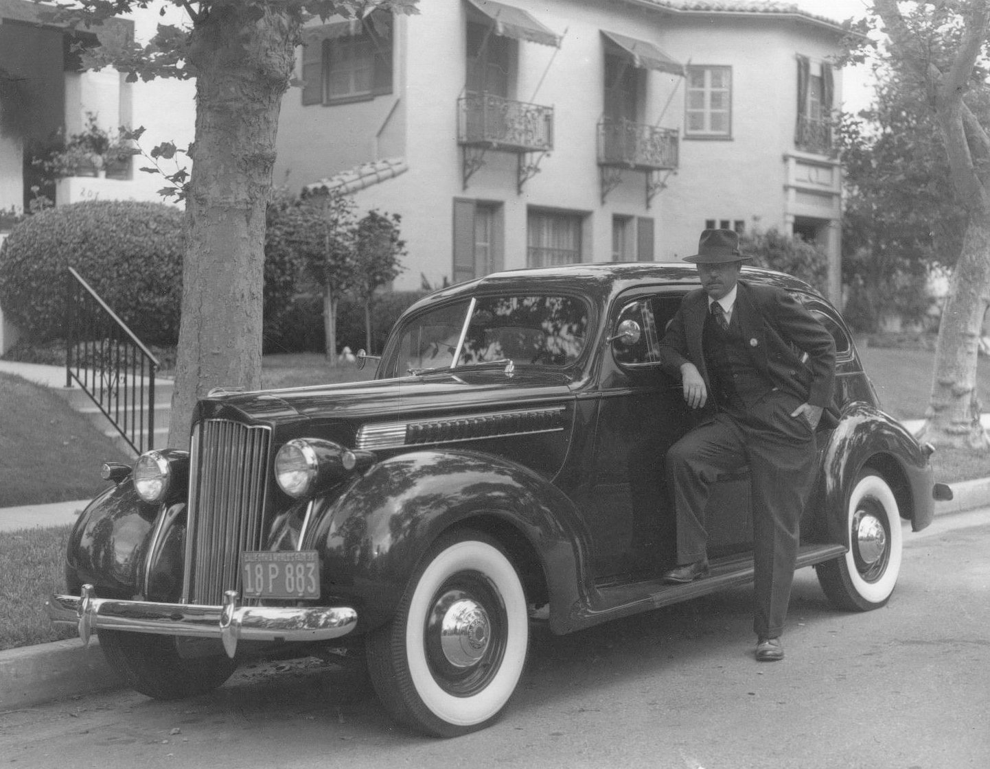

- Posts: 7401
Re: shutters
My shutters are open because I've been driving. As the car sits and cools a diaphragm in the radiator will move the linkage to close them.
