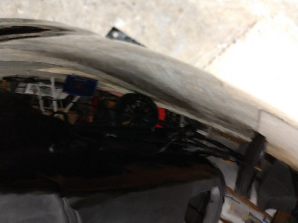

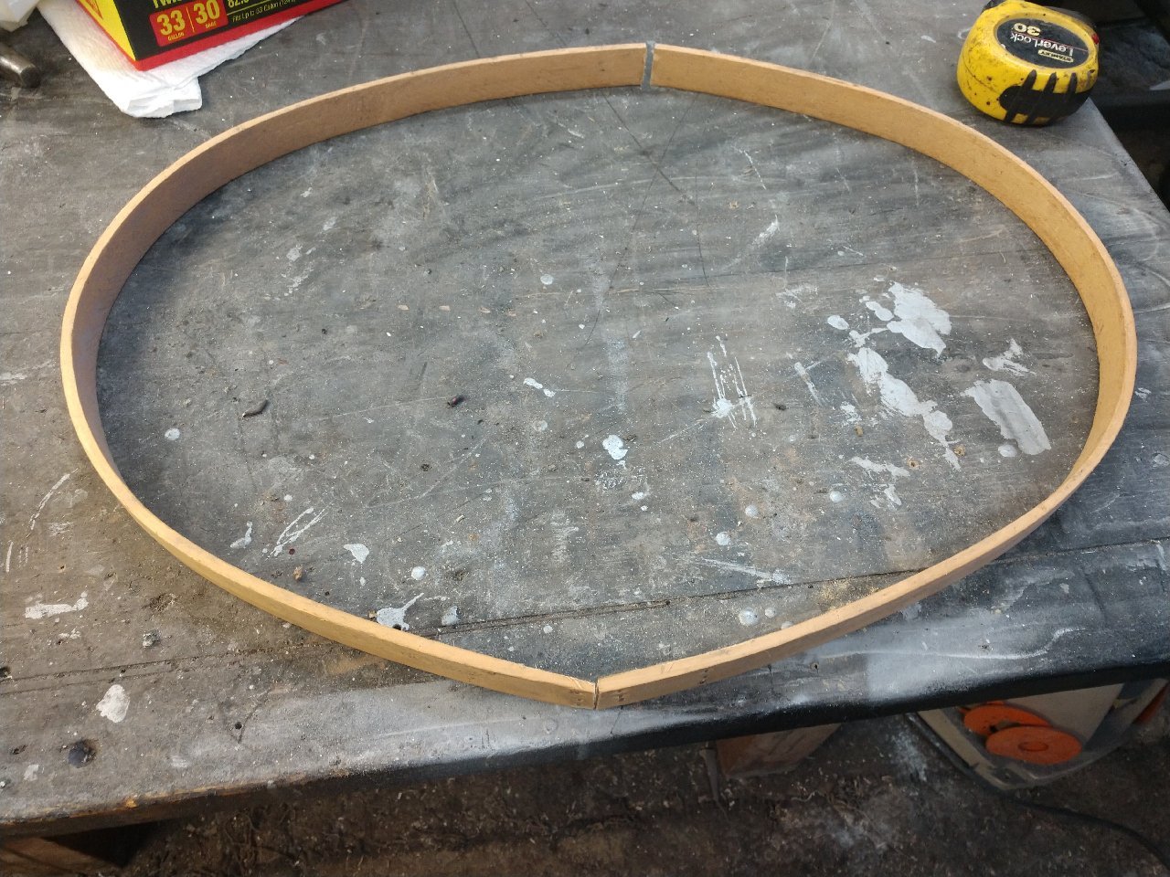

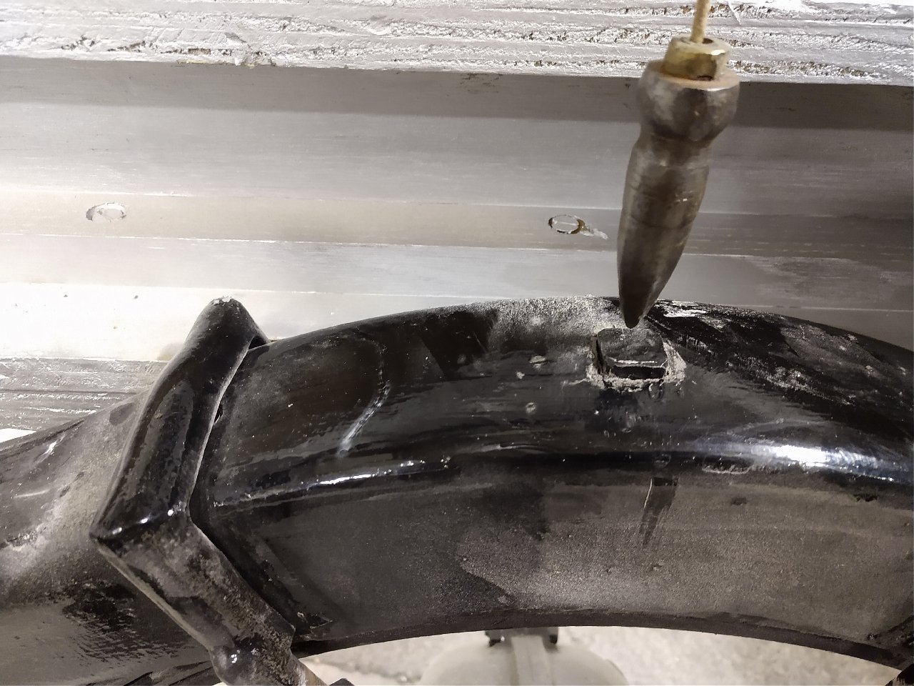

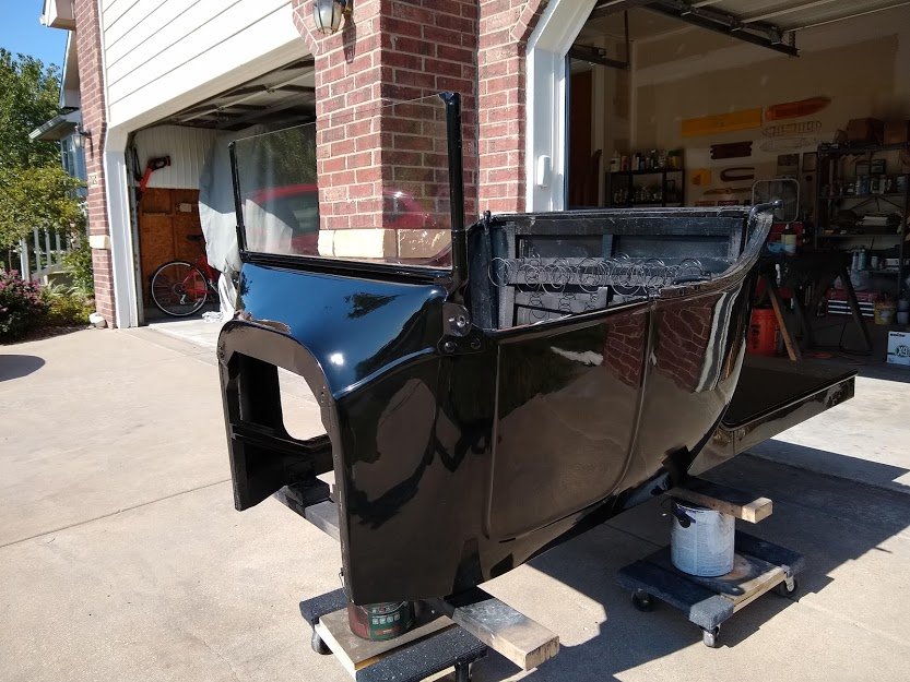

Post by Allan » Sat Apr 11, 2020 10:49 pm

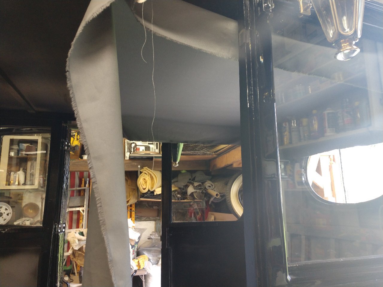

Don, I believe the bolts should be 5/16" coach bolts, with the nuts under the hood former. Here in Australia, coach bolts come with Whitworth nuts. On 5/16" bolts these nuts are bigger than those Henry used. If I make a special order for 5/16" UNC nuts, then I get the correct size, which is 1/2".
I love the way your hood fits.
Hope this helps. Allan from down under.

Re: '16 Centerdoor restore...
Post by FordorGalore » Sun Apr 12, 2020 9:28 am
Sounds right to me Allen, thank you !! Happy Easter to you and yours. :)
Post by FordorGalore » Sun Apr 12, 2020 9:29 am
It's centered and plumbed Bob !! Ya happy now ? :D :D :D

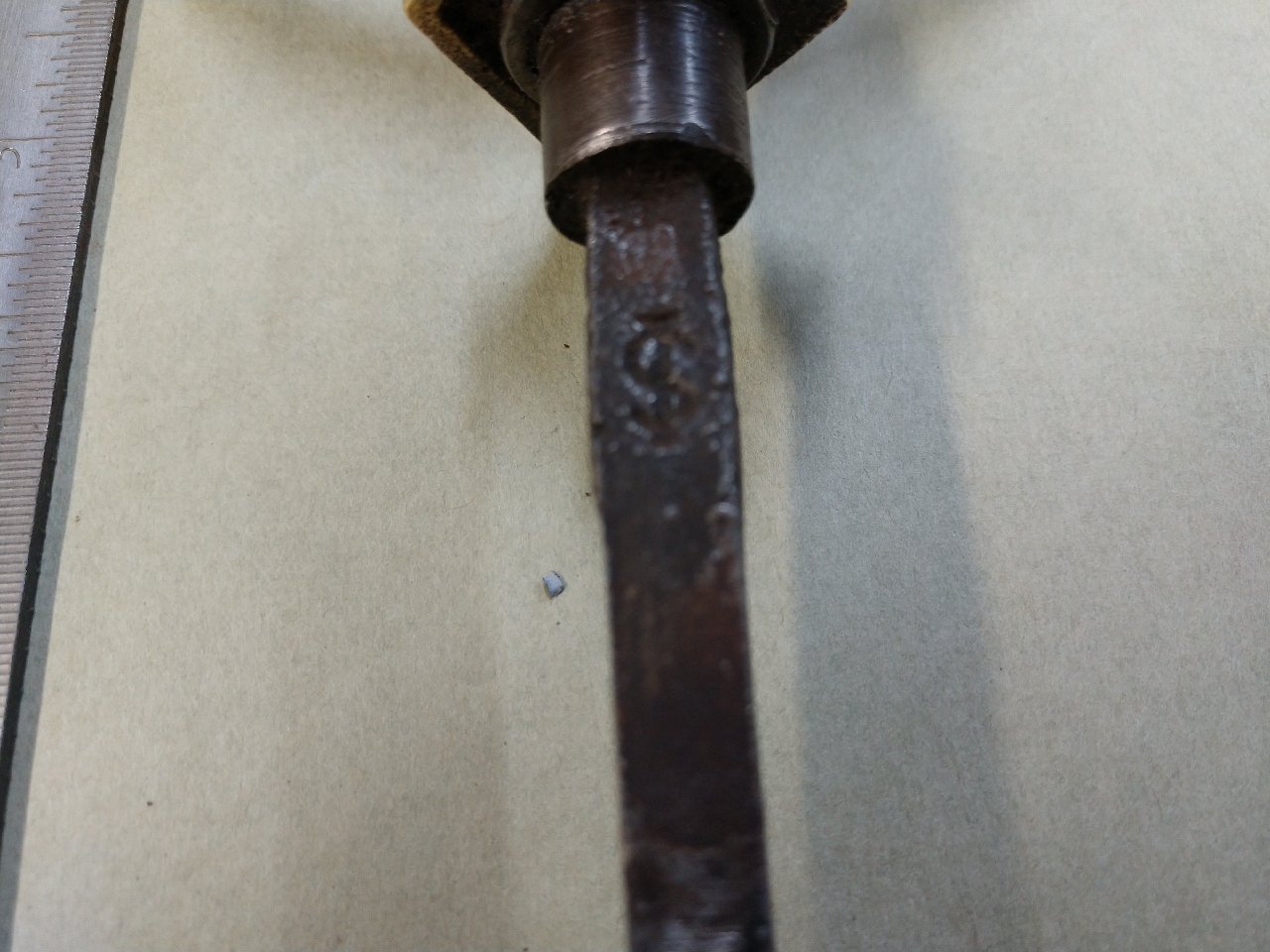

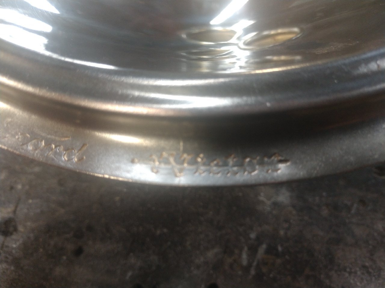

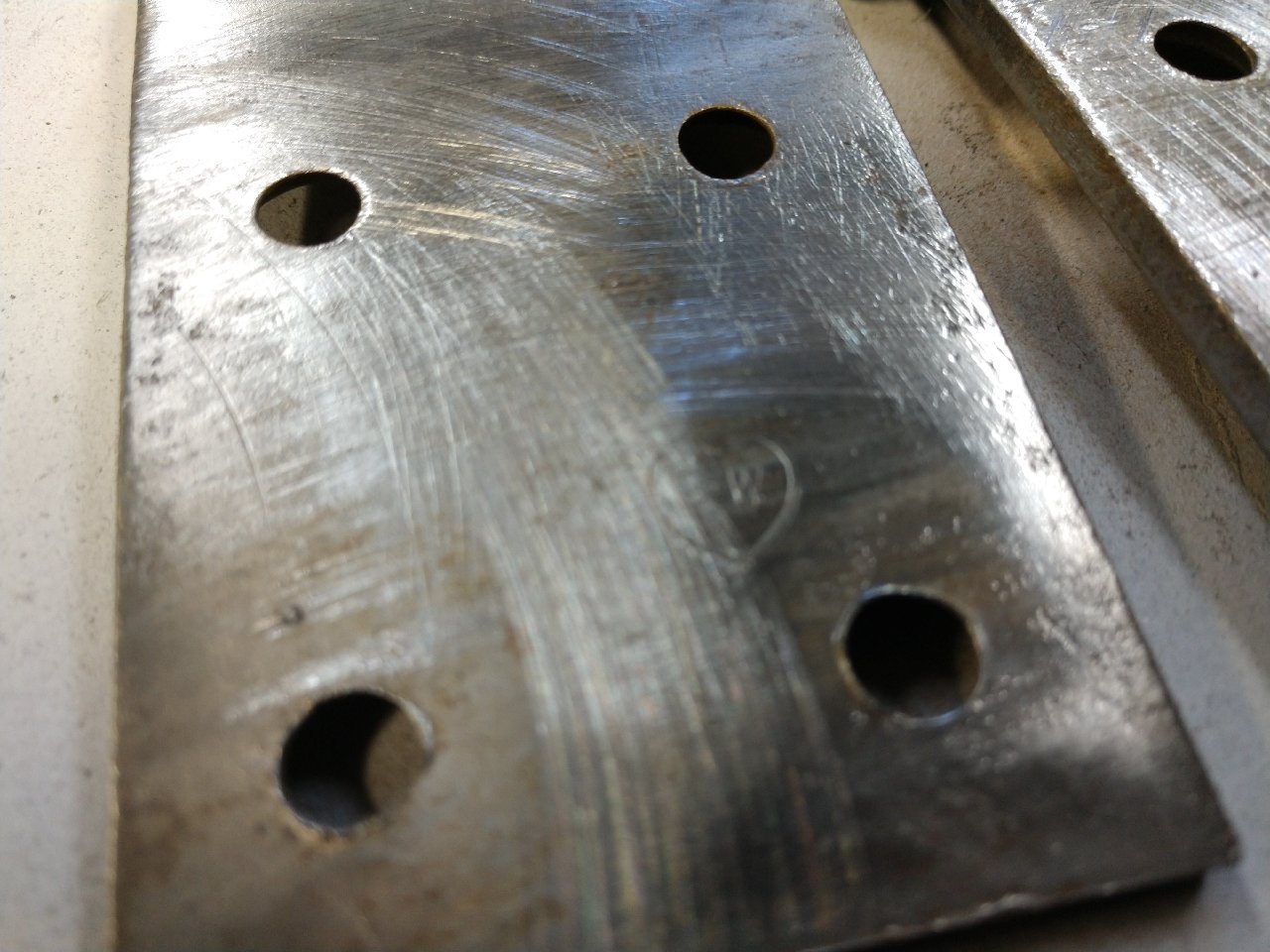

Post by FordorGalore » Tue Apr 14, 2020 11:50 am

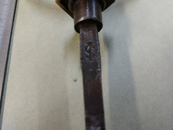

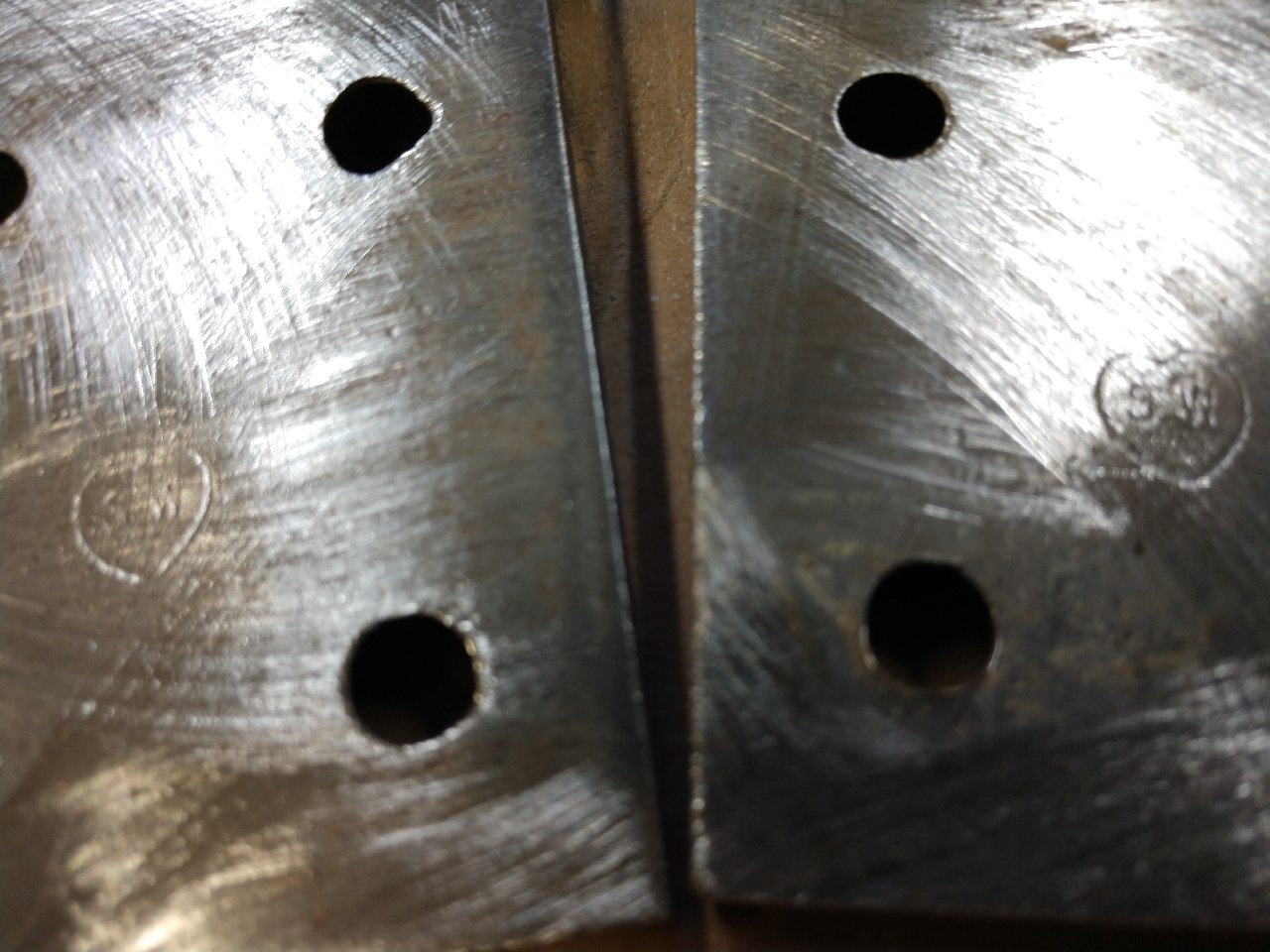

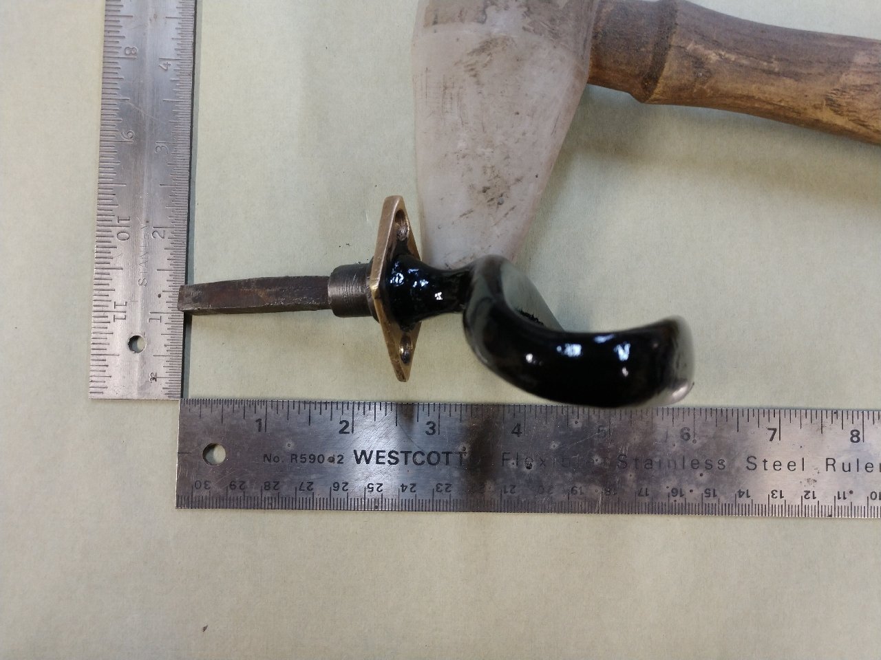

So I'm cleaning up the door hinges on this century old machine and find a "heart" shaped stamping on each hinge. The initials "S W" stamped inside the heart. Anyone know who this could have been? Thanks in advance !!
Dropacent
Posts: 3384
Last Name: Morsher
Location: Norwalk Ohio
Post by Dropacent » Tue Apr 14, 2020 12:00 pm
Don, Something in My memory brain is telling me it is Stanley works. ( Stanley hardware) They were a huge hardware supplier back then, and likely an off the shelf item for the builder. A search of cartouche marks on the interweb may be worthwhile.

Post by FordorGalore » Tue Apr 14, 2020 12:48 pm
Tim you are absolutely right !! The following is from a FaceBook friend.
The S.W. in the heart design appeared "according to my sources", in
various configurations below the notched rectangle STANLEY logo, from c.
1920 to c. 1934. It was preceded by the "V logo" and followed by the
simple notched rectangle.
Before 1920 the Stanley Rule and Level Co. and Stanley Works
existed as two separate companies (it's a long story...) For some time
before the merger of the two firms in 1920, Stanley Works had been using
the heart logo with SW inside, in recognition of company stalwart William
H. Hart, who served the firm for 61 years and was Chairman of the Board
from 1915-18 (when he "retired" at age 84 and died the following year!).
After the merger, tradition has it that employees were invited to suggest a
new logo for the now united operation, and what we now call the Sweetheart
logo on Stanley tools was born. Although the use of the SW in the heart
was formally dropped in favor of the simple notched rectangle in 1934, the
older combination logo still came out of the plant on various product lines
until the old stock was used up over the next several years.

Neat info, Don. Sad that Stanley has gone the way of the really cheap tool market.(got no time for crap tools ) I have some old Stanley stuff that I’ll have and use forever.

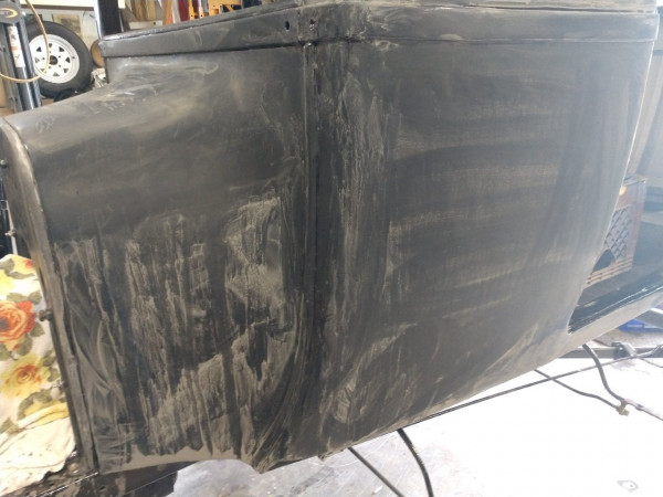

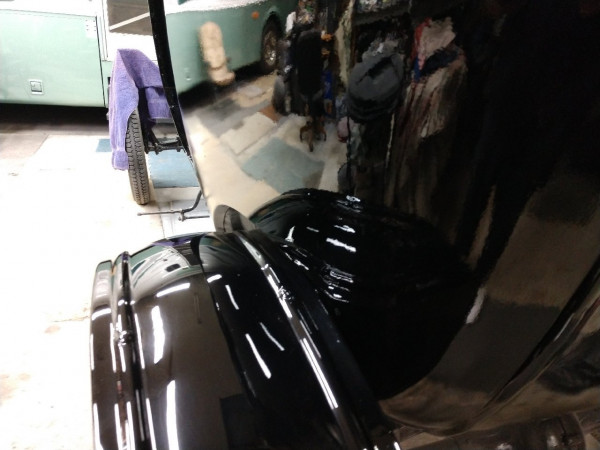

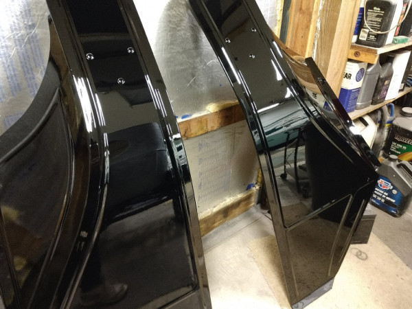

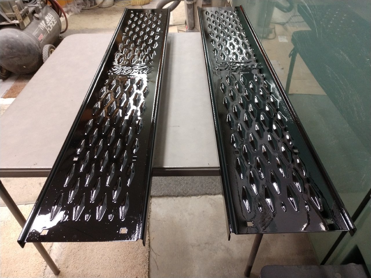

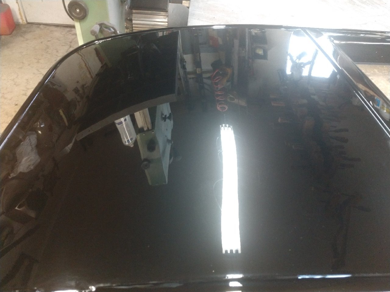

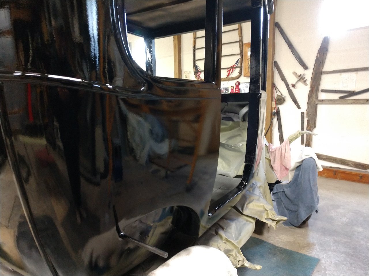

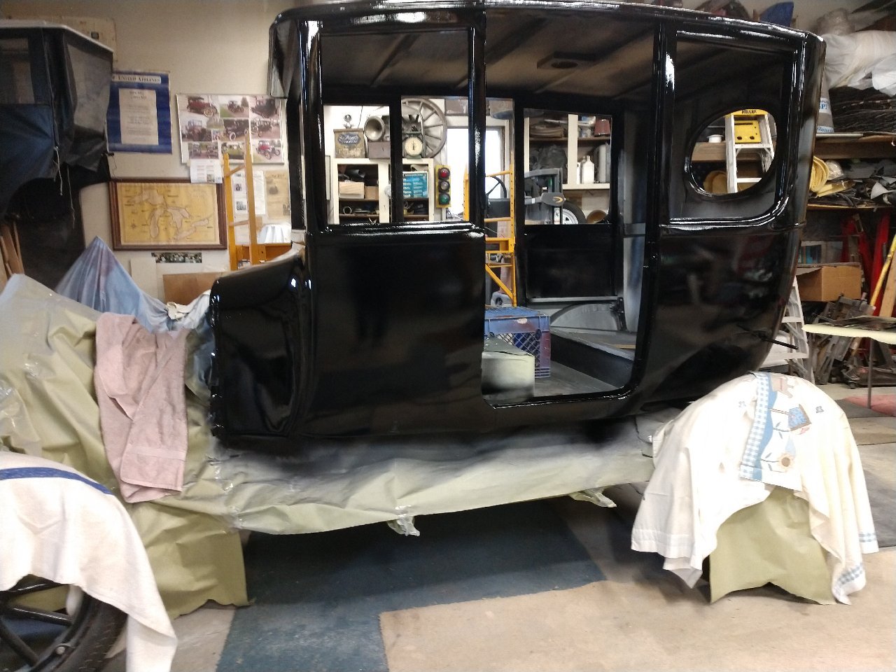

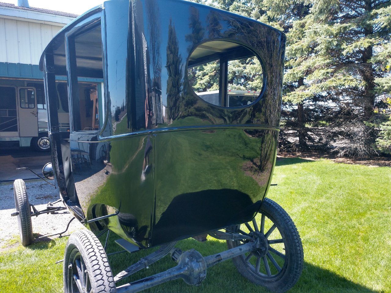

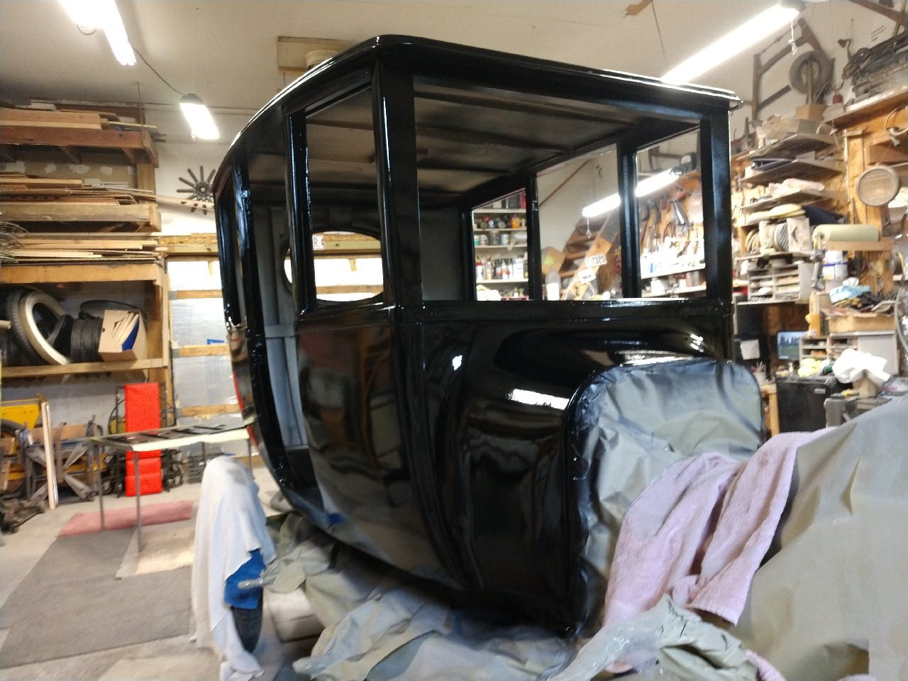

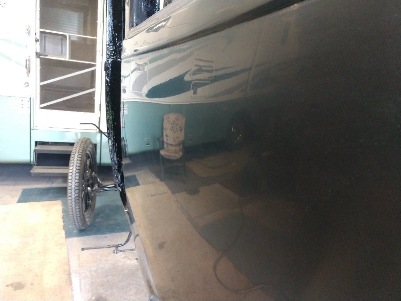

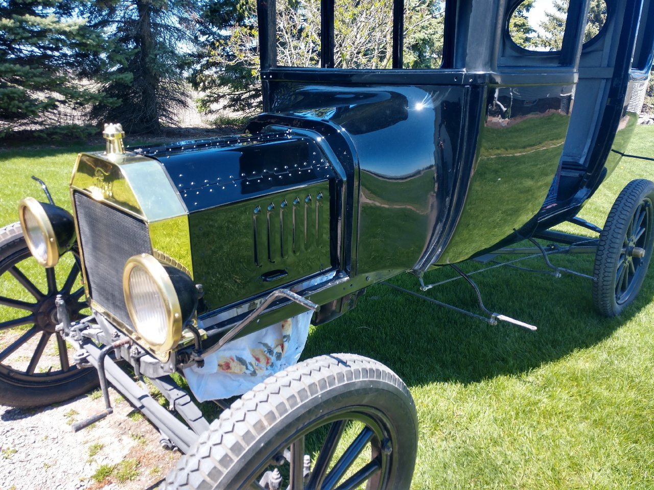

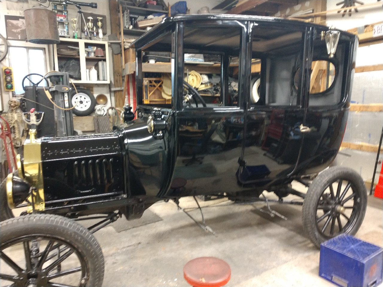

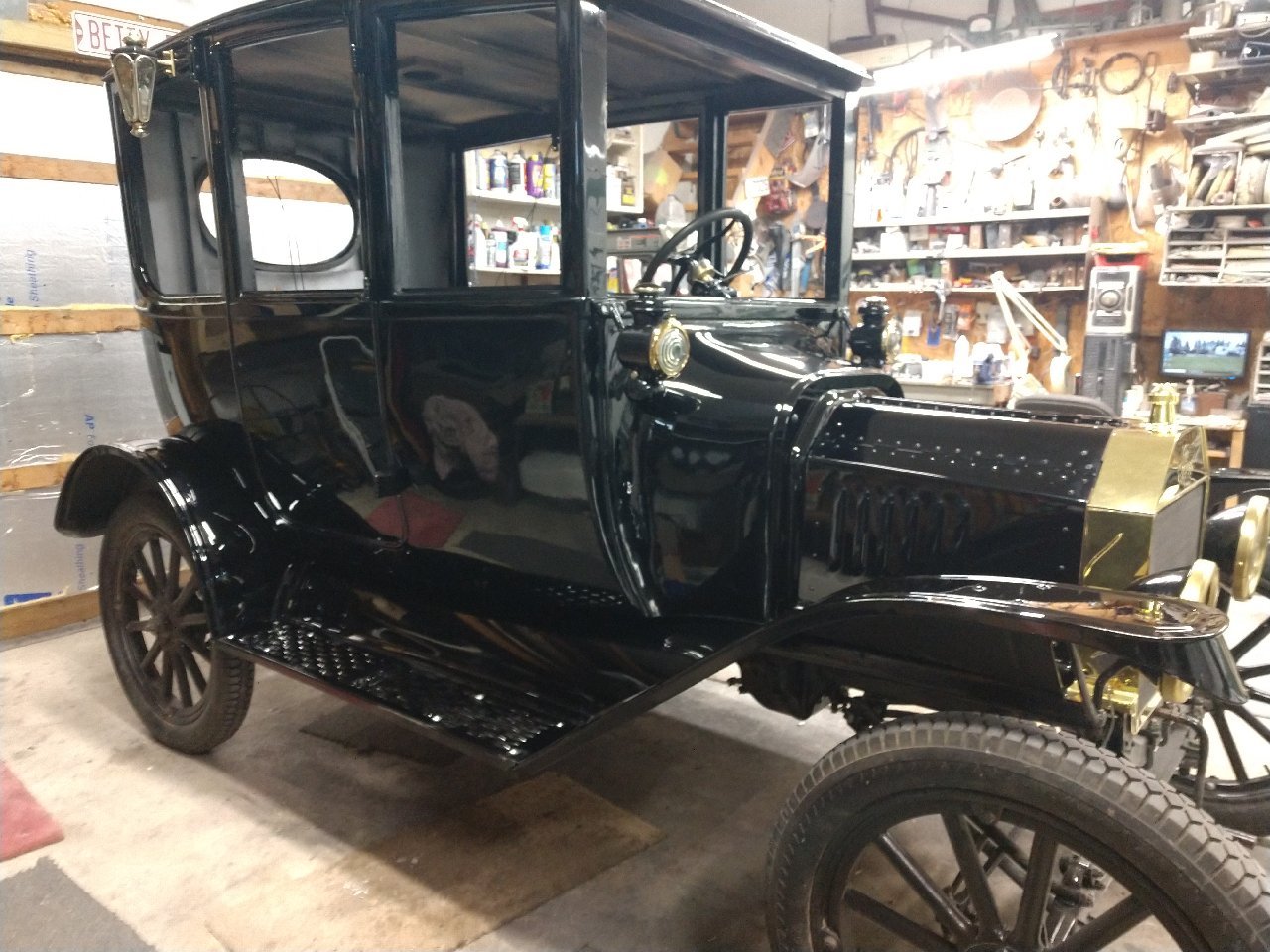

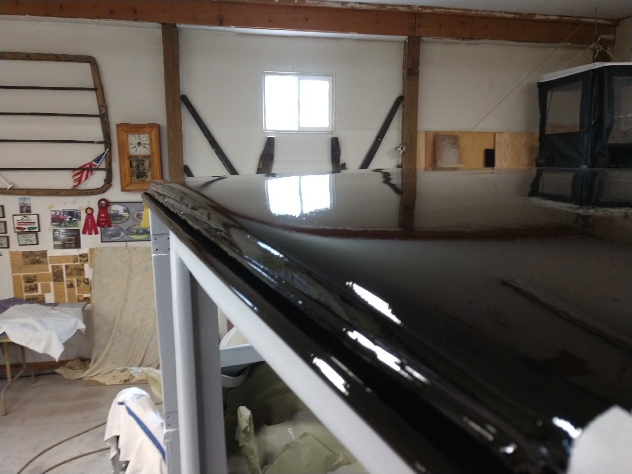

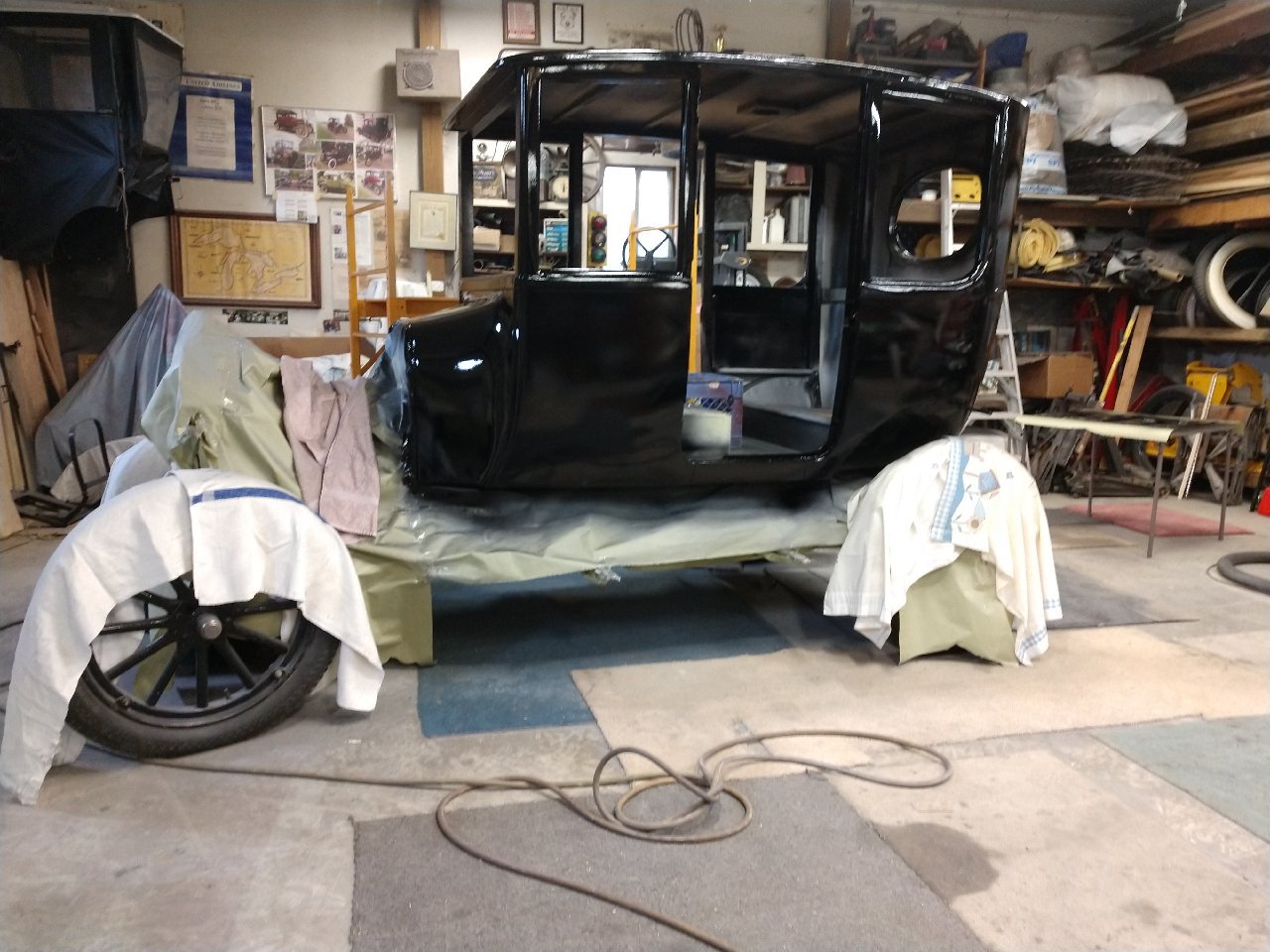

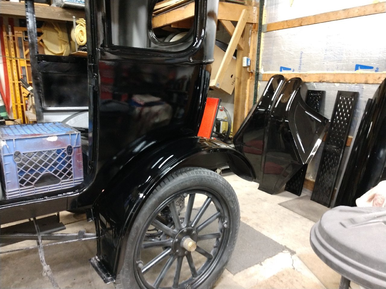

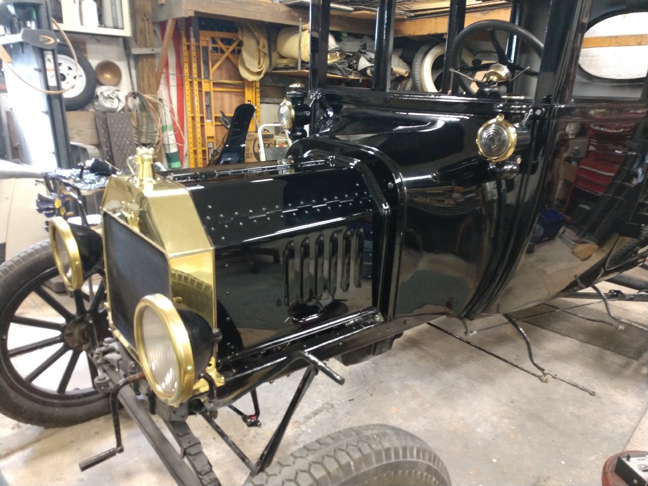

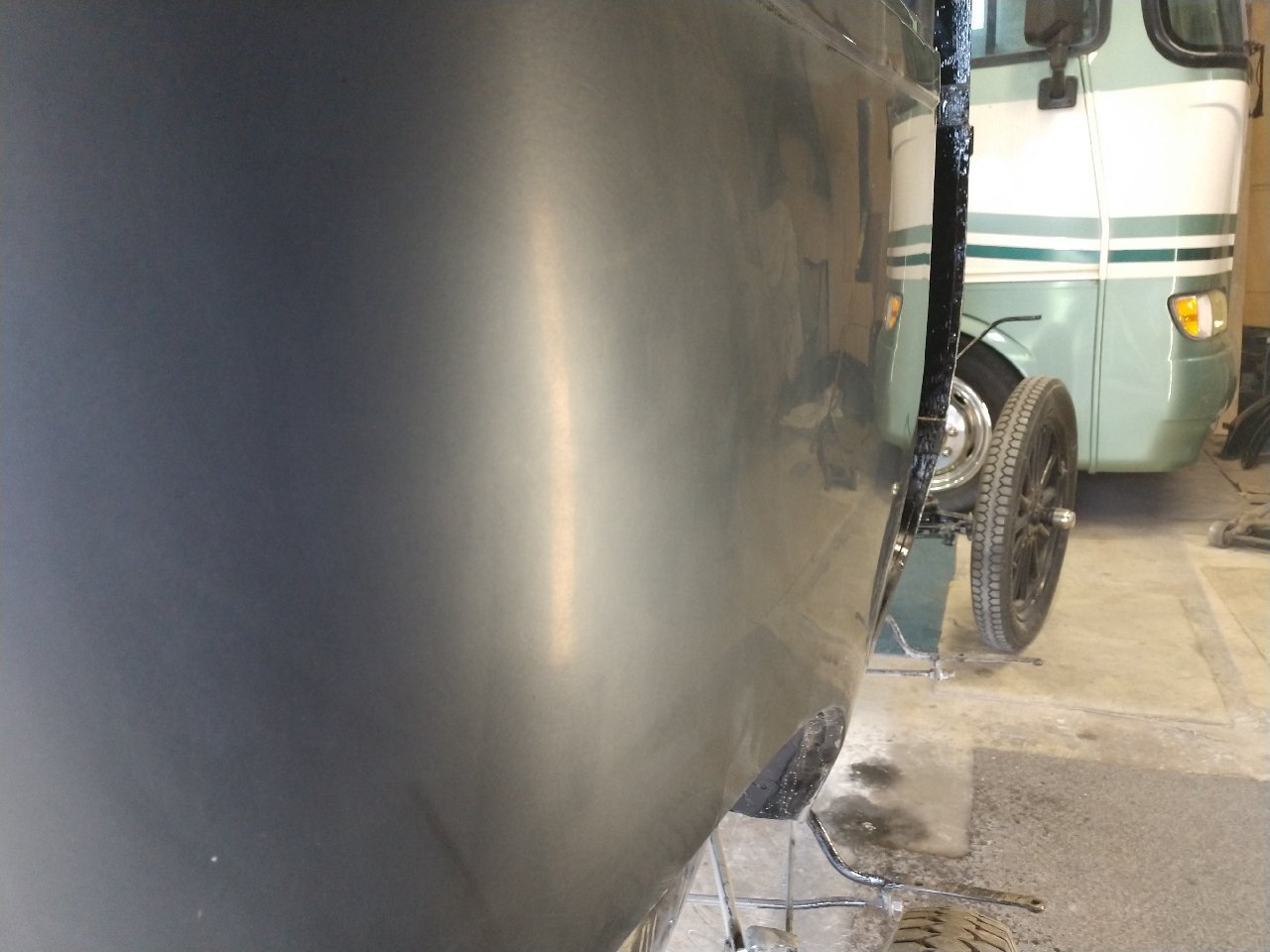

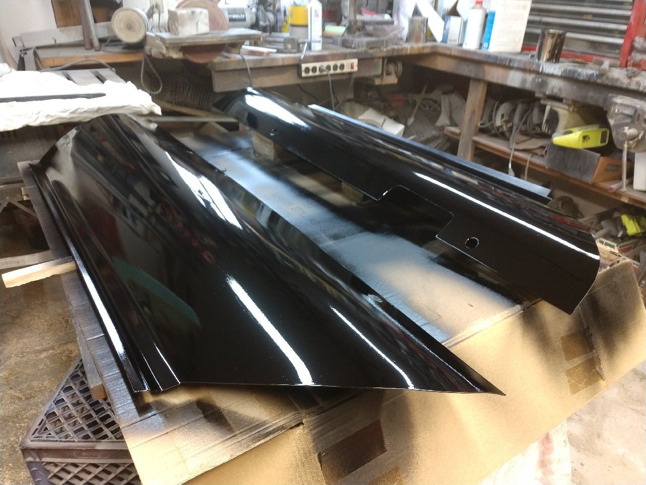

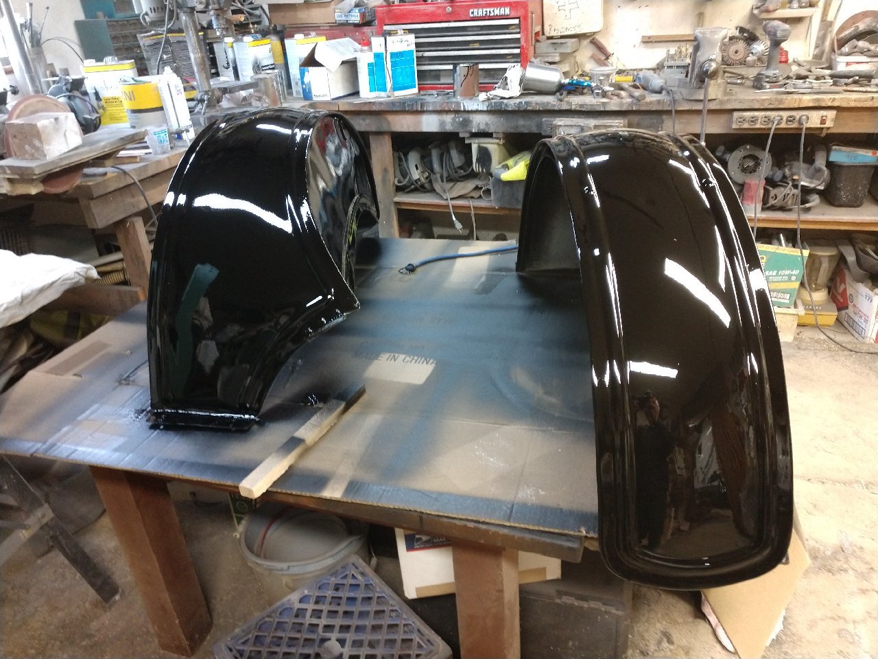

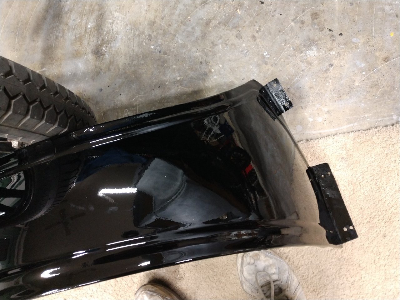

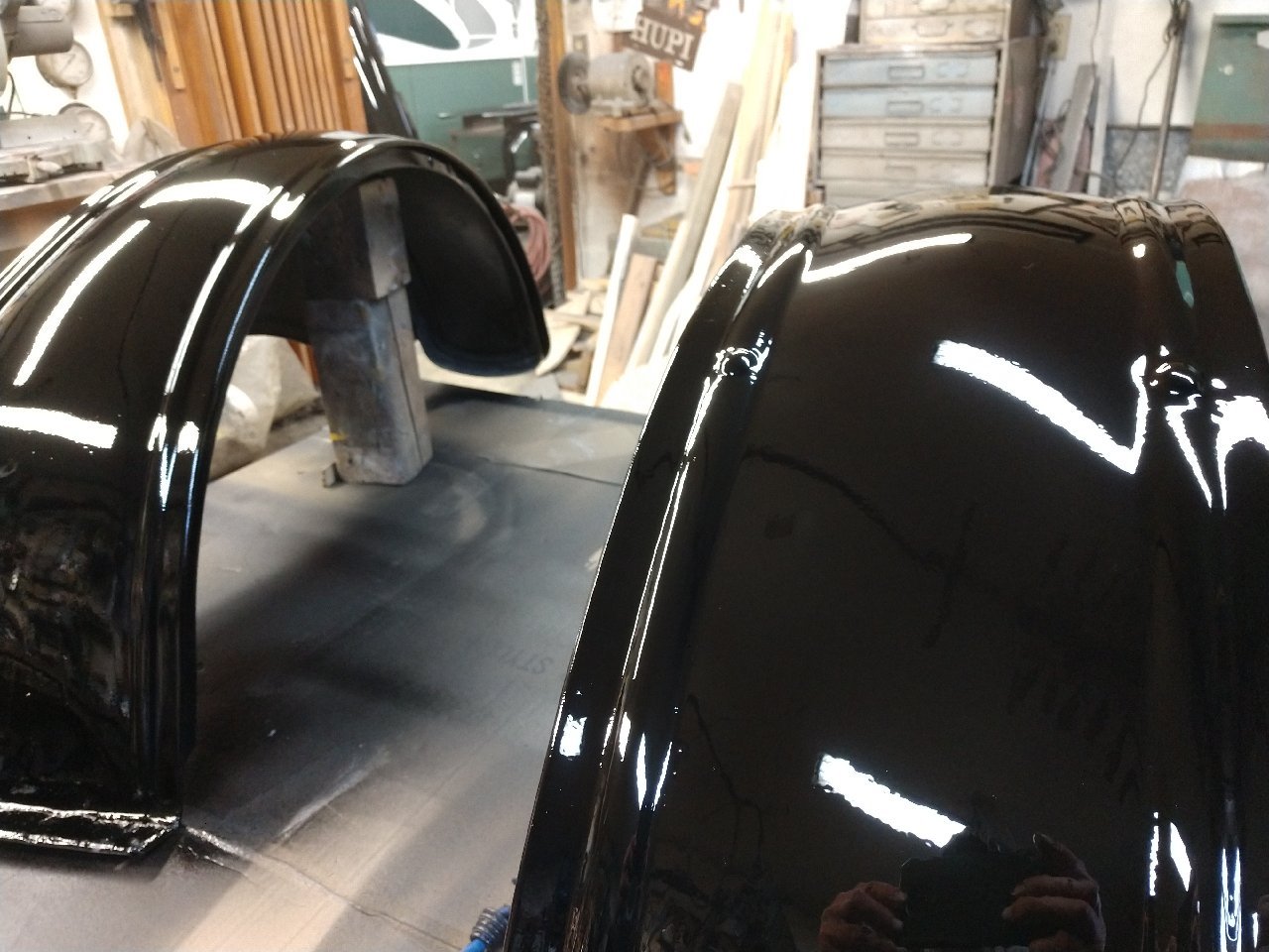

Post by FordorGalore » Fri Apr 17, 2020 3:54 pm

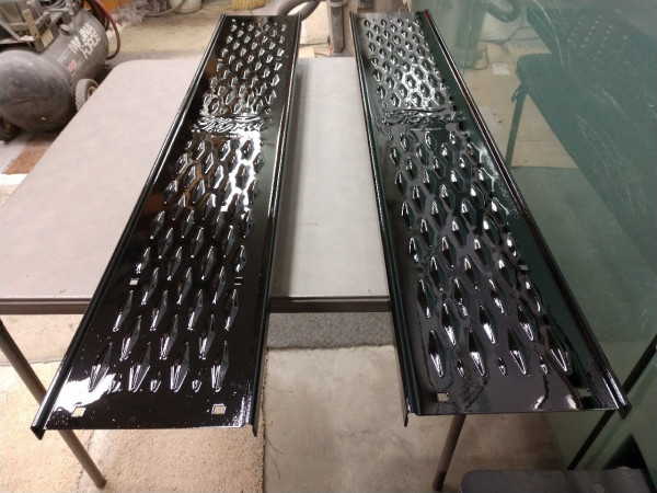

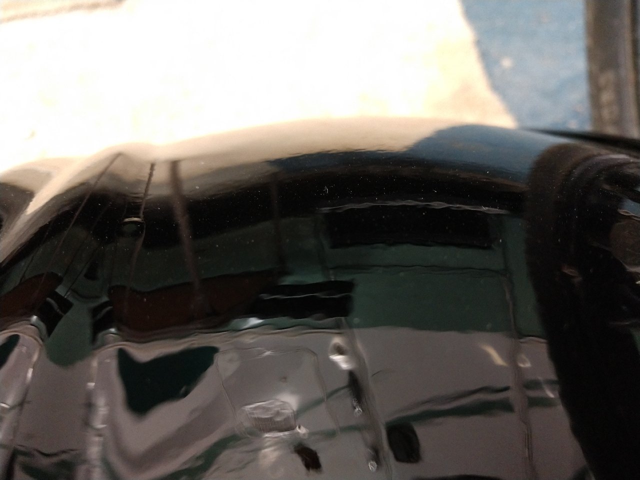

Started to do some painting today on a few smalls. Painting once a year isn't enough, and it shows. Still very wet in these pictures.
mtntee20
Posts: 672
First Name: Terry & Sharon
Last Name: Miller
Location: Westminster, CO
Post by mtntee20 » Fri Apr 17, 2020 4:35 pm
Don,
If I could paint that good just once a year, I would be ECSTATIC!!!! Geez, those look great in the photos. I realize, close up, you might be able to see some small defects but the photos look outstanding. Good Work!

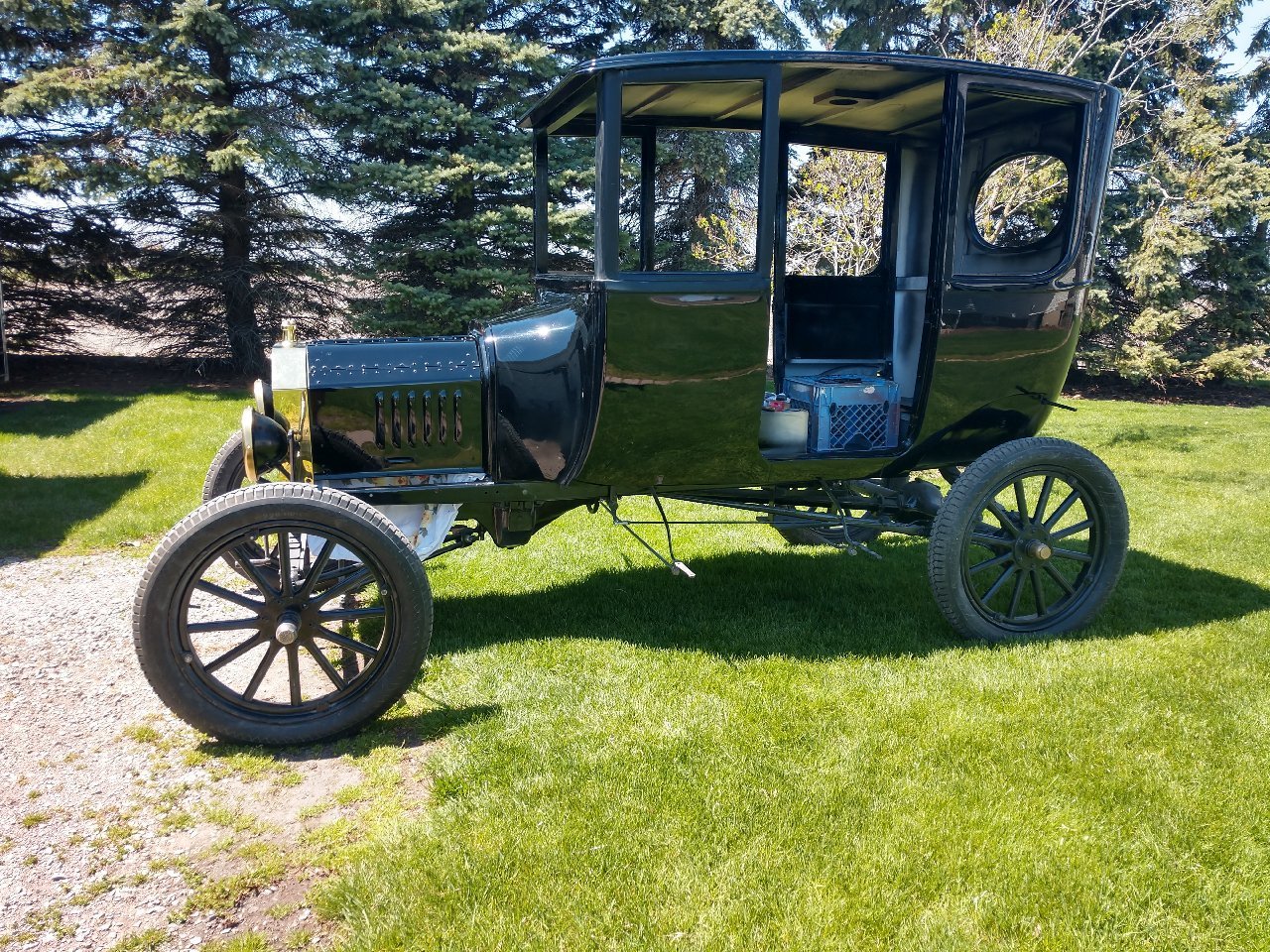

FordorGalore
Posts: 430
Joined: Fri May 03, 2019 8:20 am
First Name: fore
Last Name: door
* REQUIRED* Type and Year of Model Ts owned: 1922 centerdoor 1927 fordor 1916 centerdoor
Location: Nowhere Michigan
Post by FordorGalore » Fri Apr 17, 2020 4:53 pm
Thank you Terry, I probably should have waited until it laid down and dried before taking pictures. Being that its still wet is shows every little piece of dust in it. I will have to wait until the morning to see what I actually have here. Either way it all gets wet sanded and then either clear coat or cut and polished. Just having fun during the lockdown !! Hope everyone else is too.
Posts: 4287

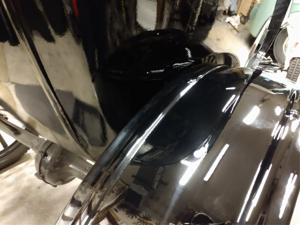

Post by Wayne Sheldon » Fri Apr 17, 2020 5:07 pm

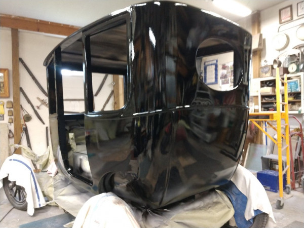

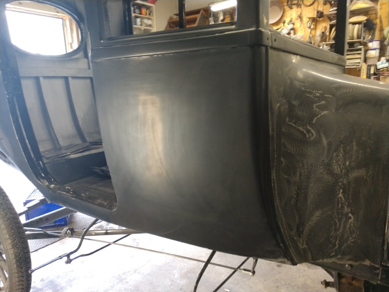

Crowned rear fenders?
FordorGalore
Posts: 430
First Name: fore
Last Name: door

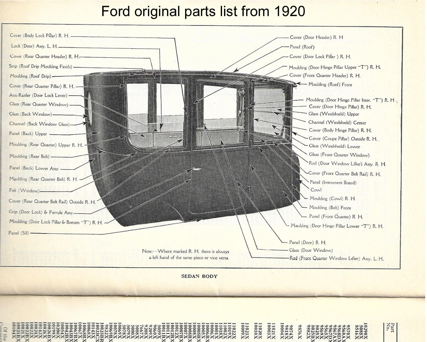

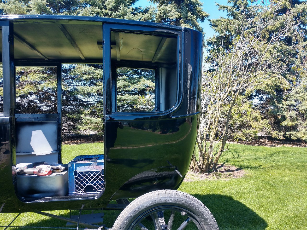

Post by FordorGalore » Fri Apr 17, 2020 6:33 pm
Yeah, I question those fenders also. Mike Husted didn't think they were correct for a early '16 either. The hood, radiator shell and hood shelfs all appeared to be re-pops. They had no surface pitting anywhere and the radiator was newer also. So, more research has to be done on the period before I fork over more money on a maybe. I would also have to have the flat style fenders of the '15's to see if they would properly fit the deep fender wells on this body. The fender wells are just shy of 5" deep in the front where they meet up with the aprons. Talk to me Wayne !
Posts: 1645
Last Name: Seth
Location: Jefferson Ohio
Post by perry kete » Fri Apr 17, 2020 7:13 pm
Don,
That car is beautiful. Looking good! :)

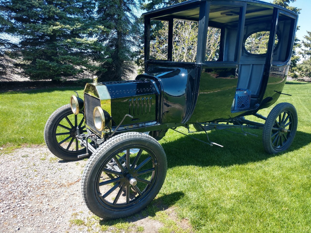

Post by CudaMan » Fri Apr 17, 2020 7:39 pm
Bruce's book talks about the 1915 -1916 sedans starting on page 201. It mentions that 1915 sedans had an aluminum body and different splash shields and rear fenders from the "other models", but by 1916 it had a steel body and used the same splash shields and rear fenders as the "other models". It mentions that the rear fenders were attached directly to the body rather than using irons. The rear fenders do not appear to be crowned in the pictures in the book.
Bruce's book also has a special section on the entire run of the "Centerdoor" sedans starting on page 287.
Post by FordorGalore » Fri Apr 17, 2020 8:14 pm
Yeah Mark, I've had some long discussions on the body and fenders and the entire car in general. The FaceBook groups I belong to have no definite answer. They do agree this car is transitional and may very well be correct OR incorrect. Until I get some solid proof that it's wrong I will go with what I got. Bruce McCalley's book is very much a gray area for this centerdoor time period. I guess he even admitted he couldn't be certain what he wrote was right. It keeps things interesting to say the least.
Posts: 4287
Post by Wayne Sheldon » Sat Apr 18, 2020 3:33 am
I had a few discussions with Bruce personally when I was restoring mine. He admitted he didn't know for certain what the '16 model c-d sedans were like, or even IF they were originally built at all. Decent evidence that they were in fact built didn't come to light until after Bruce was gone.
In the first place. It MUST always be remembered that the "true" '15 model c-d sedans and the '16 brass model c-d sedans are two completely different animals. Although they look very similar from a distance (or in most photographs), in details, exact dimensions, materials, and trimming, they are VERY different. There IS reason to believe that a few transitional early '16 model c-d sedans had some carryover pieces. A long-time friend of mine had one that still had its factory installed gasoline tank under the rear seat! However, a previous owner had also installed a later front seat and square gasoline tank because of the fuel flow problems that rear seat tank became famous for. And his car was a Canadian built sedan, so that casts doubt about some differences from USA cars. My car had an identical rear seat structure as did his, and our two were the only c-d sedans I looked at that had that structure. Every other c-d sedan I looked at was different than ours, and I looked at about two dozen of them.
My '16 c-d sedan also had the early '15 sedan fenders on it. Unfortunately, my car had suffered a bad '50s restoration casting doubts on everything about it. There were good reasons to believe it had been the real thing, and a well known San Francisco Bay Area collector that had previously owned the car claimed the rear fenders were what the car had when he got it.
As for the rear fenders. I haven't seen a really definitive date given for when the crowned rear fenders began showing up on cars. Apparently, from past discussions on the subject, the rear crowned fenders started showing up late in 1916 model brass radiator cars. That detail rarely shows in era photographs. Usually, the picture is of some thing or some one else, and we get to hope to see such car details. Rear fenders were rarely ever the subject of era photographs. From many common angles photos are taken from, the crown does not show. Many times, one can "think" they can see the crown or not, but often it is as much illusion as it is a clear view. I have seen a few era photos that clearly did have the crowned rear fender on a brass touring car. But not many. And I have spent a fair amount of time studying multiple photographs of a single car just to study how both crowned and flat curved rear fenders look from different angles. In some of those past discussions, a few people having nice original late '16 model Ts, with good reason to believe the rear fenders were original to the car, have found the crowned rear fenders as early as late June of 1916, and several from July and August. I doubt that any T had the crowned rear fenders before late June of '16.
And as usual for me, that is my opinion from my memories of past discussions.
FordorGalore
Posts: 430
First Name: fore
Last Name: door

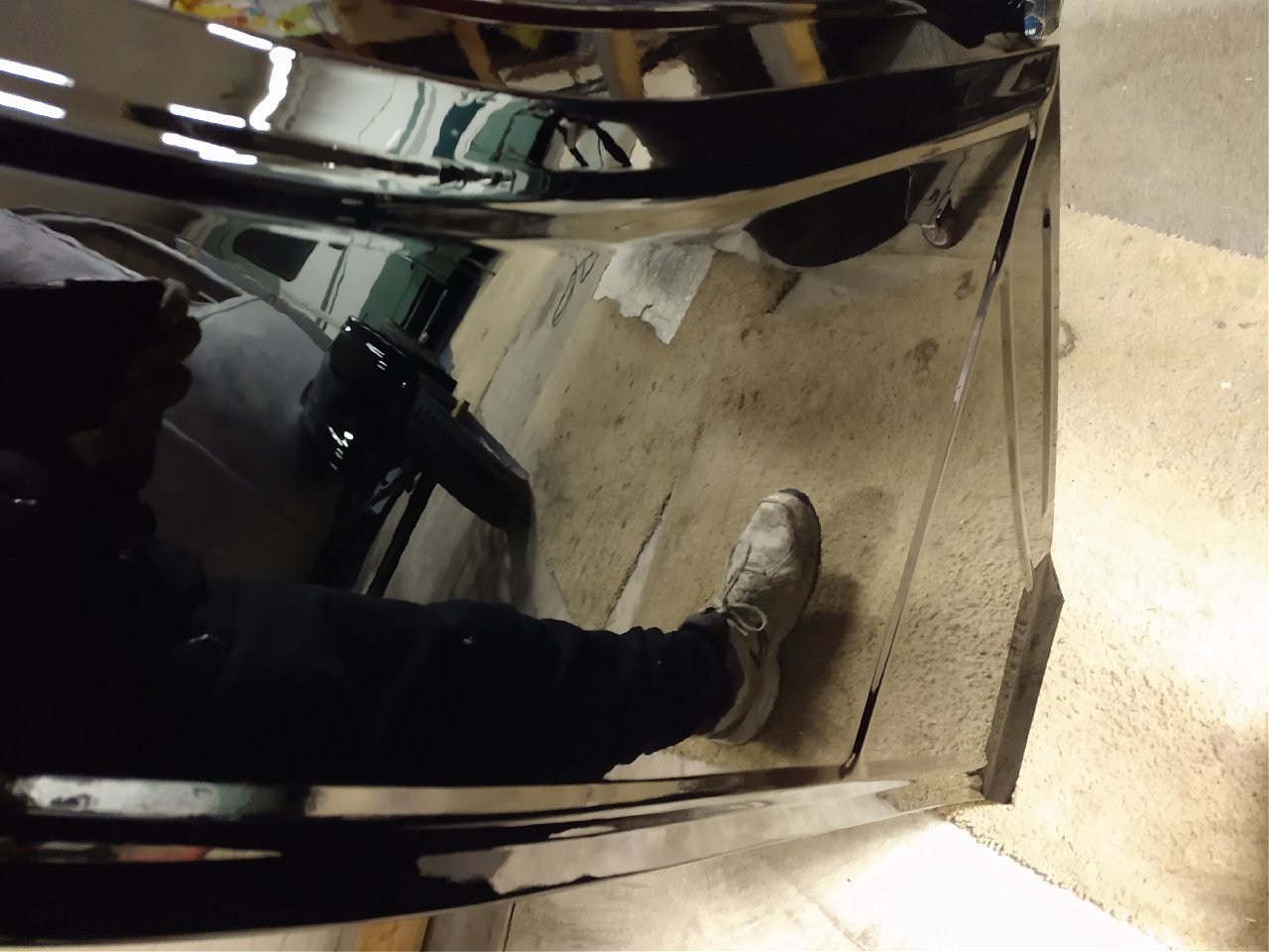

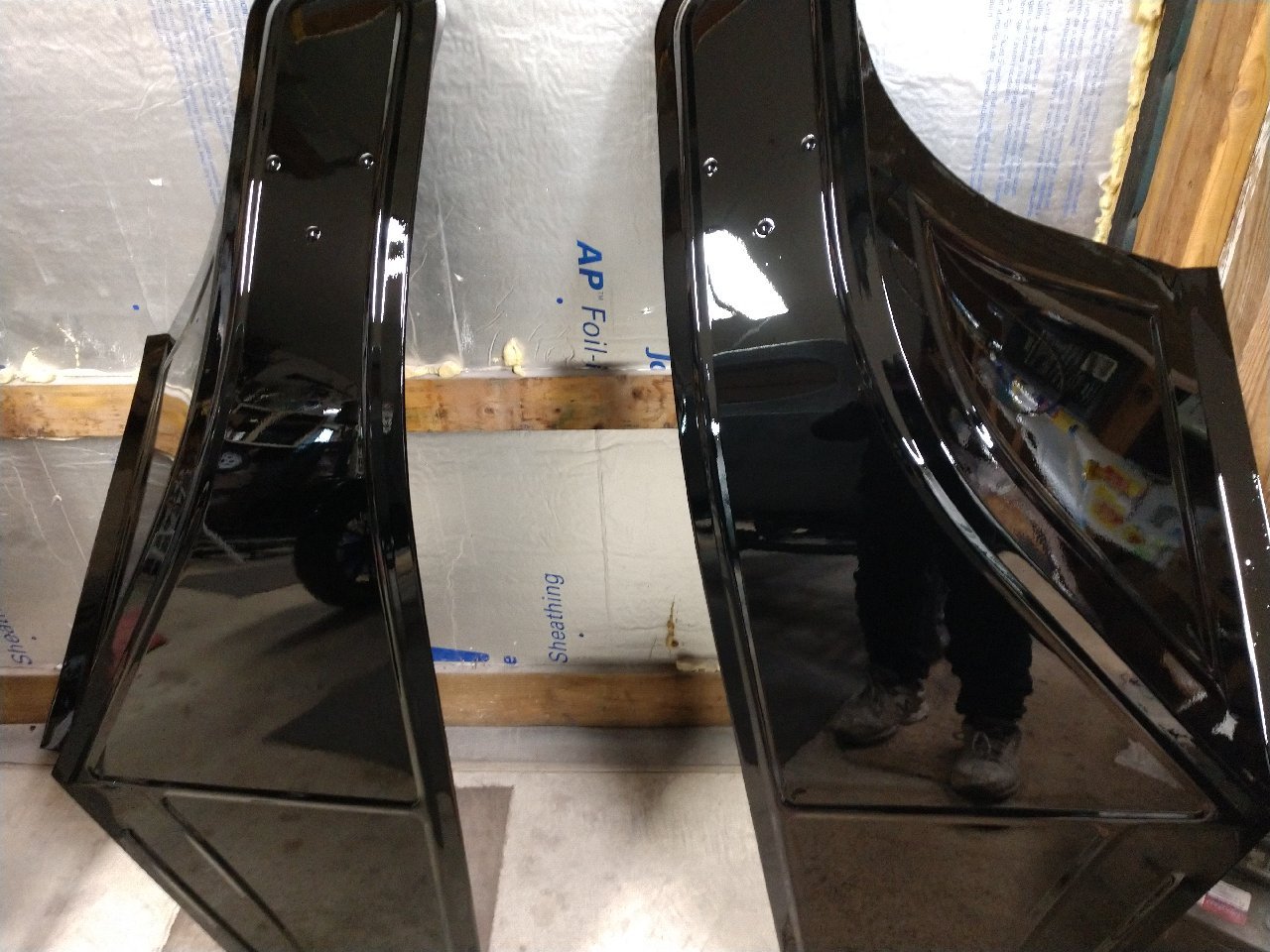

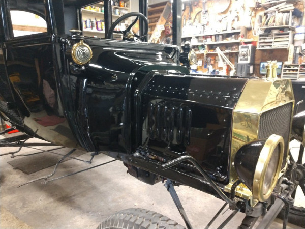

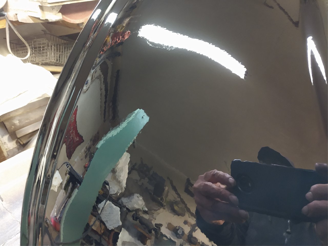

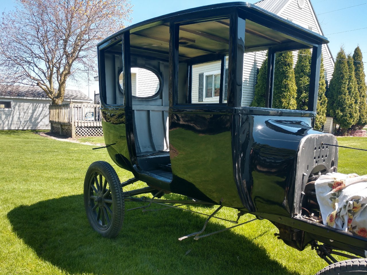

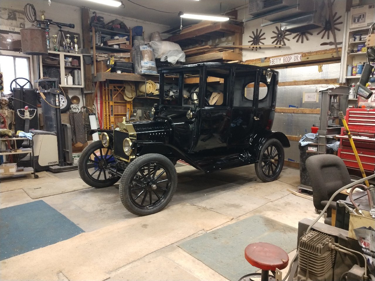

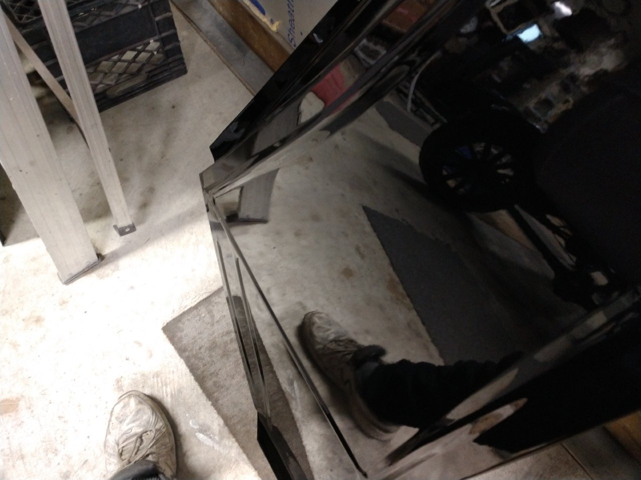

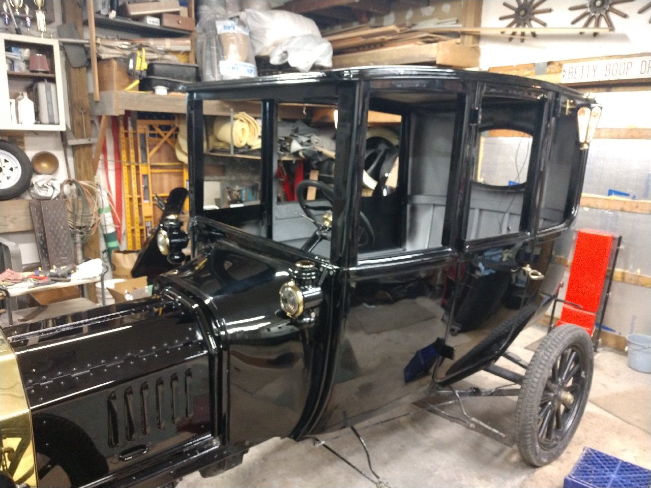

Post by FordorGalore » Sat Apr 18, 2020 9:07 am
Ohhh BABY!! It laid down real nicely. The morning after results. Love that paint !
Post by Joseph A Stearns » Sat Apr 18, 2020 10:40 am
Wow, that is nice nice!! Is this the super paint like the red paint $$$ you used on the Sedan? Good job Buddy.
Post by FordorGalore » Sat Apr 18, 2020 10:50 am
Basically the same... Thanks Joe.

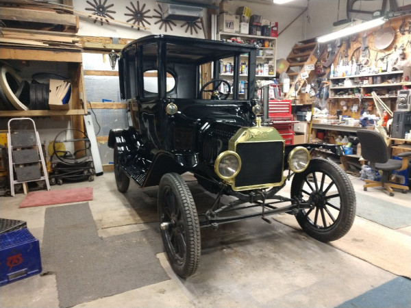

Post by FordorGalore » Sun Apr 19, 2020 8:53 am
Thanks Wayne...I follow the 50ft rule.

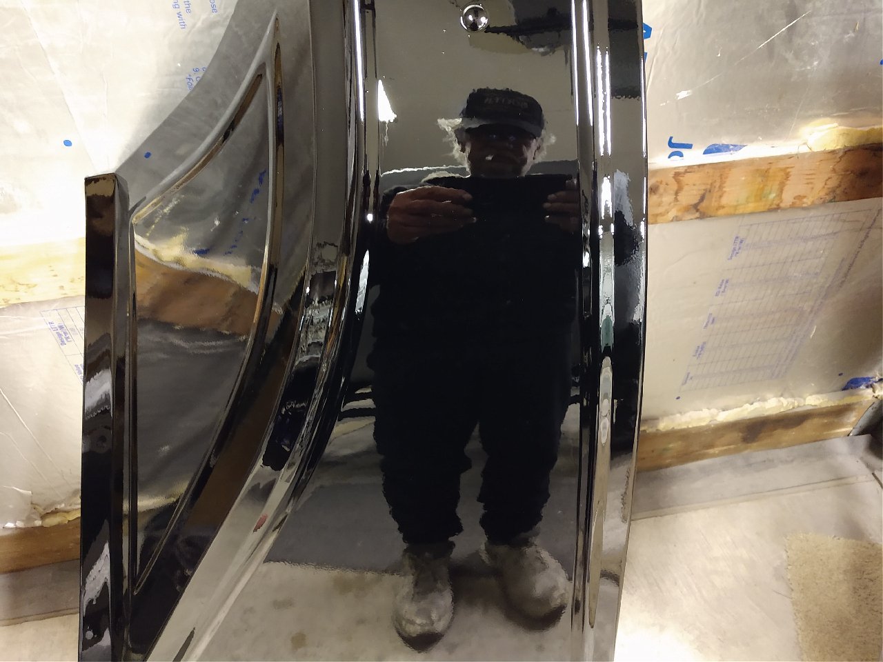

FordorGalore
Posts: 430
First Name: fore
Last Name: door

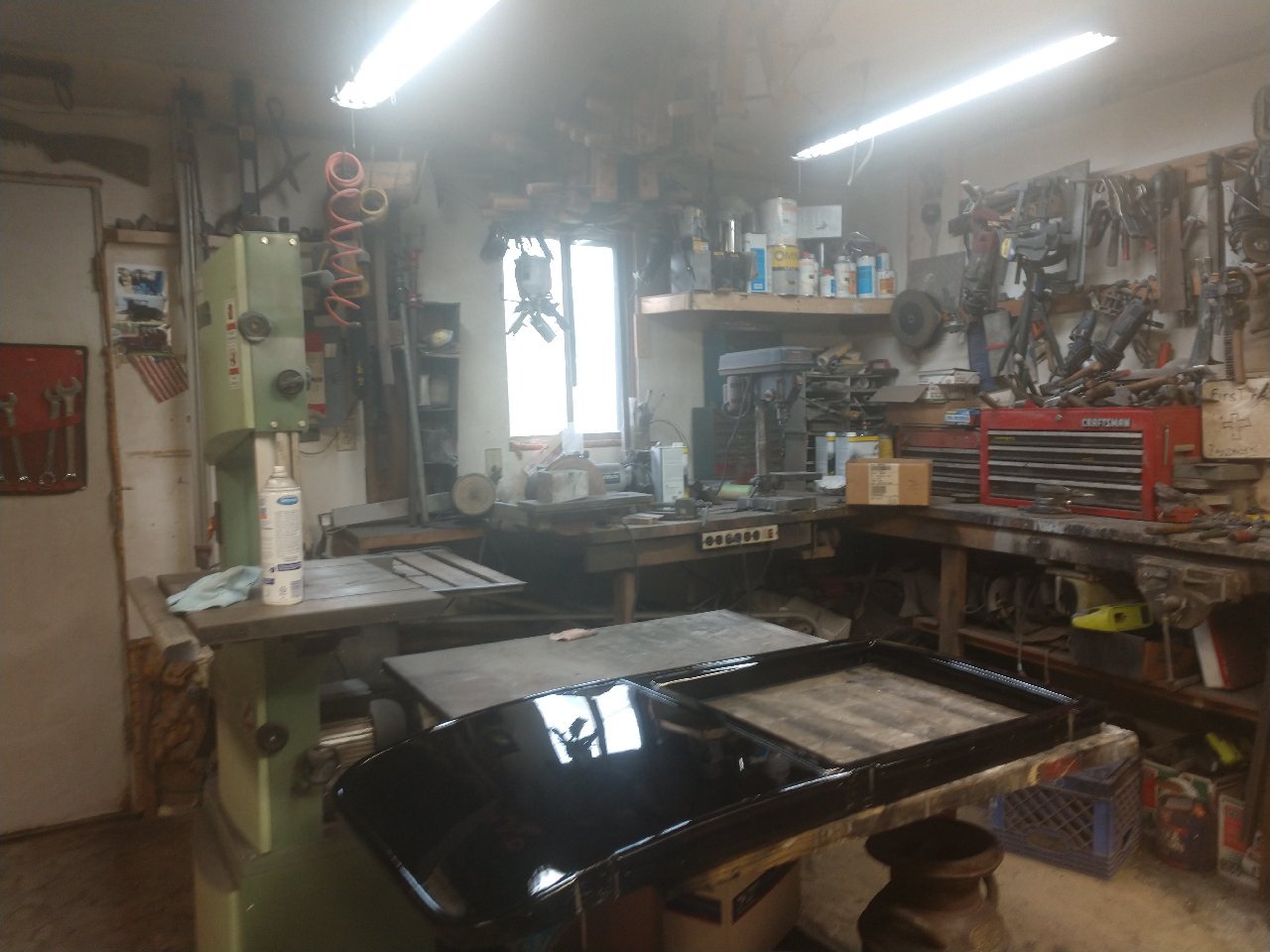

Post by FordorGalore » Sun Apr 19, 2020 8:55 am
Mirror mirror on the T, the reflection looks like a fatter me....

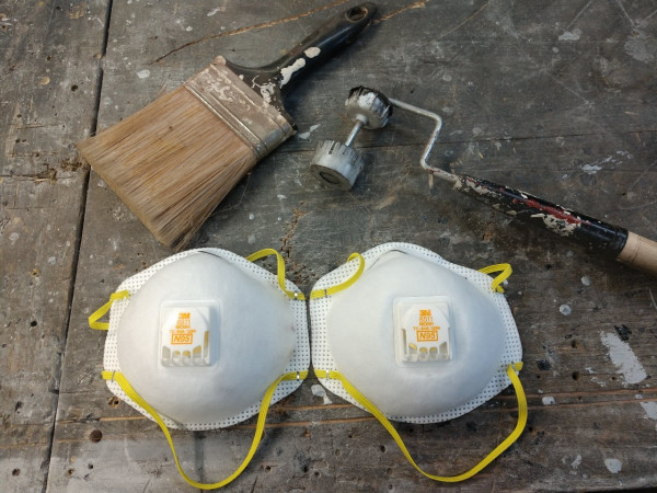

It is nice to see someone follows Henrys way of applying paint using a paint brush, garden hose and dipping. Points should be taken off if they shine to much, we cannot have that. Mike

Oh yeah thanks Mike !! I used a hair brush and tree sprayer ! LOL...

I would not have thought of the hair brush as I have very little, very appropriate, the only thing missing is the hair dryer, that would count as
oven baked.

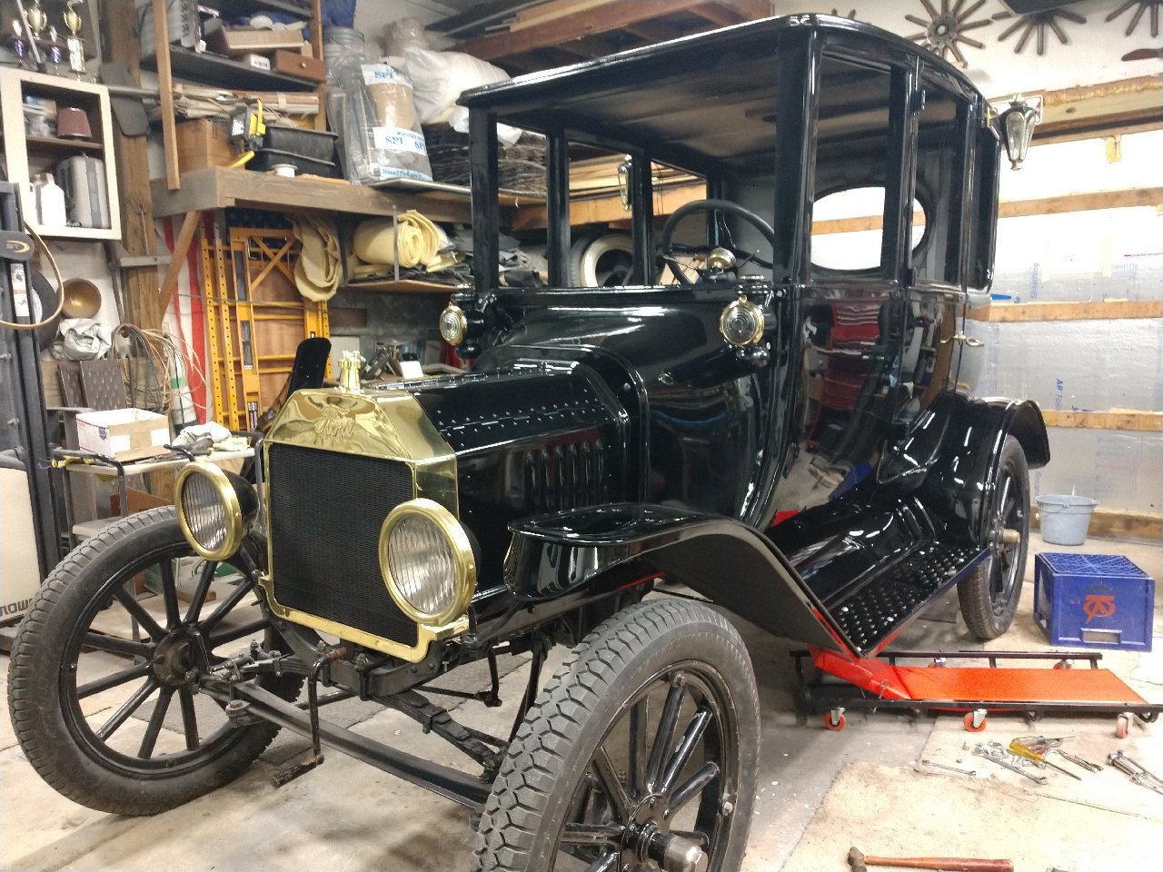

Post by Tim Rogers » Thu Apr 23, 2020 1:33 pm

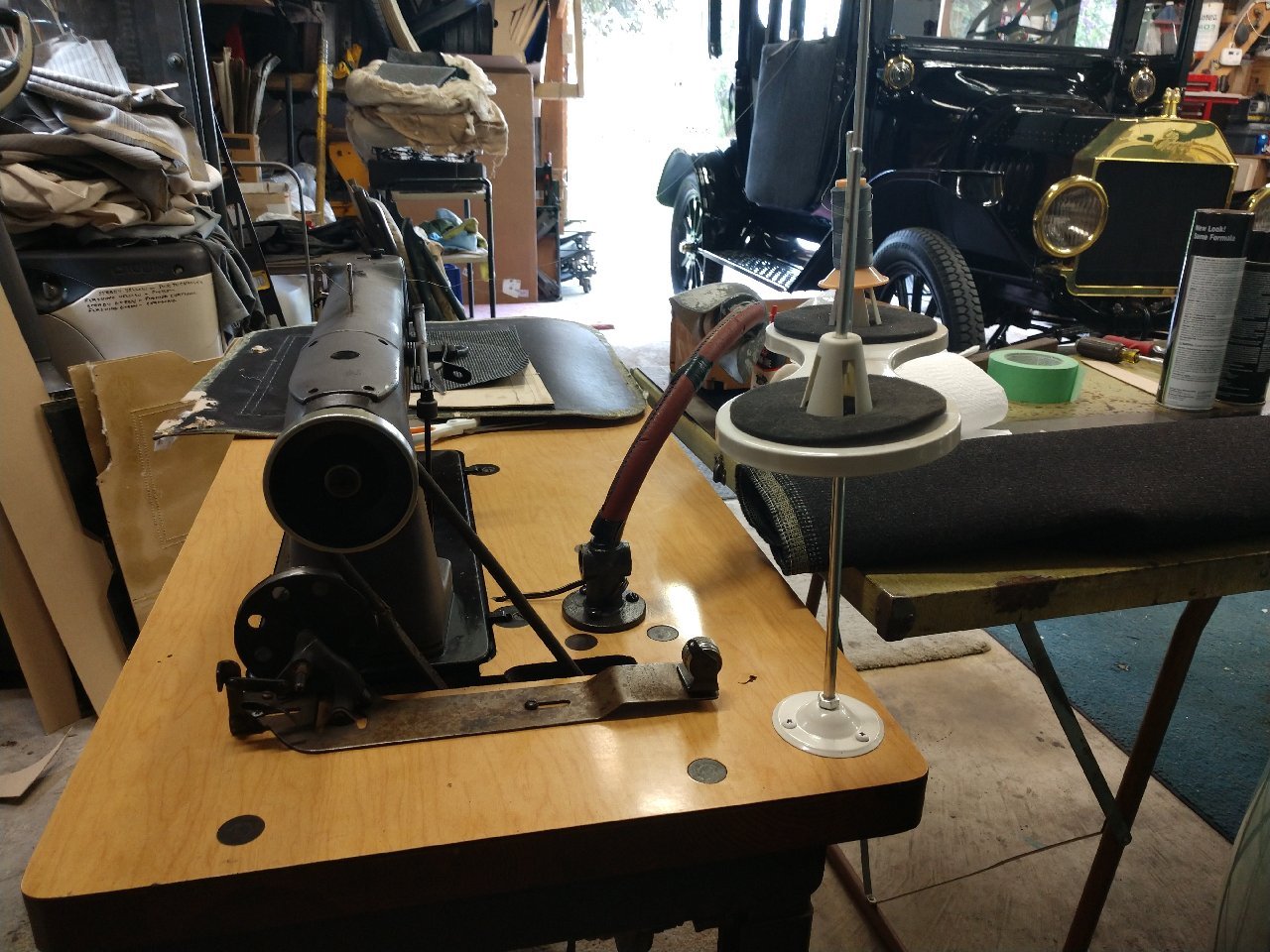

Excellent job and beautiful paint work to say the least! When finished, will this car be a true representation of what the factory produced in 1916 or will it be something more grand and beyond what mass production would look like?
FordorGalore
Posts: 430
First Name: fore
Last Name: door

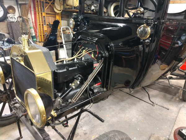

Post by FordorGalore » Thu Apr 23, 2020 1:42 pm

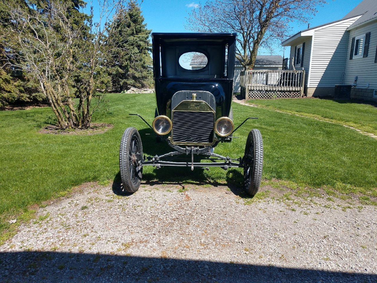

Tim it should look like the picture, except I will be adding the carriage lights. Thanks for asking...

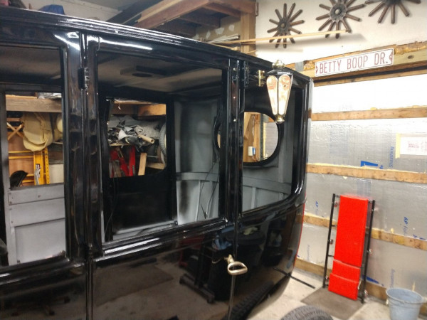

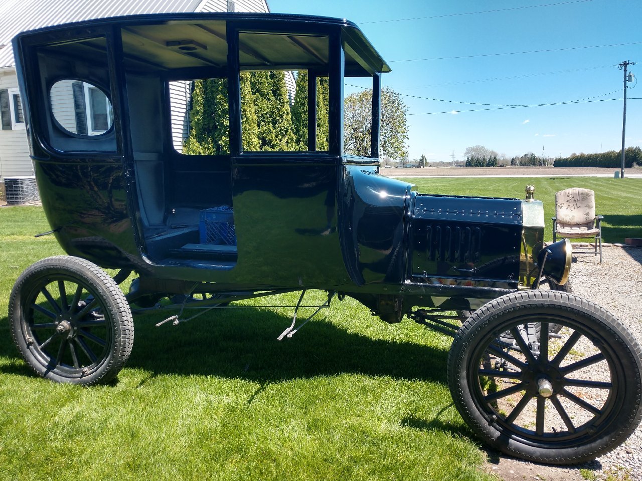

Post by FordorGalore » Fri Apr 24, 2020 11:55 am
Thank you Bill, this is the result of 5 hrs of spraying this morning. The paint is still wet and hasn't laid down. Fingers are crossed and prayers for the sprayer !

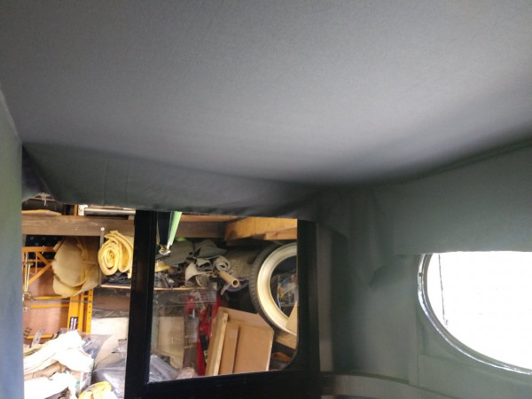

Post by Mikes 1912 » Fri Apr 24, 2020 12:19 pm
That is a fantastic upholstery job. Mike
Post by Dallas Landers » Fri Apr 24, 2020 7:53 pm
Looks great Don! Good choice on the color. :D

Post by otrcman » Sun Apr 26, 2020 4:41 pm
Don,
Your body paint should be well hard enough for close inspection now. Are you happy with the result ? Sure looks good from here !
Post by FordorGalore » Sun Apr 26, 2020 4:58 pm
Dick, I should have waited another month for the temps to come up. But being the impatient, quickly bored and forge ahead dummy that I am...I painted it anyway. So, the truth is each day it looks better and its because of the cooler temperatures of everything from the paint itself to the compressor air. I am going to wait a full week before wet sanding and cut and polishing but I'm pretty happy with it. This week I will be wet sanding the fenders and smalls I had already painted. I doubt anybody wants to look at pictures of that tho. Thanks for asking ! :) :) :)

I also should have added that Mike Husted and I talked about the effects of the borderline temperatures. The conversation lasted about an hour and although most of the conversation was garbled at Mr. Husted's end I picked up what I could. But be warned if you call Mr. Husted and you hear a continuous crinkling and I mean very loud crinkling it's actually caused by numerous Twinkies being devoured. And don't be surprised if a sudden burst of frustration comes very clearly across the phone. It's caused by the bottom cake of the Twinkie sticking to the paper wrapper. The ole Twinkie eater !!! :lol: :lol: :lol:
Post by FordorGalore » Mon Apr 27, 2020 6:54 am
4 days later and each day shows improvement on the paint. I will wait 7 days before working on it...

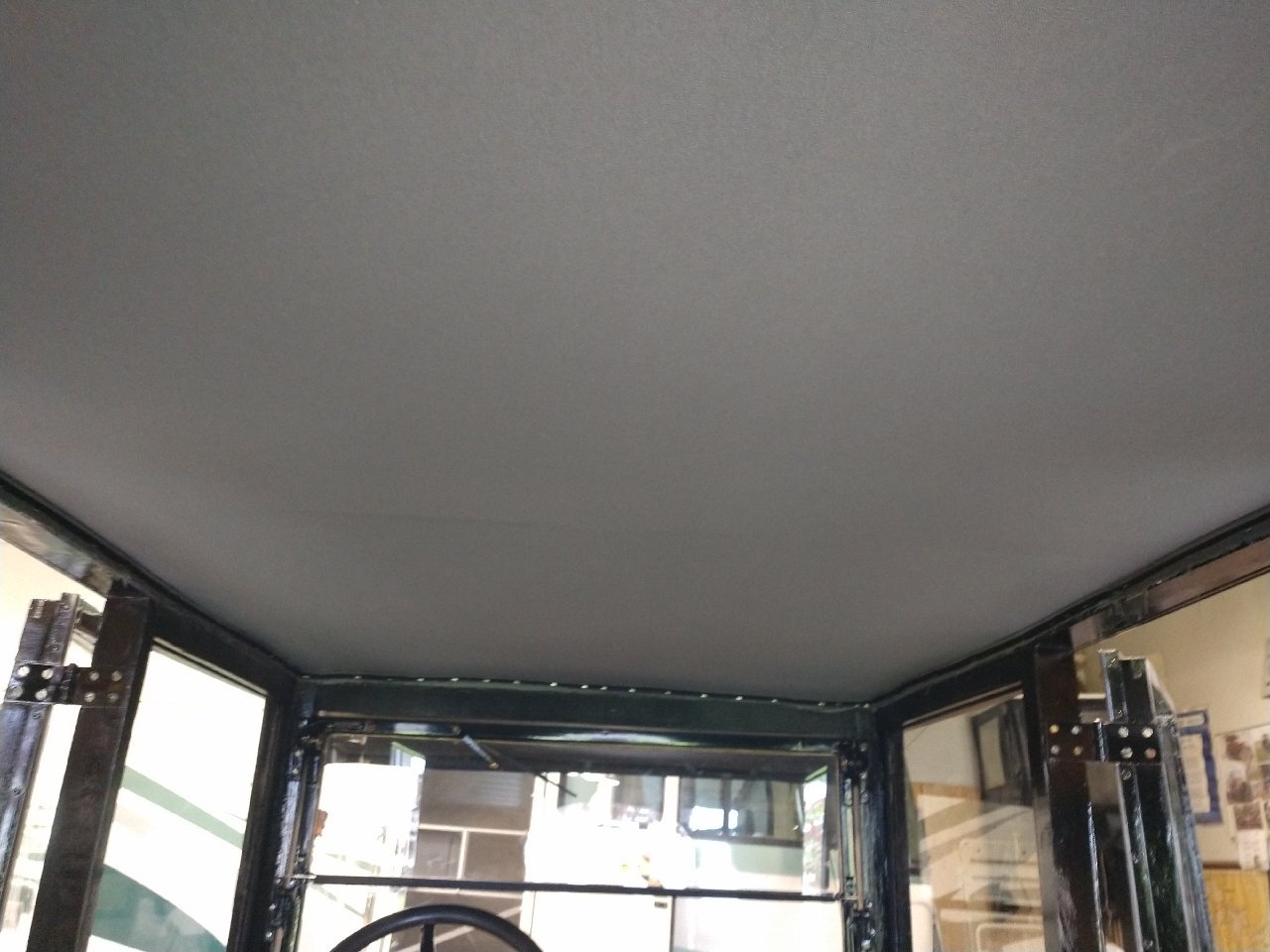

When are you going to upholster that blue seat with that pink material? If you do not have enough I can look at the Goodwill store. That is about as cheep as it gets. You can get the padding out of old mattresses they will give them to you to haul them away.
FordorGalore
Posts: 430
First Name: fore
Last Name: door
Post by FordorGalore » Tue Apr 28, 2020 12:12 pm
Never you mind Twinkie boy !! Besides I kinda like the looks of hot pink with a nice green piping cord....yeah that's the trick !!

Post by FordorGalore » Wed Apr 29, 2020 2:15 pm

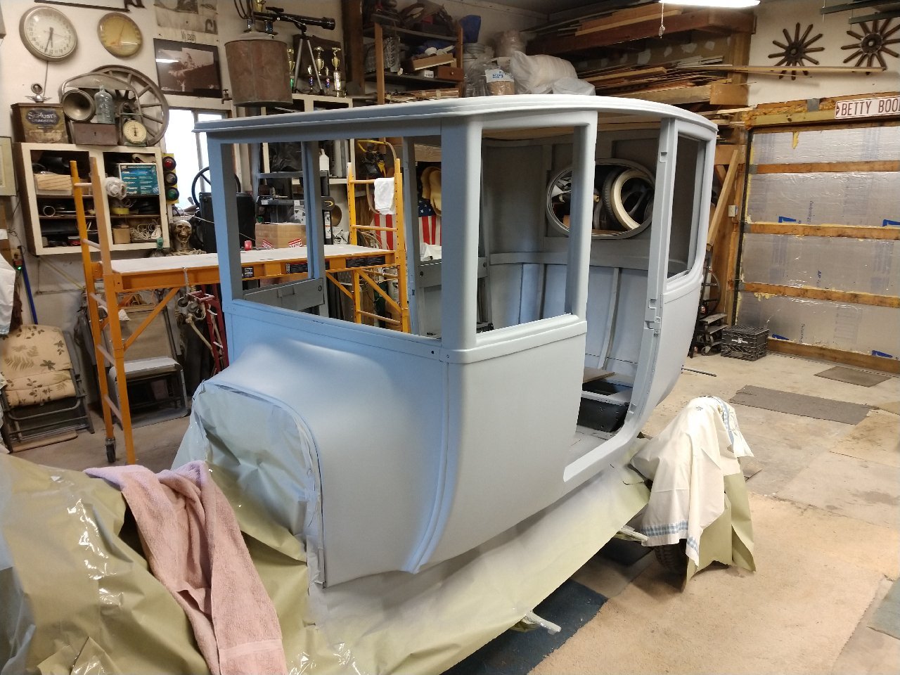

Are you talking about the plunge saw Mike? Here's what I did this morning, Steve Culp said he would cut and polish his cars until he could read the label on the overhead lights. Steve is renown for designing and building the "Culp Special" acrobatic bi-planes. He now builds and designs modern speedsters. His work is beyond words.

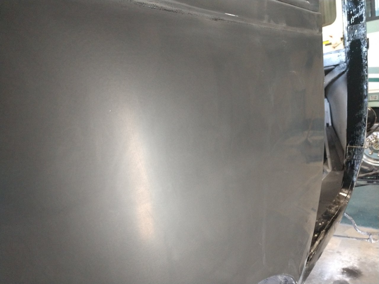

Ahhh you've needed a shave since day two of the lockdown Mr. Ketepary !! So I am cleaning up the dual socket headlight and ran across this.. FORD VICTOR. Does anyone know the story behind this? Just curious. Thanks in advance !

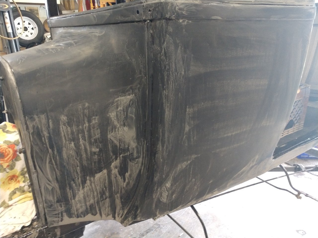

Post by FordorGalore » Sat May 02, 2020 5:02 pm
Day 4 of wet sanding....you have to live it to appreciate it. Uhgggg !!!
Post by perry kete » Sat May 02, 2020 6:59 pm
I'm just sitting here eating M&M's watching you wet sand :lol:
Post by Mikes 1912 » Sat May 02, 2020 7:11 pm
Now I know why the steeps to the motor home are down. Sand once rest for an hour, sand twice rest for an hour, sand three times sleep for the rest
of the day.
Amen to that! I'm glad last summer when I painted and color sanded my 15 runabout, that the body was much smaller than your centerdoor or even a touring car.

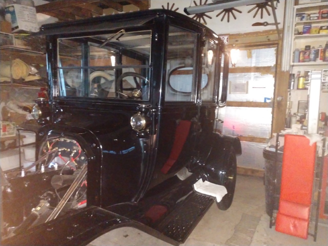

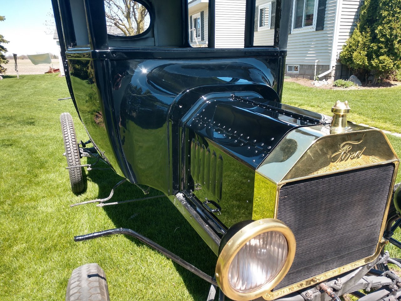

Post by FordorGalore » Sun May 03, 2020 1:29 pm
Almost done with cut/polish process. Taking the afternoon off and letting it get a tan.

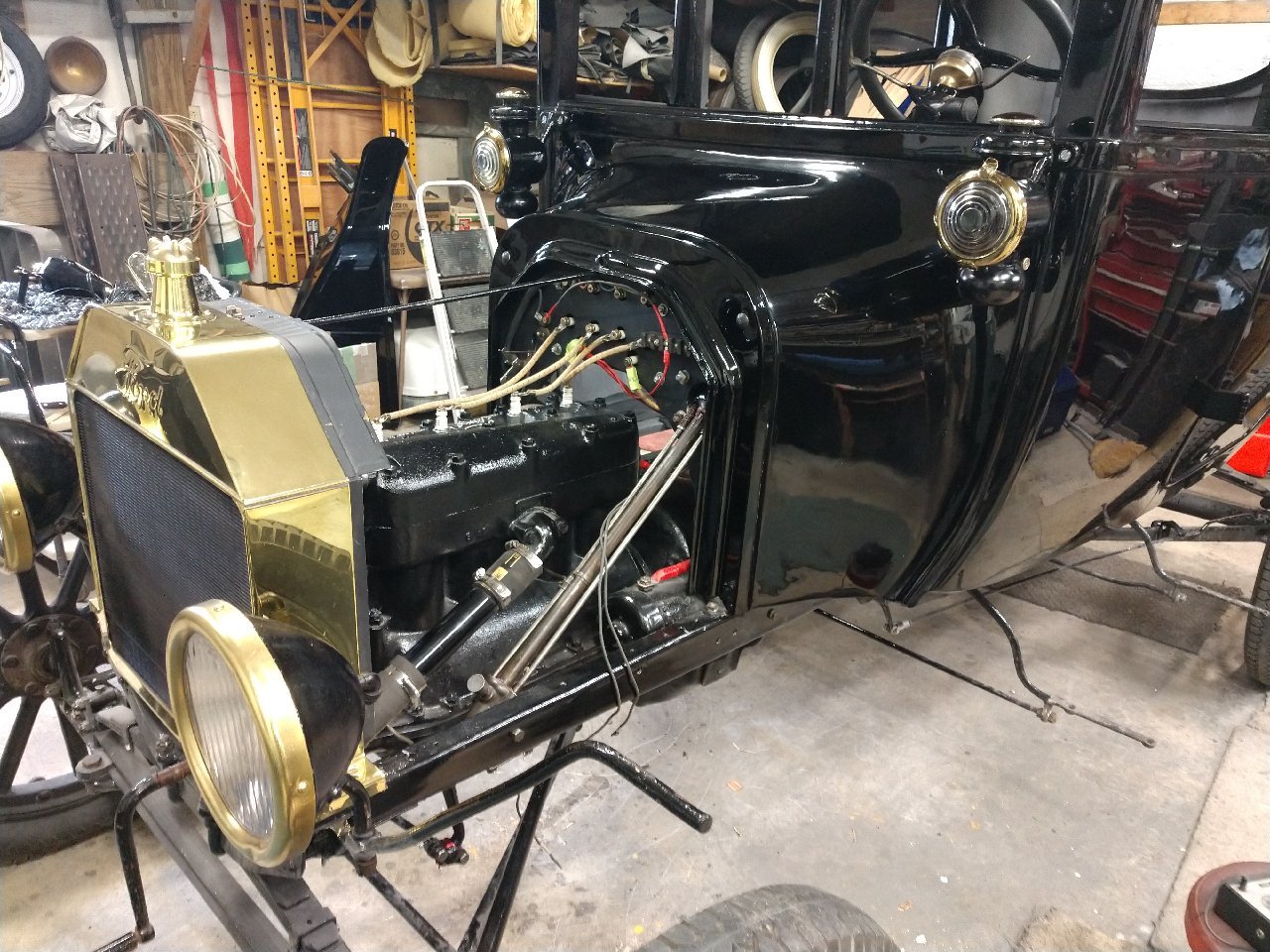

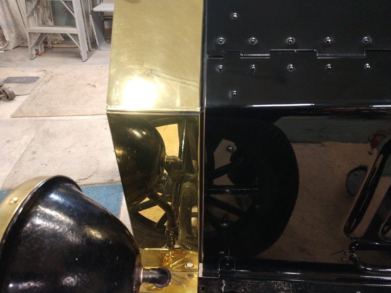

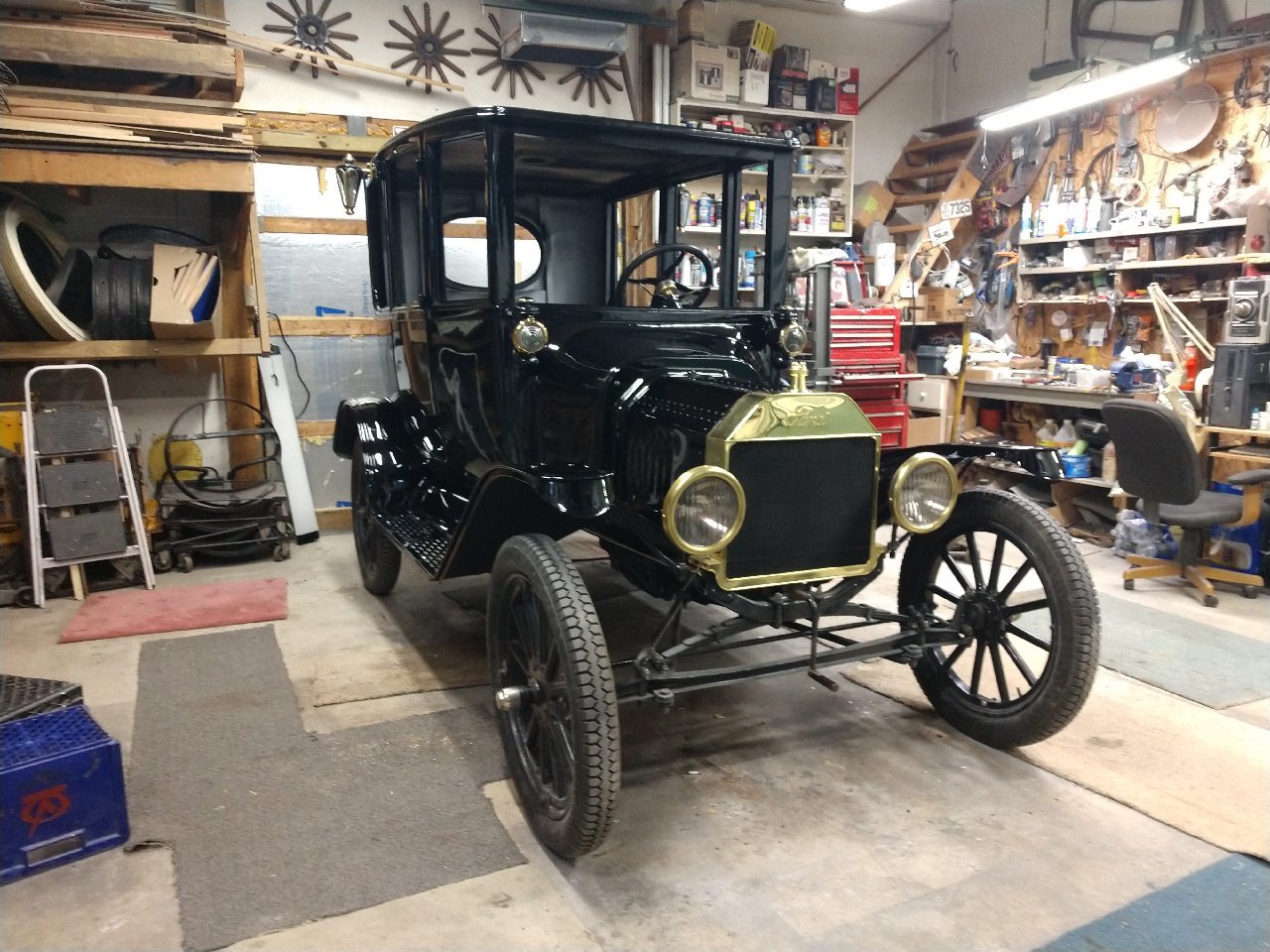

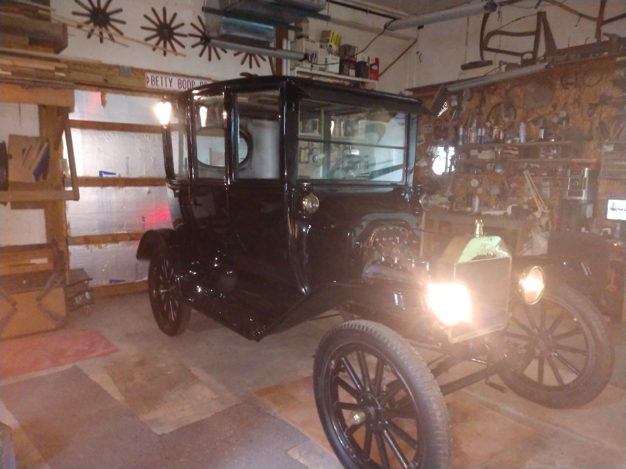

Post by FordorGalore » Sun May 03, 2020 1:52 pm
Some more pic's just for the Idaho Falls Model T guru !!
Post by Mikes 1912 » Sun May 03, 2020 6:47 pm
It is nice to see the table is set with a nice looking table cloth in the Engine compartment. Are you cooking Sunday dinner on the exhaust manifold?

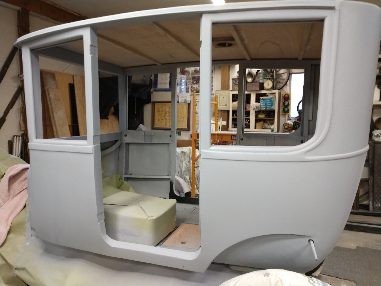

Post by FordorGalore » Sun May 03, 2020 6:52 pm
Lester take that Twinkie out of your mouth !! And put those caramels away you know how they stick to your teeth !!
Mikes 1912
Posts: 122
Joined: Sun Jan 06, 2019 6:05 pm
First Name: Lester
Last Name: Husted
* REQUIRED* Type and Year of Model Ts owned: 20
Post by Mikes 1912 » Sun May 03, 2020 8:53 pm
It is nice to see the easy chair in the background, it is the most important tool there is. You did not say what is on the menu?
22centerdoor
Posts: 30
Joined: Mon Jan 07, 2019 6:01 pm
First Name: David
Last Name: Stauffacher
* REQUIRED* Type and Year of Model Ts owned: 1922 Centerdoor
Location: Monroe, Wisconsin
Post by 22centerdoor » Mon May 04, 2020 1:10 am
Don,
Your paint work is gorgeous!! Take it from one who did that last year on my centerdoor!
Dave

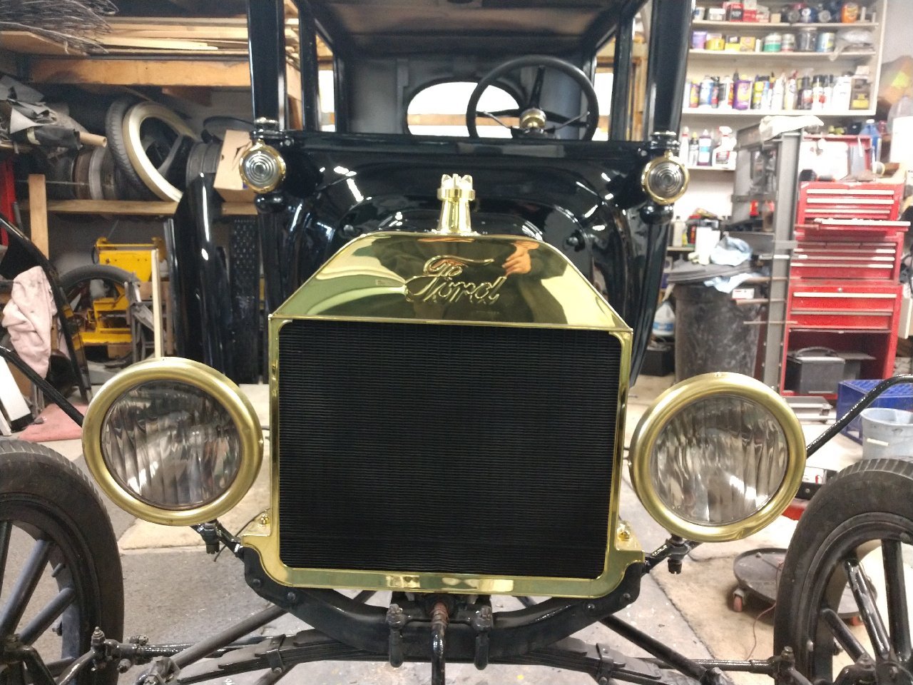

Post by FordorGalore » Wed May 06, 2020 4:15 pm
Got the wiring installed, set the timing, installed the low beams and aligned the hood for this 200th time.
Posts: 1645
Last Name: Seth
Post by perry kete » Wed May 06, 2020 4:43 pm
WOW! That is some car I'll bet you're proud of that baby. :)
Posts: 2533
Last Name: Strange
Location: Hillsboro, MO
Post by CudaMan » Wed May 06, 2020 4:59 pm
Beautiful! :)
Please post a link to a Youtube video of its first startup and run. :)

Thanks Dennis, and Mark I will try to do just that. I'm in no hurry to get it cranked up because I want to start mounting the fenders, running boards and a few others. I did have it running when I bought it and I have to figure out the Stromberg carb on this thing. So if anyone knows where the carb adjustment should be set for a good start please let me know. Thanks in advance !!
Post by FordorGalore » Thu May 07, 2020 8:45 am

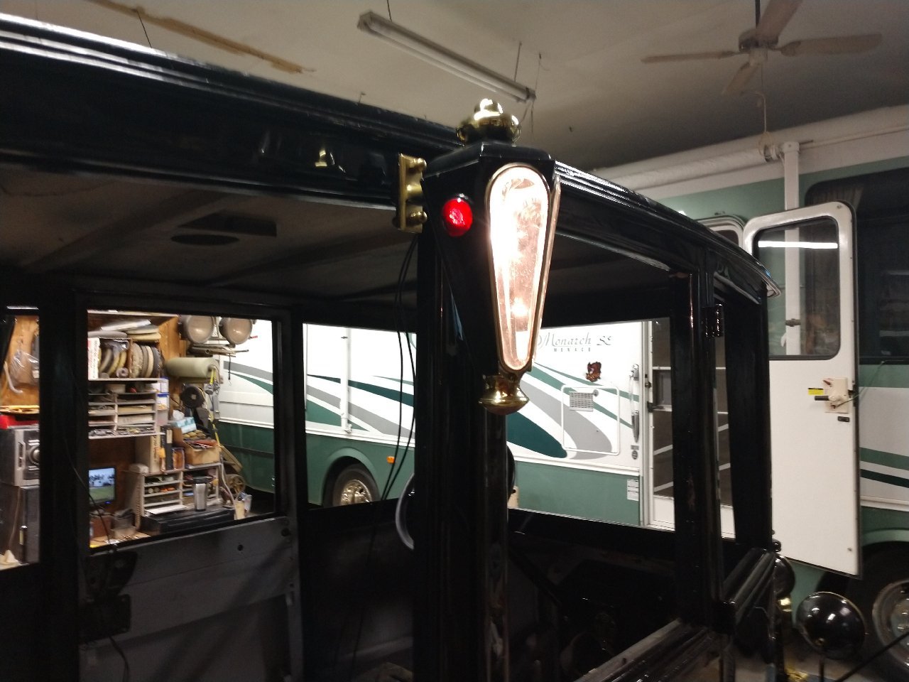

Thanks Mark, I will give him a try. So today after a century or so the carriage lights brighten the day once again. My special thanks to Jim Perry for trusting me as the caretaker of these jewels. Thank you Jim !!

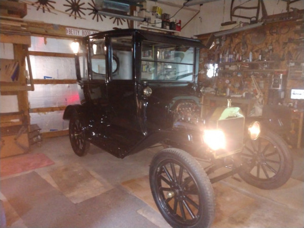

Post by FordorGalore » Fri May 08, 2020 12:58 pm

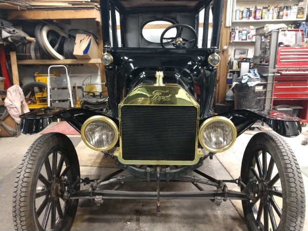

As of noon today Henry's little lady is finally fully dressed !! :D :D :D
Russ T Fender
Posts: 466
First Name: Val
Last Name: Soupios
Location: Jupiter Florida
Post by Russ T Fender » Fri May 08, 2020 1:03 pm
How did you get that done so fast? I'm three years in on a restoration and half as far along as you are! Don't you ever sleep?
Post by Bob McDaniel » Fri May 08, 2020 3:19 pm
Time to get out your milk crate and go for a ride!
Posts: 1645
Last Name: Seth
Post by perry kete » Fri May 08, 2020 3:58 pm
Those carriage lamps make the perfect pigtails on Henry's little lady. Boy everything's beautiful. You better get some pictures submitted to the club magazine. She'll make the perfect "Centerfold Girl" ;)

Post by Marty Bufalini » Fri May 08, 2020 6:01 pm
Don, if there is an OldCar Festival, I had better see this car there- and get a ride!

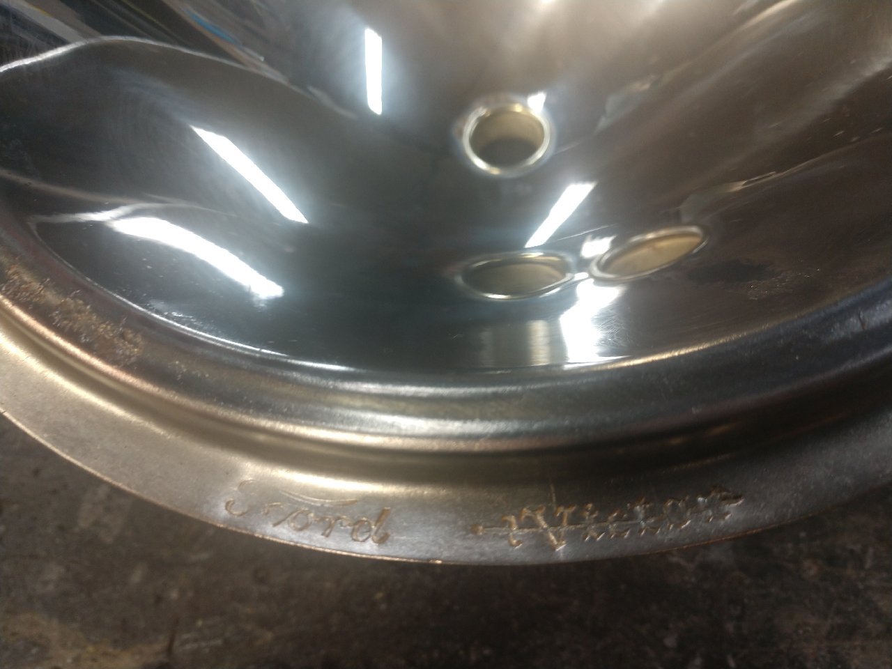

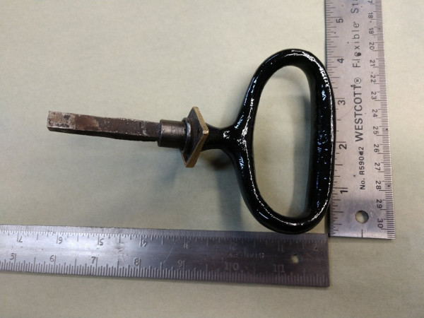

Post by FordorGalore » Mon May 11, 2020 12:19 pm

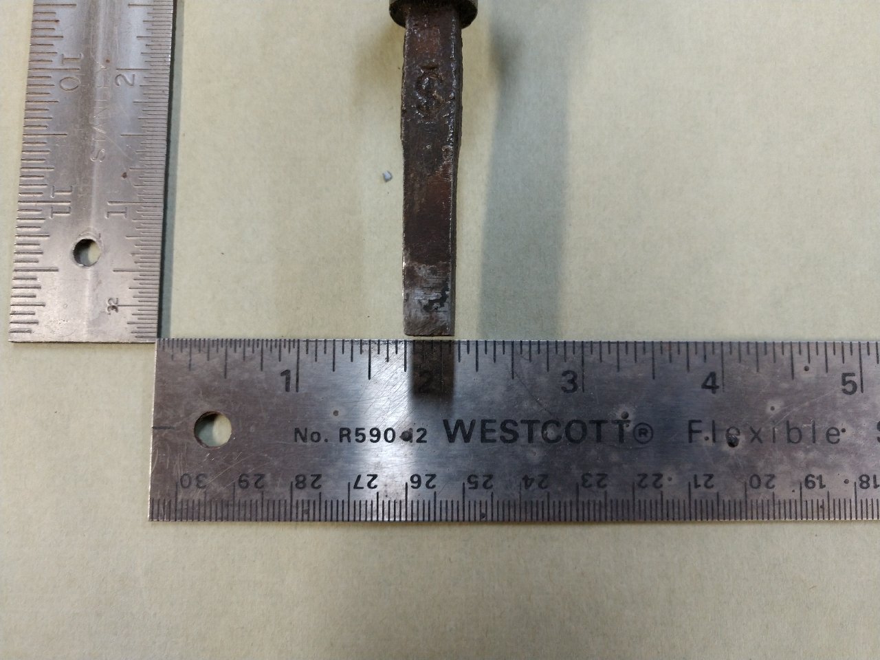

Cleaning up the bale handle and I found this marked on the shaft. It appears to be a $. Does anyone know what trademark this is?
Robert Kiefaber
Posts: 96
Joined: Tue Mar 05, 2019 3:38 pm
First Name: Bob
Last Name: Kiefaber
* REQUIRED* Type and Year of Model Ts owned: 1906 model F, 1907 model R, 1915 centerdoor sedan, 1921 centerdoor sedan
Location: Indiana
Post by Robert Kiefaber » Tue May 12, 2020 2:34 am
It looks like a piece of art, great job Don!

The Ford parts list from the 1920's. Clearly shows that the grip loop handles were painted originally. The body illustration shows many differences from the 15-16's including the door handles, window latches and more. Interesting stuff !

Post by FordorGalore » Fri May 22, 2020 3:41 pm
She lightens up my life !! Completed the wiring, converted the system to 6v. They all work as they should including the magneto horn. On to the upholstery now.
Posts: 4287
Post by Wayne Sheldon » Fri May 22, 2020 3:58 pm
I am amazed by the results, and the speed at which you achieved such a fantastic automobile from such a messed up pile!
Posts: 6776
Post by Allan » Fri May 22, 2020 7:29 pm
Don, she is absolutely beautiful. That car could not have landed in better hands. This may sound nit picky, but to my eyes, those fluted lenses in the headlights look out of place. The plain lens shows all there is to see, and add to the wistful appearance of the early cars. You may see things differently, and that is OK too.

Post by FordorGalore » Sat May 23, 2020 11:49 am

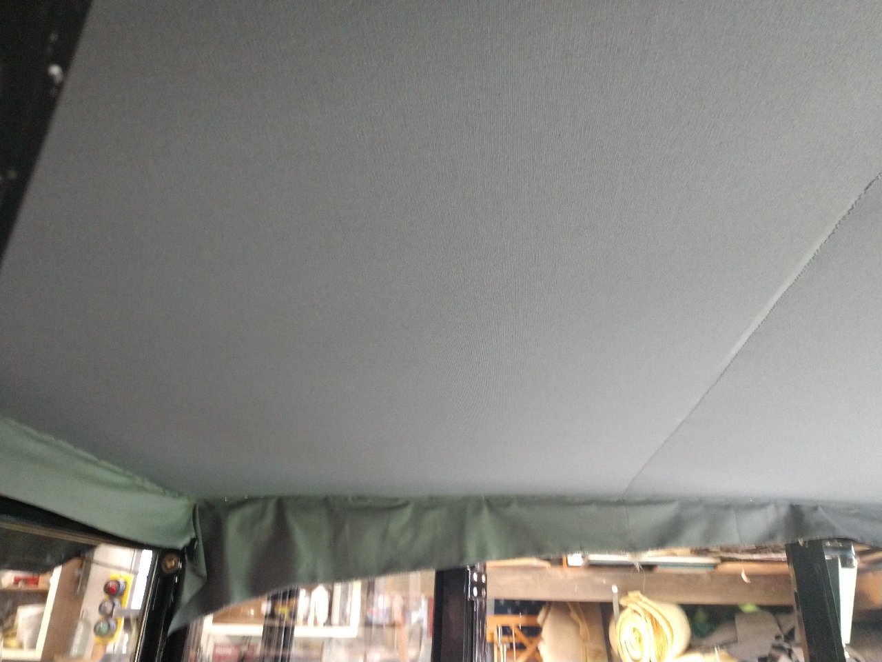

Thanks guys, today I am get'n into my head-liner !!

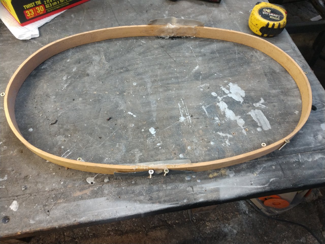

Post by FordorGalore » Thu May 28, 2020 9:18 am

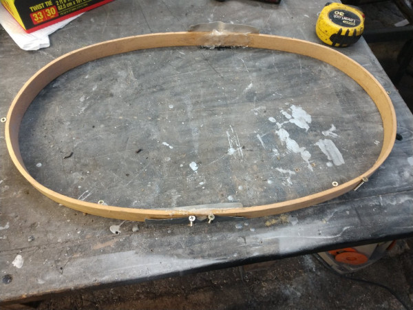

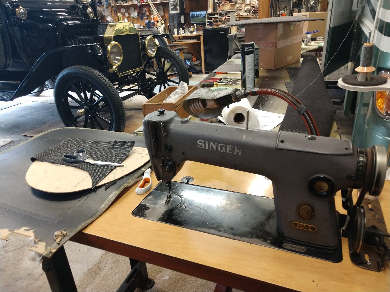

Making the rear window trim......oval, Ohhhhh ful !! :D
Mikes 1912
Posts: 122
First Name: Lester
Last Name: Husted
Post by Mikes 1912 » Thu May 28, 2020 7:50 pm
I did not know that duck tape came in green. Is that better than sewing.
FordorGalore
Posts: 430
First Name: fore
Last Name: door
Post by FordorGalore » Thu May 28, 2020 8:29 pm
That's masking tape, it allows ole farts to sew a straight line ! (or somewhat straight line. Sorta) Picked this up today. Industrial sewing machine that handles those door panels like its a Twinkie on Mr. Husted's desk !!

Post by Dallas Landers » Thu May 28, 2020 8:37 pm
Looks alot like mine Don. My foot feed is so fast, I cant get used to it. They will sew about anything that will fit under the foot.

If twinkies came in that color green I would be in deep trouble. What's with that thread hanging down? must be a chain thread do not pull.

When you get done with my wood clamps and sewing machine I will need it for my 22. and heavy on the Mr.

Dallas, same here. It will take much practice before I take a chance on the panels. But I am excited to get to it.
MISTER HUSTED, as far as getting your clamps back....well I'm afraid you're screwed !! LOL :D :D :D

I need to get a good used industrial walking foot machine. My 1946 Singer 15-91 doesn't have a walking foot and it struggles to sew through more than two layers of vinyl. They make walking foot attachements, but the ones I have seen are made of cheap plastic and don't look like they would be up to the job. :)
