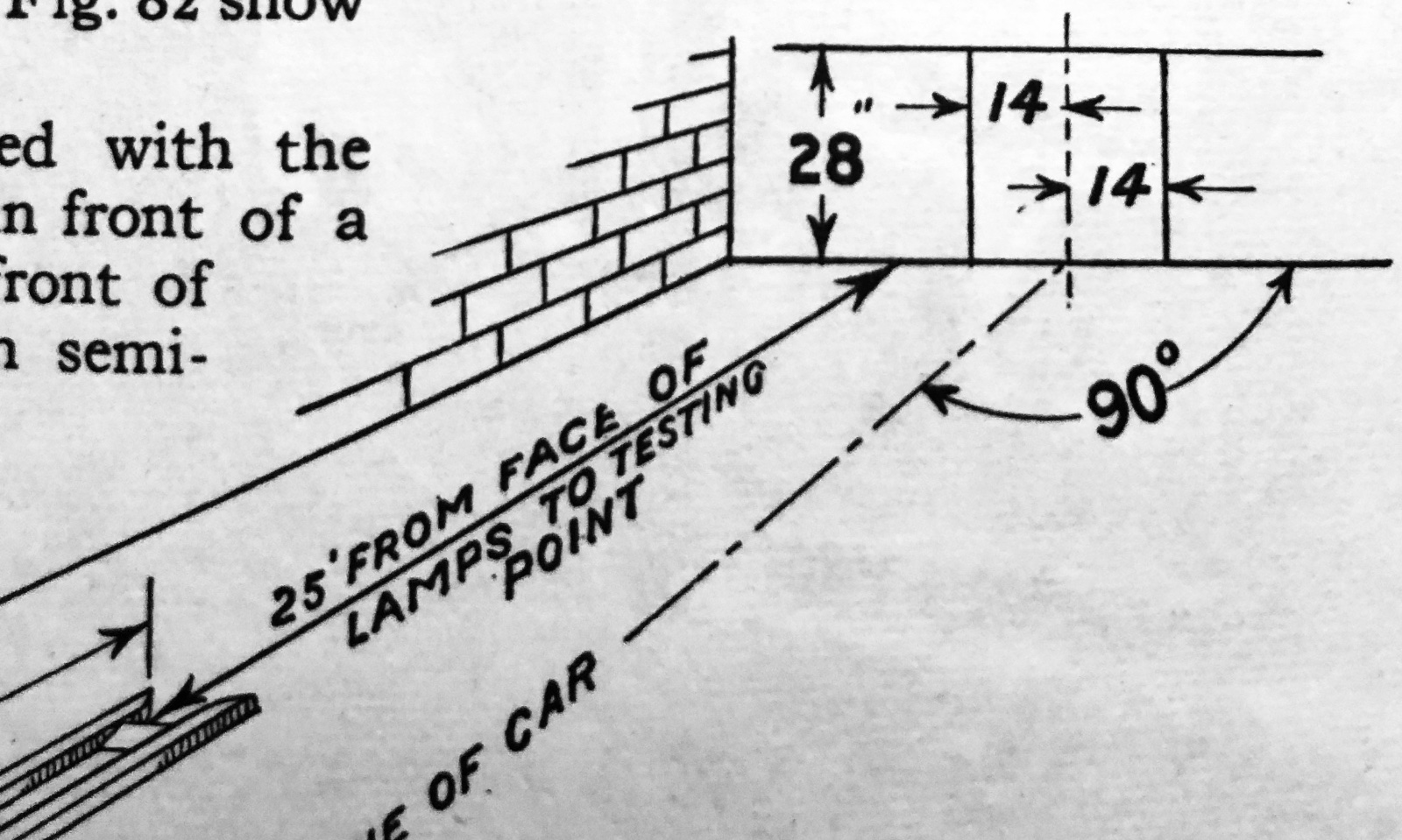

My 26 Roadster has headlights mounted on the bar. There is a dealer set up for headlight adjustment shown in maintenance literature but that’s not practical for anyone to do. Are there any tips for aligning/adjusting headlights?

With the bar mount type '26-'27 headlamp buckets, those are the most easy to adjust than any other Model T headlamp! The earlier '26 was fender mount similar to the pre'25 and need a special wrench as noted in Service Bulletins. But the new bar mount are swivel.
Just locate the height as noted in the Service Bulletin, Sept '25 on your garage door with tape or something, then at dust park the T level about 25' away from the garage door, or the side of the barn or whatever.
Then adj. the lamps by the big nut under each, they swivel on the bar recess, a large cupped washer should be between the bolt shank and the recess. Swivel up down or sideways, lock the nut, check lamp showing on your marks on the 25' away vertical surface. Get the lamps to shine in the marks you made. Rather easy, only tool is a wrench

Now that I look at the service bulletin layout, I can probably do that in my garage. Will have do some garage cleaning which is needed anyway. The only other issue is the pretty good slope where the driveway joins the garage floor but should be able to ramp up at the rear wheels to compensate. For some reason (probably old age), I thought the distance from front wheels to wall was much greater than 25 feet. Ease of adjustment was one reason I traded out the fender mounted headlamps to the bar mount items. Thanks for your input.
