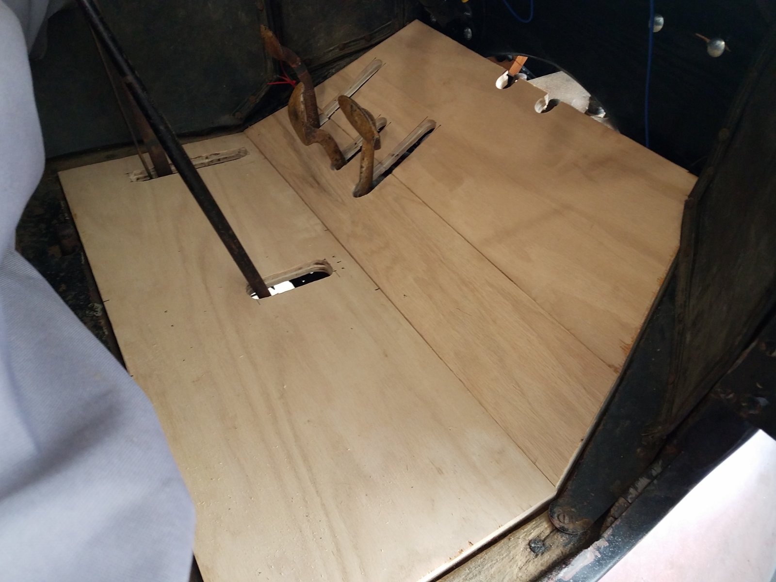

I've rebuilt a floor for Dorothy and would like to find a good sealer from the weather that is also somewhat heat resistant to the exhaust!
Looking to see what you smart folks have had luck with.
Here is a picture almost finished.
Thanks!
Thanks!

Brian, Looks like you custom made your floorboards, and I notice your pedal openings are non standard. All Ford floor boards had the reverse cut out the same as the other pedal cut outs. Also, the pedals move sideways as they move forward, make sure there is adequate side clearance so the pedals do not bind at full throw. The wood between the pedals is thin and weak, the Ford solution was to add a metal plate that provided some additional strength, they were offset slightly to provide an interlocking function to keep the two floorboards from shifting, and also provided a decorative trim. Shifting and binding floorboards are a safety item, those trim plates are not optional in my opinion.
Regarding a sealer and heat protection, neither is needed, any black paint will do the job.

Humble, thanks for the input. Pedal openings are not standard. I did have my daughter test the pedals once the boards were installed and I seem to have clearance where I need it. I suppose a quick trip around the block will reveal if any other trimming in necessary. I've seen the kits that reinforce the area between the pedals and think I may fabricate a reinforcement.Humblej wrote: ↑Wed May 06, 2020 7:21 amBrian, Looks like you custom made your floorboards, and I notice your pedal openings are non standard. All Ford floor boards had the reverse cut out the same as the other pedal cut outs. Also, the pedals move sideways as they move forward, make sure there is adequate side clearance so the pedals do not bind at full throw. The wood between the pedals is thin and weak, the Ford solution was to add a metal plate that provided some additional strength, they were offset slightly to provide an interlocking function to keep the two floorboards from shifting, and also provided a decorative trim. Shifting and binding floorboards are a safety item, those trim plates are not optional in my opinion.
