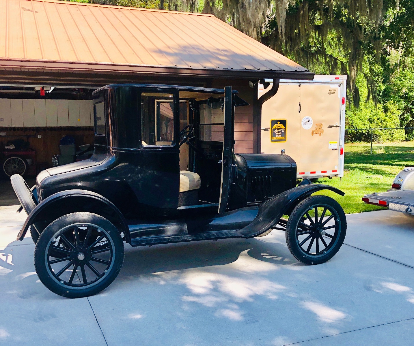

Just brought home a ‘25 Coupe , we had been thinking of a closed car for cold or rainy tours. Been off the roads for years, but won’t take much for making ‘Doc’ roadworthy.

It's an older restoration, wood framing is solid, the engine build date June 3, 1925. Has the metal doors and they close so nice.
Paint has some age cracking, but this will be a tour car. First closed car I've had.
Will get it running to check out stuff, and then go through the rest to make the chassis ready for the road.

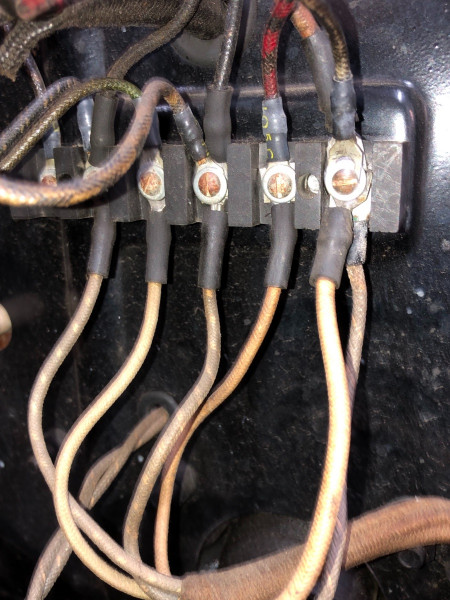

Turned on the gas, climbed in, pressed the starter button.....nothing.
Key on, no coil buzz.
Headlamp switch on, just dark
Pressed the horn button, and BEEEEP....??
Here's the wiring at the terminal block, note where big fat hot Yellow wire is placed...Oops, time for wire trace and check.

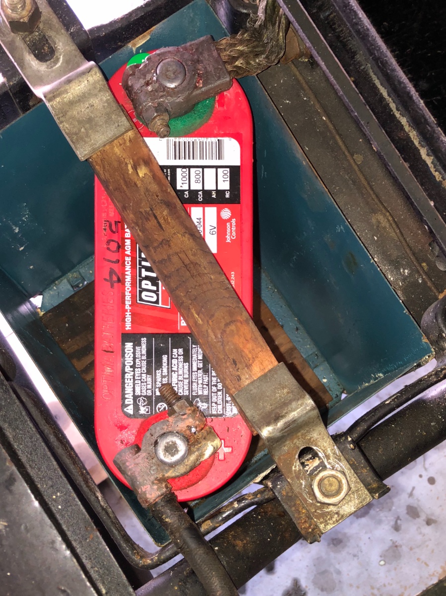

Well, didn't take long to suspect that older 6v storage battery, thought it got charged too quick. So pulled it and sure enough the re-test showed poor condition. Could barely spark the coils, when it did, pressing on the starter button quieted the coil buzz.
So removed and installed a good trouble free Optima 6v, maybe a few years old, but strong enough to turn over the engine multiple times as I set the carb adj. After that, starts fine and runs pretty good for a very old restoration.
So with Doc warmed up, took him around the 'hood. Back home walked around with engine running.
